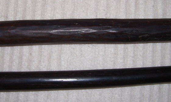

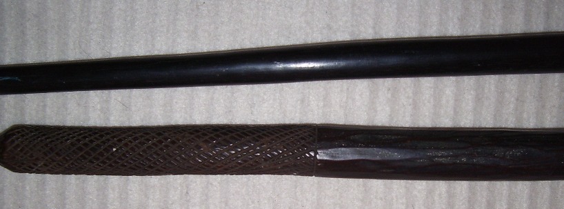

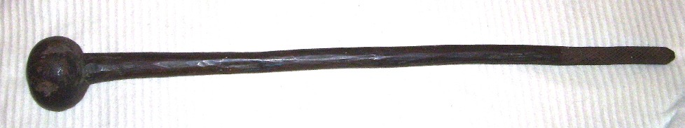

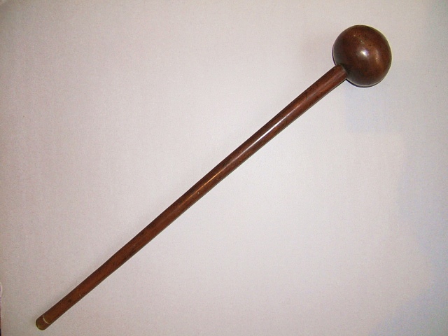

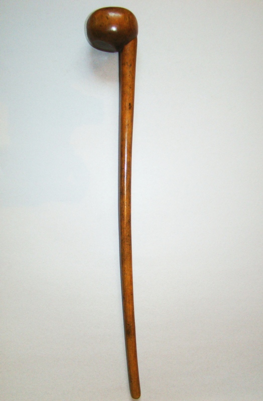

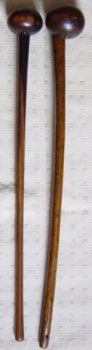

Hi,
have recently obtained two knobkerries....one is of a very hard, close grained wood 58cms long (22 3/4 inches) The head is a 'flattened' ball ... widest 3.5 cms. I have assumed this is Zulu or surrounding tribes.

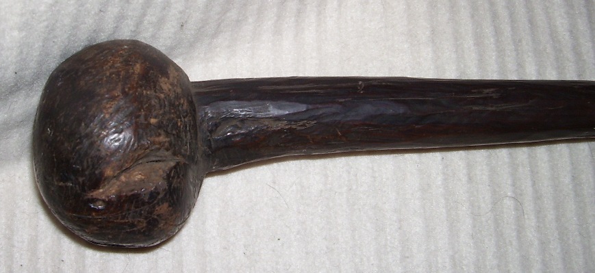

The larger, is a heavy dense wood, great patina ...some damage to the 'head' which appears to be very old (jeweller's loupe). Hand carved shaft/head with grooved carving at the handle end. Head is 'off-set' from the shaft ...some 'age cracks'. OAL 29.5 inches (75cms), head diameter 3 inches (7.5 cms) Judging by the patina etc I can easily see this being late 19th C .
Is Zulu a likely source for this knobkerrie ?
All comments greatly appreciated.
Thank you David

Hi Katana
They seem to be Tanzanian and not Zulu to me. The wood and the style does not seem Nguni or Swazi and definately not Xhosha. Could be Gogo tribe but it's hard to be sure. Still they are nice examples.

Hi Lew,
thank you for your comments ,
The knobkerries were bought individually, at different times. The smaller one was described as a Zulu 'shield beater'
The larger, hand tooled one seems to be made in the Zulu 'mould' (mold ) I have seen provenanced Zulu knobkerries that are not made from the usual bi-coloured wood and number of which were hand carved. In fact, I have been told that the majority of the bi-coloured type are early 20th C onwards (an opinion of a 'Zulu' collector)
Unfortunately, Spring hardly mentions knobkerries in "African arms and Armour" and Stone's " A glossary.......Arms and Armour...." mentions even less.
Tried to search google for "Gogo club" in image search..but just get pictures of scantily clad females not a bad thing, but not really helpful
All the best

Hi David
I agree with Lew about the club with the larger head being East African, not sure about the other one.
The book "Zulu Treasures" is a good reference...

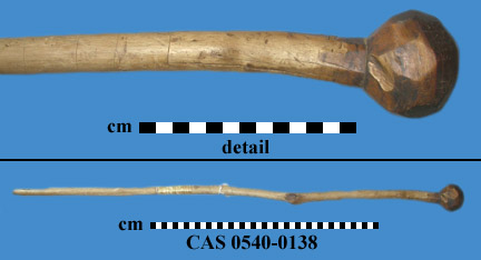

Just to illustrate the point about the diversity style and degree of workmanship of S.A knobkerries ...
Below is a knobkerrie collected from Natal Province, Nqutu District
Best

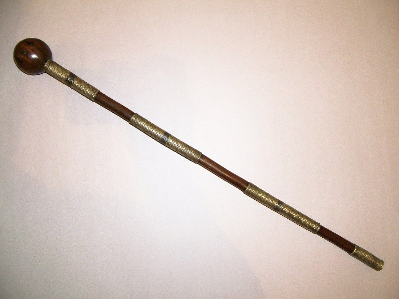

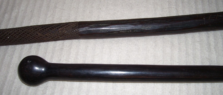

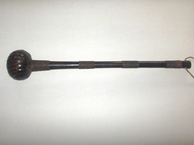

I put together a list and will try my best to identify them correctly.
Here is some facts on the Zulu
The Nguni peoples are classified into three large subgroups, the Northern Nguni, the Southern Nguni, and the Ndebele. The Zulu and the Swazi are among the Northern Nguni. The Xhosa are the largest Southern Nguni society, but the neighboring Thembu and Mpondo are also well known Southern Nguni societies, often described as subgroups of the Xhosa. Each of these groups is a heterogeneous grouping of smaller (also heterogeneous) ethnic groups.
Top= Two Northern Nguni clubs to right is also the same.
Next= Swazi
Next two=Northern Nguni
Last= Zulu Natal
