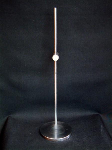

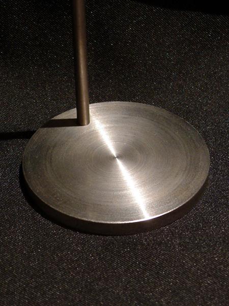

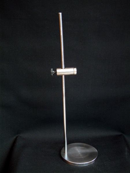

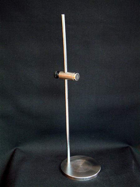

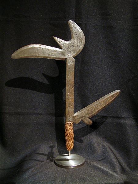

I have design this magnetic stand.
Round heavy base (8mm height) , adjustable in height and rotation.
It can support a heavy weapon with 1 magnet, or a VERY heavy with 2 magnets, even sometimes with the scabbard.
Anybody else has this kind of idea ?
Luc

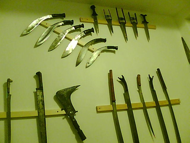

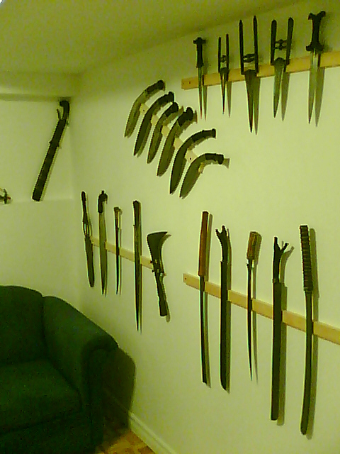

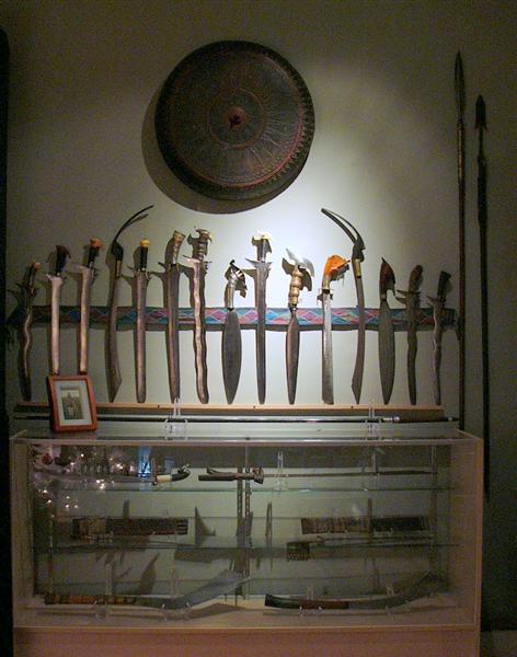

Here is my attempt with magnest.
These Moro weapons are held in place by 1.5 inch long x 1 inch wide x 1/4 in thick neodymium magnets behind the cloth. I sawed a slot in a piece of oak board, screwed the board to the wall, inserted the magnets and then put the cloth to hide the board and additionally protect the blades.
If you use neodymium magnets, be VERY careful. Unbelievably powerful. I got these on eBay from a company called "Rattlesnake." Well named. Two magnets will attract each other violently.
Not so dangerous just holding the steel blade but they hold it very well and the cloth keeps them from scratching the blades.

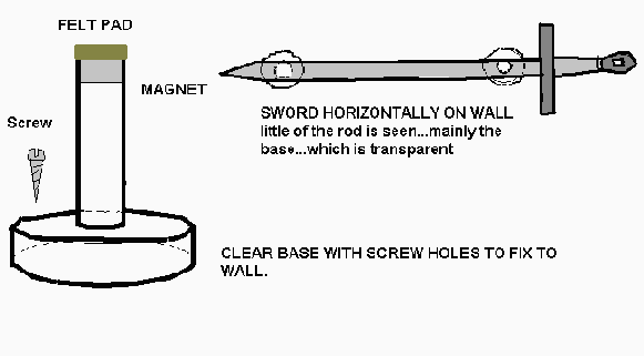

Interesting that this thread came up. I have been working on the idea of making wall brackets out of clear perspex/acrylic with neodymium magnets embedded.Basically a clear plastic rod is fixed to a bracket (to fix to the wall) at the end of the rod is attached the magnet and a felt protective piece. The rod could be 4-8 " depending on the thickness. Two would be needed to mount a sword horizontally. Once the sword is 'magnetically stuck' the only visible part of the bracket would be the clear plastic. The added bonus is ....because the bracket 'base' is clear....the surface of the wall will show through ...helping to hide it.
The idea was to create the illusion the sword was 'floating' next to the wall.

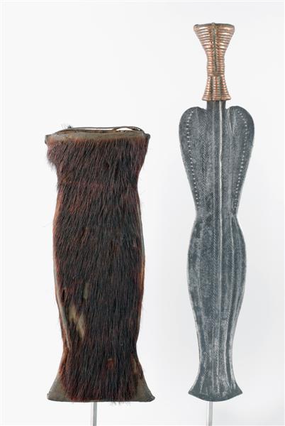

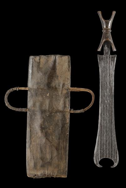

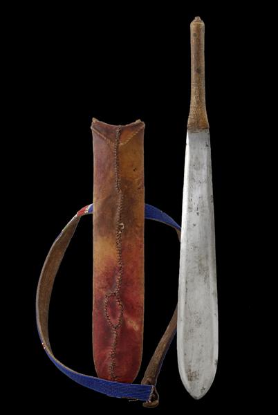

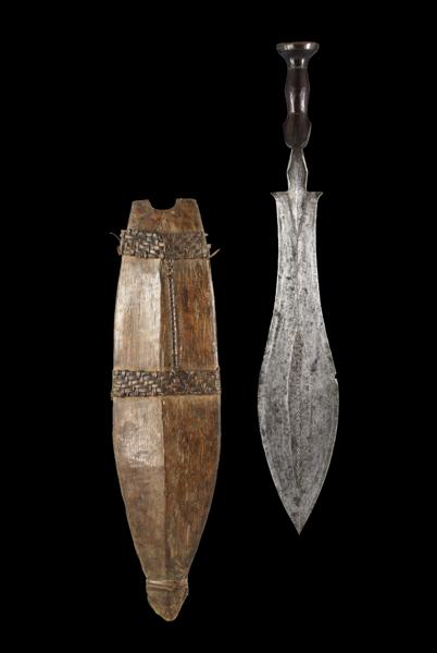

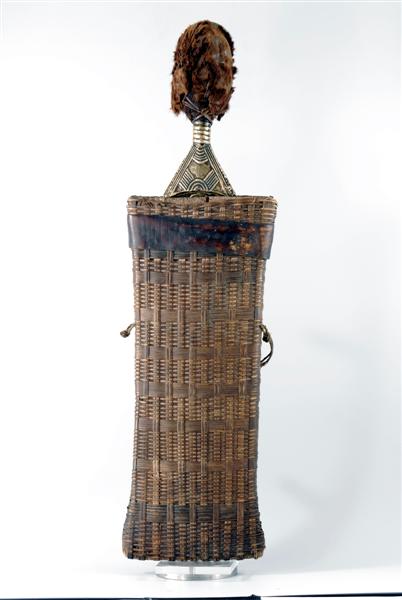

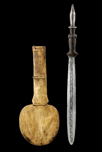

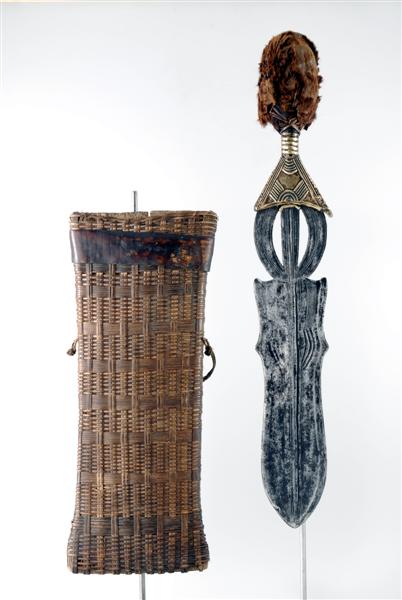

Here some pics I have made recently with scabbards.
On the photo with knives in the scabbard, I use the magnetic stand.
Luc

Old 4th January 2007, 10:12 PM   #10
katana
katana's Avatar
Location: Kent
Posts: 2,658
Luc....they look excellent.

Your system with plexiglas seems to be a good idea to hang on the wall.
Just try it and show us.

Nice wall Bill with good light.
In fact I've hurt myself with the magnets 2 or 3 time, my fingers remember this moment...
Luc
Originally Posted by Bill Marsh
Very nice stand, Luc.

Thanks Luc,
I have had 1 inch square magnets snap together with enough force to give me blood blisters. The bigger ones can actually break bones. It is unreal how powerfully they attract each other.
A six inch diameter by two inch thick can hold up 1175 POUNDS of iron and they are much more powerful attracting another magnet. The seller says this about a 6" x 2" magnet.
"This is an EXTREMELY Powerful Magnet! The end user MUST USE SAFETY PRECAUTIONS when unpacking and using this magnet. Remove all metal objects within a 5 foot radius before unpacking. Magnets of this size and strength can pull metals objects to them when brought too close. Two magnets of this size will fly together with great force and can break bones."
I am very careful when using 1" x 1.5" magnets, but they sure hold a sword well. They will each lift about 55 pounds of steel.

If these magnets are so strong, then can they attract the blade through the wood (or whatever) of the scabbard? Furthermore, is it difficult to separate the blades from the magnets?
Luc, In the picture where the scabbard is alone on the stand, how is it held? Is there a bracket around it?

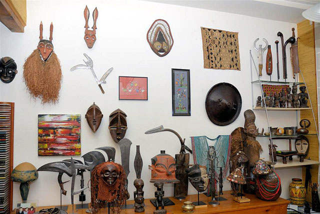

No problem it works really good.
And I'm still alive with my 10 fingers and a good heart !
Here a picture of a wall at home, you can see some magnetic stands.
Luc

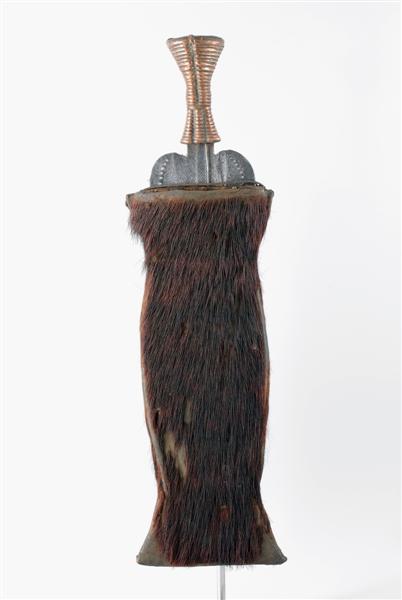

Default Scabbards

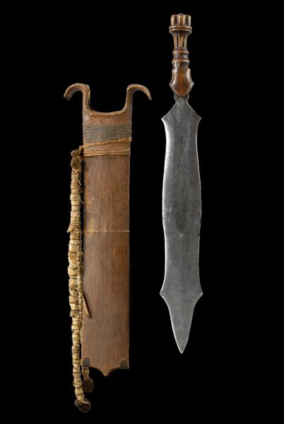

If you like knive with scabbard, here some.
Luc
