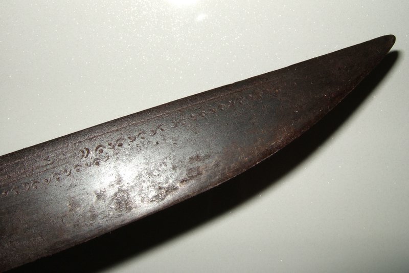

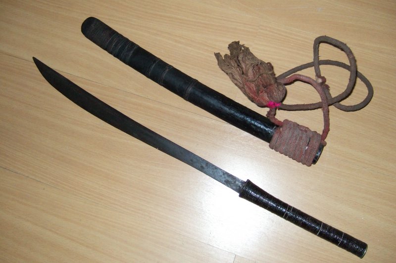

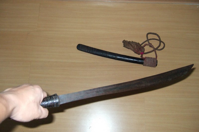

Hey all. Was led to this site during googling of sword topics. Interest spurred by my purchase of a sword in Laos as a memento. I'm by no means an expert. Any comments appreciated.

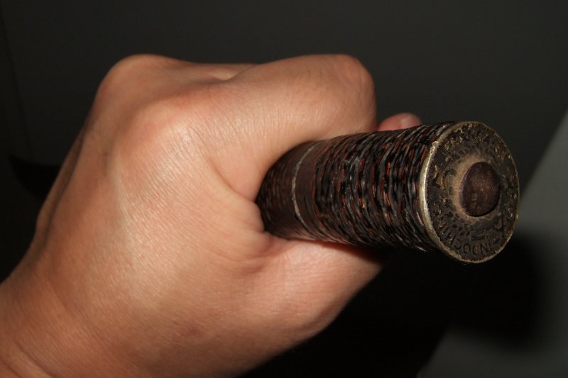

Welcome to the forum and you are off to a flying start with a question about dha! What you have is an early 20th C. dha in the Thai style. The slightly flared handle, the blade that increases in width and then tapers to the point. The scabbard, with typical cord suspension system (baldric), is held together by the standard plaited rattan strips. decoration on the blade is similar to recent Thai blade designs.
If you are interested in a discussion of recently made Thai darb, you can find more information here: Contemporary Thai swords
Your sword is older than those recent Thai examples and of better quality. I'm sure your blade would be well tempered and the decorations are typical of pieces from the late 19th/early 20th C. in the NE Burma/N Thai/Laos area (often termed the "hill tribe" region). This style of blade probably traces its historical origins to the Shan people, but subsequently a much wider set of ethnic groups adopted this basic form.

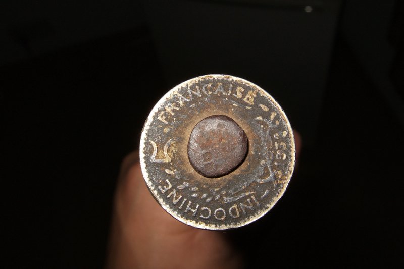

What sets your sword apart as Lao rather than Thai is the provenance (you purchased it in Laos), the old French Indochine coin, and the black lacquer on the scabbard and hilt. The use of black lacquer on hilts and scabbards seems to be more common in Laos and neighboring areas, than in Thailand or Burma.
Hope this is helpful and gets you started on learning more about your sword.

That is a nice piece you have there, micas. It is a style typical of the working dha of the "northern" Tai (Tai yuan), called Shan by the Burmese, and including the Lao. This style is seen all over the northern-ish part of continental Southeast Asia, meaning northeastern and eastern Myanmar (Burma), northern Thailand, Laos, and likely Yunnan province in China though we don't have any well-provinanced swords from that particular area. The coin substantiates the Laotian provinance, as most of Laos was part of French Indochina.
The vine motif, the rattan-wrapped grip, rattan bindings on the scabbard, the blade profile and scabbard shape (with rounded tip) make up the "suite" of traits characteristic of this style. I would say that the coin is original, and more-or-less contemporary with the sword. Its possible that it is post-WWII, but my guess based on the patina and wear, and the condition of the cord baldric (also original from appearances) is early 20th C. The incised decoration on the blade is rather nice, and does not appear to have been simply stamped in, as you see in recent blades. The black coating on the grip and scabbard is something that Ian has identified as being characteristic of dha from Cambodia (and I think Laos as well -- correct me if I am wrong Ian). It seems to be something the eastern-most users of dha did with their swords.

Nice sword. I particularly covet these weapons with coin handle caps (I hesitate to term them "pommels" anymore, as they really don't serve such a function). I've got a few with similar coins, and the provenance they contribute can be very helpful, even if not always definitive.
