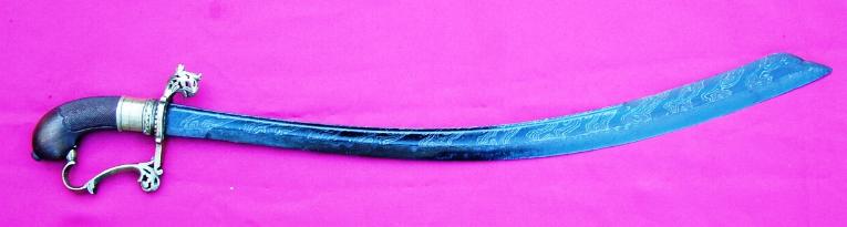

Default Parang Nabur for sharing or comment
I have never see a Parang Nabur with pamor
regards semar

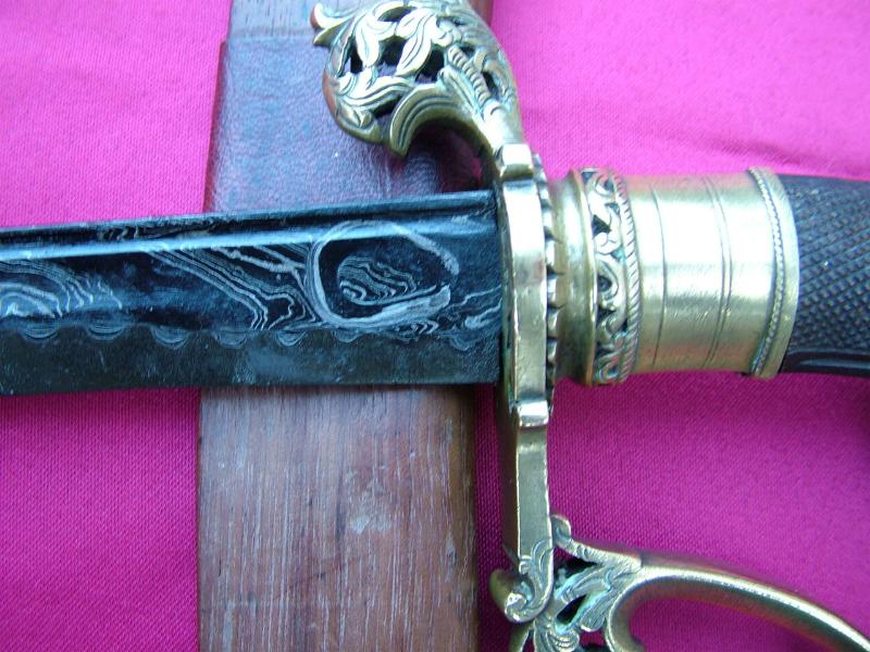

Beautiful piece Semar! I think it's a sort of pamor miring. What type of pamor miring is that? Pamor Walang Sinuduk?

hello Alex
the lengte of the parang is from the tip to the end of the hendel 75.cm
en the lengte of the blade 62.cm
I think aboud the pamor he looks like iris pandan

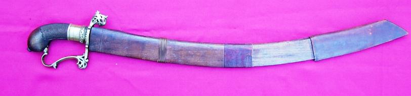

Beautiful sword! Is the end of the sheat from leather?

yes the end of the sheat is whit leather

Interesting Piece Hans.
Considering the style and quality of the handle I would say that this Parang Nabur handle might be between 1850 - 1900.
But is the blade also that old ?
The age of the blade is difficult for me to judge because it has recently been washed and oiled.
Maybe there are other forumites who can judge such a blade based on the pamor characteristics / quality ?

Never seen a pamor blade in one of these before .
Is the blade a new replacement ?

Interesting sword.
I noticed it too when it was offered but I had this hunch that it was a, maybe Bali,
later combination with the pamor blade and the end of sheath.
It's strange that the blade just follows the contours of a Beladah Belabang-blade
but there aren't the usual cut out characteristic details?
Also that the top "half-wing screw" isn't replaced when everything else seems to be restored?
Michael
