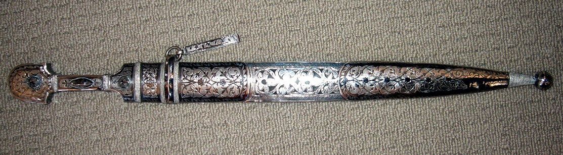

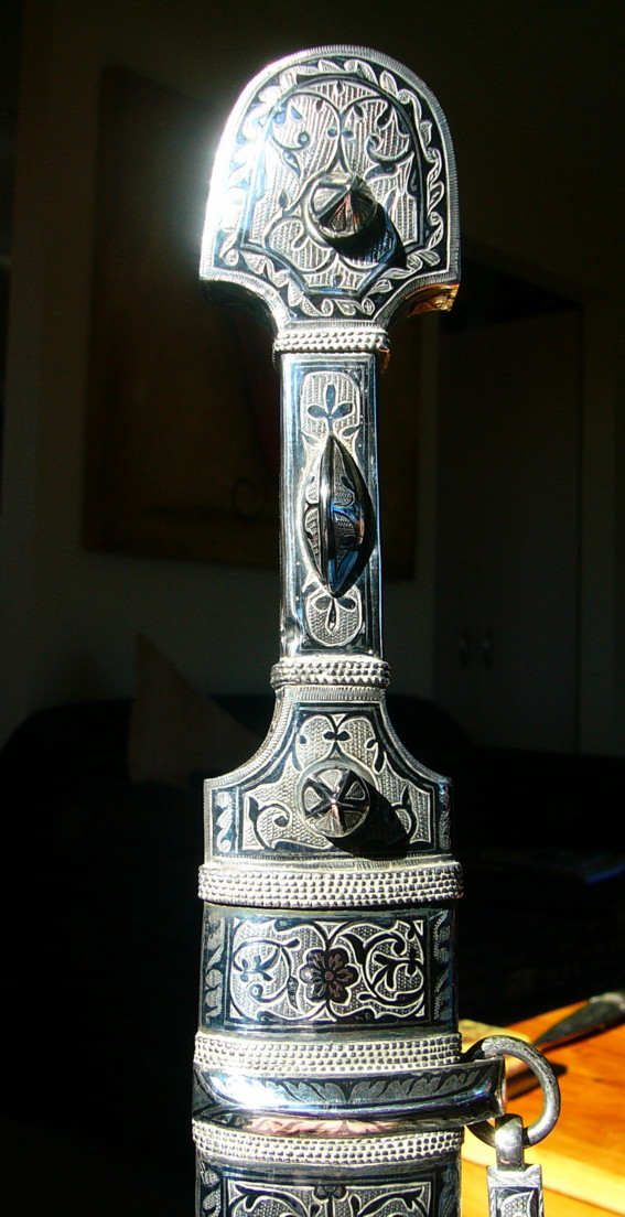

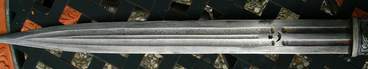

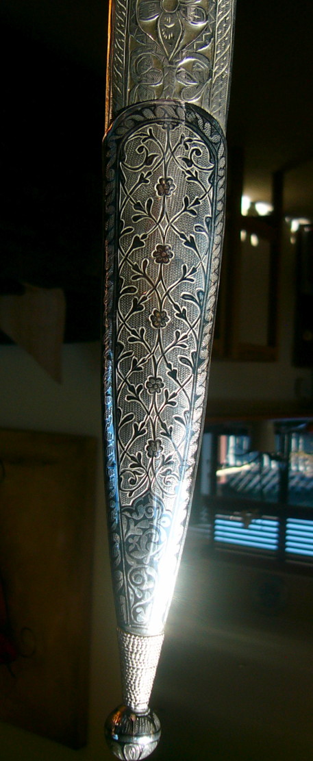

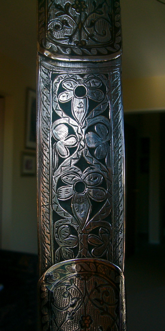

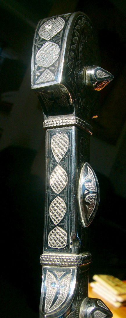

Picked this up recently and would like some information please as to age, origins etc. Also comment on the blade mark. The top and bottom section of the scabbard is solid niello silver and the middle section pierced silver over leather.
Size 24 3/4" overall with a 17 7/8" blade.
Regards Stuart

Beautiful piece.
My knowledge of the kindjals is one small step above rudimentary. To me the blade looks Georgian, perhaps by a Tiflis maker. The mounts are in the Northern Caucasus style.

Nothing to do with the Caucasus and Tiflis. Turkish dagger.

Without holding it in my hands, I suspect that the silverwork is new and assembled from different pieces: look how the middle panel differs from other ones.

Interesting----I was about to repost this as I got no response before. The centre panel is certainly an addition. OK we have 2 differing opinions as to origin. What is reason for the attribution to Turkey?---and to Caucasus? I had been told it came from Dagistan and dated to around 1910.
The niello is NOT new and apart from the centre section the piece looks to be all made at one time and not a combination of "bits".

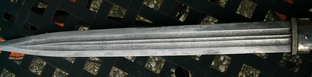

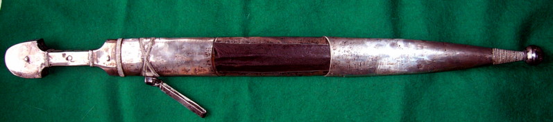

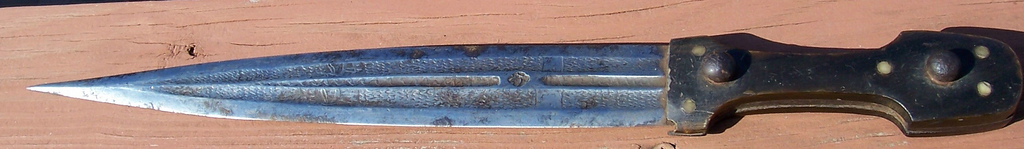

Here's my "Turk", purchased on eBay.
Of course, the more coarse imitation of Damascus, but ... you should look.
False damascus etch in valleys blade.
