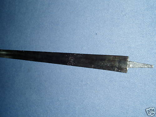

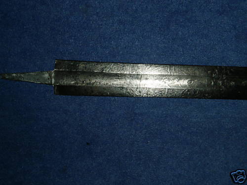

Just finished on Ebay - a museum apparently told the seller that it was mid 17th century...
stephen wood is offline   Reply With Quote
Old 25th January 2009, 10:26 PM   #2
Posts: 10,857
Hi Stephen,
This is one of the central fuller type blades often seen on kaskara, and does correspond to European trade blade forms, but I doubt the 17th century suggestion. Naturally further research or close examination of the blade in hand might reveal more.
It is hard to see from the photos, but the etching would correspond loosely to the acid etched broad stroke 'thuluth' calligraphy applied as motif during the Mahdist period on not only kaskara, but many of the weapons from the arsenals, especially Khartoum. It would be interesting to compare the etching here with the Mahdist examples.

...thanks Jim. I took the dating with a pinch of salt...

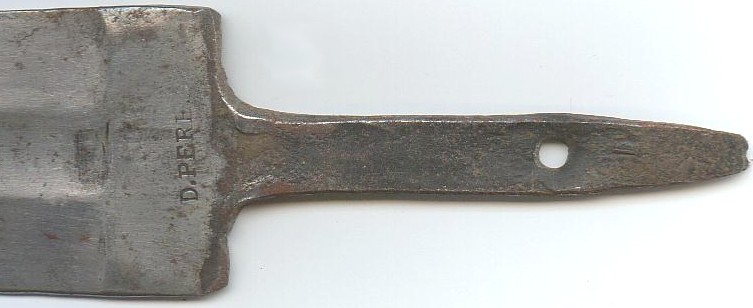

What about the tang? Isn't there usually a hole to secure the hilt? (see image) Also the tang looks like it was added rather than being an integral part of the blade. I general though I think it could be a kaskara...
The "thuluth" blades tend to be shorter, wider, blunt and thinner in my experience.
Re. the museum, the seller took it to Rochester Museum in the 80's...not as if Christopher Spring had a look

...sorry for the confusion David - I posted the D.Peres image to illustrate that the tang usually has a hole - it's not the blade in question but a previous post.

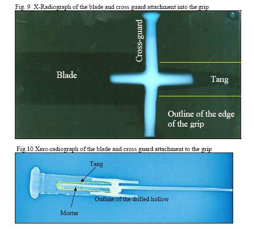

This image shows how a blade with such an unpierced tang is fixed into the hilt.
It is a "thuluth" kaskara - note how wide and flat the blade is and the characteristic "rounded" pommel.

Thank you for the great graphics showing the mounting characteristics on these. It's truly helpful to see how these were put together!

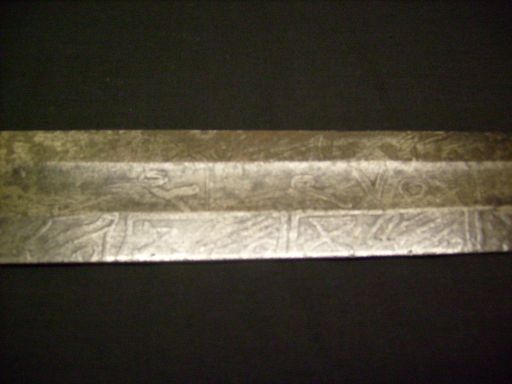

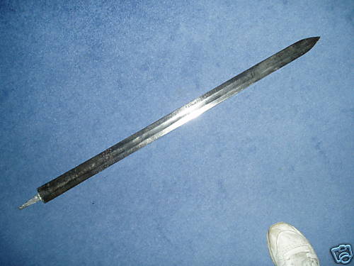

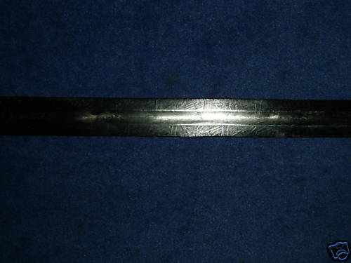

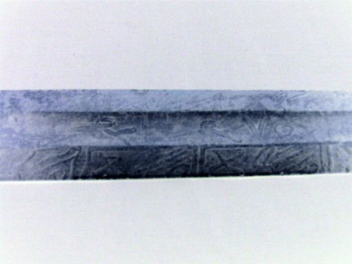

...I have been able now to make some better images, including a negative (which can show the etching better).
Now that I've actually handled it I can add; it is actually very well-made and appears to be quite old - there are areas of pitting and wear. There is nothing of the rather "raw" look that some of the (short/wide/flat) etched blades possess.
It is 36" long (not including the tang), 2" at it's widest point tapering to 1 1/2".
Unsharpened. There is a single broad fuller. The etching consists of what appears to be a single 3-character "phrase" repeated along both edges and a longer "phrase" etched in the fuller towards the ricasso. Identical on both sides.
It is quite unlike any kaskara I have handled before - closer I think than anything I have seen to the Islamic swords that are said to be the kaskara's antecedent.
I wonder if anyone can pick out the script from the new images?

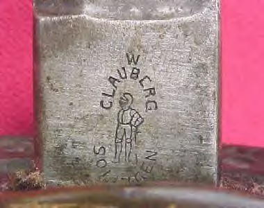

...a gentle clean has revealed the partially visible W. CLAUBERG SOLINGEN mark on the tang. I have seen kaskaras with Clauberg blades before but none like this broad, single-fullered type.
I understand that Clauberg blades, with their trademark of a man in armour, were known in Arabic-speaking countries as Abu Askari - bearer of the soldier.
I have as yet been unable to take a clear photo of the stamp - here is the same mark on a Civil War Officers' Sabre.
Interesting how some kaskara blades which were thought to be unmarked are revealing maker's marks on, or near, the tang - in this case it had to be the tang as there's no ricasso.

...inside the fuller near the hilt on both sides 1258 Mohammad Ahmed which is the name of the Mahdi and a Gregorian date of around 1842 - two years before his birth I saw one recently with the same.
