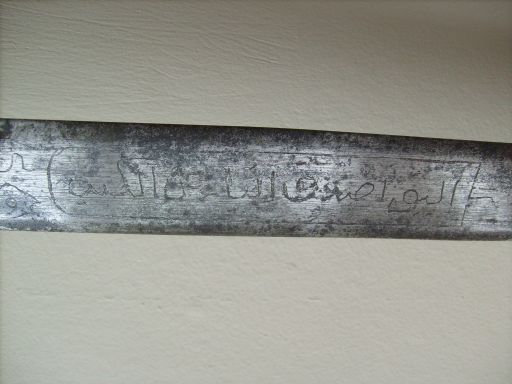

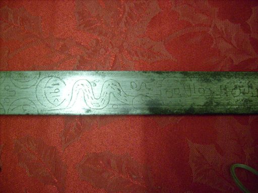

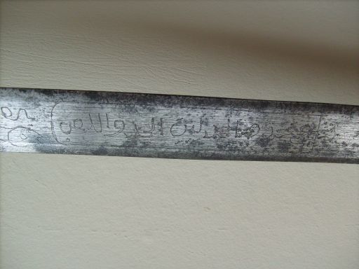

I would be very grateful if anyone could give me an idea of the reading of these Arabic texts which are inscribed on a kaskara blade.

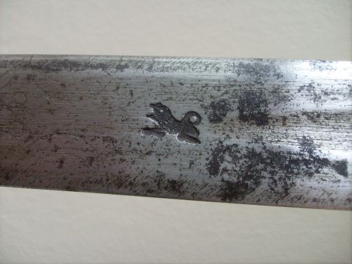

The blade itself is stamped with an orb and a lion as per Pallme's footnote, which might date it as early as 1837 although I expect the engraving is later.
It is not as long as usual (31") showing no sign of having been shortened and handles very well.
I read the date in the moon as 1915 (Gregorian) an auspicious year in the history of the Darfur Sultanate.
Many thanks,
Stephen

It looks like the Arabic is etched not engraved. That is usually a good sign it was done later than the blade especially if it is older one.

I am curious about the snake/python symbolism,which does seem to occur noticeably on blades from Darfur and these regions, enough to be noted in the Reed article.

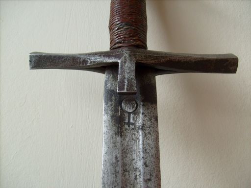

The cross and orb is different than those typically inscribed on European blades in which the cross's verticle line extends to a horizontal line bisecting the orb. Italian blades of some similarity identified by the markings on them , as well as the orb and cross as early as 16th century are known in Tunisian regions. Perhaps these were the prototypes for the native applied versions.
The lion reminds me in essence of the winged lions found stamped in some schiavona, for St. Marks. I believe the stance is however similar. There is of course considerable record of Venetian trade into Tunisian regions.

1912 to be more precise
the last digit is a 2 ... here all digits are wrote in arabic in fact
quality of your pic's is not enough to proceed at a try of translation, sorry
