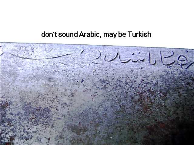

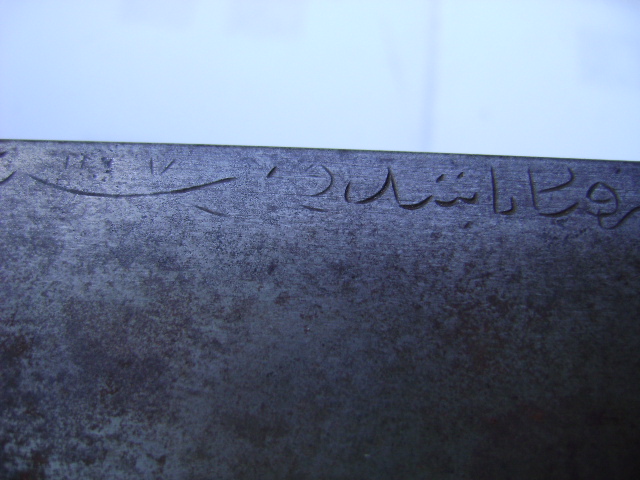

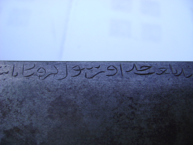

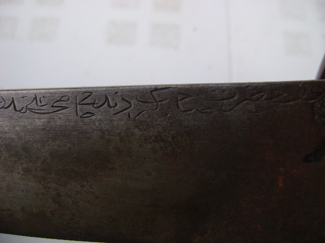

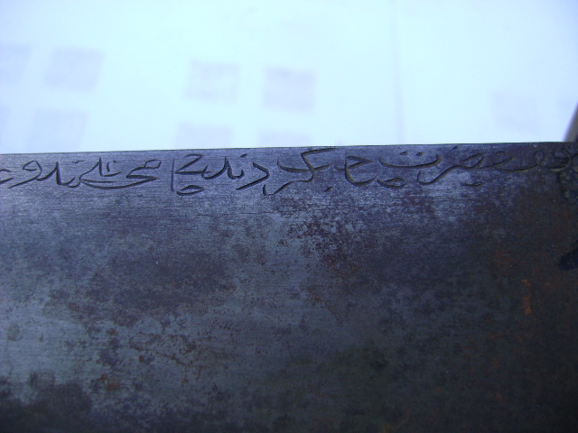

OK, folks, I just got this puppy.
Old, ancestral blade with ugly military handle.

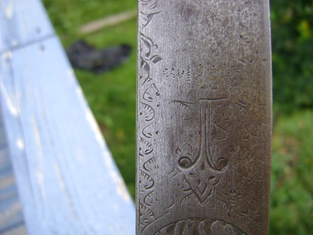

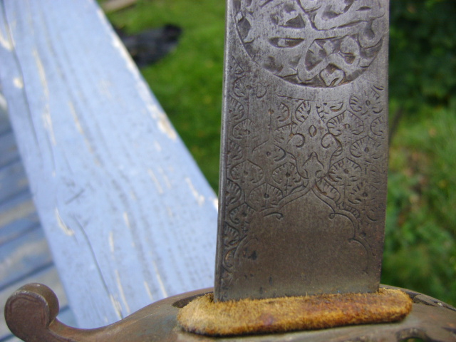

As per my understanding and books of Yucel and Mohammed, this is a Mamluk-style sword, dated 1107H, ie 1695-1696 Gregorian . Mamluks were conquered by the Ottomans in 1517, thus: Mamluk-style. Typical decoration: some ornament at ricasso, then cartouche, then Mamluk "commas".
The blade has a little bit of superficial rust ( yet uncleaned, I am still drooling), and some areas seem to show Damascus structure, I think mechanical, but will know better when it is polished and etched. It has yelman, but very small , what is usually referred to as old kilij type.

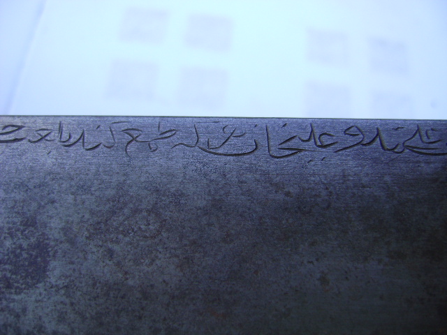

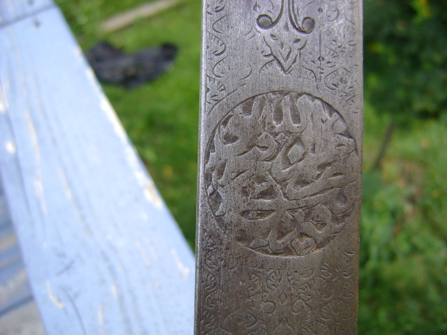

There is a long inscription along the spine on the left side of the blade, short decorative one on the right side and cartouche.
Please, translate as much as you can!!!!
Thanks in advance!!!
Today is my birthday and this is my present to myself :-)

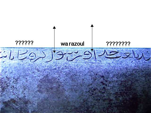

Old 17th September 2009, 03:02 AM   #7
Dom
Dom's Avatar
Join Date: Oct 2005
Posts: 1,142

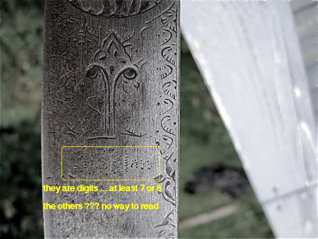

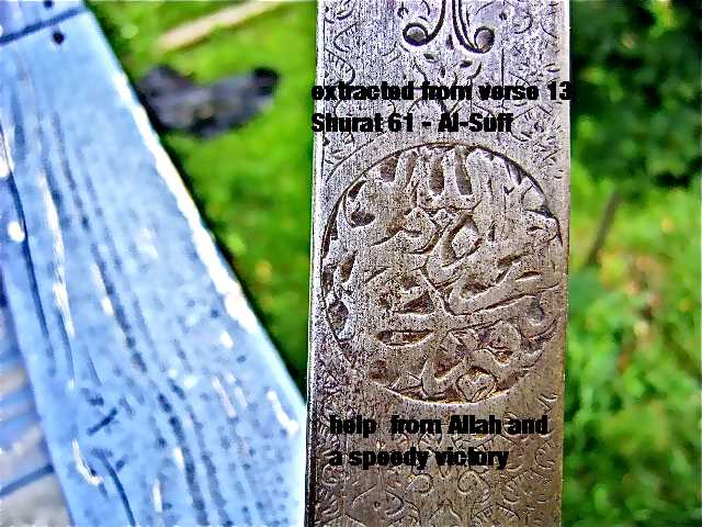

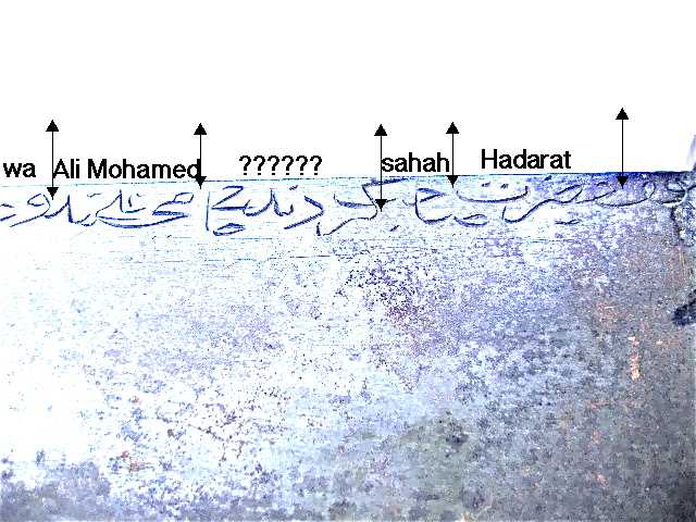

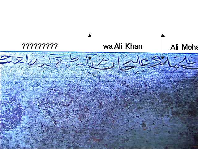

Hi Ariel
here our present for your birthday
just 2 comments;
- the sentence seems to be writting in Turkish, not in Arabic
- we suppose Turkish, coze the beginning of the sentence started by a Turkish title "Hadarat"
- HADARAT - no real translation, Turkish title
- SAHAH - belong to, or , owner
- WA - and
- RASOUL - Messenger, sometime Prophet, but with the name of God (Rasoul Allah)
sorry if it's not more than that
à +
Dom

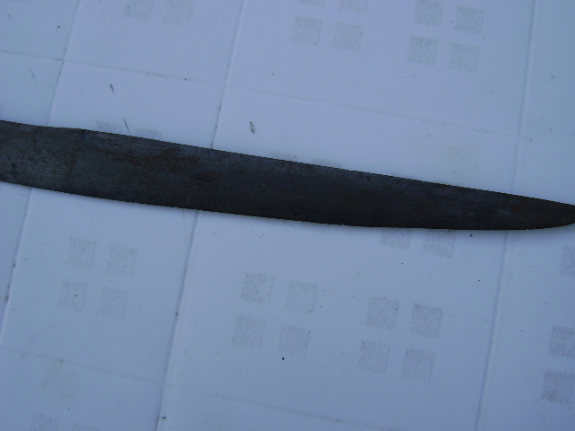

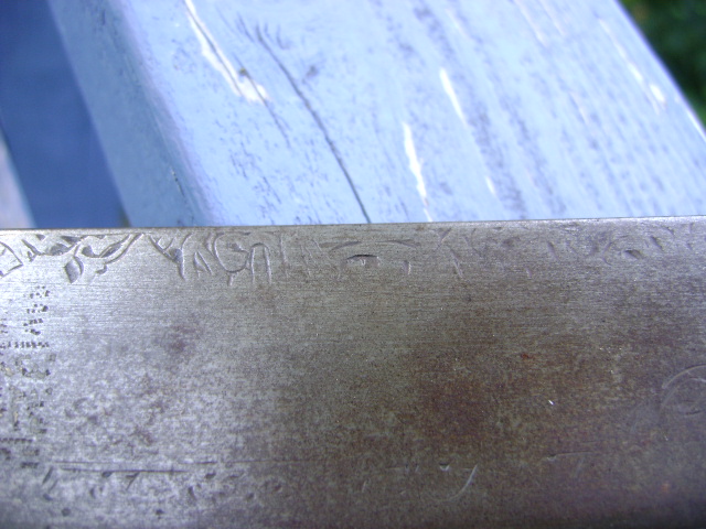

Old 10th October 2009, 09:34 PM   #9

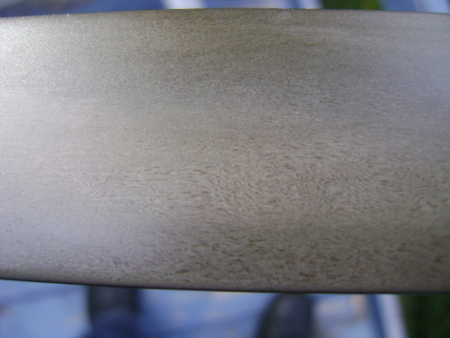

OK, I just etched it. needed to go to UNDILUTED ferric chloride solution from Radio Shack.
It is wootz, but I can see it only in certain small areas. The rest became (very nice) solid dark grey.
Question#1: why only certain areas? Why did it need such a strong solution? Does the etching solution become old ( mine is very old)? Will getting new stuff help?

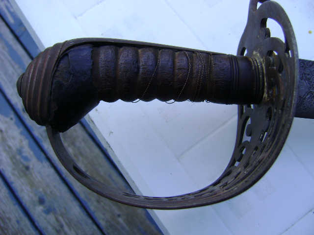

Question #2: obviously, this is a remounted old blade. Some Turk needed a sword ( probably, WWI), and used an ancestral (?) blade.
Should I fit it with a new handle/crossguard? I have a full set for a Syrian ( bedawi) handle and a Persian/Syrian type iron crossguard, likely, what it had at least in it's second incarnation ( before the military monstrosity).
Old 11th October 2009, 10:17 AM   #10
ALEX
ALEX's Avatar
Posts: 936
Ariel,
It is common, especially on older blades with low contrast sham wootz, to see "patches" of wootz. Many reasons - wear, corrosion, re-polishing, heat exposure/experiments/vandalism, original under/over-development, etc. I think it's later, and the heat was not properly controlled when the blade was made, hence wootz was not developed on entire surface. This would also explain the need of strong etchant and the resultant mix of grey-coloured and low-contrast wootz segments.
The FeCl solution will expire, so it's better to discard it after use, and use new solution.
I would re-mount with Ottoman fittings as first choice, and Persian/Syrian as a second.
This is very,very nice blade, Ariel, and especially being wootz!
