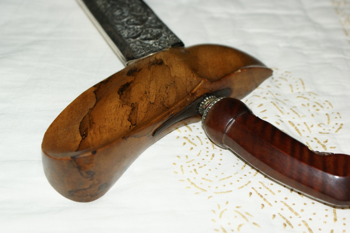

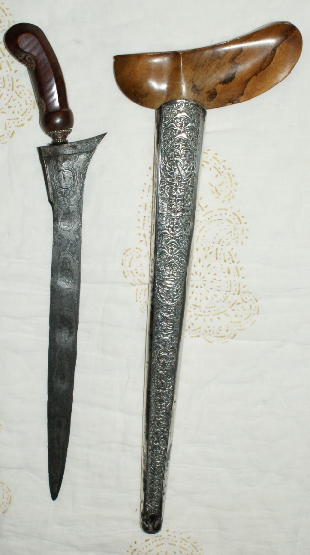

Just want to share my old keris with original mounts with you.
Your comments are very welcome.

very nice keris picit and kul buntet pamor. Also the dress is very adapted. You can show us the pesi?

Very nice picit kebo lajer. For some reason i am very strongly drawn to this type of keris. Perhaps it all the strong talismanic elements. I especially like this one. Nicely done. Would love to see it in good stain. It looks like the hair was used to keep the hilt tight on the pesi. Am i correct?
I am not convinced that we can be sure about "original" fittings. They certainly seem to have age and the wrongko seems to have been made for the blade, but this isn't necessarily the first dress this blade has seen...or it might well be, but i don't think we can ever be sure.

Is it probably gonjo iras? For me an interesting detail is the small ring-shaped figure on the gonjo. The sorsoran looks reshaped in some places.
Is it a proper dress for a talismanic keris? Is it acceptable for shorter Central Java blades to have a normal size sarung?

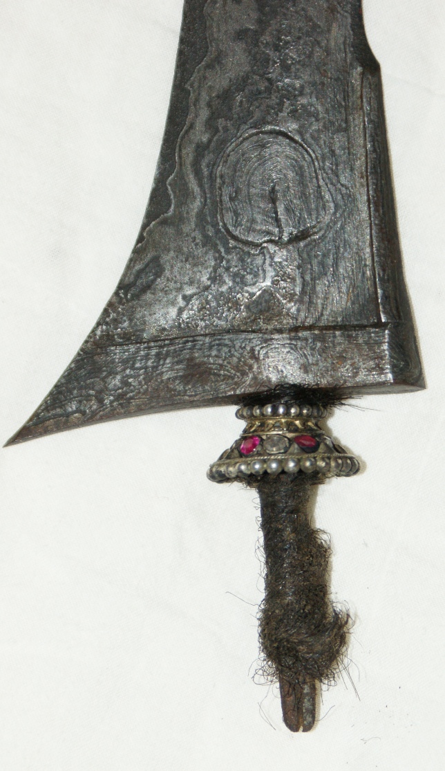

First, I didn’t plan to remove de ukiran. The keris is in the Netherlands for 70 years and nobody has removed anything.
But I removed the handle today. It looks like an old pesi with human hair and this has almost become to dust.

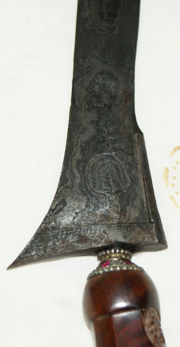

This keris have a separate ganja (not ganja iras).. the pamor does not flow continuously from the blade to the ganja..
The layering technique of the 'kul buntet' inlay looks more like a 'batu lapak' form, rather that the swirls of a kul buntet form..
Old 15th September 2009, 12:41 AM   #7
Posts: 7,230
Actually, we can't call this either kul buntet or batu lapak, it is simply pamor tambal, and my guess is that it has been done well after the time of completion of the blade.

I'm not calling it batu lapak.. I'm just making a comparison on the style of the layering works of the inlay.. If the inlay sat at the base of the blade, then I'll most definitely call it batu lapak.. In this case, pamor tambal is appropriate..
Yes, now by the close up picture I can see it also, pamor tambal.

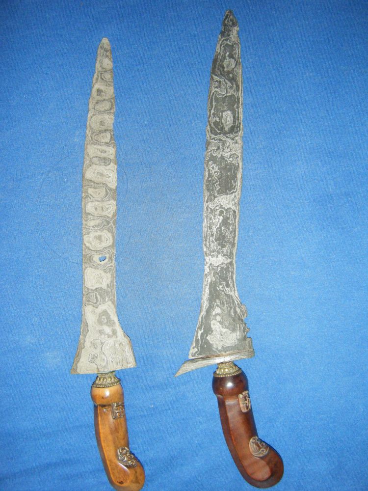

Here are two of my picit keris, the left one with missing ganja and the right one is a keris putut, both blades are very thin.
sajen

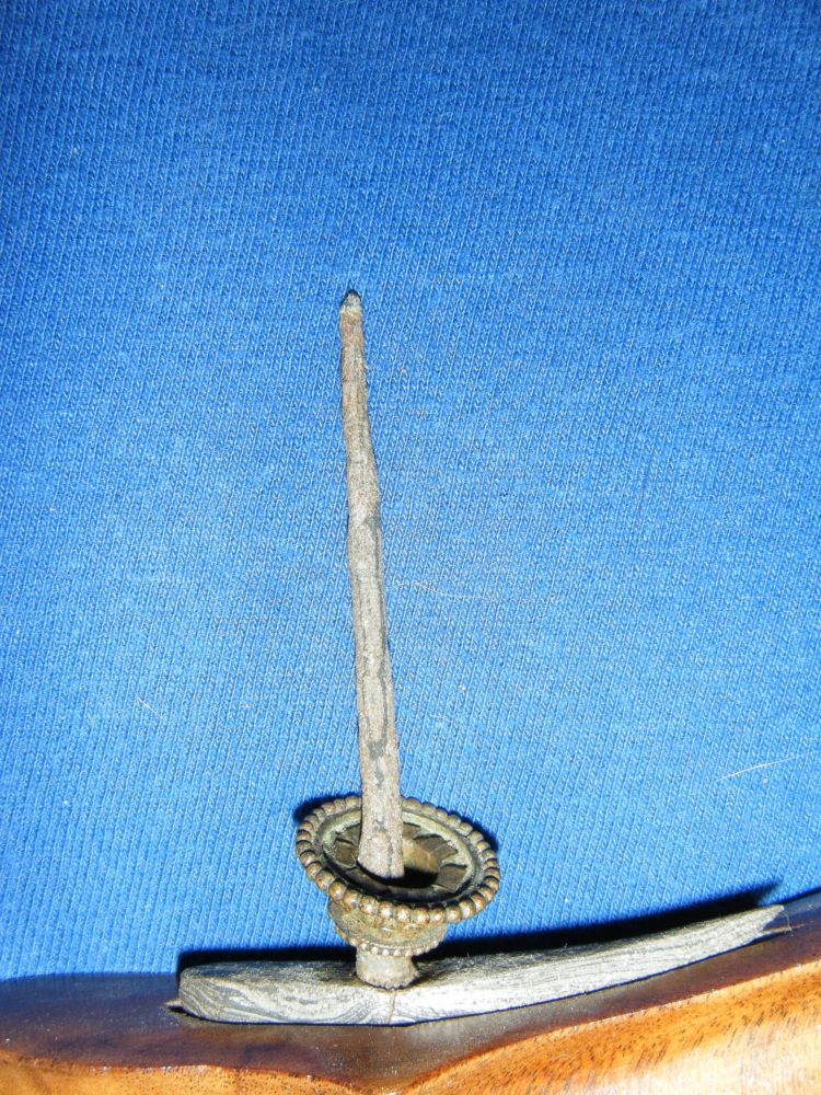

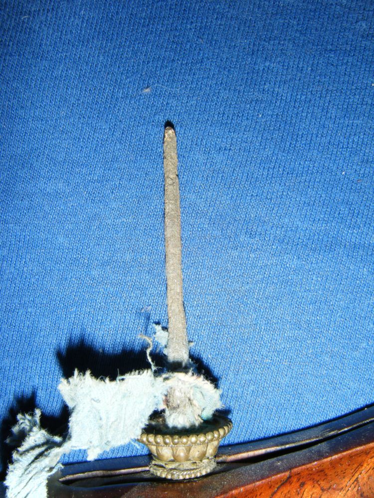

Do you have a picture of the pesi?
Jonno is offline   Reply With Quote
Old 17th September 2009, 05:44 PM   #15
Originally Posted by Jonno
Thank you all for your response.
Sajen,
Thanks for showing your keris. My keris is also very thin.
I just take them, the first picture is from the keris putut, the other from the keris with missing ganja.
