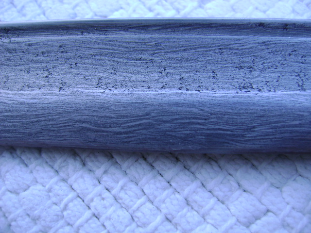

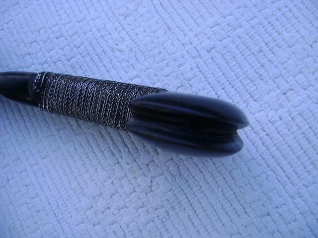

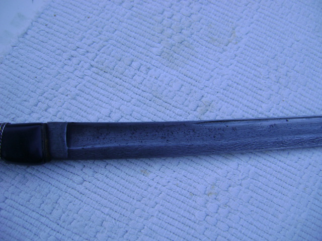

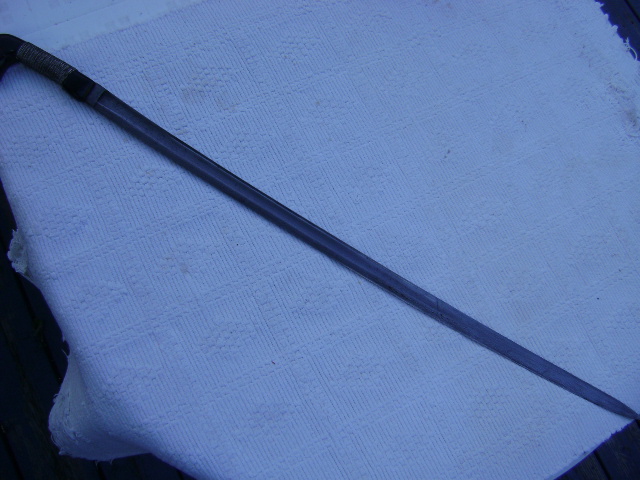

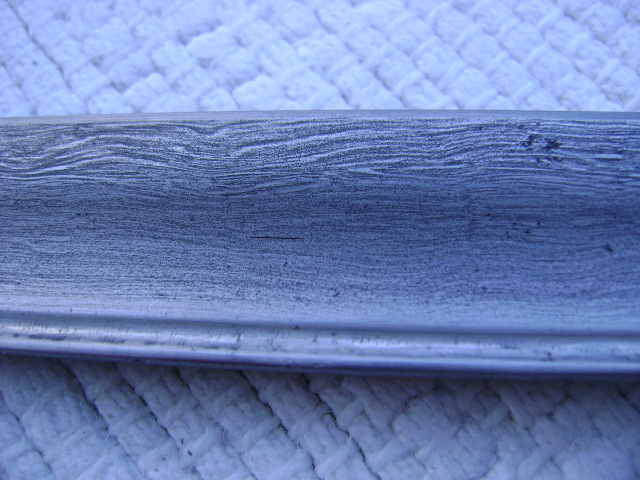

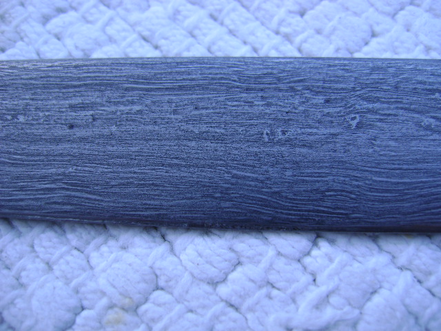

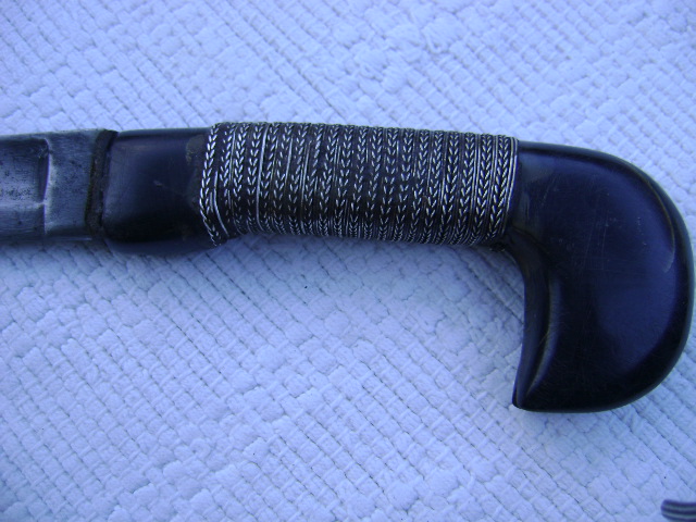

Folks, I need your help, especially the "metallurgists"

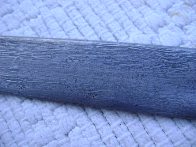

I have a shashka ( no scabbard). The blade is of obviously "European" pattern, but very light and very "bendable" ( returns to true like a lightning). It has no markings. What is interesting here is the blade , and I cannot decide, is it a Sham-type wootz ( bulat) or mechanical damascus. If it is wootz, it would most likely be of Anosov's-era Zlatoust production, a rarity. If mechanical, could anybody suggest the source of such a pattern. Obviously, it is no superficial etching; the pattern is seen thru the blade, spine included. Will be most grateful for opinions. |

#3 |
Yes, indeed. quite reminiscent.
I spoke with Russian collectors: all told me that Anosov's "bulat" was a very, very coarse wootz. That is why I am so confused: will the "very, very coarse" wootz look like that? |

Reminds me of this one: http://www.vikingsword.com/vb/showthread.php?t=8118

Posts: 2,818
Ariel,
I did notice some time back a Karabela hilted Shamshir that had the exact same pattern through the blade...so at a guess I'd say your on the money with this one, incidentally it sold for huge bucks. Gav |

Posts: 1,769
I am not a metallurgist - actually quite the opposite, but I vote - sham wootz. This is probably mostly due to wishful thinking on my part, as I have a kindjal with a similar pattern visible throughout the blade - pictures attached.
Regards, Teodor |

Location: East Coast USA
Posts: 3,191
My vote is sham wootz also

Join Date: Nov 2005
Posts: 189
Nice blades!
Could be shear steel, the 'other' pre-Bessemer way to make steel from iron. Here is a pic of a lightly etched wood chisel made of shear steel, the laminations can be coase or fine depending on the amount of processing. It can look almost exactly like sham wootz
