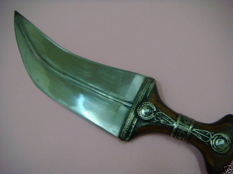

I would like some comment on the construction methods of ribbed Jambiya/Khanjar blades. I notice that a lot of these, particularly later/modern examples originating, particularly from Yemen, are constructed in two pieces, and then fused together in some manner. I personally have always regarded these as "not genuine", but simply a method of easily forging blades to attach to mass produced Jambiya. There are however some modern pieces which do have a solid blade. I have very recently taken a chance on one of these, described as having a "one piece blade", and although I do not regard it as old, it does, at a VERY cheap price, fill a small gap in my collection until I have the serious funds available to replace it with the real thing. I do not yet have it to hand, so can not really comment any further until it arrives. Pics are sellers.
Meanwhile, I would be most interested to hear comments re these two piece blades.
Regards Stuart

The rib on your new purchase is squared which to me seems two pieces pressed together.
Lew
Hi Lew,
I hoped you would reply to this, and thanks for the link to the previous thread. I see that I replied to that one at the time also, and my thoughts/cautions re Yemeni blades was expressed then. I can imagine that in a poor country, cheap methods of manufacture would prevail for the "masses" but I would still like opinions regarding the genuine-ness (if its a correct word) of these sandwich blades. Your comments in the previous thread regarding age is very helpful, and I would like to comment about a much older piece, but the Forum rules do not allow me to do this at the moment.
Sufficient to say that the piece shown in the pic, has according to the seller, a solid blade. I can only assume from that comment, that its is not two piece. When it arrives I will know more, and by then I should be able to make further comment within the rules also.
Thanks also to Michael for his historical input to these different blade making styles. He confirms my suspicion that the two piece construction is much cheaper and easier to make. The fact that these were made as a type for the poorer person, also confirms for me these these are indeed a genuine article, and not just something cheap to lure tourists.
Regards Stuart

I may be able to shead a little light onto the squared rib debate on the jambiya blade. It's my experience that the rib is squared to that the dagger can fit neatly into the scabbard. As the scabbards are made in bulk as a separate process to the making of the dagger, they are not fitted uniquely and are of variable quality. In other words the scabbard is nowadays not uniquely made for each dagger. Some craftsmanship has been lost over the years in this area. So they adjust the rib on the blade by grinding so as to produce a snug fit.
The extension of this process is that a squared rib is usually indicative of a more recent manufacture, or blade replacement, but can apply to a solid as well as a hollow blade.
My observation only,
Steve

The squared rib is the product of the die used in the press and not the result of someone trying to get a better fit in the scabbard. Wood and leather do give so even if the rib was a few microns or a mm off they would fit.
