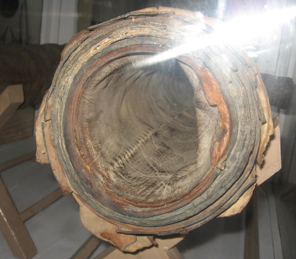

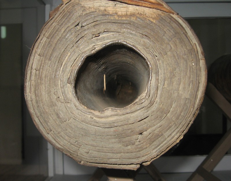

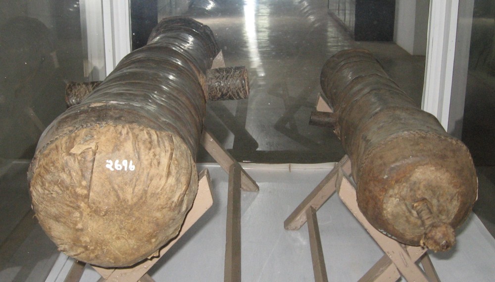

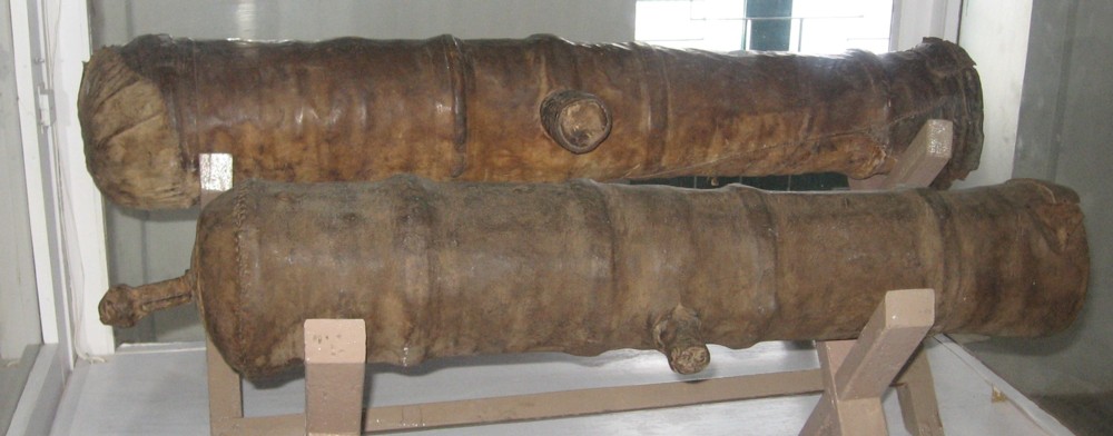

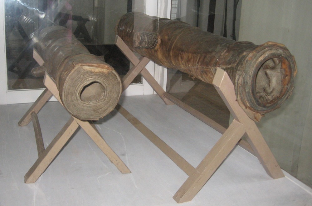

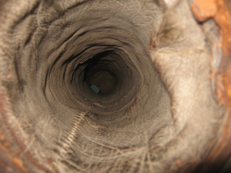

The following are images I obtained, the beginning of this month, at the National Museum in Kathmandu, Nepal. They are called leather cannons. The title is LEATHER - CANNONS SEIZED IN THE FIRST NEPAL - TIBET WAR IN 1792 A.D. They are complete with trunnion and one with a cascabel etc. But see the interior of the cannons. It is all leather, no smooth surface, visible seams and no scorching? Could these be the outer covering of ordnance fired off the back of an animal for example? If so why the trunnion? Apologies for the bad photographs. The conditions were anything but favorable.

I guess what I have added are the images of the interior of the cannon which throw some light - pun intended - on the interior construction. Can the two posts be merged?

Thanks Jim for the great start to this discussion. First to answer your question. The one with the numbers 2696 painted on it has a touchhole for ignition. I have not been able to photograph it. The other I do not recall and my notes throw no light on this. However, even if it was a covering, the opening for the touch hole would still be required; right?
As for pseudo cannon, why would someone have to go to such lengths in preparing it in leather when it could have been done easily with wood or even terracotta for example? Note the neat sutures at the breech of each cannon. Surely such sutures would have given way had an actual charge been ignited?
