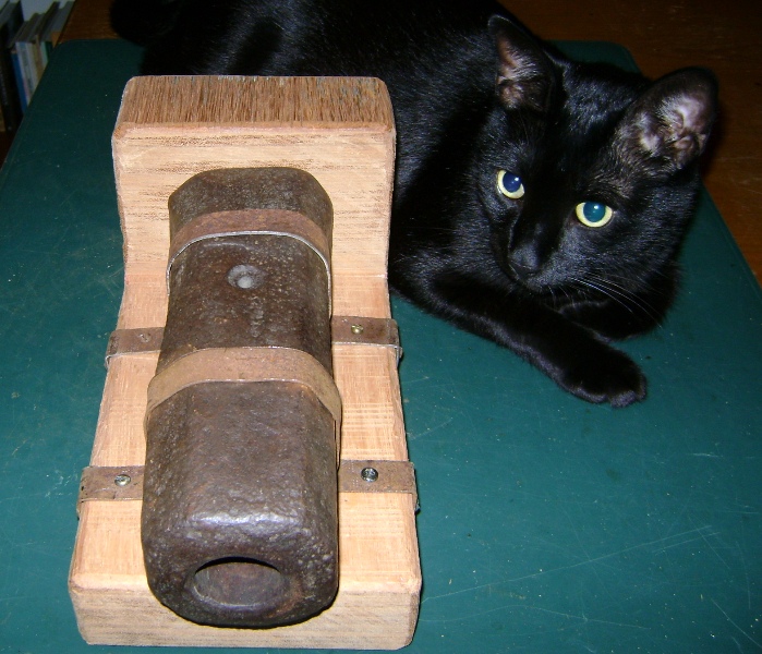

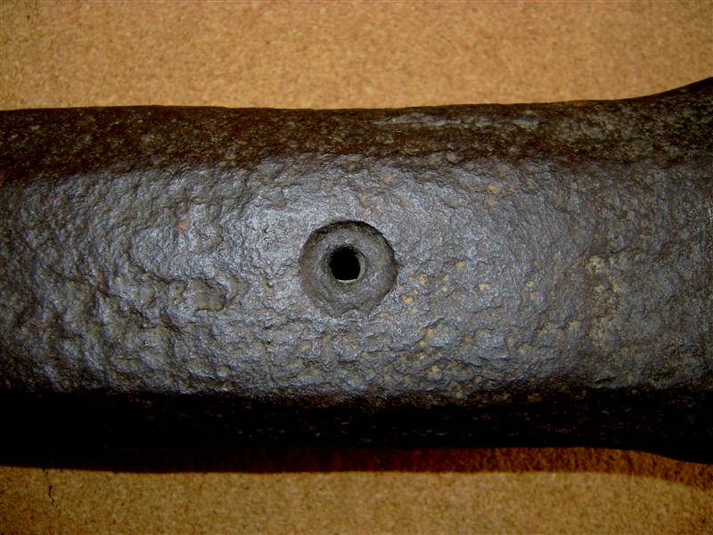

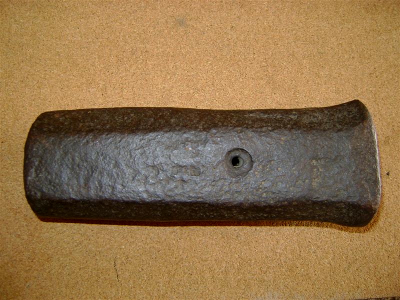

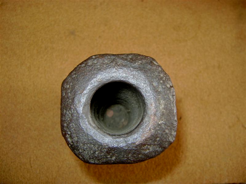

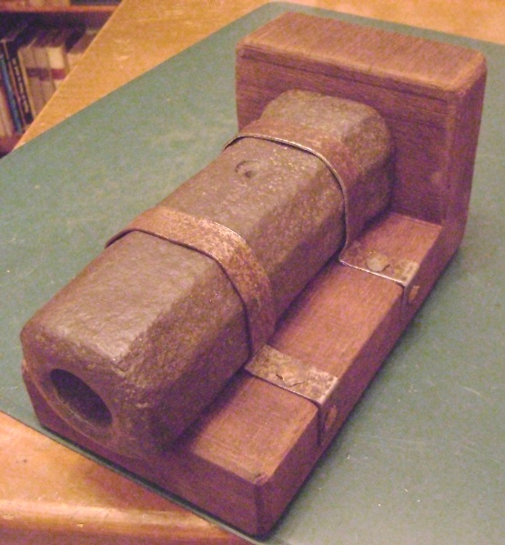

This is really a little beast ... all 7,7 Kgs of it .
I was wondering why the touch hole is so advanced, almost in the middle of the barrel .
Guys, i couldn't believe it. The touch hole in right on the basis of the bore; which means that this cannon a thickness of 8 cms. on its rear.
Perhaps the user was thinking that this piece lasted long enough to be loaded with contemporaneous smokeless powder .
Say Michael, is this a common characteristic in (early) hand cannons?
Its total length is 23 cms. and the caliber aprox. 3 cms.
Meanwhile i am making a rest for it. The wood is afzelia. I will have to decide if i give it some colour, like dye it with vieux chaine.
The screws are provisional; i will replaced them with early handmade rustic nails. I will try and find an old ring to apply in its rear, to simulate a suspension option
Ah, the cat is Adriano; he didn't want to move away .
Fernando

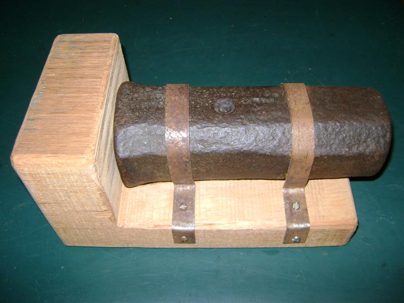

A couple more

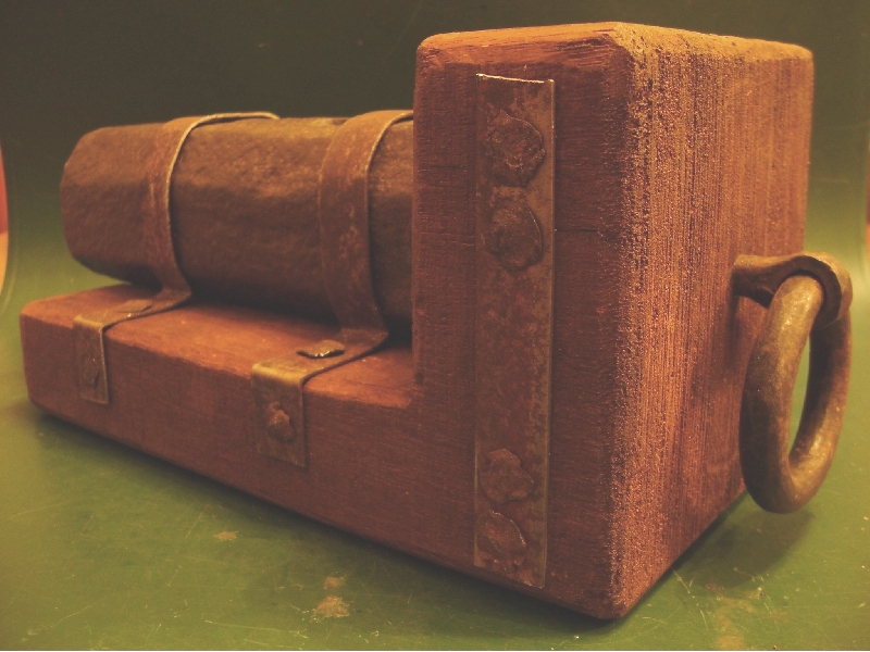

Old 6th August 2009, 11:16 PM   #3

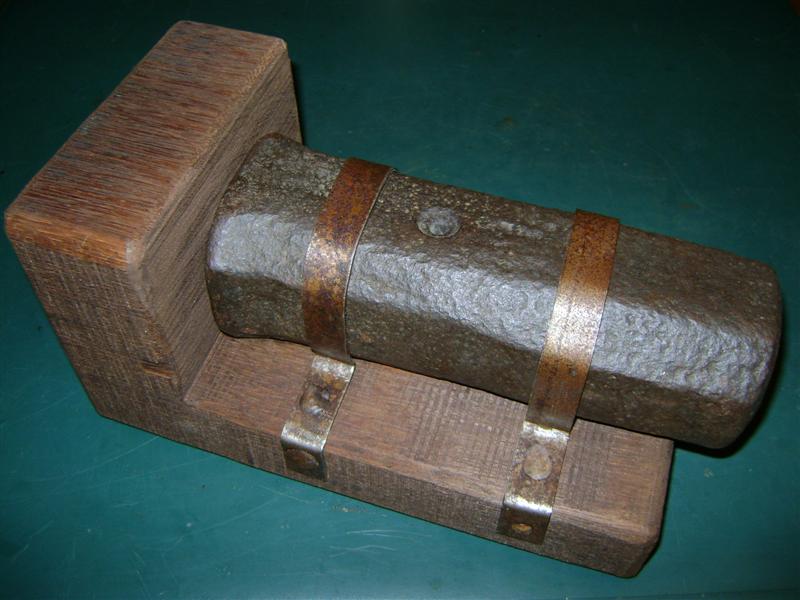

See the difference.
Two coatings vieux chaine infusion, ancient handmade nails ... and no cat
Fernando

Congratulations, Fernando!
A fine acquisition, the patina on the metal is impressive. The recessed touch-hole is interesting, am wondering if it has been "bushed" or lined to reduce its diameter after being eroded after extensive firing. At any rate, the fact that there is a deliberately-made "crater" around it leads me to think that here we have the first steps toward the development of the priming-pan, to make ignition faster and more sure with the slow-match.
As far as the thickness of metal behind the bore, maybe Michael or another forumite who has examined far more European handgonnes than I have can comment. I can only suggest that such a thick breechplug be looked at in light of the rapid evolution of gunpowder technology at the time, and the understanding of chamber pressures must have been limited considering the variability in powder composition and granulation. A bit of "over-engineering" certainly wouldn't hurt!

Concernning the cannon, i see what you mean about the recessed touch-hole and hope that Michael comes around, expecting that he can situate this characteristic in time or and place of origin.
About the possibility of the hole rectification and bushing i can't figure it out by myself, as age dust and patina would 'disguise' any possible marks of a seam.

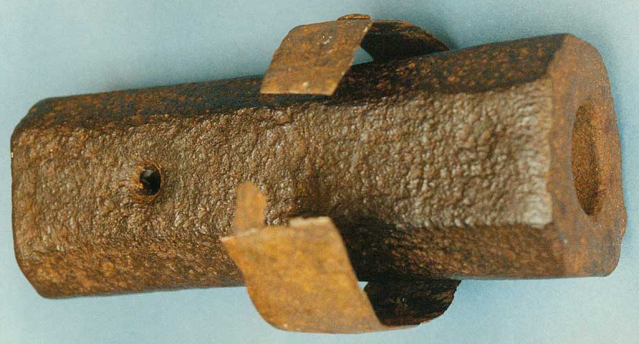

Hi Fernando, my friend,
You really deserve being congratulated on this fine, rare and early piece which can doubtlessly be dated as early as ca. 1400!

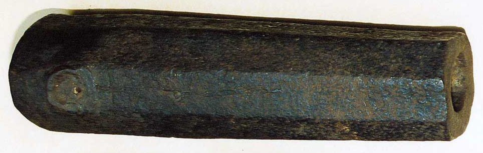

I attach photos of two handgonnes from my collection which you certainly remember. The smaller of them, ca. 1380-1400, retains one of its originally two iron bands to fix it on the (missing) stock. Just like on your piece, the octagonal barrel shows a broad flat next to a narrower one alternatingly - a very early feature, together with the touch hole being situated quite a bit forward of the rear end. On my piece, the touch hole is 4 cm from the rear, which is about the same relation as my barrel is only 13.8 cm long.
The touch hole of the larger barrel, made in ca. 1460-80, is 6.3 cm from the rear end and has a bulged pan like area around it.
As the touch hole on your beautiful barrel is surrounded by a finely polished and well centered pan moulding which is not by far as heavily corroded as the surroundings, and which is too early for the time your barrel was made, I think that it is a working time amendment of ca. 1450-60 when such pan mouldings first arise.
Well done, my friend! I think your path to early hand cannon has led you far back to their origins already!

Herewith a (lousy) picture of the cannon rest, in a (provisional) final status. I have added one carrying/suspension ring and side reinforcements.
This rest setup was idealized after considering the rest of your Nischengeschütz, the replica of the Loshult cannon in the Crecy museum and the bombard shown by Cornelistromp at the Chateau de Castelnaud.
Maybe it has nothing to do with any of them, but that's where i got the "inspiration".

Hi Fernando,
I have to congratulate you on the very beautiful stand you made for your High Gothic barrel! All aspects considered, it conveys a good impression of how the complete piece may have looked like some 600 years ago - imagine!
Also, your gift of close oberservation has to be praised: the proportions of the iron bands as well as of the rear iron ring look very convincing to me.
