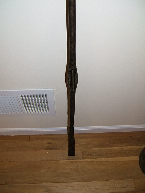

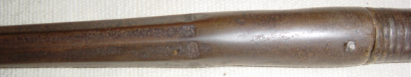

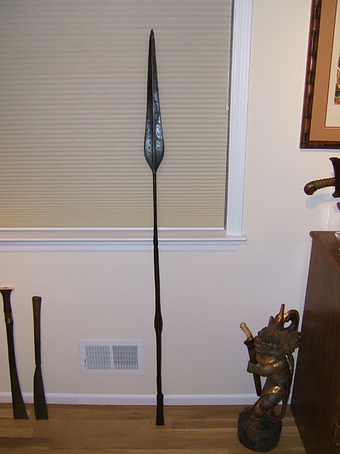

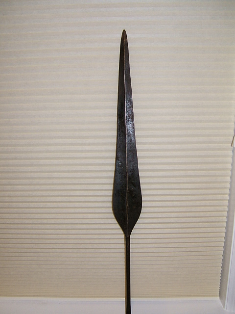

This is the other item I picked up this week. A nice example of Ngbandi spear?
It seems a bit short to me even though it measures 68" long is it possible that it was shortened at some point in it's life? Let me know what you think.

Lew,
That spear looks absolutely fine to me, a close up of the end would be helpful. From what we see at the moment it is a really great spear ,super find. Tim+Sam

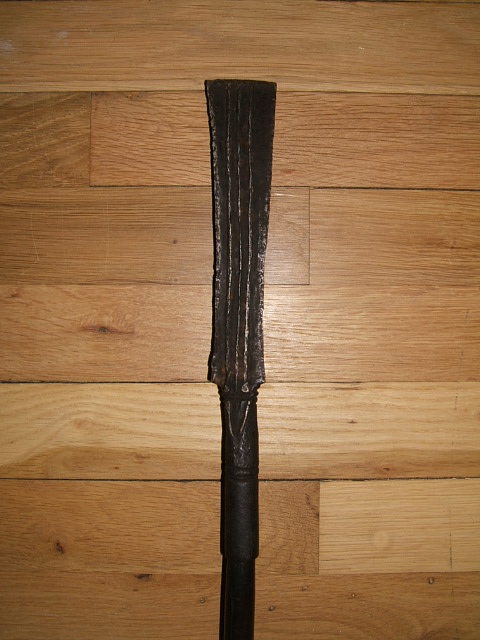

You are quite right : a Ngbandi spear. There's nothing wrong with the length of your spear. I have a similar one which measures about 63 inches (157,5 cm).
Don't forget these were weapons for close combat, stabbing spears. The long blades of Ngbandi spears were used for thrusting through the shield of the opponent.
I see some nice carving on the handle.
The metal 'shovel-type' butt is not typical, but spear blades were traded all over Central Africa. It's possible that the owner preferred that type of butt end to the more conventional one. Nothing wrong with that either.

Nothing wrong with that butt, just another type.
Here are some pics of different spear butts from the Congo area
Typical spear butt found on Ngbandi spears, but also used by the following tribes : Bati, Benge, Poto, Ngombe and Gens d'Eau. Mostly made of iron and rather heavy. To counter balance the weight of the big spear blade. (Length : 8 cm)
Top to bottom :
Bell as found on spears coming from the Mongo-tribes (Length : 29 cm, width : 10 cm)
Long iron spike, Ngbandi spear. (Length : 55 cm)
Three smaller spears (top to bottom)
From the Nkundu, Lia or Konda-tribes, made from copper. (Length : 8 cm)
End of an light spear, tribe unknown (Length : 8,5 cm)
Butt end of a small spear from the Bana-pygmees, Aruwimi-area (Congo)(Length : 19,5 cm)
Two butt ends of thrusting spears (top to bottom)
Used by following tribes : Ngbaka, Ngombe, Doko. The butt end is wrapped with iron banding. (Length : 19 cm)
Atypical spear butt from an unknown tribe (Congo-area). Looks like a spear head, but is not sharpened. (Length : 19,5 cm)
I have to measurements to give you an idea, this doesn't mean the butt ends are always exactly this size. These can vary quite considerably.
