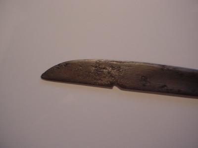

I can't believe this one hasn't been solved yet. I still believe it has a utilitarian purpose rather then a gory one. Last time this came up it got me looking at some of my blades, and I found this 'dent' on one of my British 1796. To my eye it may have had a similar purpose?

Typically we think of nicks and notches at the back of a sword blade as combat related, but on your M1796, again the notch is seemingly deliberately placed, not random as if from accidental damage.

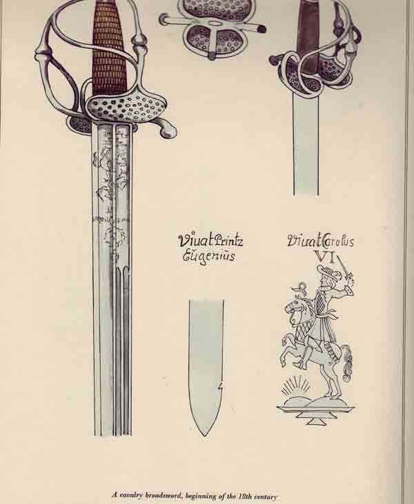

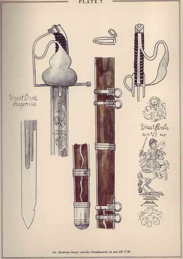

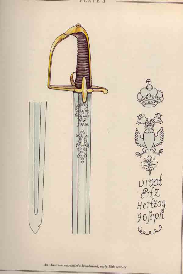

The dent on my 1796 would catch a small rope or string but not much more. Here are some scans from Wagner, the illustrated notches aren't much bigger than my dent. The mystery lives on.
All the Best
Jeff
