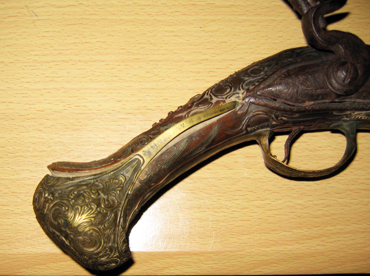

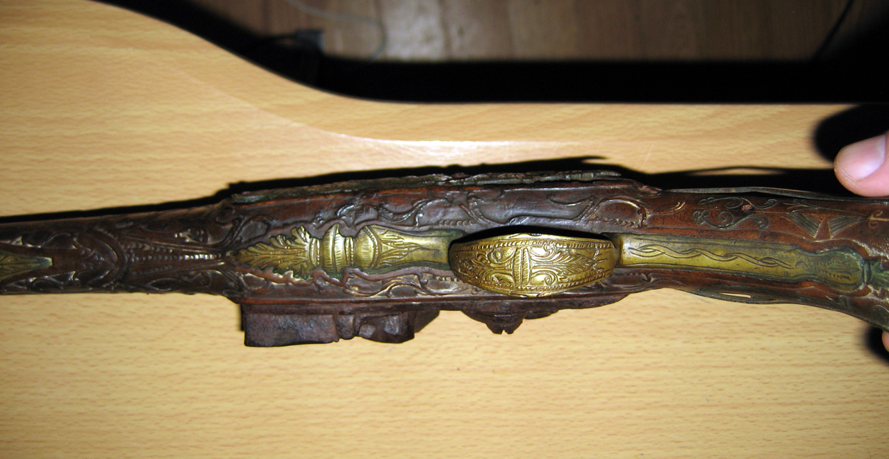

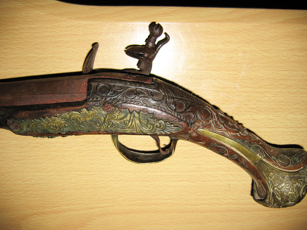

Hello all! I've recently inherited this flintlock pistol and would love if you could help me identify it. It seems to me that it bears a strong resemblance to this gun http://www.vikingsword.com/ubb/Forum1/HTML/002066.html but my barrel is much less engraved though the stock is very nicely carved and adorned with brass wire inlays. The lock very rusty and still moves a bit but is stuck in the full cock position. The barrrel, as you can see is coated with rust and after removing it I can see that it was not browned or blued. The butt piece is missing it's main "screw" or whatever you call it and the lock plate bolt heads are mostly rusted away.
It's pretty neat though and would love to know more about it. Any help you can provide would be greatly appreciated!

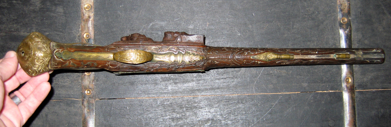

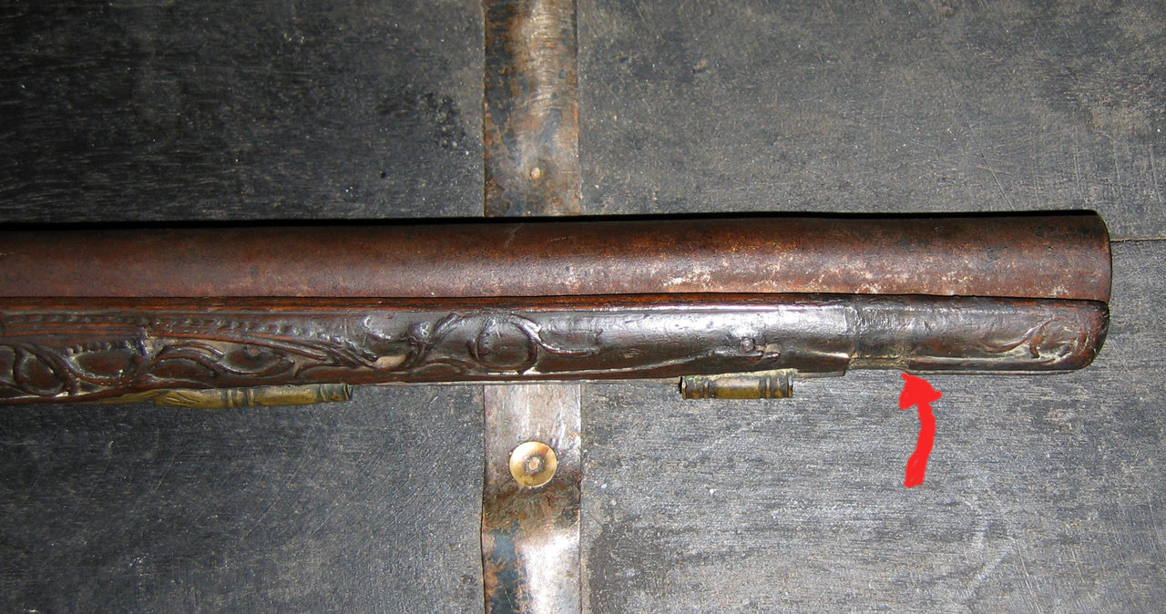

P.S. One of the photos shows the stock and barrel near the muzzle where there used to be a band. Any clue where to find the missing parts for a piece like this?

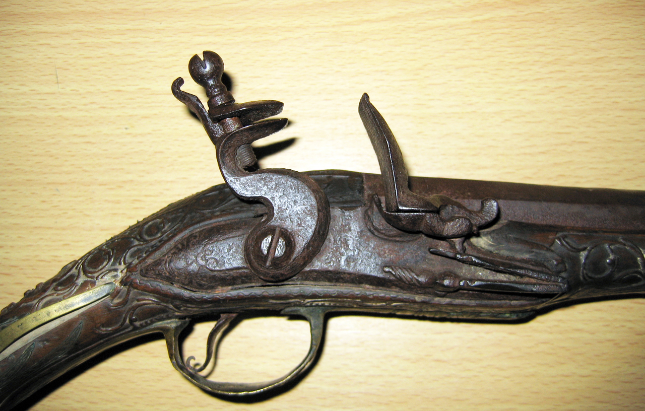

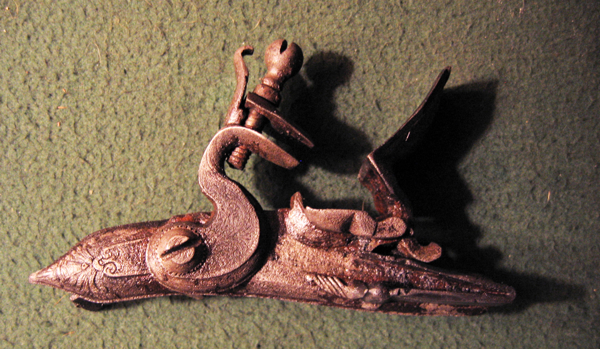

Check if it has a patent vent in the inner aspect of the pan.
Does the hammer's screw move a if you try to unscrew it, or is it fixed/soldered?
Normally, the end of Hammer screws in the 18th C were pointy, if it is flat, it's a bad sign.

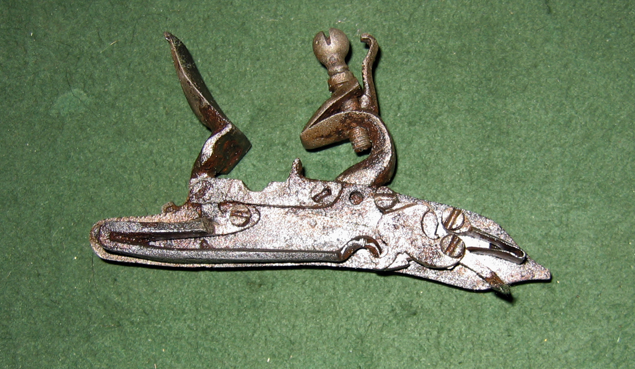

Usually, there are screws that go through the outer face of the lock, and engage the plate on the opposite side. The screw positions in yours do not seem to correspond in this manner.
Does it have any poincons, words, signs inscribed on the barrel?
There were fake guns made for decoration purposes during Victorian times, these had a very weak action spring, and couldn't fire. The wood work was rather elaborate.
If I were you, I would disarm the lock and check if the inner workings correspond to the Real McCoy.
G'luck!
M

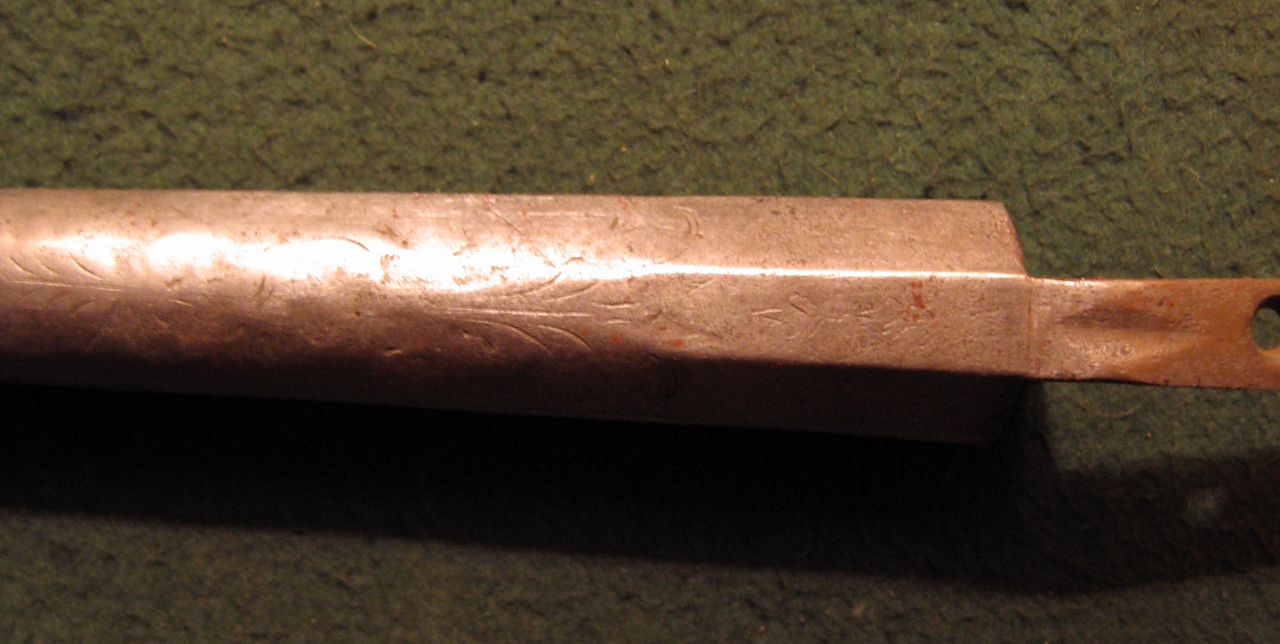

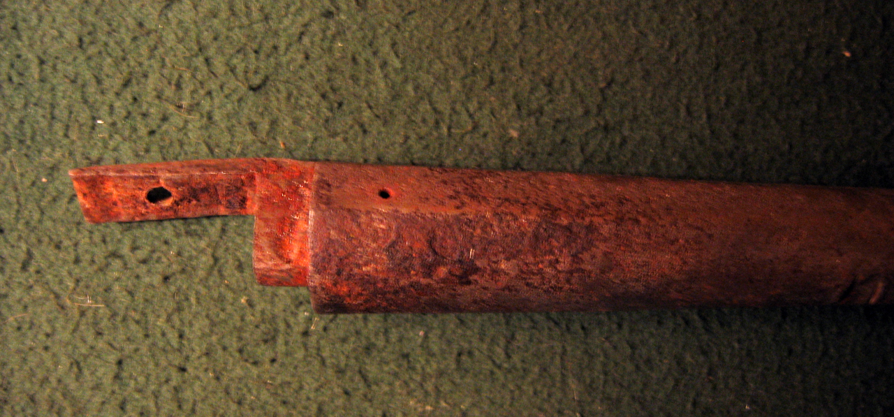

Not sure what you mean by a "patent vent" Celtan? (see attached pic of the barrel to see if the vent inlet looks legit) But in an answer to your other questions:
"Does the hammer's screw move a if you try to unscrew it, or is it fixed/soldered?" = Yes the hammer's screw moves and I can unscrew it.
"Usually, there are screws that go through the outer face of the lock, and engage the plate on the opposite side. The screw positions in yours do not seem to correspond in this manner." = I agree with you that many lock plates have screw ends that go out the exterior of the plate - but I have seen many that don't as well.
"Does it have any poincons, words, signs inscribed on the barrel?" = There are some faint inscribed patterns on the barrel, no makers marks or words - and I'm not quite sure what a poincon is... but I'm attaching an image that will show what is on the barrel.
"If I were you, I would disarm the lock and check if the inner workings correspond to the Real McCoy." = I have dismantled the weapon and I will ask you and the other forum memnbers to help me in ascertaining if it is the "real McCoy" or not.

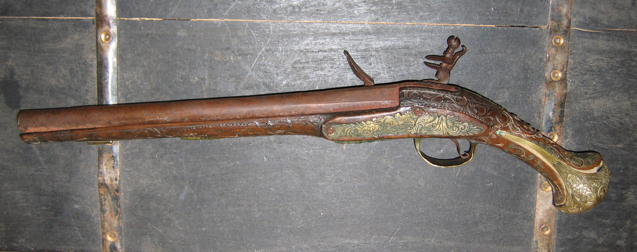

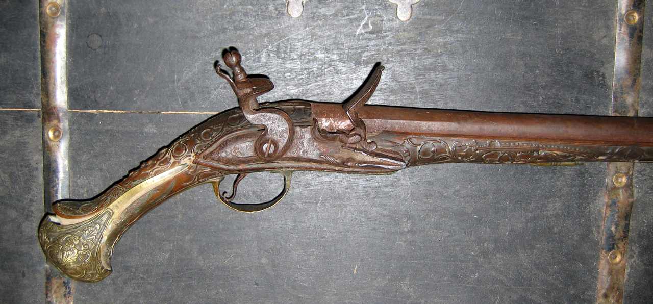

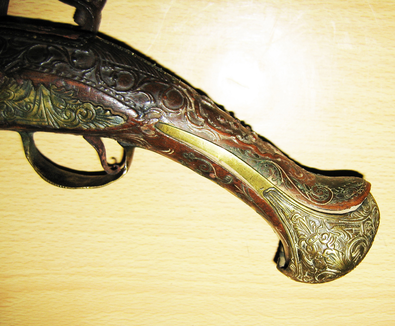

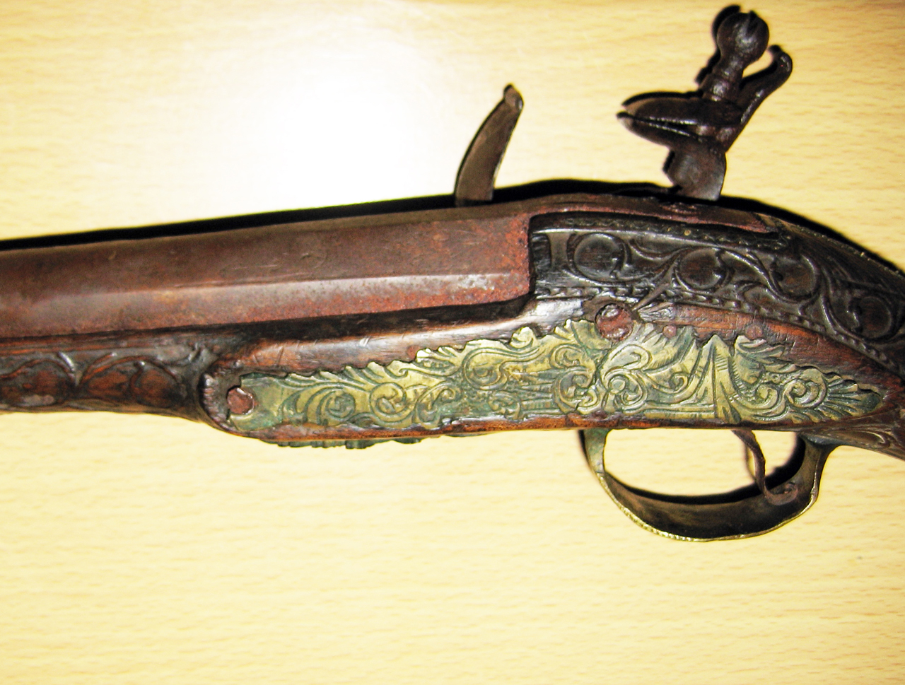

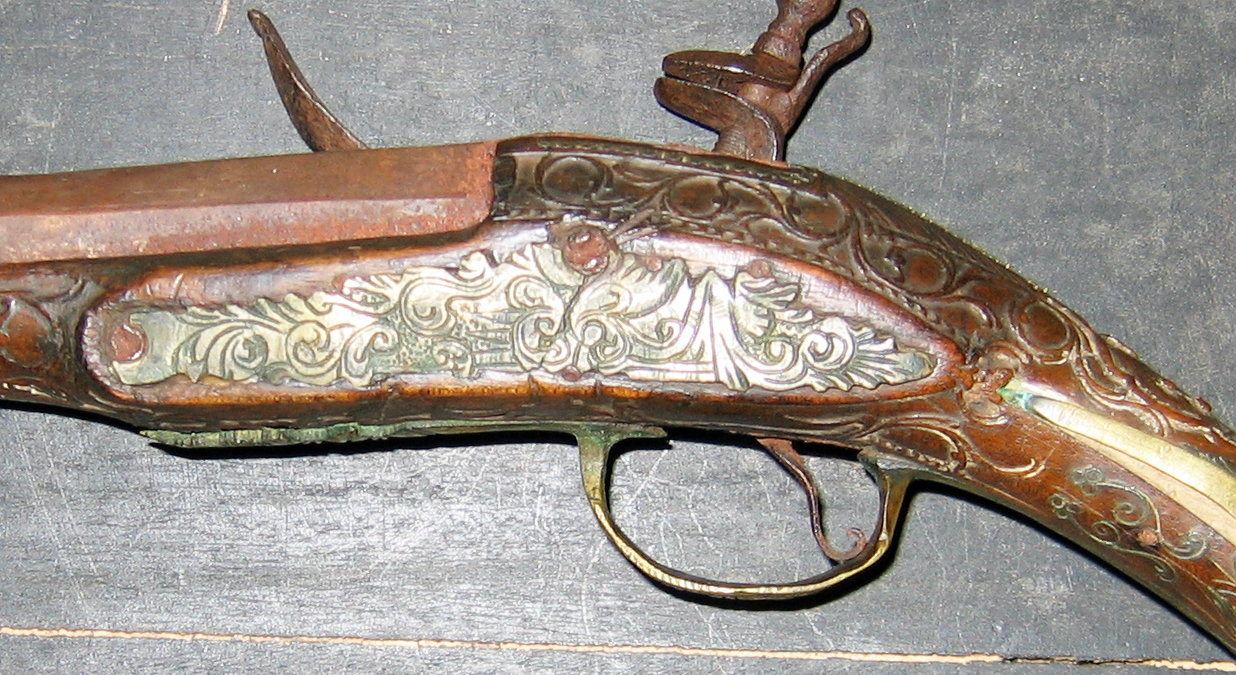

In my opinion this IS the real thing and likely Belgian made for the eastern market. There appears to be a round circle on the barrel just forward of the stock wood. Although not clear this COULD be a Liege Proof Mark. If you can clean it up a bit it may become a little clearer.
These were made up until quite late (for flintlock) and some even VERY early 20th century. The reason for the late use of muzzleloader, and particularly flint, was that cartridges and percussion caps in eastern countries could be relativly hard to find, but powder and projectiles of all sorts were not. Hence the much later use of muzzleloaders.
Regards Stuart

I agree it looks real. My initial thoughts were Balkan/Turkish.
What a great restoration project for the coming winter!
Betweeen now and then get yourself all the little tools you'll need to remake some screws and bits.

Everything looks legit. The type of lock suggests an european maker, although it is unusually decorated.
"Patent" means that it goes all the way through from pan to chamber. Poincons are the armourer's marks, hammered in the metal with dies.
Congrats! Nice acquisition.

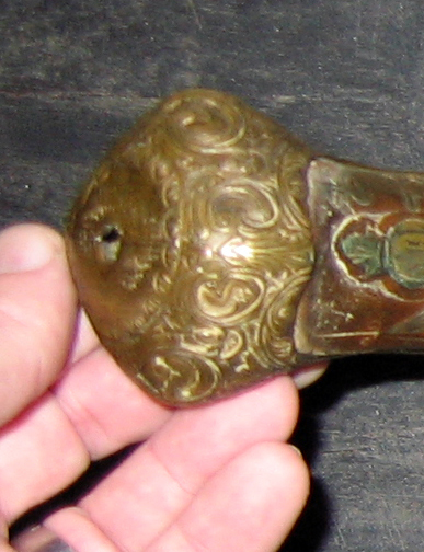

Any thoughts on how to clean the stock? It has quite a bit of inlaid wire (probably brass but could be silver - it's so patinated that I can't tell yet) and also bits of wire inserted almost like tiny, headless nails, in patterns along the inlaid wire.

An ultrasonic tgoothbrush, like Braun or Oracare, plus Windex. The wood can then be taken care of with Orange Oil.
Don't polish any brass! If there's active "red" rust, you may take care of it with a very fine sandpaper or wire-mesh sponge.
Once the rust is inactivated, clean away the oil from the metal, and polish with restorer's wax, or even plain Car Wax.

This stock looks OK to me with maybe a little dirt against the carved bits. I would be inclined to give it a rub over with some raw linseed oil and see how it looks after that. Linseed oil was what was used on those really nice English gunstocks you see around, and was rubbed by hand. If you find that you would like to enhance the silver inlays, then give it a VERY LIGHT rub over with FINE "Steelo" (not the soap variety) before oiling it.
Where the barrel and lock lay, you will need to remove any rust residue also.
As you have the pistol in bits I would suggest the pineapple juice bath to clear the rust. By the look of the metal parts this may take you some considerable time, but it WILL work.
ALSO MAKE SURE THAT THERE IS NOT A CHARGE DOWN THE BARREL!

The pineapple juice will take quite a time but be patient. It will be worth it in the end. Process is to let it soak for a few days and use (maybe household Scotchbrite--that green abrasive cloth) to remove loosened rust. Keep repeating the process until most of the surface rust is gone, and then use fine Steelo once the metal surface is revealed. You will also need to refresh the pineapple juice frequently. You will end up with a greyish surface on the metal but this is easily removed with a light rubbing with Steelo. The process will not damage the surface.
As far as part replacement is concerned, my policy has always been to use what you have, but obviously if parts are broken or missing then they will have to be mended/replaced. If you have a local friendly gunsmith, he may have boxes of old gunscrews which could just suit your needs.
In my opinion the missing barrel band would be brass, but get the colour right when you chose the piece. Brass DOES vary in colour. Check out books to get an idea of what it should look like. As far as the finial goes, I would glue it in place and put a suitable brass plug in the hole. PM or email me if you like with any other questions.
