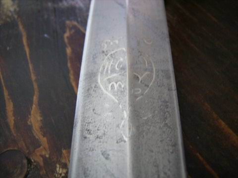

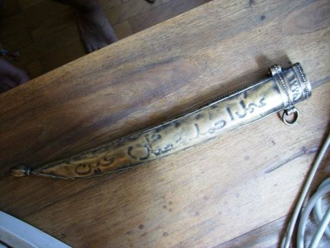

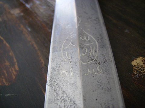

I have a huge plea to the members of this forum, who can read Arabic for a translation, which is most likely from Turkish. A friend of mine in Bulgaria recently acquired this dagger, and is wondering if someone can read the inscriptions on the blade and on the scabbard.
Thank you very much in advance,
Teodor
Old 22nd July 2009, 09:11 PM   #2
TVV
TVV's Avatar
Location: Bay Area
Posts: 1,769
Please disregard the scabbard, which is obviously newly made.
Thank you,
Teodor

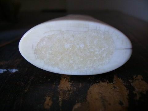

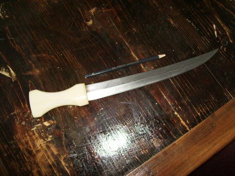

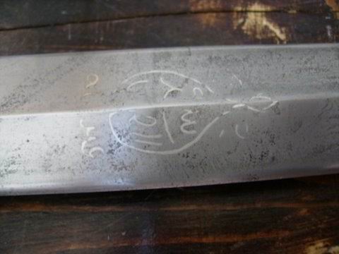

Here are some more pictures - hoepfully someone can read the inscription or at least let me know that it is illegible.
Also, would anyone venture a guess on origin? Mine is Ottoman, 18th century.
Thank you,
Teodor

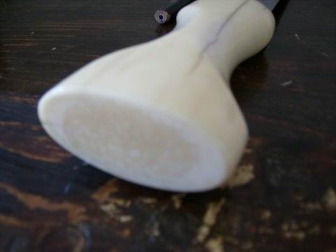

Old 1st August 2009, 11:18 PM   #5
TVV
TVV's Avatar
Location: Bay Area
Posts: 1,769
Thank you very much Jeff,
My Ottoman attribution was based on the hilt, made of one piece of walrus ivory, and overzealously cleaned. This of course does not mean that the blade could not be Indian.
My friend tried to do a light etch, but apaprently there was no clear pattern, although I am assuming he has not given up just yet. I did not think of the possibility that the blade may be imported into the Ottoman Empire.
Again, thank you very much for your reply.
Teodor

Old 15th August 2009, 04:55 PM   #7
Dom
Dom's Avatar
Join Date: Oct 2005
Posts: 1,142
Originally Posted by Jeff D
Hi Teodor,
While waiting for the definitive answer, my guess is that it is a Indian version of Asad Allaha Isfahan.
All the best
Jeff
Hi
the general aspect, and indeed the inlay looks "Indian",
but the mentions are in arabic,
on the blade
- in the "cartouche" at right, the Holy name of God "Allah"
- in the "cartouche" at left, the Holy name of the last Prophet "Mohamed"
- under the cartouche, the name of "Abdallah" (may be owner name ?)
on the scabbard;
"Amal Ahmed ???? Hussein"
"Made by Ahmed ???? Hussein"
due to all arabic mentions, doubtful that could be Ottoman, even Persian
dagger
à +
Dom

Dom,
Thank you very much! The scabbard is almost brand new, made a knifesmith in Bulgaria, who copied from somwhere - we can not use it for identification.
It seems that the general consensus is that the blade is Indian, with an Ottoman hilt. When it comes to names, such as Allah, Mohammed and Abdallah, is there a difference in the way they are written in Arabic, Turkish or Persian, or are they written in the same manner in all these labguages?
Teodor
