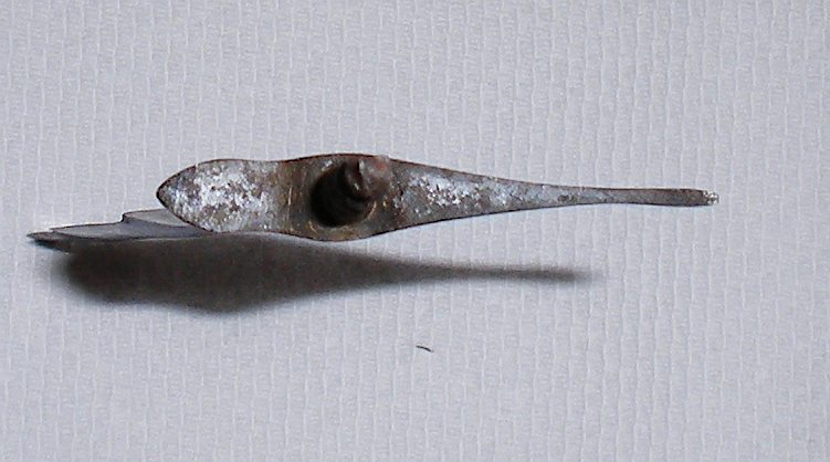

Smile Day To Night
Before and after .
Thanks to a fellow forumite .

Before and after it is stained? Would you please tell me the process? Stained with Chinese warangan?

Ganjawulung, the chemical arsenic trioxide was used instead of realgar .
I think the rest of the process would be better explained by the person who stained the blade .

Very soft finishing, not too contrast as arsenic-warangan staining. I think it is more suitable for such old blade -- not too contrast. But I'm still guessing on the blade, whether it might have ganja or not... An iras?
GANJAWULUNG
Old 23rd July 2009, 05:17 PM   #10
Posts: 6,442
Yes, it is an Iras .
The blade is 15 3/4 inches long .
Pesi is 3 inches .
The Width at ganja is 3 inches also .
Note the top view in post #8 .
I'm impressed by the pamor control .
The blade also has a nice song .

I am afraid i am the guilty party when it comes to the staining of this blade. Frankly i was a little disappointed by my results, but didn't have the time to have another go at it. I am glad Rick is satisfied for the moment at least.
Yes, this is done with lab grade arsenic trioxide. The application is with a soft toothbrush in a method specified elsewhere in this forum by Alan Maisey.

I am no expert, but having had this blade in hand i think i would lean towards a Lombok origin. It is certainly a gonjo iras blade. I look foward to seeing it dressed.
