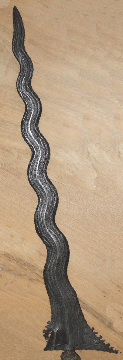

I am looking for more info on this keris. It has very distinct greneng.
Based on this greneng I have heard two stories - unfortunately very different ones....
Story one was - this is very typical for early Sumenep kerisses
Story two was - this is very typical - signature like for an Empu called Tandju Bari - supposedly early 19th century eastern Java.
This keris is one of my personal favorites in my small collection - would like to hear more opinions!

and the full blade

No ideas about the background of this blade?
Old 16th July 2009, 01:15 AM   #7
Posts: 7,230
In my opinion this is an old Madura blade.

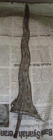

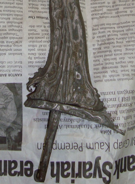

I have taken the liberty of putting this blade into an orientation that permits me to form an opinion.
Note the way the gandik tends to lean towards the centre of the blade; this is in most cases a characteristic of old Madura blades. Combined with the forward lean of the blade,and the type of pamor that has been used, as well as the form of the greneng, I would be comfortable with a classification of old Madura.

Originally Posted by erikscollectables
and the full blade
Hi Eric, I really like your keris. I have to say this keris has a very fascinating shape. the greneng and jenggot are still in a good shape. wonderful keris it is. I bet it has a thick blade couse I can see the odo-odo on it.
the odo-odo runs from the sor-soran to the pucukan ( the tip of the keris).
the pamor on its edge seem floating run along with the luks and bordering the sogokan.

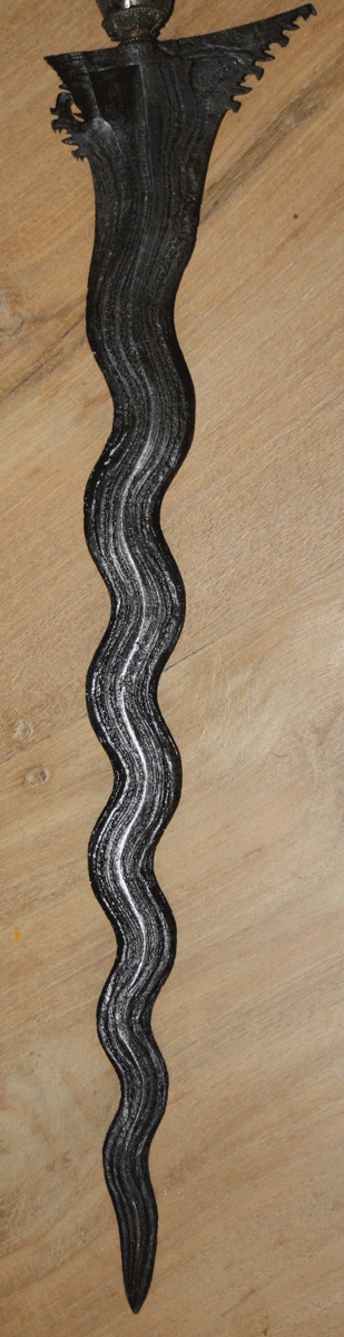

a few days ago I saw a madura keris with 7 luks which also has thick blade, thick pamor and has odo-odo on it. We can see the tippical style of the gandik, the kembang kacang and hoe the first luk run from the gandik toward the middle of the keris.I manage to take the photograph before it has the warangan. here it is. the blade has 37,5 cm lenght
ferrylaki is offline   Reply With Quote
Old 16th July 2009, 03:28 AM   #9
Posts: 7,298
Erik, i really like this one. Just beautiful!
