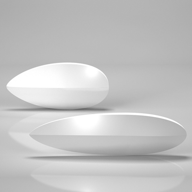

Good points on the metal glasses. The answer is, I'm not sure where they are in development, and given the way stressed silicon glass works (as described), I wouldn't be surprised if there are similar problems with metal glass. I think some knife makers were experimenting with them, but they're out of my price range.
I absolutely agree about the problem of blade weight. I have a ceramic paring knife, and it sits there, mostly unused. It's ridiculously sharp, of course, but it's also about as light as a plastic knife, and the blade chips if it hits bone. The light weight means that it's actually more work to cut with it (no mass to work with) and the ceramic chips if it hits bone the wrong way. I do have a diamond hone that can resharpen it, but basically, it's less useful than the first-generation ginsu knife that I inherited from my grandmother, although it cost ~100x more.
The variable knife suffers from this problem. You have the edge, but you've got to lever the darn thing. Slice whips (the generic cyberpunk name for monomolecular wires with no support) have the same problem of no weight behind the edge, and you've got to be really, really careful that you don't garrote yourself when you're swinging one.
Anyway, I'll leave you with a retro-futuristic knife, made from modern materials in a paleolithic shape. That's right, it's a handaxe made from modern ceramics. Gotta love those designers (Link). Anybody want to try it?
