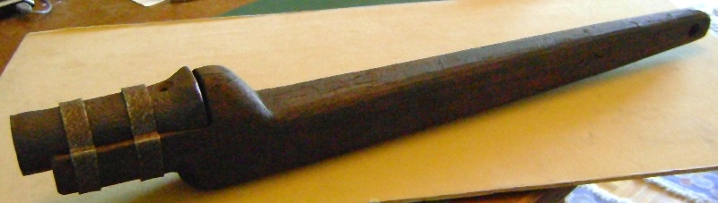

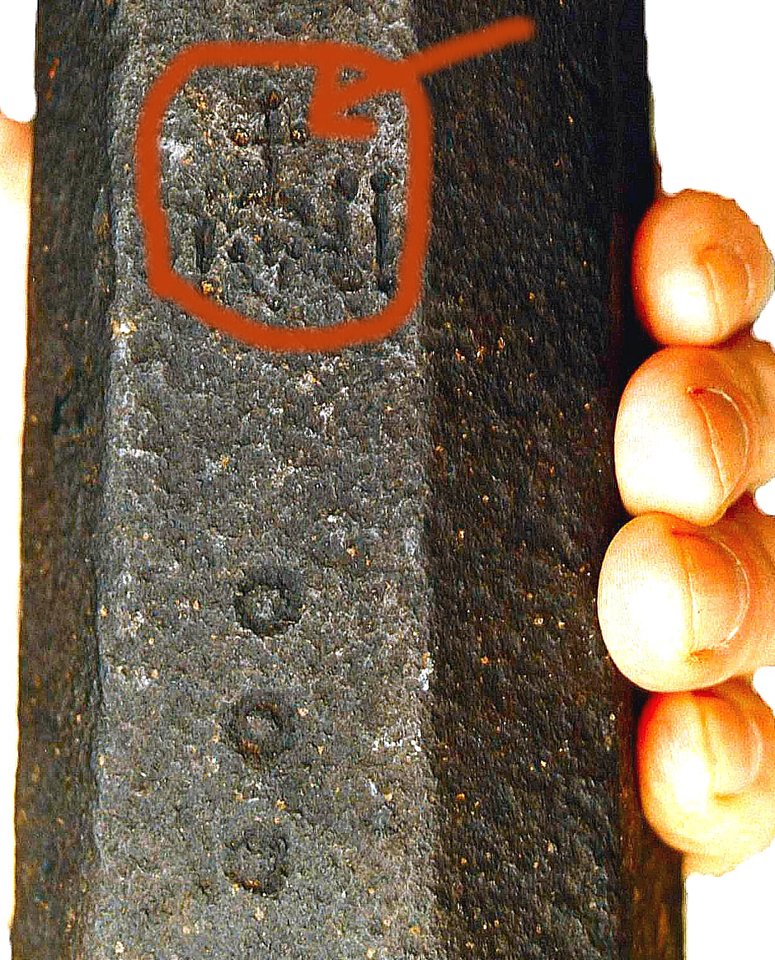

I assume i am not (yet) a cannon maniac, but rumours run out there in a way that a distinct member of this Forum spotted this fascinating example in a (Spanish) website and engaged in the whole process to acquire it and forward it to me.

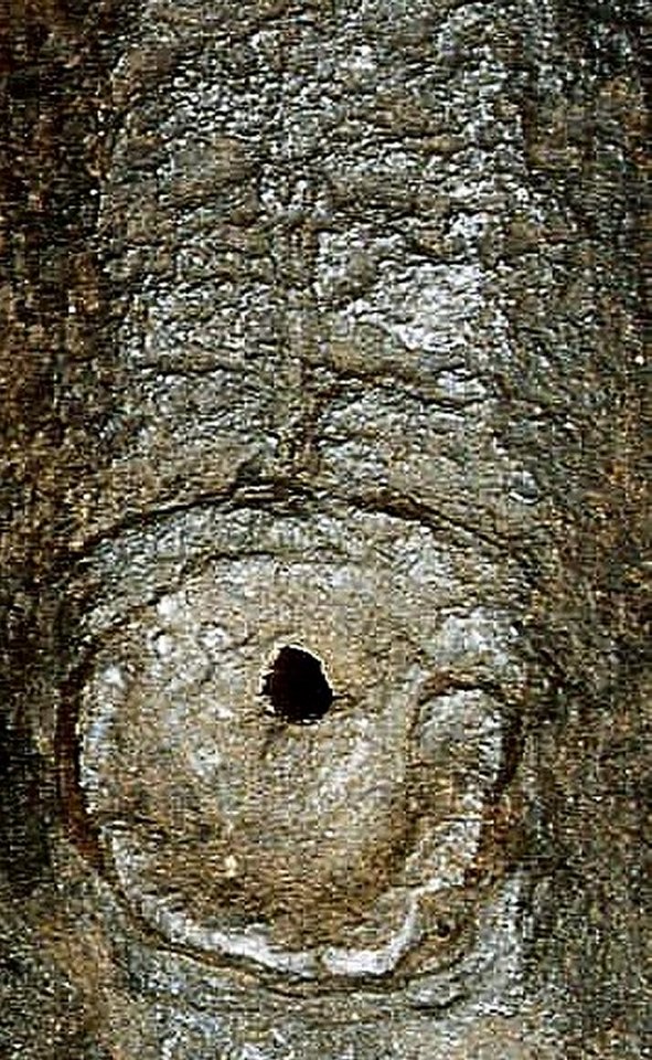

I assume it is a great satisfaction to everyone when a piece holds marks, namely those of the maker; even if not identifiable, which sometimes is a question of time ... at least one always hopes so.

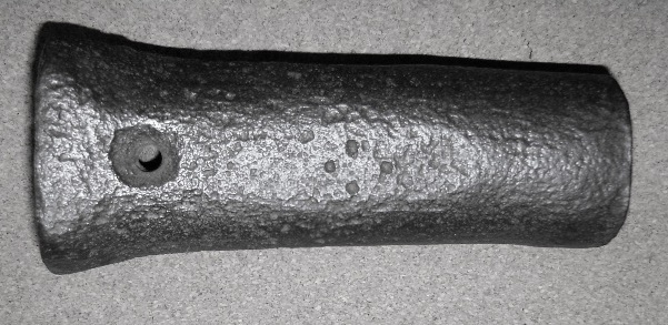

This one has 15,5 cms length and a 19 mm calibre.
Particular care was taken by the smith at finishing its rear end; faceted sides and an upper edge much more pronounced than the bottom, suggesting actual accomodation of the late to a stock bed ... i would say, within my expertize .
The marks are in an usual position and, as i said, i hope to see or hear about similar ones some day.

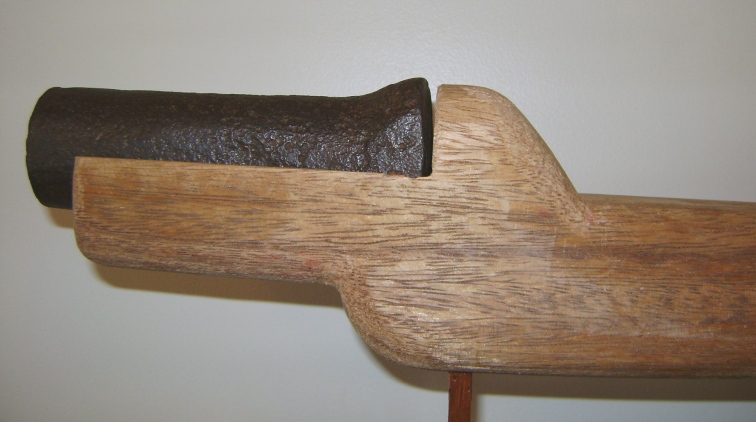

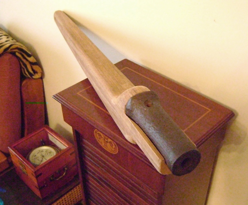

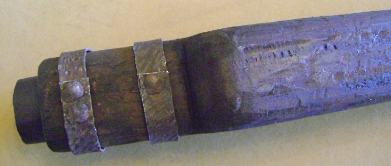

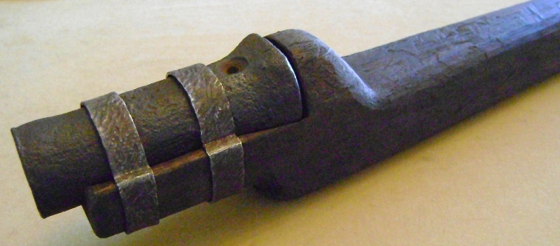

The stock was first ordered for a small cannon i have acquired a few weeks ago, but i rushed to the carpenter to alter the measurements to fit this specific one, as i see it more invinting for an immediate stock project.
The wood is kambala (the name alone excites me); the (crossbow type) shape is roughly based on the example from the Suhl Museum, posted in this forum by Michael.
Now i will have to go to the smith to organize the barrel bands.
I would feel rather comfortable with receiving your Gentlemen's opinnions ... either satisfactory or desillusive
Fernando

OOO! Looks great! I like short early handgonnes

Well done, Fernando,

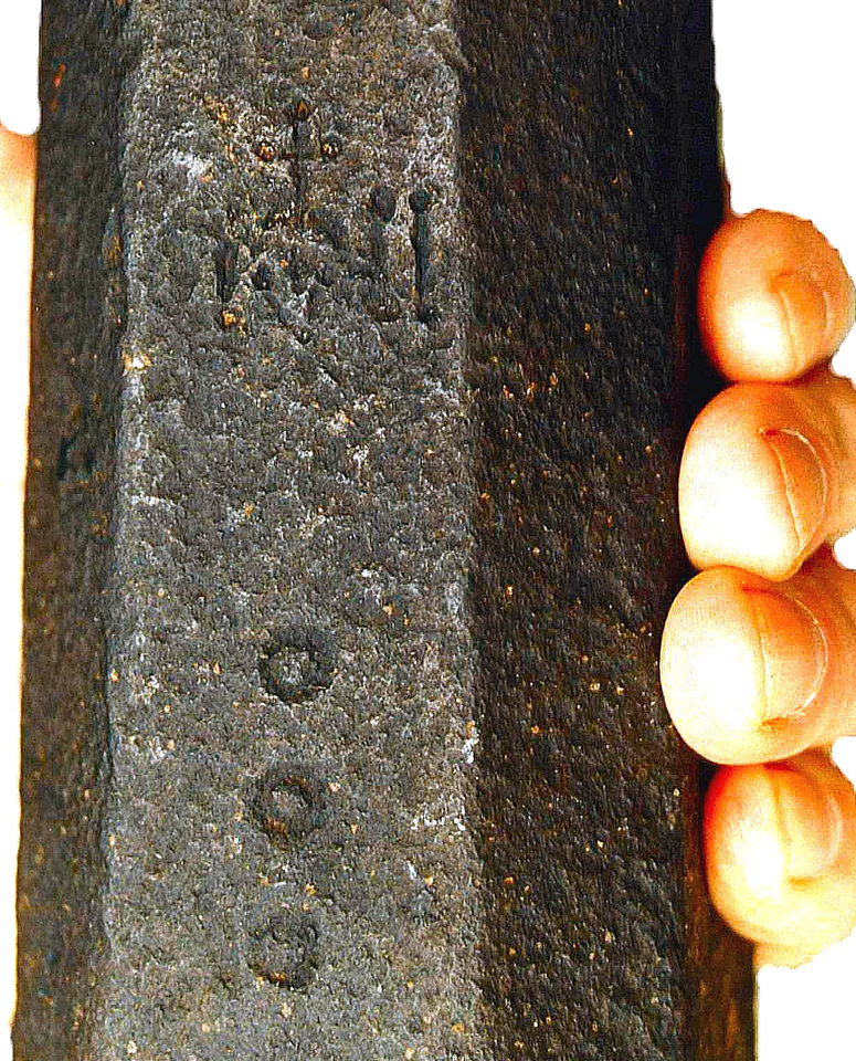

The marks seem to me like a stylized (dotted) cross which is quite commonly found on 15th century short barrels.
Michael

Well done, Fernando ...
Thank you Michael. You know that a compliment coming from you in this area works like a tonic.
... The marks seem to me like a stylized (dotted) cross which is quite commonly found on 15th century short barrels...
Good ... very good . Seller had it dated XVIII century, but even i knew he was wrong by far.
Thanks again
Fernando

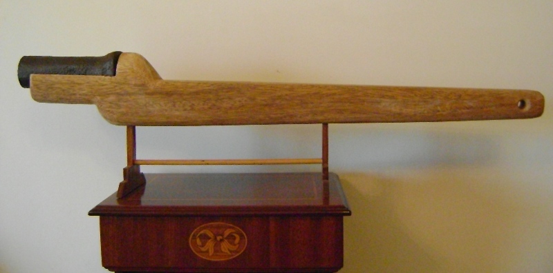

Congratulations, Fernando! Finding an example that is clearly marked is a bonus. I also like the way that the maker designed and made this thing with some thought as to the way it is supposed to fit securely into the stock. Looks great in the reproduction wood "tiller" that you had made -- some tool marks on the wood (see the two examples with stocks in Howard L. Blackmore's book), some stain and linseed oil rub to the surface, and a hammered iron barrel band or two and you're all set to go!
It's amazing that you have managed to snag several of these early gonnes in the Iberian peninsula within so short a time -- these weapons aren't exactly common. Keep up the good work!

Fantastic piece Fernando! What great workmanship in recreating that stock also, looks perfect in it. You are really doing great in acquisitions my friend.
Michael, as always you know me and my curiosity on markings. Can you say more on the stylized cross, was it just on firearms, and was it typically used in Spain or in other European arms?
