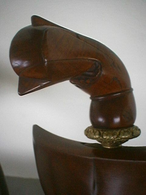

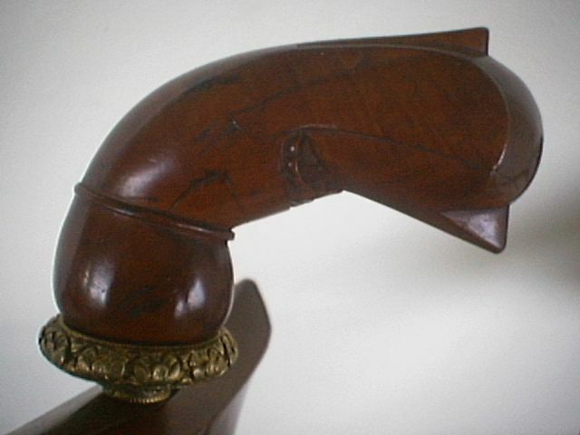

Interesting find Ariel. I've run into one or two of these before, most recently in Melaka - sadly so battered yet overpriced it wasn't worth considering - but they don't turn up often. They're clearly an uncommon variant of the "kerdas" hilt form and likely from the somewhat amorphous family of Straits Bugis keris. Its a shame its missing its scabbard as this might have helped in identifying it. Very likely the sheath was the more or less typical 'square' Bugis style sheath however to the accustomed eye there is a huge amount of variation in this form and this can sometimes help in attribution.
The blade is also a bit hard to place precisely and may be a trade blade. No doubt Eastern Sumatra is a safe bet though I've seen South Sumatran blades very much like this one.
The hilt in my collection which BluErf is refering to is somewhat different from yours, though both are probably related. Note in the image below the clearly defined medial ridge joining the tanjak and garuda mungkur on mine, while on yours the top of the head and the garuda have become a more or less amorphous blob. you'll also note that the body of mine, while perhaps a bit "stockier" than the usual Straits Bugis keris, still more or less fits the mould, while yours is a fairly unusual shape. Very flat across the back of the head, with a rounded face and rather thin at the neck and waist.
The keris in my collection has the so-called chieftain form sheath and a typical Straits Bugis blade. The keris I encountered in Melaka recently had the same sheath and blade form but again, the hilt was more like yours. This again suggests that the two are related although you can never be 100% sure.
Once more, nice find!
