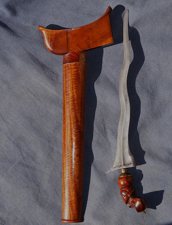

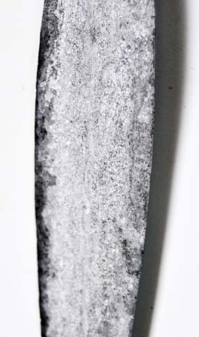

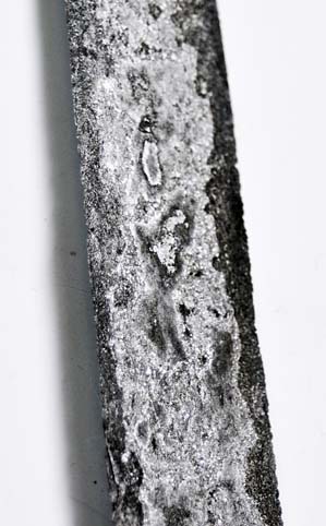

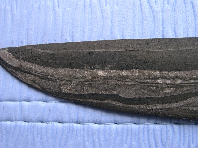

do you mean sparkling like this one in this sword? or a sparkling one like in this keris?

Hello Rick, thank you for the picture. Very beautiful keris; I like it a lot!
Hello Ferrilaki, the "sparkling" (somehow I feel that`s not the right word to describe it ...) in the sword comes quite close to the one in my keris. Pity I (still) cannot post pictures ... Thanks for yours!

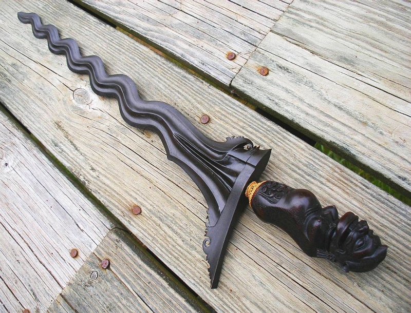

Such as this ?
