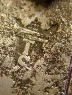

Can anybody tell me more about those maker marking? German?

All the Original 2 character Toledo marks have the name Character above the Town character (T for Toledo as the lowest character).
(This is also copied by Wolfgang Stantler, Muenchen).
your mark can be the mark of Clemens Tesche Solingen 17thC or Wilhelm Tesche Solingen early 17thC, it is published that they both have copied Toledo marks (Alonso de Sahagun, S under crown, Tomas de Ayala ST under crown).
The name of the maker T(esche) above the town mark S(olingen) makes sense if they copied well.

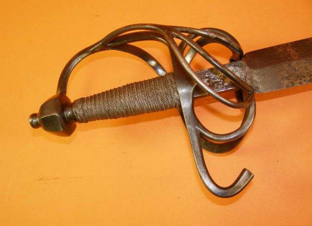

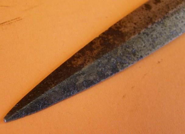

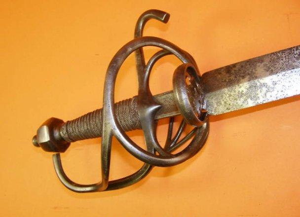

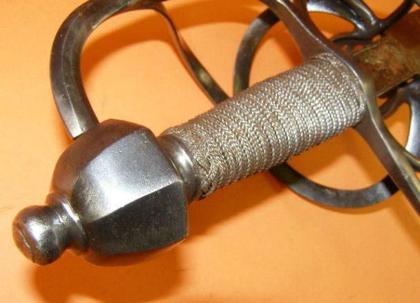

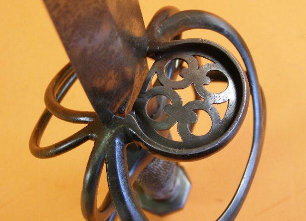

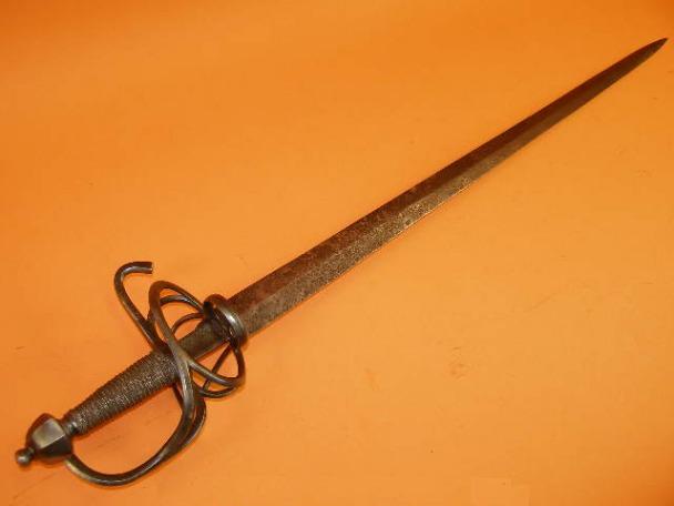

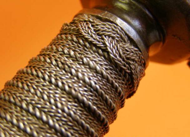

Here it is.
Is that the so called muenchen town watch sword?
