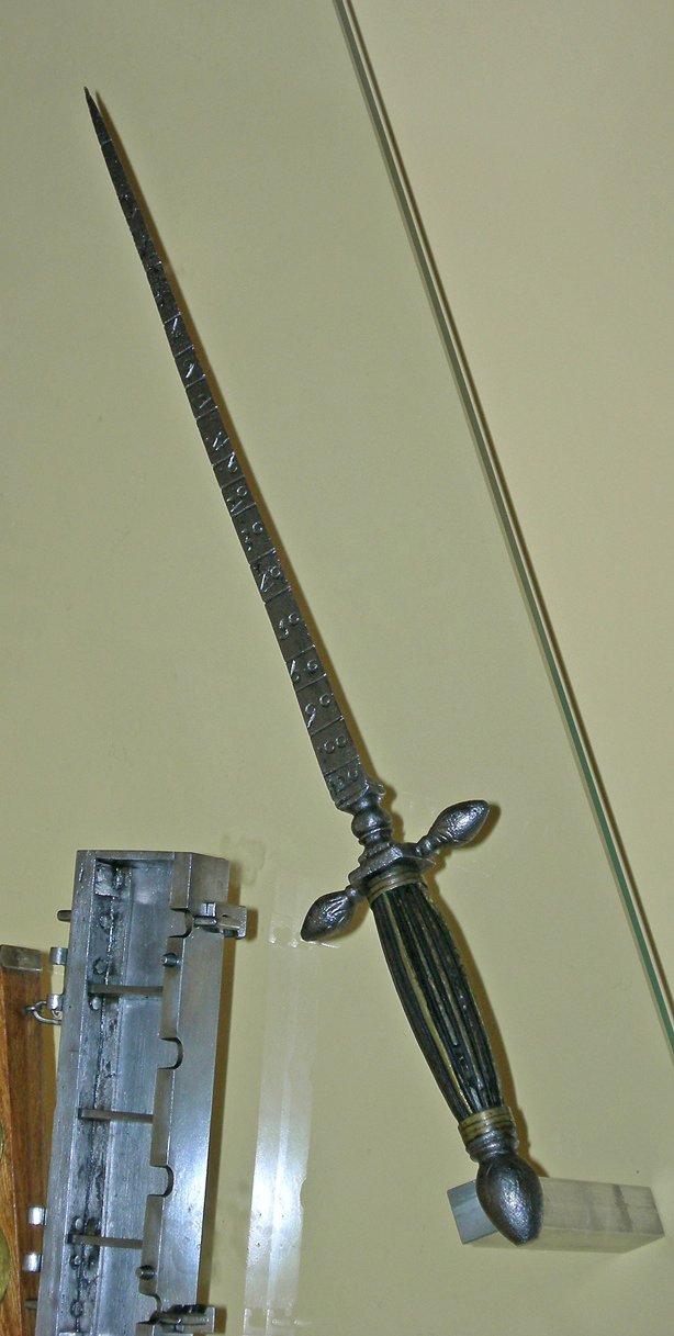

Does anyone out there have an example of the so called 'bombardier' stilettos, with graduated lines and numerics presumed to measure charges?
Old 26th May 2009, 09:58 PM   #2
kisak
kisak's Avatar
Join Date: Jul 2008
Location: Stockholm
Posts: 182
Hessink had one for sale a while ago: http://hessink.nl/Webalbum/thor/wapens/1396_frame.htm
There's also one on display in the Army Museum in Stockholm. I'm not sure if I forgot to take a picture of the museum's description, or if it might have been lacking altogether. Either way, I'm afraid I can't provide any information beyond the picture itself there. It's displayed in a manner suggesting it was a gunner's item though.

It is most certainly an 17th-18thC. gunner's stiletto. A friend of mine has one. I never understood what the numbers meant: Bore?
How was it used? Was it stuck in the charge, to adjust it for reach by removing excess?

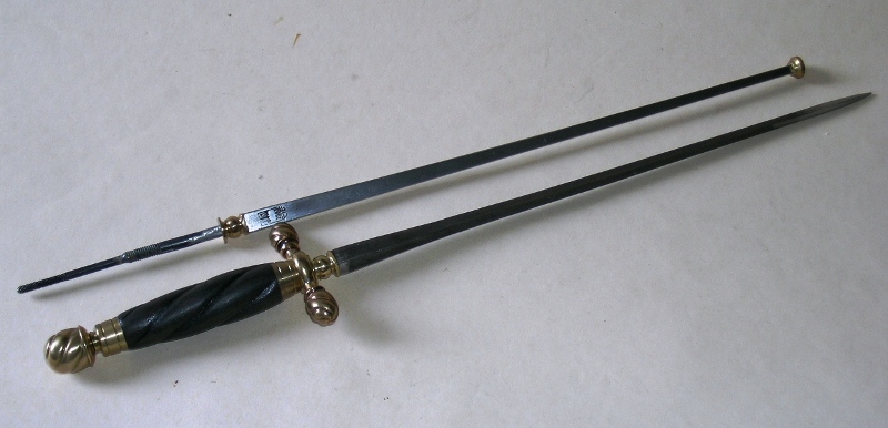

Here is a nice one from Oriental-Arms, bought by a good friend of mine.
http://www.oriental-arms.com/photos.php?id=2314
We had this dagger replicated by a knifemaker, with interchanging blades (they were taken from fencing foils therefore have square cross section rather triangle one): one has a sharp point and the other has a safety button for training. Here is a photo, and another photo of a similar one from an old booklet in Italian, dealing exclusively with gunner's stiletto.

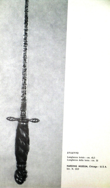

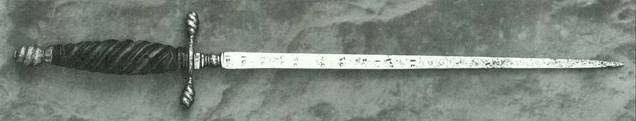

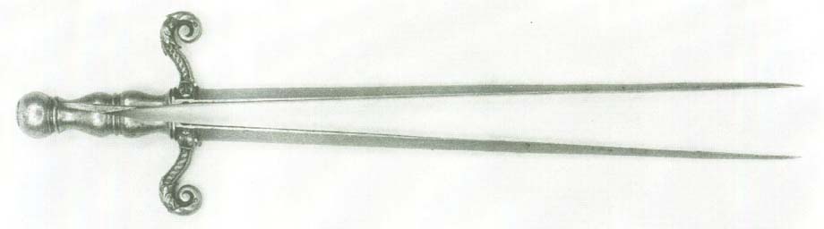

With about all having been said and considered, I am afraid that I will not be able to contribute substantially. Artillery is just not sufficiently covered by my expertise but I finally did manage to find some more illustrations.
Unfortunately they cannot shed new light either on the discussion whether the numeric scales on gunners' stilettoes etc. refer to caliber or cannon adjustment. Literature seems to be very vague on these issues. About all I could find seems to prove that Jim is absolutely right in postulating an Italian provenance for gunners' stilettoes in general.
The caption to the stiletto below just notes 'stiletto with artillery scale, Venice, ca. 1670'.

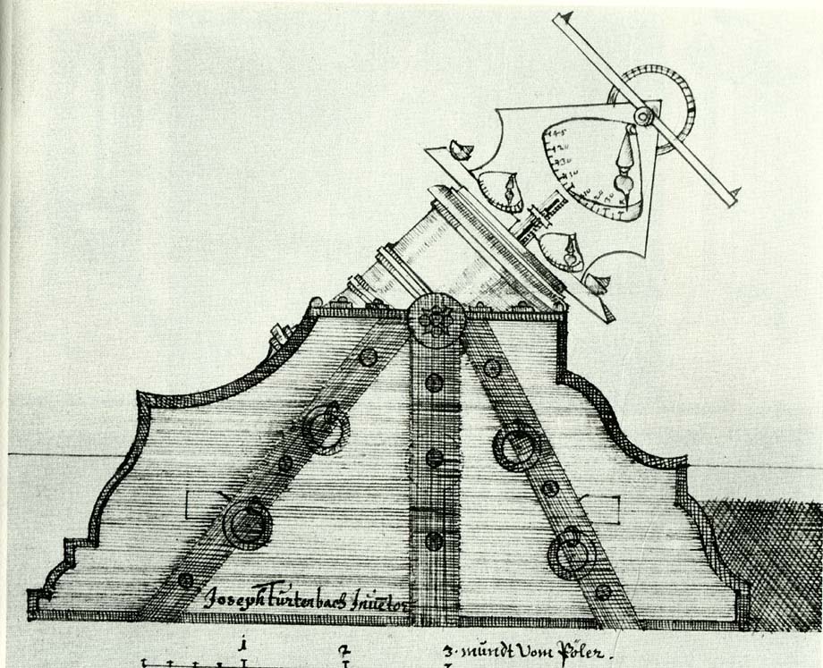

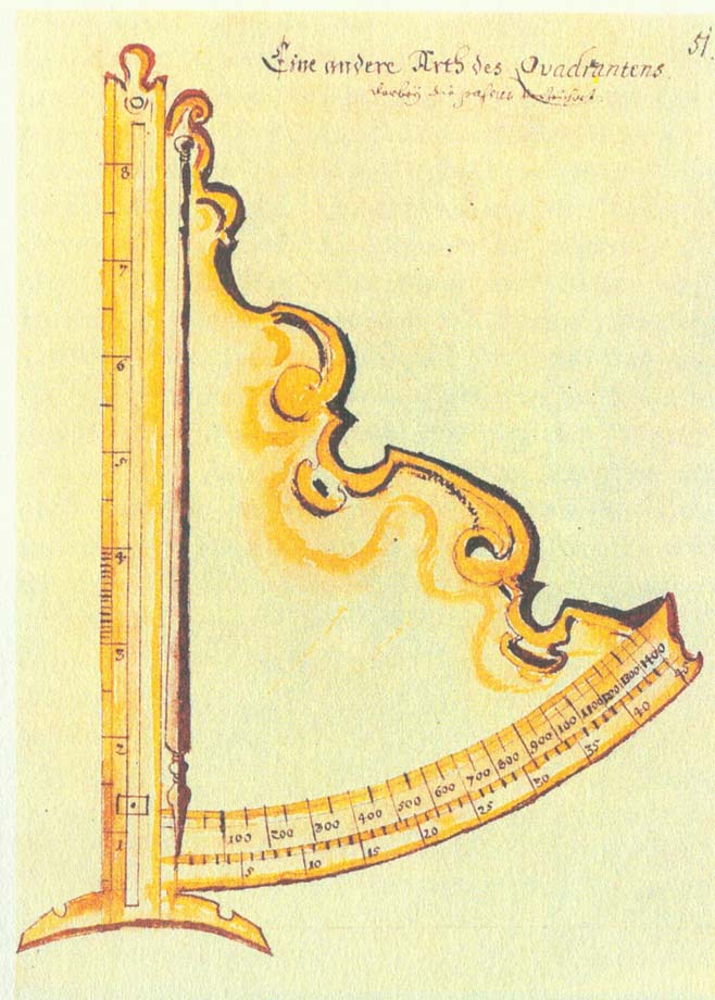

I add some original illustrative sources on the use of artillery quadrants and other measuring methods, though.
Michael

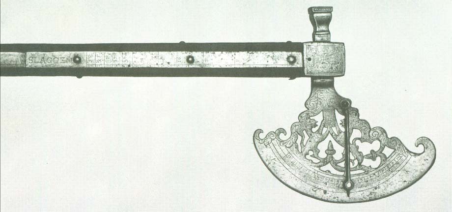

A combined fighting axe and artillery quadrant made for Duke Julius of Brunswick in about 1585, and a combined gunner's calipers and dagger, Italian, ca. 1630.
m

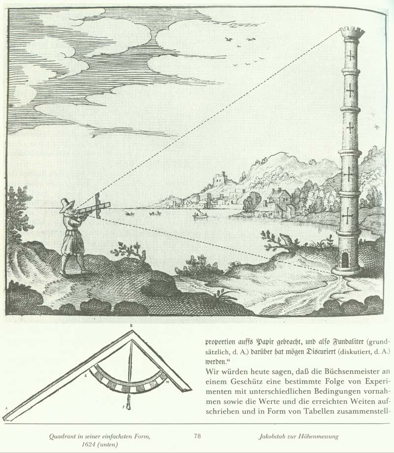

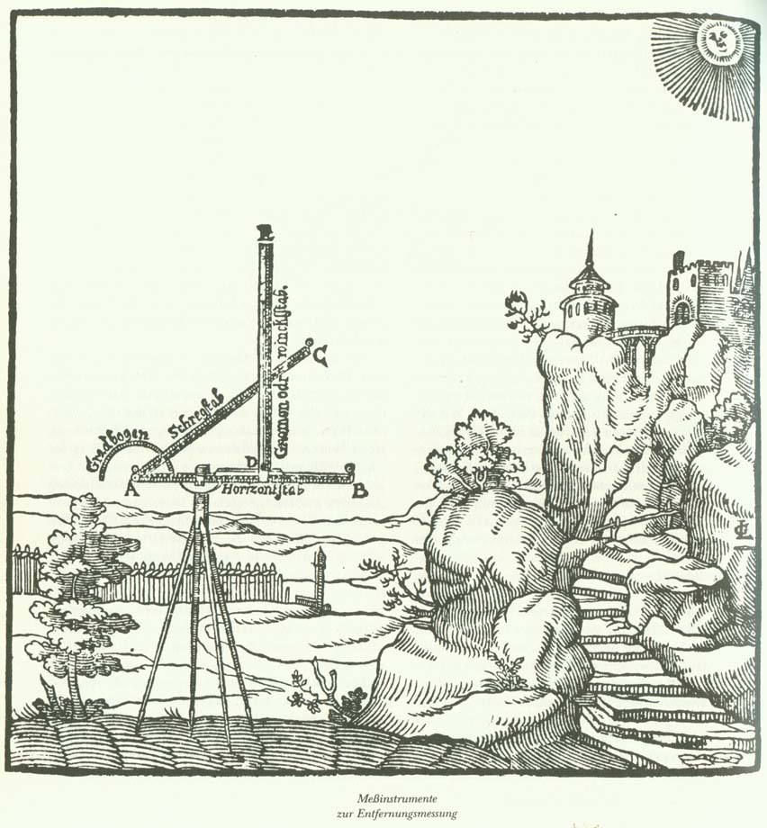

Posts: 4,310
Some historic sources of illustration, ca. 1560 to late 17th c.
m

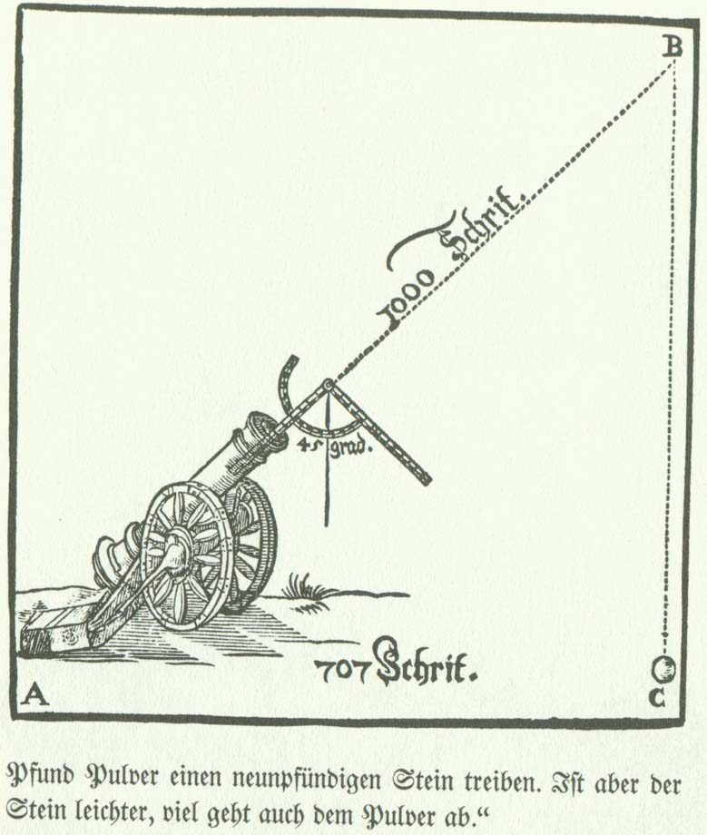

Posts: 4,310

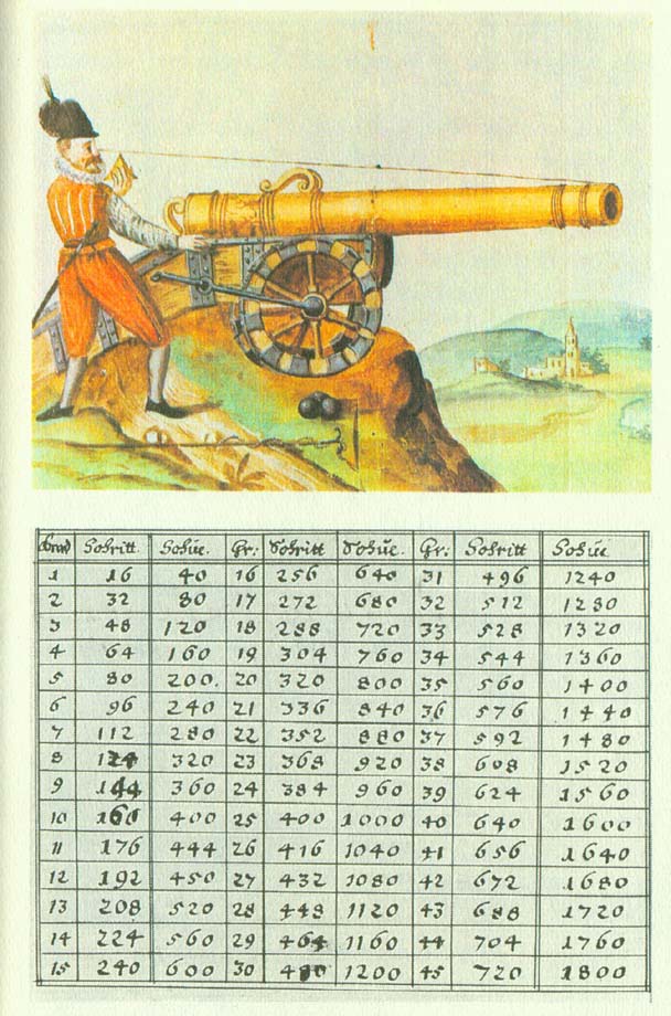

Adjusting a cannon for firing stone balls of varying weight, 16th c.
m

The combination axe and gunners quadrant of c.1585 is what I was looking for, what type of weapon/instrument devices might have led up to the application of numeric scales on these stilettos.
It would seem that the geometric computation of trajectory was a key focus in the instruments used prior to the mid 17th century appearance of these gunners stilettos, and I had wondered why these did not have the caliper feature in addition to the numeric scales.

This is a very interesting aspect of artillery, and as I have noted before, not having great familiarity with this topic, had not really 'struck home' as it were.
In rethinking the plausibility of these actually quite attractive and fascinating daggers being sacrificed to this clearly basic necessity, I returned to the original article to recheck the note on this. Terenzi does state that these 'fusetto' were likely used, if such be the case, to foul the touchhole as described.
It is noted as well that the author was 'uncomfortable' with the position that these gunners stilettos were exclusive to the artillerymen of Venice, though it was well known that the Venetian 'fire mouths' were the best organized and proficient in the world. With this, it seems odd that only 6 examples of these exist in Venetian museums.
With this apparantly well established elitism, Angelucci (Turin, 1890, cited by Terenzi) accepted the thesis that these daggers were issued to Venetian cannoneers as 'badges of corps' without any function as either tools or weapons. He suggested further (and questionably) that the scales were applied without order or meaning. This presumption seems well disproven, but is included here as worthy of note.
It would seem to me that with the Venetian artillery, an elite corps considered the best organized in the world of the time, would have a 'tapered steel pin' fashioned as a round device specifically for this reluctant but necessary action. Surely, one of these gunners would not sacrifice what seem to be rather valued weapons in this manner, except as a last resort. The practice of 'spiking' cannon, or otherwise disabling them, seems well known as a standard military practice throughout the history of these weapons. With this being the case, certainly such spikes must have been part of the accoutrements accompanying the gun crews, and I wonder if such items exist among the holdings of old artillery miscellania.
I am inclined to think that a weapon such as a stiletto, regardless of how it was used, would not be left deliberately brittle, nor with deep incisions intended to break the blade more easily. Despite the obvious shortcomings of these daggers as defensive weapons, I think that much as most weapons worn in dress or court situations, they were entirely capable of at least limited combat potential.
Regarding my previous note on the advent of premeasured containers of powder precluding the need for these for measure, it is noted by Terenzi that these needlepoint stilettos served well to puncture the containers to release powder ar key locations for ignition.
