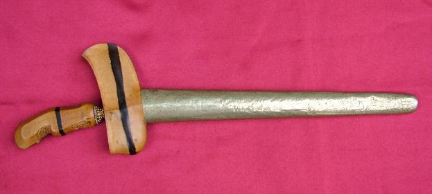

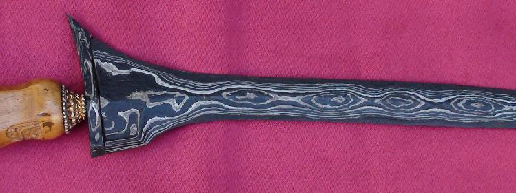

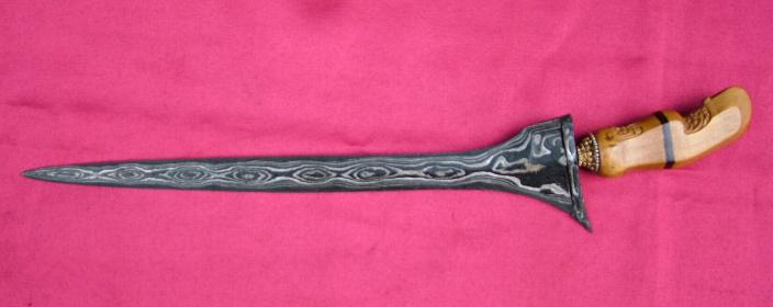

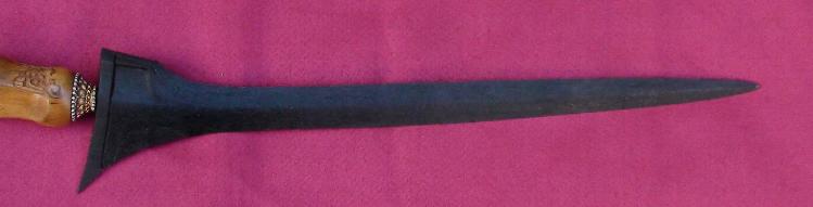

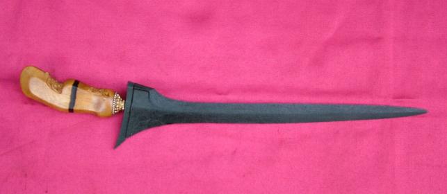

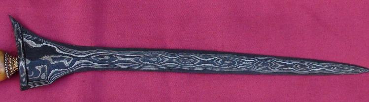

this keris I have found one my last holliday the man ware I buy this keris say that this is a keris tangkis one site of the peksi has pamor and the other side has no pamor the same like the blade
Old 23rd August 2010, 06:33 PM   #2
Posts: 7,297
Really need some closer shots. The kendit on both sheath and hilt look faked to me. The blade itself looks nice at a distance. I like the pamor from here. Looks like it is probably a contemporary blade that is nicely executed.
Old 24th August 2010, 01:28 PM   #3
Posts: 7,229
Semar, some people say that pamor tangkis has one blade face with pamor and one blade face without pamor, other people say that pamor tangkis has a different pamor on each blade face.
In any case, we can accept that by one definition, this blade is pamor tangkis.
It could be, as David has suggested, recent production, but quite frankly, from these photos it is impossible for me to guess whether it is , or it is not current production.
The wrongko is not a form that we are accustomed to seeing in current work, the pendok is old, and if the kendit line is not natural, it is very probably an imitation with some age. The same remarks can be applied to the hilt.
Disregarding the question of how old it may or may not be, it is in any case quite a nice piece.

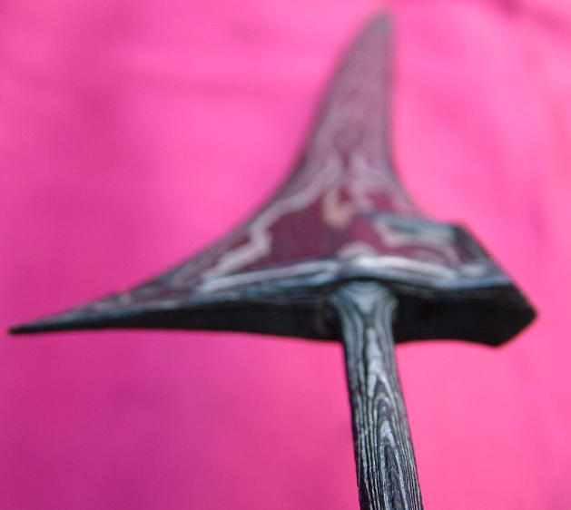

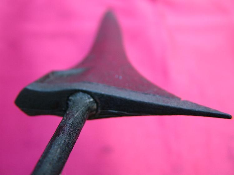

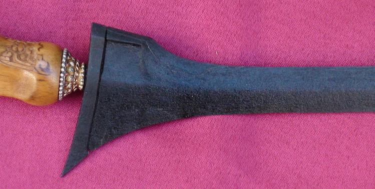

I hoop this ar better picteurs
regards semar
Old 30th August 2010, 01:56 PM   #14
Posts: 7,297
Thanks for the close-ups Semar. I won't make any comments on age, but it is a lovely keris.
