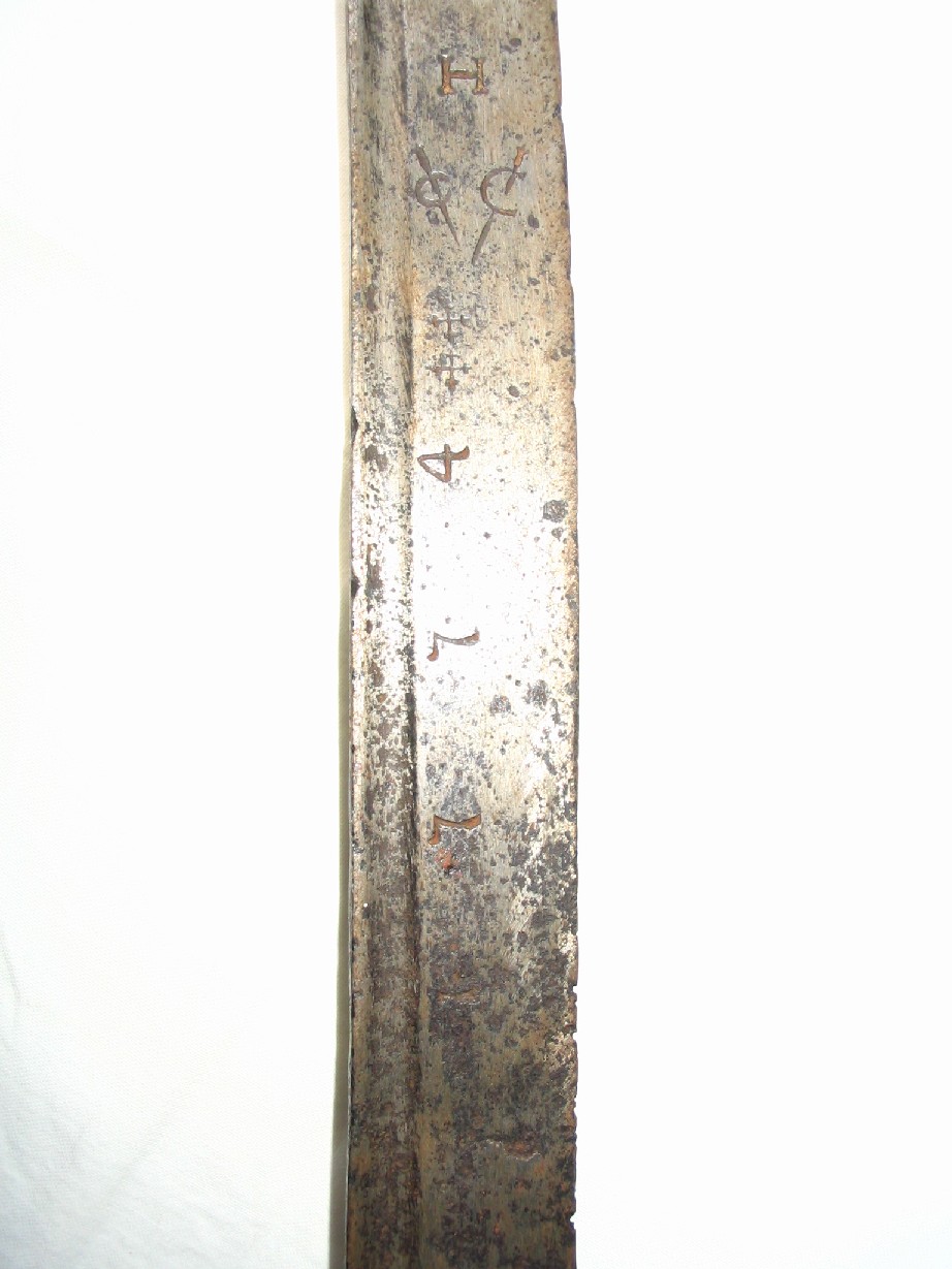

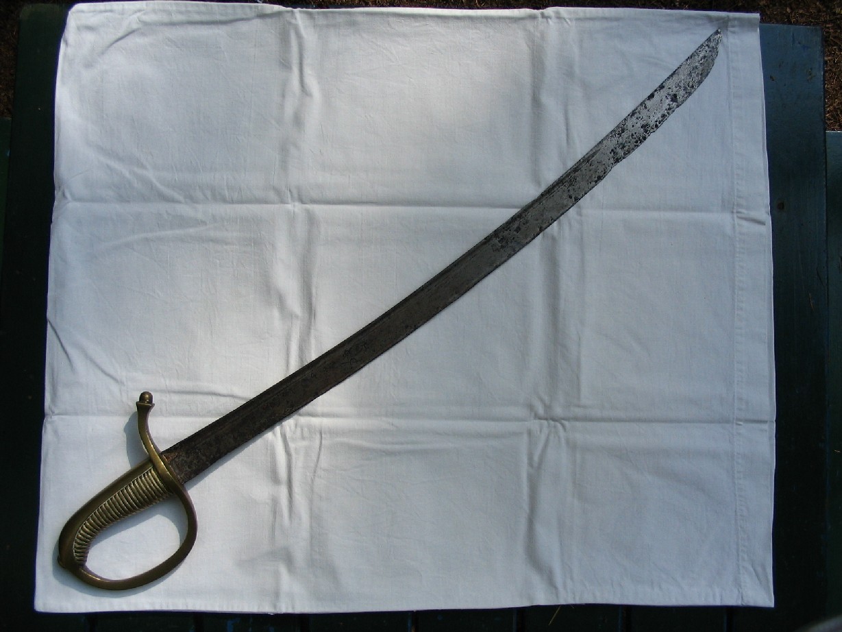

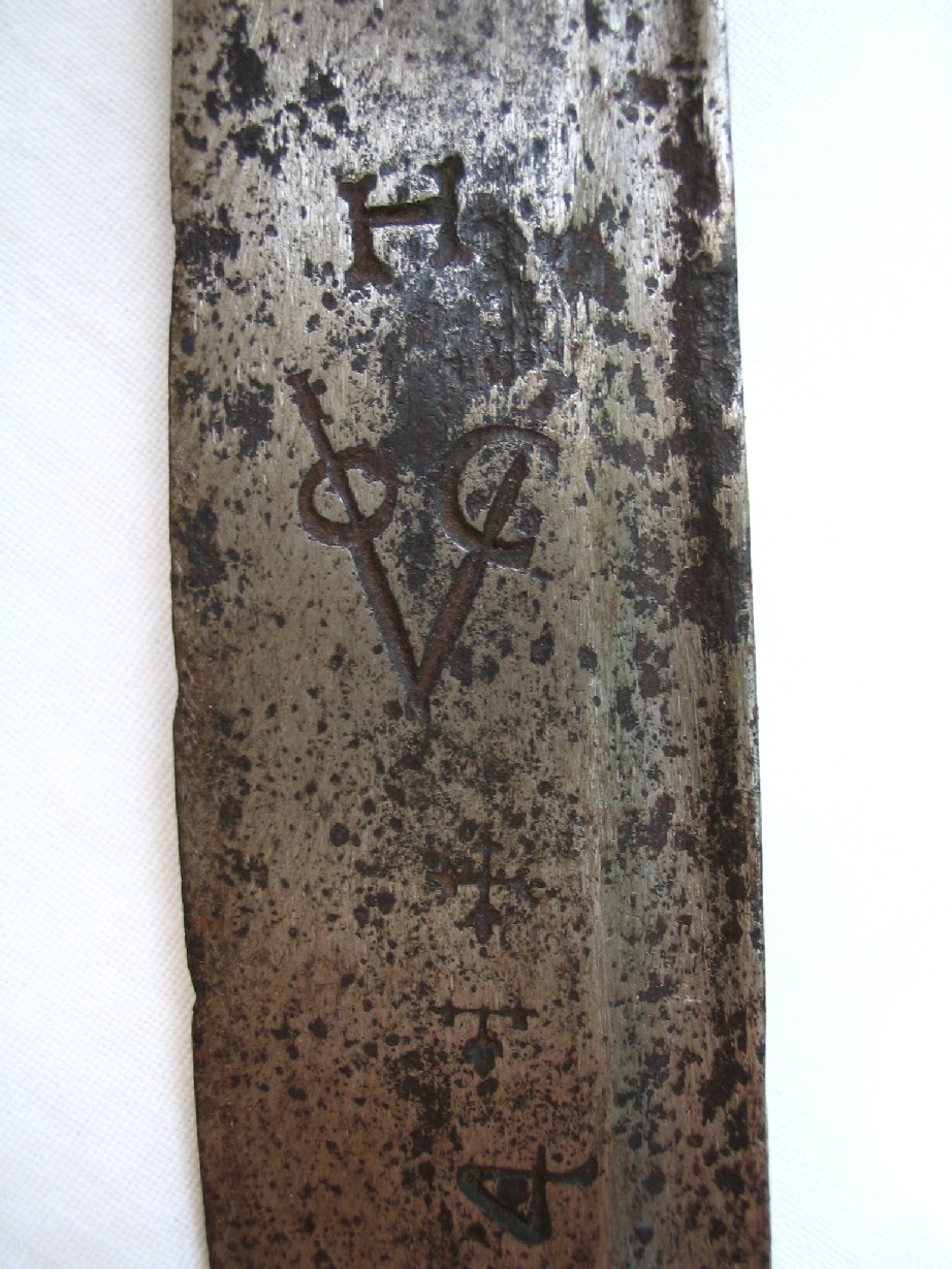

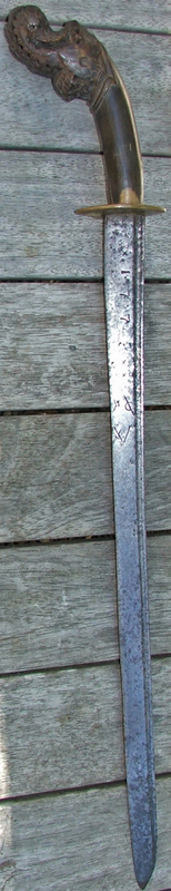

I am looking for help on finding info on this sword (picture).
I won’t sell the Sword, but I like to now if its authentic.
It’s in the family for almost 30years.
VOC stands for: De Verenigde Oostindische Compagnie (The United Dutch East Asia Company)

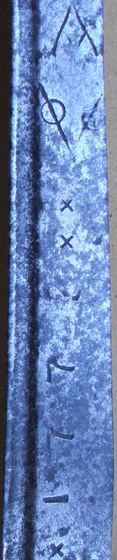

There are different characters on the Sword. On both sides the same.
Characters:
VOC
1774
(+ characters)
total length of the sword (sabre) some 80cm (32inch), blade approximately 65cm (25,5inch)
The grip maybe bronze?
The Blade is connected through the grip (on the backside of the grip)
Please look at the picture and let me know what you think. Any info will be greatly appreciated.

In the absence of any info so far, I am putting my input. I hope it is of some help.
Your blade looks like it was made in Hoorn in 1774.
The VOC had contracts to build and operate foundaries in such places as India. Among the things produced in these places were blades for trade/commerce.
I am including info/fotos for a Pedang Soenda with such a blade.
Cat.: PedangSoenda
Type: Pedang Abet Pamoeka
Blade: VOC sabre, 49.5cm., 0.35cm thick
Handle: Makara Bolong, buffalo horn
Age: c. 1773
Origin: Tatar Soenda
mvg,

The blade and the hilt don't seem to be the same age at least as far as wear and abuse goes .
Remount ??

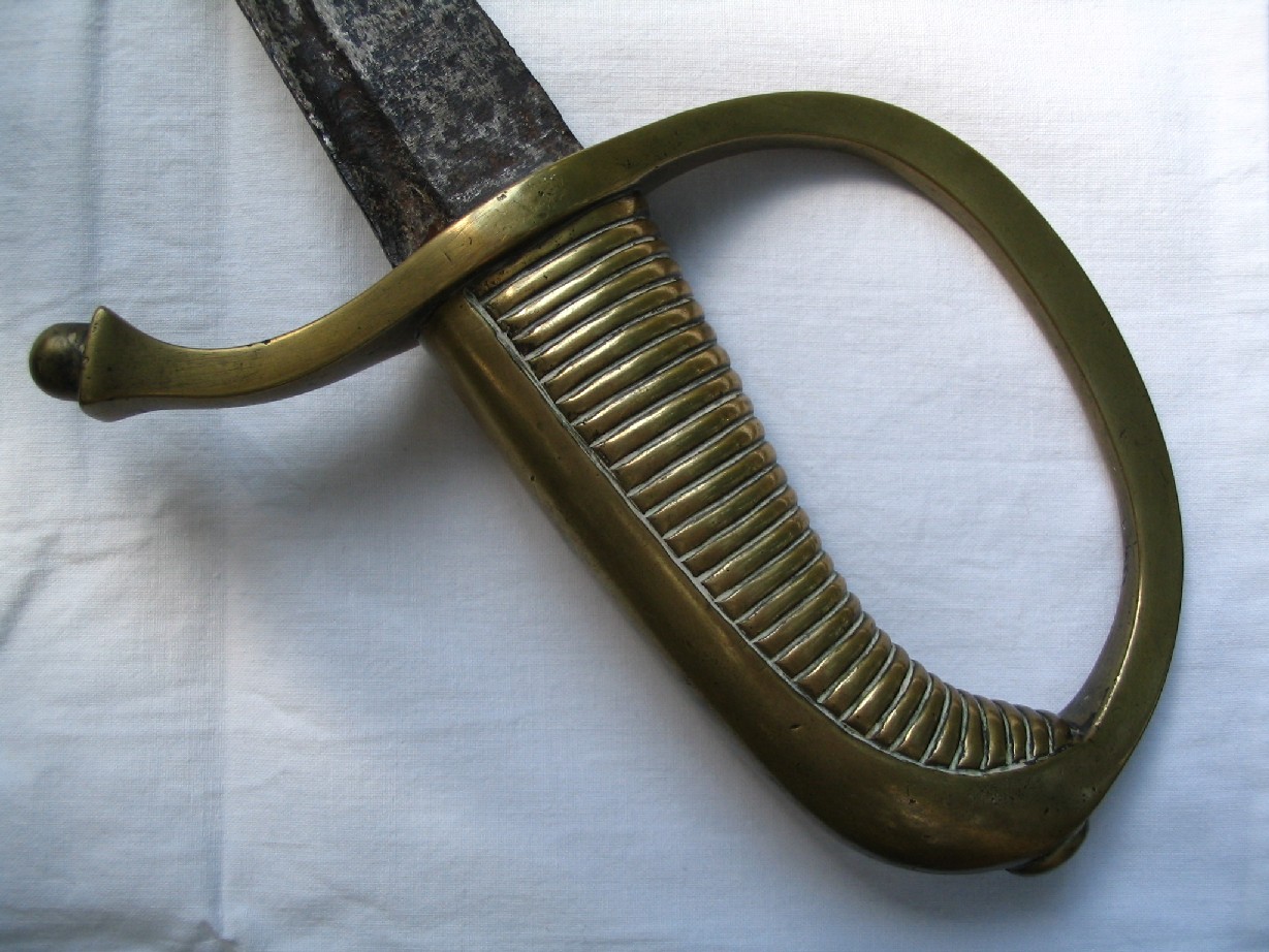

Unfortunately, the hilt on this sword is one of those generic pattern artillary hilts found on French, Prussian and Spanish pieces roughly of the period ca.1830-1890. I'm not familiar with any Dutch pieces having this hilt. I thought that the VOC stood for the Dutch East India Company? I'm not familiar with the 'United Dutch East Asia Company', as I assumed after the the East India trading company went under circa 1800, there were no further companies involved? Interesting. So...if this Dutch East Asia Co existed into the 19th century, it could be a real piece. If not and the VOC stands for the earlier company, it has either been re-hilted or is a fake. I guess one other possibility is that someone affectionately inscribed it on a later sword out of found rememberence of the company.
If the VOC marking is attached to a later company (this Asia company you speak of), this might explain why this marking is sometimes found on more 19th century pieces.
Shaver Cool, anyone??
Sorry, Jim! Couldn't resist!!

I asked an expert in Holland. Probably it is a real old Sabre. Likely it is composite from two swords. A French Briquet (1809/1811) and an VOC chamber Hoorn kling (blade).
It was common for militia and for the garde-champêtre (=patrolman) in Dutch Indonesia to build there own (cheap) sabre.
He send me the pictures of the Briquet. Although the number of ribs on the handle don’t match (mine has 30, and the briquet 36?). The rest is identical.
Now I focus on the VOC chamber kling (perhaps a sort Pedang Soenda??).

The French briquet is the ubiquitous brass hilts M ELEY was refering to. Yours is slightly different. If you look at the end of the quillion it has a nipple shape rather than the more common blunt tip as seen in the picture or the flattened scroll as seen in the Dutch naval saber. Your hilt may be a later replacement, but it may also be original. The answer lies in dating that 'nipple' tip quillion.
All the best
