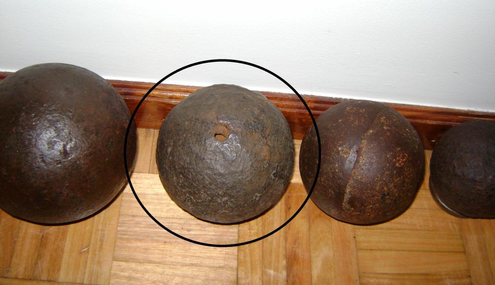

Can any members help me with any info about this item which I hope is some kind of cannon ball . It weighs 1.1 kg and is about 65 mm in diameter .
Old 28th October 2013, 06:16 PM   #2
Sure thing; more precisely a grenade. Cannon balls are solid, grenades are hollow, to be filled with explosives or shrapnel. The loading hole also fits a fuse. Early ones were simply matchcord and later ones were 'inteligent' devices, like detonators and timers.
This one was possibly for a 2 1/2" howitzer.
18th or early 19th century, i would say.

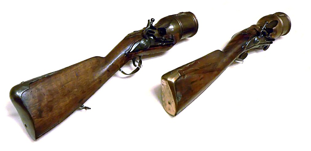

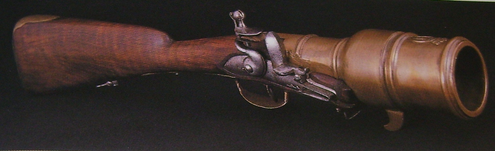

During your browsing you may find these 'grenade launchers' or 'portable mortars'. They date from the 18th century, but i don't think they are the issue here.

Grenades vs mortar shells...this has always troubled me as well. Per Gilkerson, grenades were rarely smooth and often not even perfectly circular, because they didn't need to fit perfectly in the barrel. Mortar shells were more like solid shot in that they were supposed to be well formed and smooth, at least theoretically. Put one in the ground for a few centuries and it might not be so easy. I have what I think is a grenade in my collection, somewhat between the size bigger than a golf ball, but smaller than a tennis ball. It has a very small 1/4" hole and congealed powder inside. It isn't perfectly round, so I assumed grenade. Problem is, most resources claim grenades are larger than mine and with a bigger fuse hole. Hope to someday find a resource that shows other sizes besides what 'Boarders Away' lists.
Another controversy is with the brass grenade launchers. Some sources say that these rifle types were too short and too thin to be effective as launchers and that these guns were more likely for shooting off flares or fireworks.

...Another controversy is with the brass grenade launchers. Some sources say that these rifle types were too short and too thin to be effective as launchers and that these guns were more likely for shooting off flares or fireworks.
Speaking of which ...
This example is in exhibition in the Portuguese Royal Palace of Vila Viçosa armour collection.
For what it is worth, the text says that it is a XVIII century Spanish (?) portable mortar, with a 73 m/m mouth. Cast in bronze, with a chamber of much narrower section, with a support hook in the lower part. Silex lock a la French. It shot 'case' with multiple projectiles. It was used in ships and parapets.

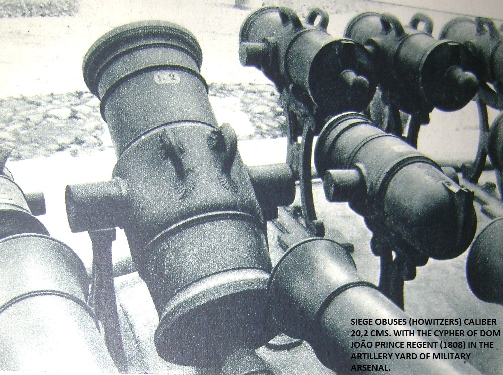

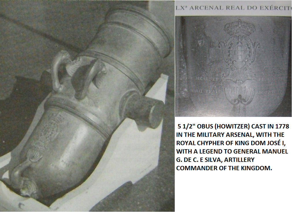

I know that hundreds of 5 1/2" howitzer grenades were shot during the French invasions (1807-1814). I am trying hard to locate the illustration of one of these projectiles. On the other hand, i don't see any reason for the example i have shown above not be one of such things. Most howitzers were mounted in fortification lines around Lisbon and i got this one over there.
Despite its corrosion due to age, it looks rather spherical ... and the fuse hole is pretty narrow.
I would quicker assimilate that the difference between grenades and shells and even between mortars and howitzer typology, resides in their time evolution and origin.

Yes, just one of the many frustrating and foggy areas of naval collecting. I like the bronze gun for the 'Tops'. It would have done well against boarders.
I don't necessarily question Mr. Gilkerson, but I feel that his study concentrated particularly on one country's type of grenado from a specific time period (Great Britiain, ca. 1600-1750-ish). As we've seen on this forum, there were all manner of exploding shells around made in different materials (clay, stone, etc). Perhaps in the future, someone will do a more definitive and specific volume on said lobbed bombards.

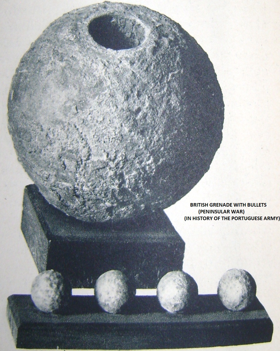

The British introduced the shrapnel grenade in Portugal during the Peninsular War, an invention soon adopted by Portuguese. Apparently Wellington had some doubts about the efficiency of such grenades, on grounds that their projectiles impeled by the bomb explosion didn't have enough velocity to penetrate and kill victims, only injuring them. But he appreciated the use of such shrapnel in heavy cannonry (24 pounder), with visible results in Badajoz.

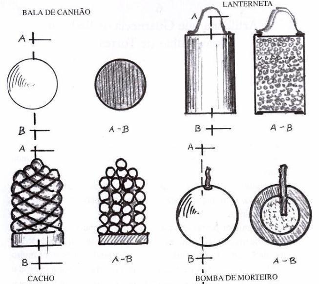

Eventually ammunitions involved in this issue have have somehow different names in portuguese, which creates some difficulty in shifting them to english; grapeshot is called 'bunch' (like for grape bunch) and caseshot is called 'lanterneta' (from lantern).
What i infer from Welington's words is that he preferred (sacs of) musket bullets (sic) being shot directly by cannons than shrapnel being bursted by howitzer, call it shells/grenades/bombs.
