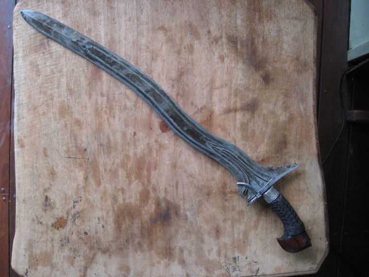

G'day

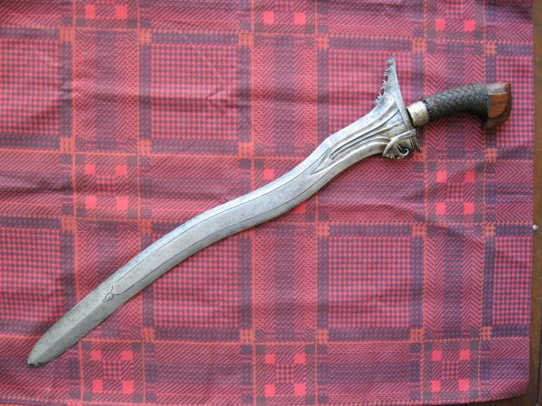

Would this be a middle period or archaic period kris?
Pre 1850's?
To me, a piece with some prescense regardless.
I have stained kris.

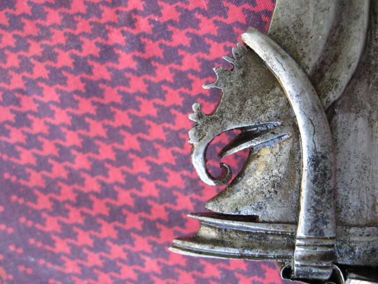

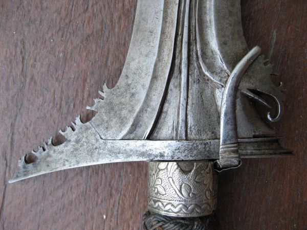

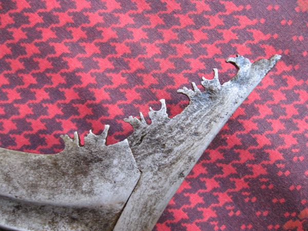

HelloDaniel, could you post a close up of the gangya area, I think that this will help to understand better the age of your kris
FLavio
Old 18th August 2008, 01:17 PM   #4
scratch
scratch's Avatar
Join Date: Sep 2007
Location: Australia
Posts: 96
Thanks for your interest Flavio.
Blade is light, 22 oz
Blade length 20 1/16 in
Overall length 24 3/4 in
To me, it is craft and art.
If all these photos are too many I will delete if required.

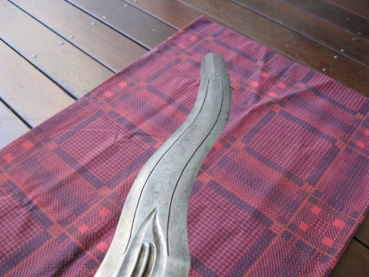

I have included some pre stain photos.
The blade also has a slight swollen tip.
Cheers
Dan
scratch is offline   Reply With Quote

Looks to be what I would put in the transition category. I say early 1800's. This
thread;
http://www.vikingsword.com/vb/showthread.php?t=6853
might be of interest. A very similiar kris.
Old 19th August 2008, 01:45 AM   #6
Posts: 7,399

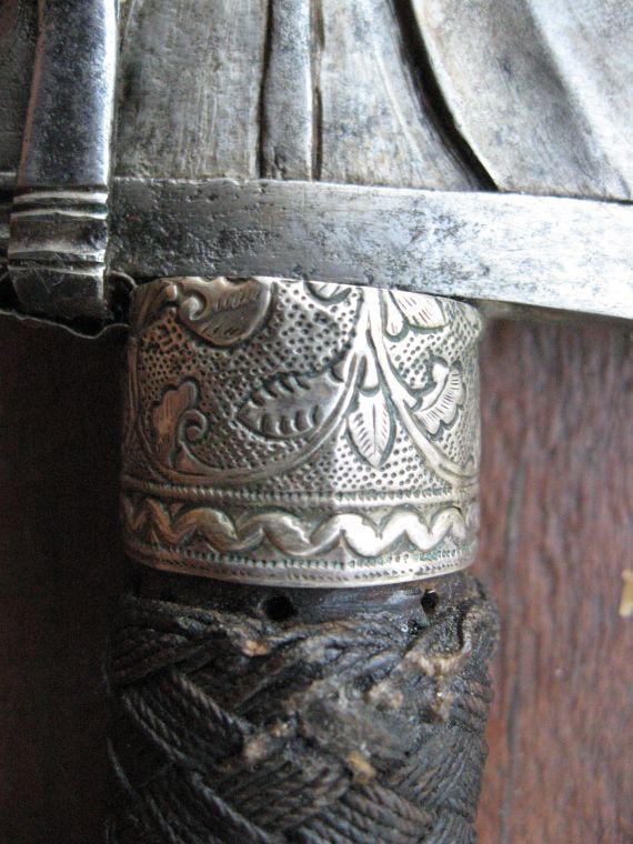

I agree with MROSS and definitely Sulu with the front part of the ganga and the style used in the ferrule.
A great piece - congratulations!

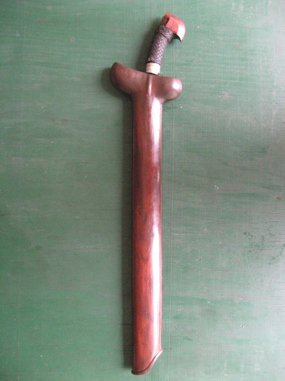

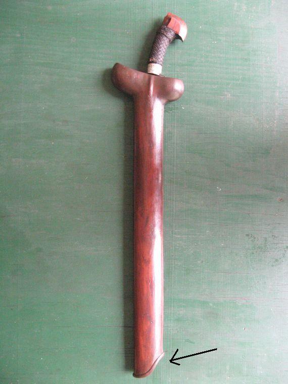

BTW - the scabbard is later.

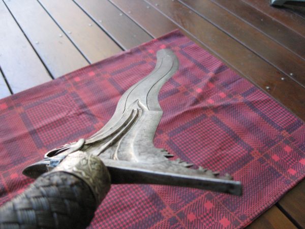

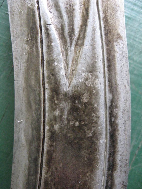

I don't mean to criticise but the stain looks all wrong .
I'm so sorry to bring this up .
What did you stain the blade with ?
Old 19th August 2008, 04:46 AM   #9
Posts: 7,289
I suspect that scratch may have used arsenic and lime like he did with his "Balinese" keris. If so Scratch, that would be a "mistake" of sorts. Vinegar would give a more "correct" result for a Moro kris.

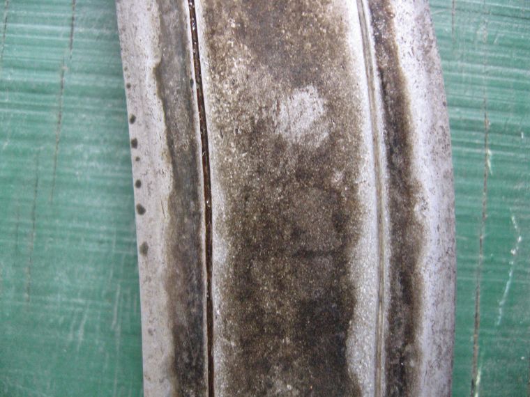

Rick, no problems, I was waiting for the hammer to fall David, Spot on I thought some of the metal looked like it was designed to take a pamor stain. I wondered if such cross polination of staining etching techniques could have been used in period. Curiosity got the better of me and these are the result.I was surprised to get result. I mean no disrespect by my use of warangan on this blade. To me it look quite stunning in hand, camoflaged too
Thanks for your replies Mross, Hello PenangsangII
What are the geometric sparkles/crystals in blade?
Thanks for the communication,
Dan
Hello scratch,
Good looking kris there!
Here is an earlier thread related with your question: http://www.vikingsword.com/vb/showthread.php?t=5092

Nice Sulu kris there. Good catch!! Yup, I must agree that most Moro kris do not have good results after using arsenic (warangan) as it may turn splotchy at some areas. Very dirty look. But personnal I have seen only one piece which turn out to be very outstanding after using warangan etching.
I am also curious about the bottom stem. I think this is not common.
Newsteel is offline   Reply With Quote
Old 20th August 2008, 02:29 AM   #14
Posts: 7,399
And to make the point, Moro did not use arsenic......

Newsteel and Battarra, Thanks for your historical accuracy, And I take the point about blochiness Piece can easily be rendered stain free I think.
Scabbard has received some restoration to lower half I think

Use 220 or 240 grit sand paper (no lower) and that will get the stain off, but then you can restain with lime juice or ferrous cloride (low concentration).
