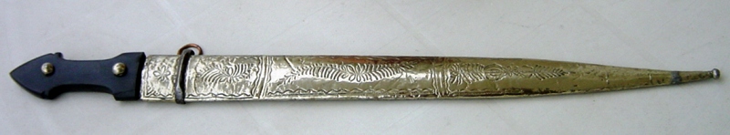

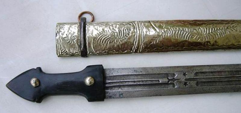

A triple fullered 18" (45 cms. ) blade.
Handle looks horn ... at least by night
Wooden scabbard covered by "white brass" on the front and tin on the back.
Kindjal labeled by seller as 18th century and scabbard 19th century.
Anyone familiar with these blade marks ?
Is it easy to tell the origin of this piece ? and the possible veracity of its age ?
Thanks a lot in advance.
Fernando

The scabbard ornaments look Balkan to me. The blade... Daghestani trade blade.
Overall, hard to call it Caucasian
Old 20th April 2008, 12:07 AM   #3
Thank you Ariel.
18th century for the blade, makes any sense ?
Old 20th April 2008, 05:48 AM   #4
Unlikely. There are less than 20 known Kindjal blades in existence dated 18th century ( I have one) . None from the 17th. Check Miller's book "Kaukasiske Wappen".
Old 20th April 2008, 06:37 PM   #5
Thank you once more. I will register the data on this piece, concerning blade and scabbard, as per your input. I will consider its age as being XIX century.
Funny thing i can't spot that book in the Net .
Kind regards
Fernando

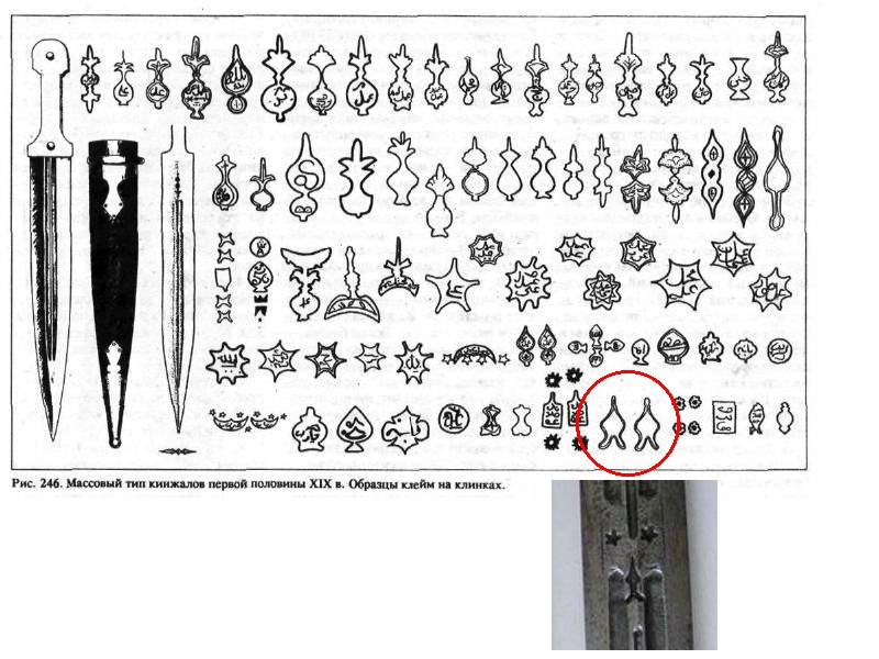

I was scrolling the PDF pages of this book about Caucasian Weapons by E. Astvacaturyan, that a member ( i don't remember whom) has provided us long time ago by email and, in page 145, there is a sketch with what i think to be several makers marks seen on 19th century kindjals. To my unexperienced eyes one of these marks seems to be the same as part of the symbols in the example i have posted in this thread. I am a zero in Russian, but this part of the book appears to be the Daghestan section ... precisely the area mentioned by Ariel as being the provenance of the discussed piece.
Could those members with more knowledge in this subject give a coment on this similarity ?
Ariel, could you help ?
Thanks
Fernando

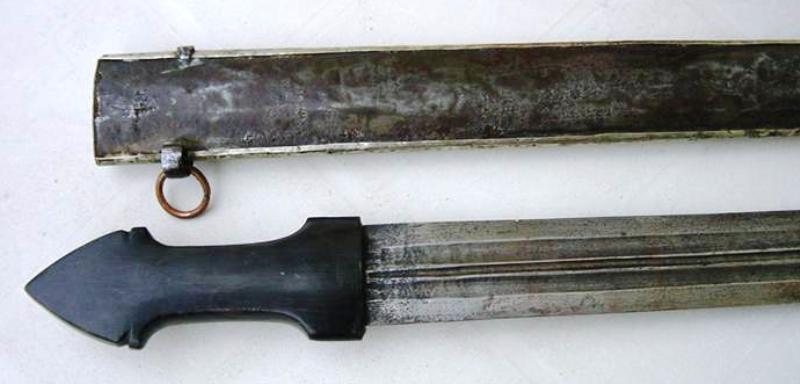

Nice old blade and scabbard on this one. A lot different than the tourist items listed recently. My only question/concern would be the handle. Normally you would see the rivets on the reverse side of the handle possibly the grips are recently replaced or maybe I just can not see them in pic
Old 22nd May 2008, 02:00 AM   #10
Thank you Ward,
Now that you mention, i have rechecked the handle and its assembly. The grip is made of one only piece ... of horn, i still think.
The tang, at the grip entrance, looks to be the plate type and not of spike form. The fixation points are not what you can call rivets, but nails with a round shell head, like those in the large luxury leather covered chairs, if you know what i mean. They don't go through to the other side, indeed. But they sure are very old, so much worn that the shells are risking to fall off the nails. Whether this grip was not the original, it sure is from the period or close to it.
What do you think about the mark in the book and that in the blade of this piece ? Could it be the same ?
Fernando

Fernando, I see a relation among this mark and yours. The figure on the books is referred to typical marking on kindjals from the first half of the 19th Century.

Eventually i had that legend translated by a Russian ( Siberian) acquaintance ... which coincides with your interpretation .
I just thaught the kinzhal conoisseurs would favour me with some considerations on the mark analogy or similarity .
Thanks all the same.
