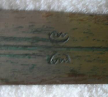

I have an old sword which I believe is a Takouba, it is very basic, there is on the blade a mark,actually an identical pair of marks, with one each side of the Fuller where the shorter fullers ends. There is probably a correct name for them, but to me they look like two halves of a broken egg, with the broken bits facing away from the central Fuller. The sword is very basic, the only decoration is some crude markings on the guard, two six pointed stars on one side, the other side looks as if it had markings but they have worn away. (Through being carried ?)
Can any one help please do you know what this mark means, I have just started collecting, am am keen to find out more.I know this sword has been in the same family in UK for at least 50 years and was purchased in Africa. I have not been able to find any information on sword makers marks although I know they exist. Any advice would be much appreciated. Thanks.

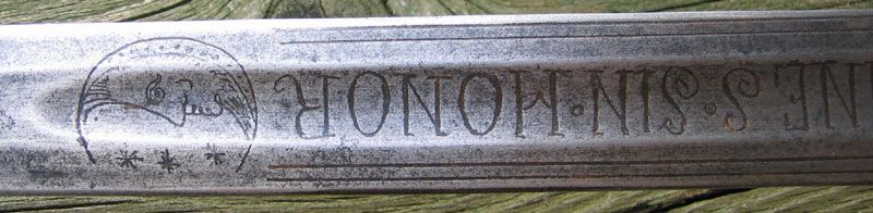

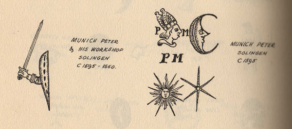

The markings represent a 'half moon' with a face, usually two facing away from each other. These were copied from European manufactured blade markings in a belief that they has talismatic/magical powers.

I have often wondered what was key to the Saharan swordsmiths choosing the paired crescent moons such as these to place on takouba blades, and in some instances on kaskara blades to the east. It seems that these paired marks (termed 'dukari' as claimed by Briggs) they occur consistantly and become increasingly stylized to near unrecognizable form, but positioned in the same manner.
While the markings imitated by native makers suggested certain powers to be imbued in the blade as perceived from the emphasis of these on the imported European blades, it is interesting to consider the meanings of the markings as they diffuse cross culturally. What began as occult allegorical symbolism on the blades in Europe, evolved into associated quality marks by certain makers, then into folk magic and power imbuing talismanic symbolism in native perception.

The marks in the linked photo are 'degenerated' half moons; consistent with the overall appearance of a local natively made blade. On trade blades of European origin, the half moons will be much beter defined.

Well my blade is flat, and thin, about 2-3 mm (I need a micrometer !) springy but not floppy. So I guess I have a native made blade with imitation man in the moon markings, however the fullers are well defined, and could not be defined as "Scratched on". They seem fairly regular. On one side of the blade One of the Man in the moon markings seems worn away (From repeated sharpening ?) Although the sharp edge finishes about there. There are strange slightly raised lines on the sharp edges which run at right angles to the cutting edge, I do not think they are the result of sharpening, at least not using the traditional method.
The blade also shows a swirly sort of pattern in places.
Do any of you guys have an opion ? Do I have a genuine old (ish) native blade or is it one made for the tourist trade ? I know it was brought back from North Africa about 50 years ago and has been in the same family since then.

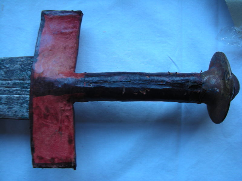

From your pictures, which I have taken the liberty of quoting below, I would opine that this is a genuine ethnographic specimen of fairly typical quality. The pommel does appear to have some age and is of an older form. The leather looks somewhat newer than that age from the photo, but aging would be less out of the Sahara and photos may be quite deceptive. (Indeed our tour leader on one of the trips cautioned that leather work that had been in that environment for 5 years would often appear to have an age of 50 years.)
That harsh environment is not one that leads to accumulation of much material wealth and fairly simple takoubas such as this one seem to be what is actually worn on a daily basis out in the desert.
The silver mounted ones I have pictured are, I suspect, a fairly recent silversmith's innovation in response to greater wealth among urbanized Tuareg; I doubt any that I have seen were assembled longer ago than 20 years. However, while these swords are new, the blades contained within them are often old heirlooms (for example, the 21st century sword in the logo above is built around a 17th century blade of European origin).
