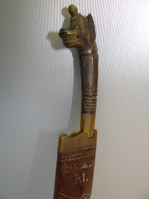

You know my interest in Bicolano blades, see here: http://www.vikingsword.com/vb/showth...ighlight=bicol

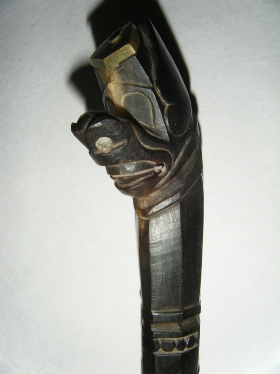

So I was glad to add today a Bicol dagger (at least I think it is) to my collection. The dagger is 11,5 " long with a blade from 6 5/8". Sadly it's missing the scabbard.
Like usual all comments are welcome.

Hi Detlef:
Apart from the carved dog (arso ?) head on the hilt there is little else to suggest a Bicol origin to me. The blade actually looks of European or US manufacture rather than Philippines, and the hilt (apart from dog's head) does not remind me of other bicolano knives.
Your example does not seem like a typical itak from Bicol. Perhaps a composite from a number of unrelated pieces?

Hi Ian,
thank you for comment. I based my attribution by the inaso hilt from horn. But agree with you that the blade seems to be a recycled US blade. Also the unusual eyes from screws (?) of Western manufacture let me think that this dagger seems to date from 1900-1945, maybe WWII area? For sure you are correct that it is not a typical Bicol dagger (BTW, how look a typical Bicol dagger? ). But again, would like to see more Bicol blades, sadly there is not much written/documented about Bicol blades. Think about how long it was needed to pin down the origin of the so called Minasbad, see here: http://www.vikingsword.com/vb/showth...batangas+sword

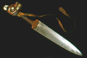

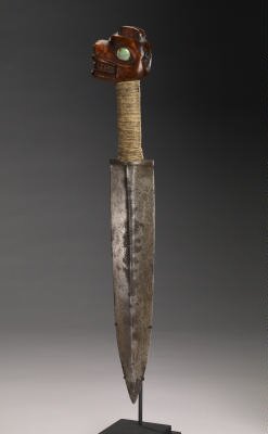

The carved head is a bit like that to be found on some North West Coast USA/Canada daggers (Tlingit).
Old 28th December 2014, 03:27 PM   #5
Hello Colin,
are you able to show examples?
Old 28th December 2014, 04:17 PM   #6
Posts: 7,298
Interesting idea Colin, though i believe stylistically the Tlingit pommels are carved a bit differently. The rest of the hilt doesn't really look Tlingit and you very rarely see a cross guard on such daggers, especially one like this. Sorry that these images are so small Detlef, but they are all i could find on line. I think these my more likely represent bear, than dog in the Tlingit culture, which genetically are really just much larger dogs (canines).

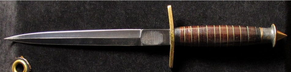

Old 28th December 2014, 04:34 PM   #7
colin henshaw
Join Date: Jan 2008
Posts: 1,432

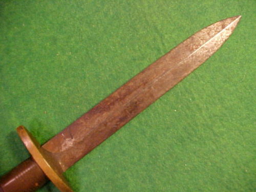

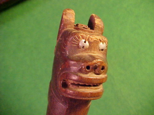

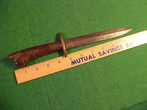

A few more...
Old 28th December 2014, 05:51 PM   #8
Hello David and Colin,
indeed a very interesting resemblance! Thank you both for posting the pictures but agree with David that the hilt of the dagger in question is different and have a more Bicol appearance, see this picture taken from the thread given in post #1. Attached also the handles from my Bicol sinampalok and the dinahong-palay from Barry.

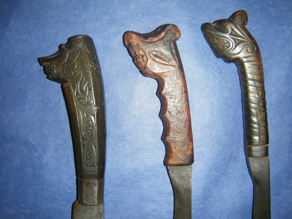

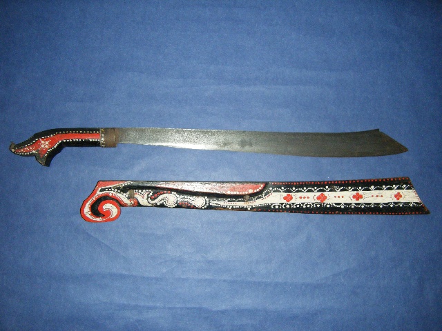

Lastly, with regard to what a Bicol knife might look like, we do have some pieces that have a town of manufacture stamped on them. The large belly, clipped blades from Iriga, Camarines Sur are a case in point and several are shown here http://www.vikingsword.com/vb/showthread.php?t=15018
Cheers,
Ian.

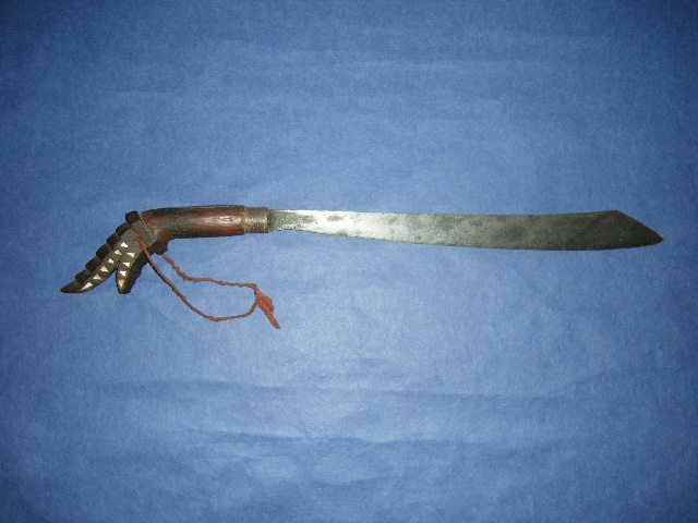

Thank you Ian for the further remarks. I am not sure to which entent this will be helpful since the terms "sinampalok" and "dinahong palay" maybe Bicolano terms. Of course I am aware that Tagalog and Bicolano relative languages but it could be that a translation will be different.
Both terms was given in the thread you mentioned in your last post from Bangkaya like followed:
Though are a number of variations of blade style in Bicol, there are basically 4 prevalent types:
Minasbad
Dinahong-palay
Ginunting
Sinampalok
This was all explained to me by a panday from Tabaco, Albay in Bicol. Unfortunately, I wasn't able to take photos since I left my camera at my friends house (we were in search of pili nuts and just happened to run into the panday.) Most of the swords pictured on this thread are sinampalok or dinahong-palay (dahon palay in tagalog=rice leaf.) The minasbad is the long sword sometimes with an elaborate guard. The ginunting has a blade that is recurved but not hooked down like the modern Ilonggo or Marine Recon ginunting. The dinahong-palay and sinampalok are similar, however, the blade on the sinampalok tapers towards the hilt where the dinahong-palay maintains a constant width then abrubtly tapers usually with a hook like projection or goosenecks to the ricasso (much like a tinamban sansibar from Leyte.) As for the figural carving, he described this type seen on this thread as inaso or aso (dog) faced carving. The other figural style is called sawa which I believe is more of a crocodile or naga form.
And the term "sinampalok" was given to me also from Zel in the same thread by email like followed:
The type you have is I believed called a sinampalok....I don't have my notes with me right now. Sinampalok is term also used elsewhere in Luzon, but I've heard referred to this blade type in Bicol. I wouldn't get too hung up with the exact name of the blade type. There are hundreds of different blade types in the Philippines and the same blade can have different names even in the same region. What's important is that it's from Bicol...but it's not a minasbad.
Now, when you have a look to the shown sword in post #16, same thread, it has the same blade shape like from two of my swords from my other thread regarding Bicol blades/swords.
Now you will understand maybe better why I believe that my swords from Bicol as well.
That my dagger in question could be a Bicol dagger I based in fact only by the handle carving (inaso) which seems to be very typical for Bicol, look for example the ear carving. All seems by this dagger originally long together thus I believe it was worked there. Of course it seems to be a atypical blade form, maybe worked on request or with a recycled US blade, who knows?

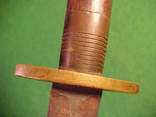

The blade on Sajen's knife looks like it could be from a US/European fighting knife (see image), or a re-worked bayonet ??
Regards.
Hello Colin,
this assumption seems to be a good one. The other alternative would be that a local blacksmith had copied such a blade.

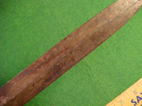

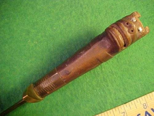

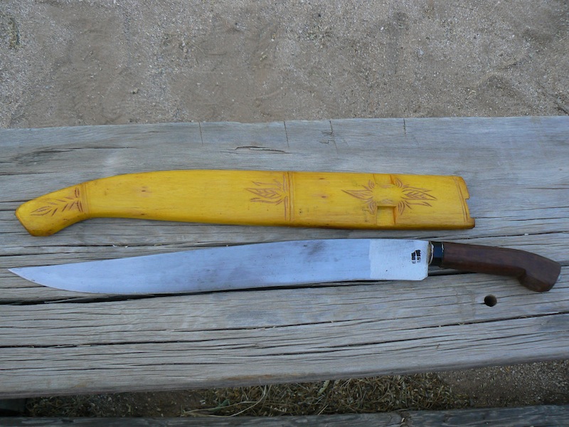

Just looking through some older threads and came across post #5 by steeldust on this thread http://www.vikingsword.com/vb/showthread.php?t=15388
"These photos are of a Dahong Palay (rice leaf) from the town of Tabaco, in Bicol, Philippines. The blade is 17" and the "tabak" was made this year. The scabbard is tied with mono filament fishing line instead of cordage. Thickness of the spine at the handle is 4.5 mm. The short sword weighs 16 oz."
The pictures are here:
http://www.vikingsword.com/vb/attach...chmentid=86499
http://www.vikingsword.com/vb/attach...chmentid=86500
Without the clear attribution from steeldust, I would not have identified this as coming from Bicol. The knife itself looks all Tagalog to me. BTW, I think the classification of this knife as a dahong palay strays quite a long way from the literal meaning of the term, and again points to the frustration (and futility?) of trying to be precise with our terminology.
Ian.

Originally Posted by Ian
Just looking through some older threads and came across post #5 by steeldust on this thread http://www.vikingsword.com/vb/showthread.php?t=15388[indent]"These photos are of a Dahong Palay (rice leaf) from the town of Tabaco, in Bicol, Philippines. The blade is 17" and the "tabak" was made this year. The scabbard is tied with mono filament fishing line instead of cordage. Thickness of the spine at the handle is 4.5 mm. The short sword weighs 16 oz."
Ian.
Agree, nothing would let me think that this blade coming from Bicol, the scabbard maybe a little bit. Vexing is also that steeldust used two different terms for one sword. Would be interesting if both terms was given to him from the seller. Here we have again the "name game". But it would be great already when we would be able to tell from where a blade has it's origin.
