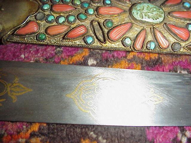

With all due respect and admiration, I am very uneasy about the state of koftgari: isn't it incredibly intact on the background of a heavily cleaned blade? And the crosshatching looks as new as the day it was made ( Hm-m-m-m....)
Opinions of professional blade restorers ( Battara, where are you?) would be intriguing.

Ariel, your opinion is very valid. Not only state of coftgari is questionable, but the way/quality of application. It is not "True Inlay", as one would expect on true quality Pala blade. Moreover, it's poorly executed, considering authentic examples. I suspect the whole blade is new (relatively) and I've seen similar Pala blades coming out of India. I have a picture somewhere and will find/post it soon.

10K would be a Great Deal IF this Pala would have authentic blade and coftgari. As Ariel noted, both look suspicious, i.e. not authentic, and I suspect even new. Any other opinions/observations?
Old 24th January 2008, 04:50 PM   #6
I am not saying the blade is new/replaced: it fits the scabbard very well. Taking into account the complexity of this particular scabbard and the need to create custom scabbards for each individual blade ( to account for the curve), I am sure that the blade is authentic.
The inscription, IMHO, is very recent, however.
So, the question will be: does a Kilij/Pala with a sumptuos furniture but with an unembellished, likely unmarked, blade justify such a high price? I think, yes. Not long ago, a somewhat similar sword, with (likely) ruined blade but with gorgeous furniture was sold for ~$20K. It was bought purely for the scabbard.
The price is a matter for the buyer: perhaps, he has a client to whom he can resell it for twice as much.
The real question is: is it legitimate to embellish blades with inscriptions to make it more attractive but in exchange to cloud the origins of the sword for future research ? If, as I suspect, the koftgari is new, the true origins of this Pala are now contaminated with erroneous information.

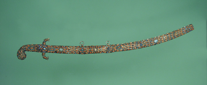

Have always thought this type of sword to be styled after the Sword of the Prophet kept in Tokapi Palace Museum pictured on page 15 in Yucels book, Islamic Swords and Swordsmiths. This sword has a gold scabbard/hilt adorned with rubies and turquoise.
The 18th/19th C. similar swords have a copper scabbard/hilt that has gold over a silver wash with coral and turquoise in bezels. The blades in the latter examples vary from a low quality blade to a high quality kilij. Most often the gold koftgari on these blades is a fairly low quality but occaissionally a nice example is found.

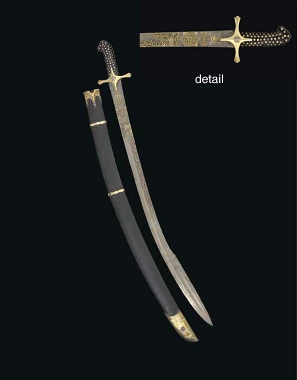

The attached example is from the early 18th C. and has I high quality kilij blade, also with low quality koftgari.
Have a photo of the Prophets sword but could not make image size small enough, can email that pic to anyone that would like to see it.
These are very desirable swords and highly sought after.....

Thank you for posting that example Rand! One cannot deny these are beautiful swords and while the lavish mounts may be considered ostentatious by some, as artwork thier effect is pretty amazing.
Perhaps you might recall the Islamic pamphlet I mentioned in my post from yesterday, I think it was Rich Wagners collection but since from memory, who knows
I mentioned in my earlier post also that I thought this might be an old blade that may have been embellished for either presentation or diplomatic gift. Perhaps I might ask for your opinion on that idea.

JUDGEING FROM THE OBVIOUS GRINDER MARKS SEEN NEAR THE ENGRAVING I WOULD DEFINITELY BE SUSPECIOUS OF THE BLADE BEING TAMPERED WITH. IF THE BLADE IS OF GOOD QUALITY AND OLD I CAN'T TELL FROM A PICTURE. AN EXPERT COULD PROBABLY TELL MORE IF IN HAND AND COULD ALSO SEE IF THE CORAL AND TURQUOISE WERE OF THE RIGHT KIND WERE GOOD OLD PIECES OR NOT. IN ONE PICTURE THERE IS ONE PIECE OF CORAL MISSING WHICH IS A GOOD SIGN.
CONSIDERING THE PRICE THIS BROUGHT AND PRICES STATED OF OTHER SALES IT IS LIKELY SOME FORGED EXAMPLES HAVE BEEN MADE OVER THE YEARS. THIS HAS HAPPENED WITH OTHER EXPENSIVE SWORDS THAT WERE IN DEMAND OFTEN SEVERAL TIMES DURING DIFFERENT PERIODS ON THE OLD ONES. I DO HOPE THE BUYER GOT HIS MONEYS WORTH AND ENJOYS HIS SWORD, BUT IF IT WAS JUST BOUGHT FOR RESALE OR INVESTMENT PURPOSES THE SWORD IS NOT IMPORTANT JUST THE CASH PROFIT OR FUTURE VALUE.

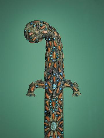

photo of the Prophets sword from Yucels book that is Topkapi. the scabbard is gold with rubies and turquoise.
According to Tahsin Oz the scabbard/hilt are 16th century additions

I would not dismiss an idea that the blade is/was replaced because I've seen these swords and know people who can modify ANY scabbard for ANY blade and make it look 100% authentic. Looking at just pictures one will NEVER tell.

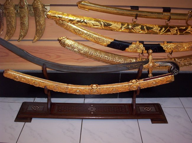

Below is a picture of newly made Pala sword. The blade of classical Kilij form was just made in India. A new coftgari is being applied as you read this post somewhere in Syria...:-)

The koftgari I agree is a later addition as Rand said. I took a look at the pictures and the quality is more in keeping with that commonly coming out of India now. I think it may be that it is a restoration based on the remnents of what was originally there (I would hope anyway ) and if so I would call it a restoration. As restorers they may have had to re-cross hatch the area to have sharper grooves to "catch" the koftgari. This would of course not be true inlay but koftgari on the surface.
