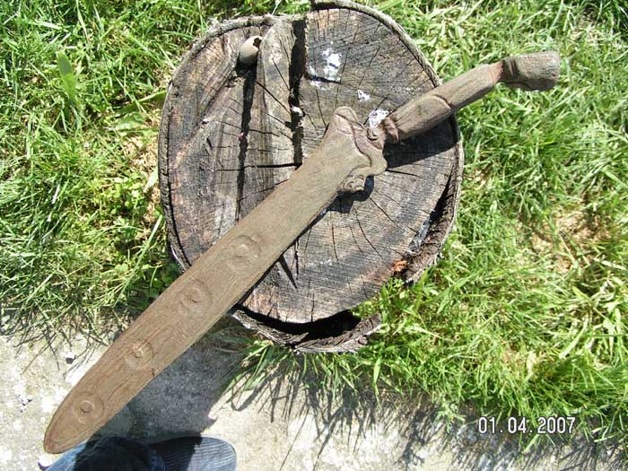

hi
my new keris.
your opinion !!

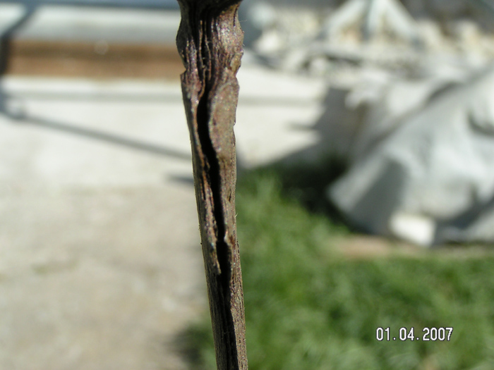

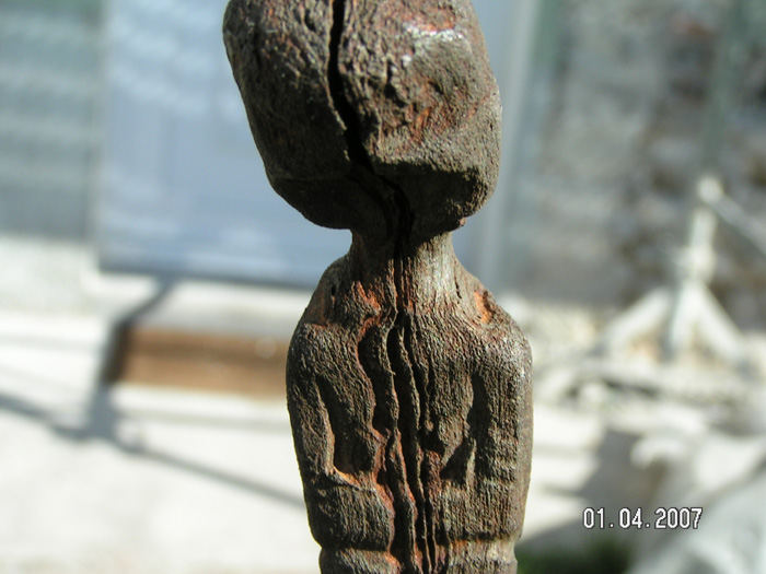

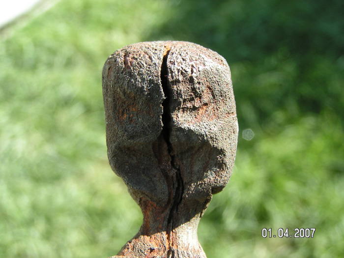

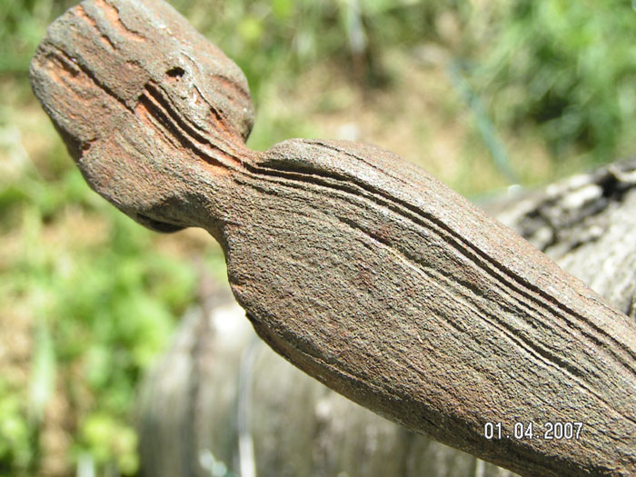

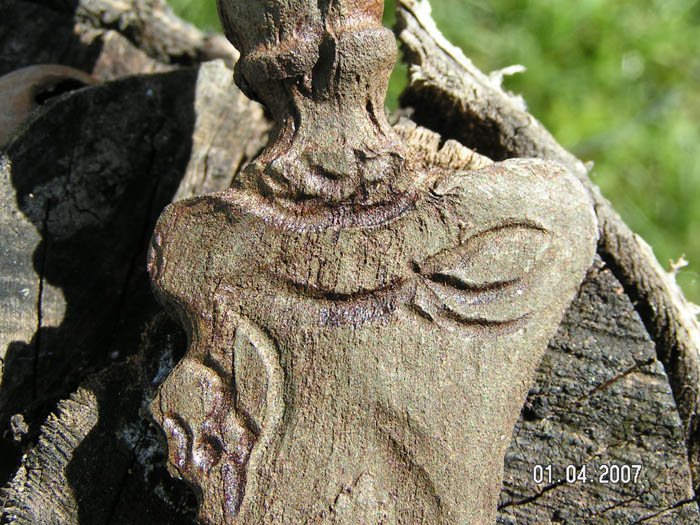

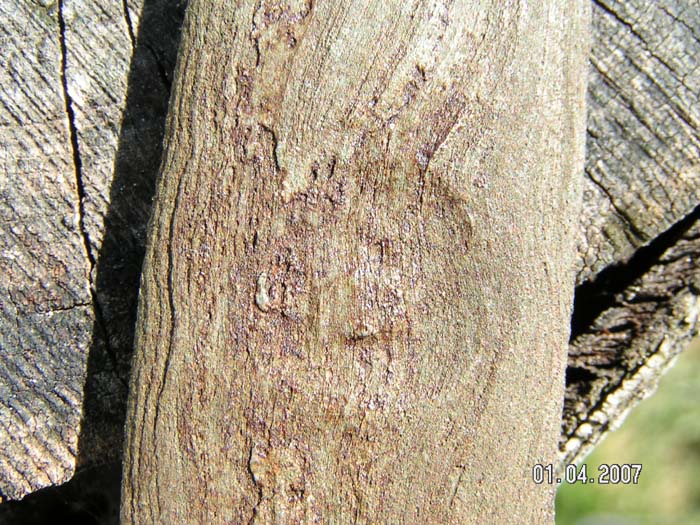

It looks like an old keris sajen, but the carved features at the base of the blade do not look quite like any i have seen before. Could you post a photo of the entire keris and a clearer and perhaps closer image of the gandik? Does the close-up show an indentation in the blade. Perhaps this keris is also pejetan, though that usual involves more than one indentation.
Judging age on these keris is always difficult. They are sometimes mistakenly referred to as keris majapahit, though most of the ones you see are rarely from the mojopahit period. They are talismanic offering keris and are still made today. Often the new ones are aged and sold as old, but yours appears to have some real age.

Old 1st April 2007, 07:07 PM   #4
galvano
galvano's Avatar
Posts: 178
Default other
other photos

I would agree Rick, now that i've seen an overall look at the keris. It's funny how you can get one impression looking very closely at things and another once you've stepped back. It is still very interesting. I like the little naga gonjo iras.
I would say the the 4 impressions on the blade are not what would be called pejetan as i don't believe these were done with the finger tips of the smith as pejetan would be. Did it come with a sheath?

dear Galvano an list
Yes I agree with other list. This is keris sajen but unfortunatly this keris is too nice to be a Real keris sajen . the sajen means (offer). this keris popular as the ceremonial offer in Majapahit era 13th -14th centuries. This kind of keris mostly escavated near Mojokerto, east java
Most of keris sajen has no pamor, gonjo the form is hardly simple.
anyway this is nice keris. isn't it David?

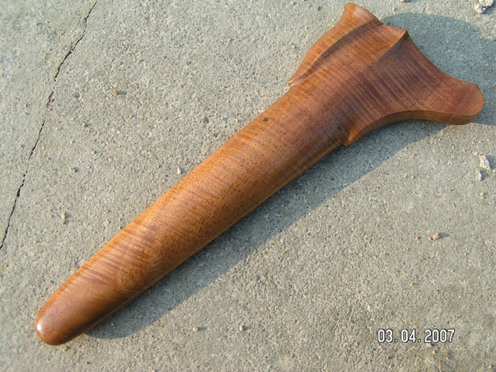

Default scabbard
yes david but the scabbard is very very new !!

Lelang, i think you will find that the use of the keris sajen as a talismanic object extends past the Mojopahit period as there are examples to be found through every century after to date, Though recent ones like Galvano's are obviously aimed at the collector market this probably wasn't the case with 16th or 17th century examples.
Galvano, i think many people look at keis as an ensemble. You may have noticed that when keris are posted on websites there is often a pic of the keris fully sheathed along with the others. This overall appearence of the sheathed blade is an important part of assessing the keris, so please don't disregard your sheath simply because it is new.

Your wrongko is really quite nice, i think. Beautiful wood in a Sandang Walikat form. This is a form usually meant for storing, though i believe it is also acceptable in some cases for daily wear and i have seen a few more extravagant example which were no doubt meant for wearing. All my talismanic keris use this sheath form, which i suppose makes sense since they are not made to be worn like regular keris are. If i am not mistaken you will find that this sheath, though appearing simple in form, is probably carved from a single piece a wood, which is no easy feat. Thanks for showing it.
