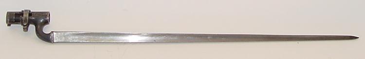

Hi Tim, the socket must have been 'straightened out' to be 'inline' with the blade....or cut and re-attached....Here is a picture of a British Martini Enfield pattern 1876/95 Egyptian bayonet. The Martini was the usual issue in Sudan at the time of Gordon. Seems likely to be the donor for your dagger.

Posts: 6,026
This dagger has been made from the top section of the type of bayonet that you post. There is a metal tube that makes the basis for the grip. I can not tell if that is also part of the original bayonet. The tube is filled with a hard black substance formed to a dome at the end of the handle. It appears that some kind of tang has been peened over on top of the dome. I will investigate further tomorrow.

katana
katana's Avatar
Location: Kent
Posts: 2,658
It makes sense that the tube was cut off. If the 'socket' (of the bayonet)was to be bent down ....(so as to be straight to the blade)....it would need high localised heat which would affect the temper of the blade....almost certainly to its detriment.
