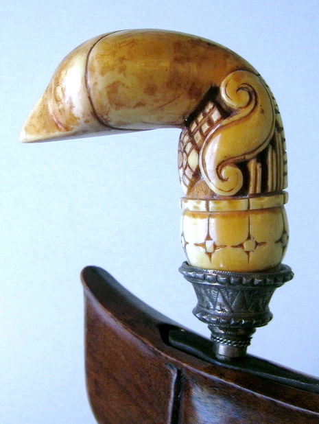

Hi all,
It's been quite slow on this list for a couple of days and I hope you could help me learn some more about this Keris.
It was collected in Minangkabau but I think it looks like it has influences from Gayo/Aceh as well as Bugis?
The hilt is described as an Indragiri variation in the book Hulu Keris.
What do you think about the origin of this Keris?
And what do you think about the blade?

I know little about Sumatran keris. I know even lesser about this keris. But here goes.
I kind of agree with Indragiri opinion of the hilt (Pg:65, Fig:107).

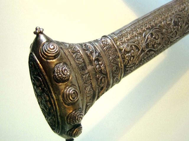

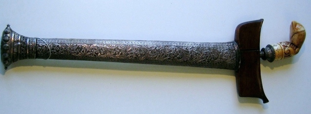

For the sheath, there is quite a gap, when the blade is sheath, which suggests, the blade is not original to the sheath, or vice-versa.
The pendok's buntut looks similar to this piece.
http://www.kampungnet.com.sg/modules...view_photo.php
Wide, flaring with whirls decor. It is however not the same as Gayo style.

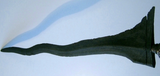

The blade, hmmm... tricky. Could it be a Javanese trade blade, dressed in Sumatran style? The blade design is Dapur Pulanggeni. Just my thoughts.

Michael,
To be honest it looks to me as a composed keris. I love the dress, but the blade doesn't fit the sheath. I think Alam Shah is right that the blade is javanese, not uncommon to find a javanese blade in Sumatra and in a Sumatran dress, but the sheath wasn't made for this kerisblade.

On the gap I don't think it's that prominent.
When in the sheath it fits tight and doesn't move or "rattle".
But you are correct that there is some small space on the top of the sheath.

Hi VVV
is it just the photos or is the hilt not a good fit in the hilt cup?
DrD

I think the keris doesn't fit the dress because you can see on the picture that the blade doesn't fit perfectly in the wrangka. In my opinion the blade was put in this scabbard because the blade was going in and had a reasonable fit. So the sheath was a replacement.

Michael, could you post a photo looking down on the top of the sheath with the keris in it so we can better see the fit. From the photo you provided i would also venture that this sheath wasn't made for this blade. As for the blade origin, My first thought was also that it might be Javanese. Still, if i am not mistaken, you will find many Sumatran blades that look very similar to blades from Jawa as, i believe, parts of Sumatra where once under the influence of the Javanese court and therefore made their keris to Javanese specifications of the time.
BTW, the hilt is beautiful!

It's to dark here now for pictures now but having a closer look I agree with you all.
The length of the blade is matching but the opening in the sheath is to big for the Keris.
So I agree that the blade probably isn't the original for the sheath.
I was to excited about the Indragiri hilt and the strange sheath to think about it.
Do you think the hilt and the sheath belong together?
I haven't seen any Indragiri sheaths to compare with myself.

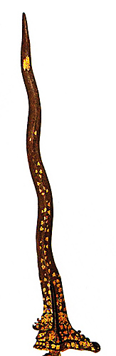

Here are two images of Si Ginjei.
I apologise for the quality, they are scanned images.
This historic keris was supposedly made by Empu Kinom, and is a Mataram Sultan Agung keris.
It was gifted to the Sultan of Jambi, so we can assume the wrongko and handle are representative of old Jambi style.
I have seen old keris attributed to Palembang that had dress so similar to this that I could not distinguish any material difference.
