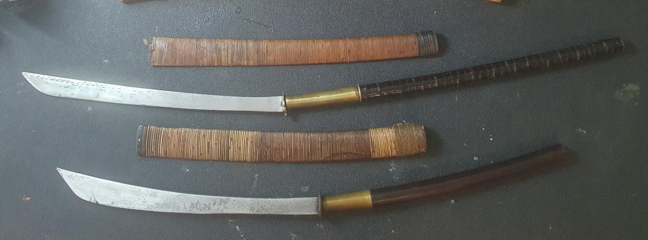

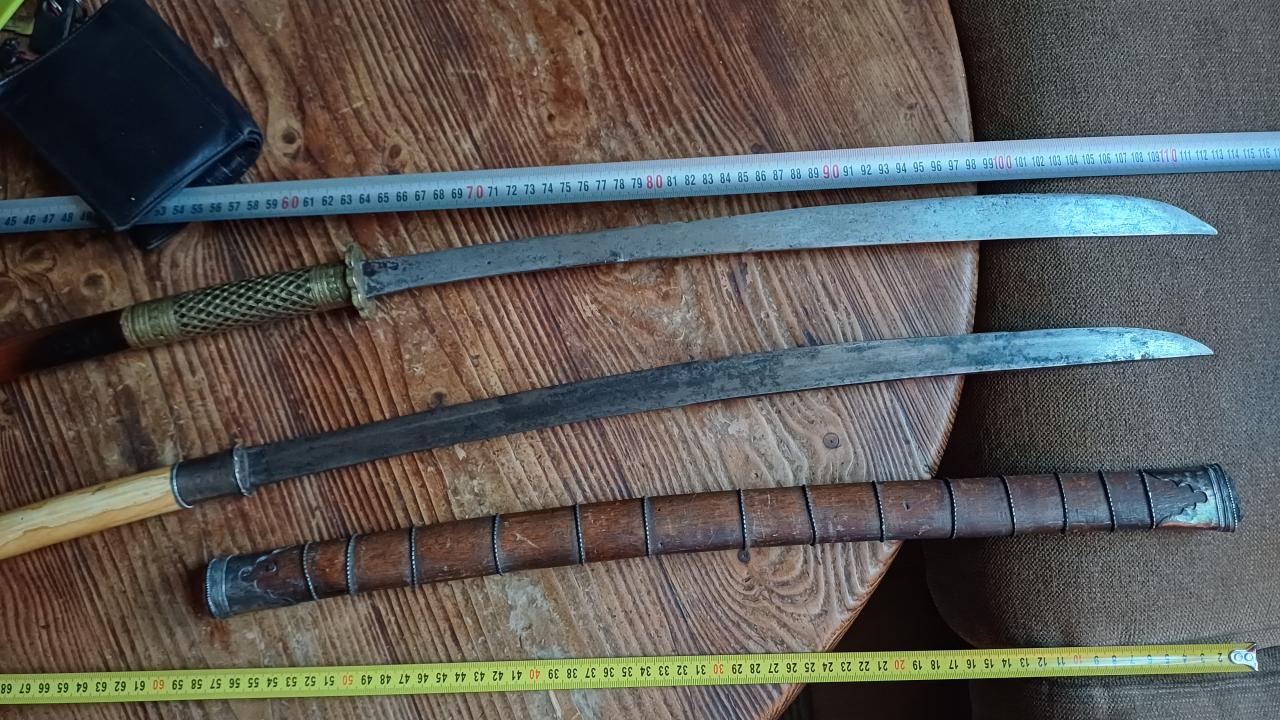

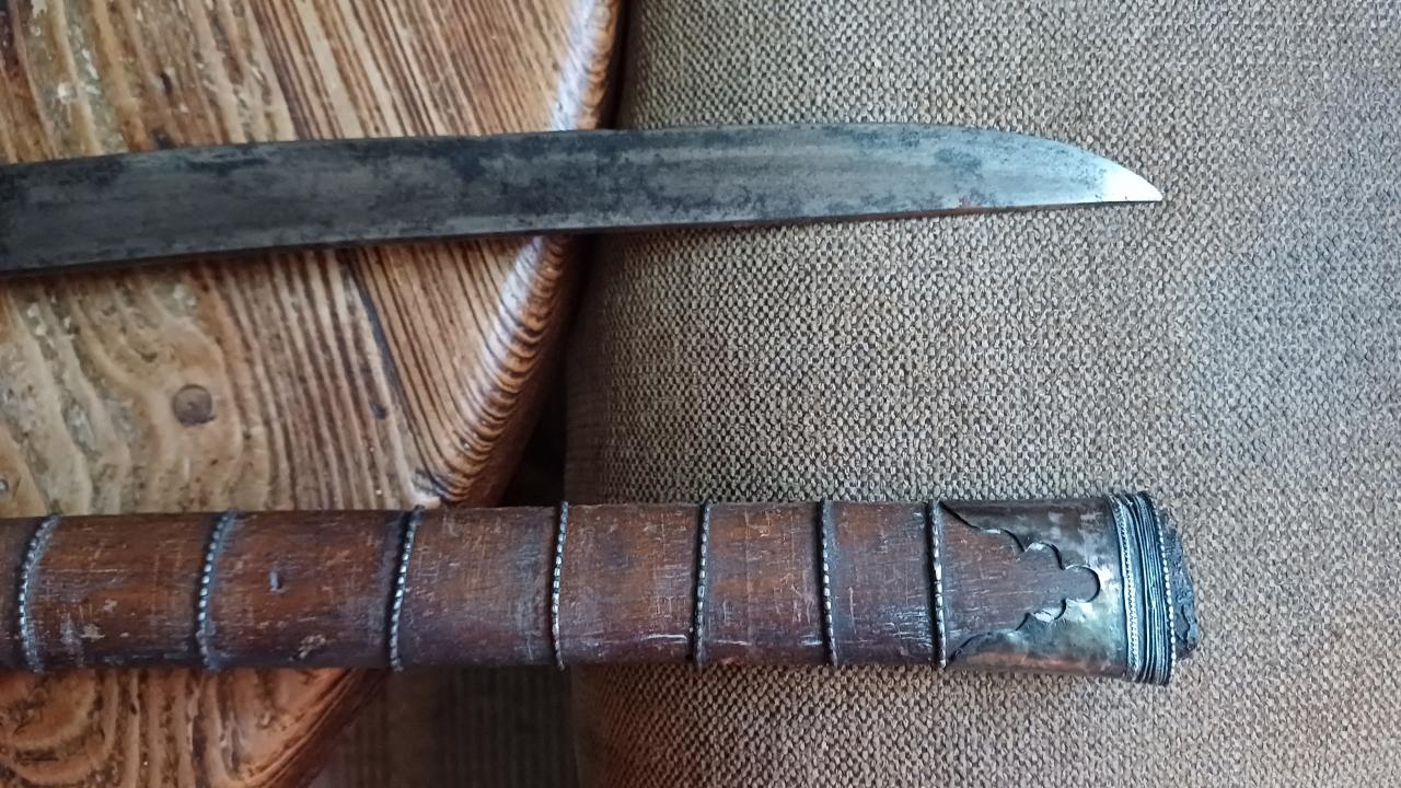

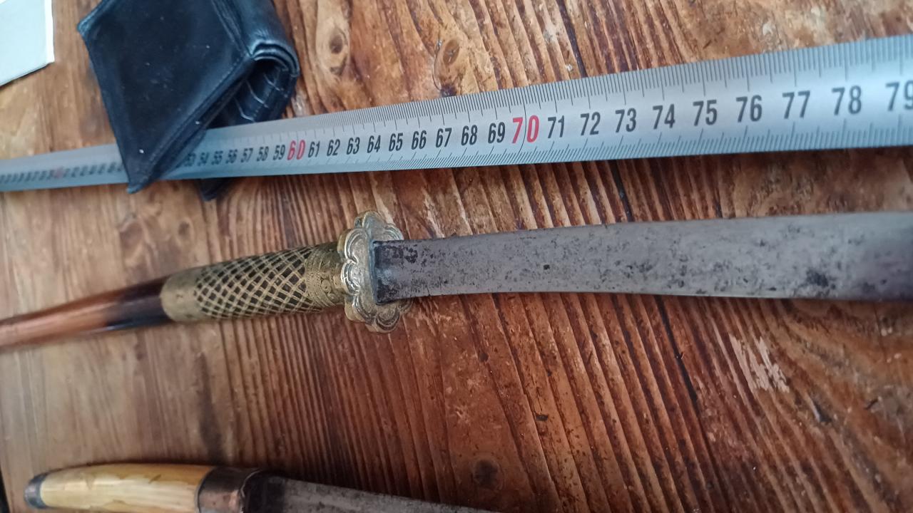

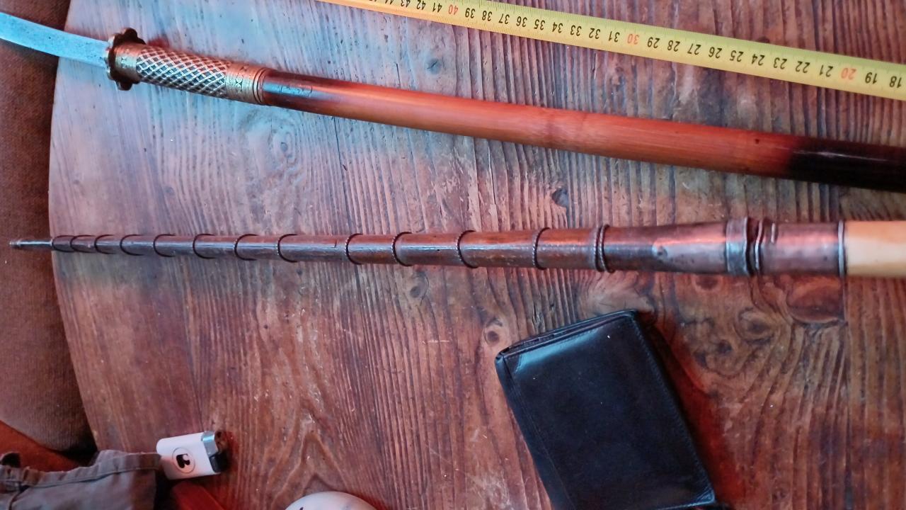

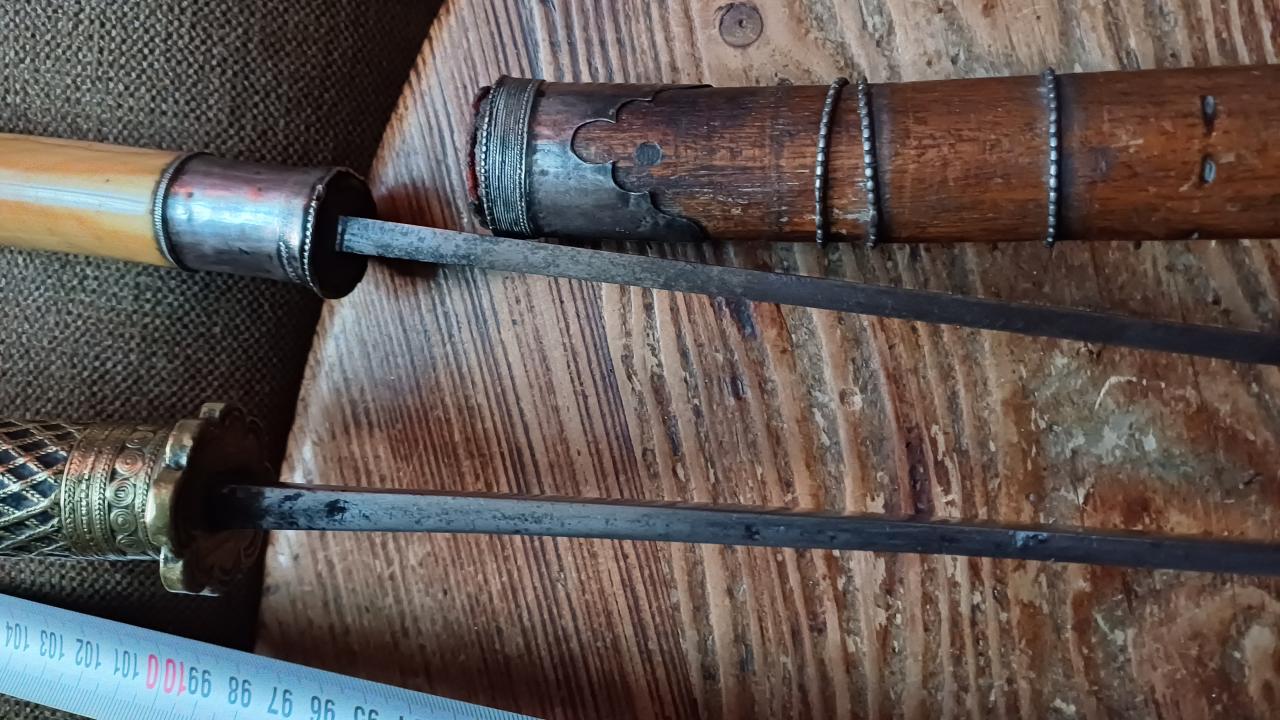

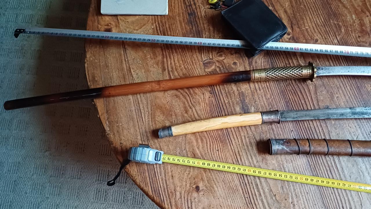

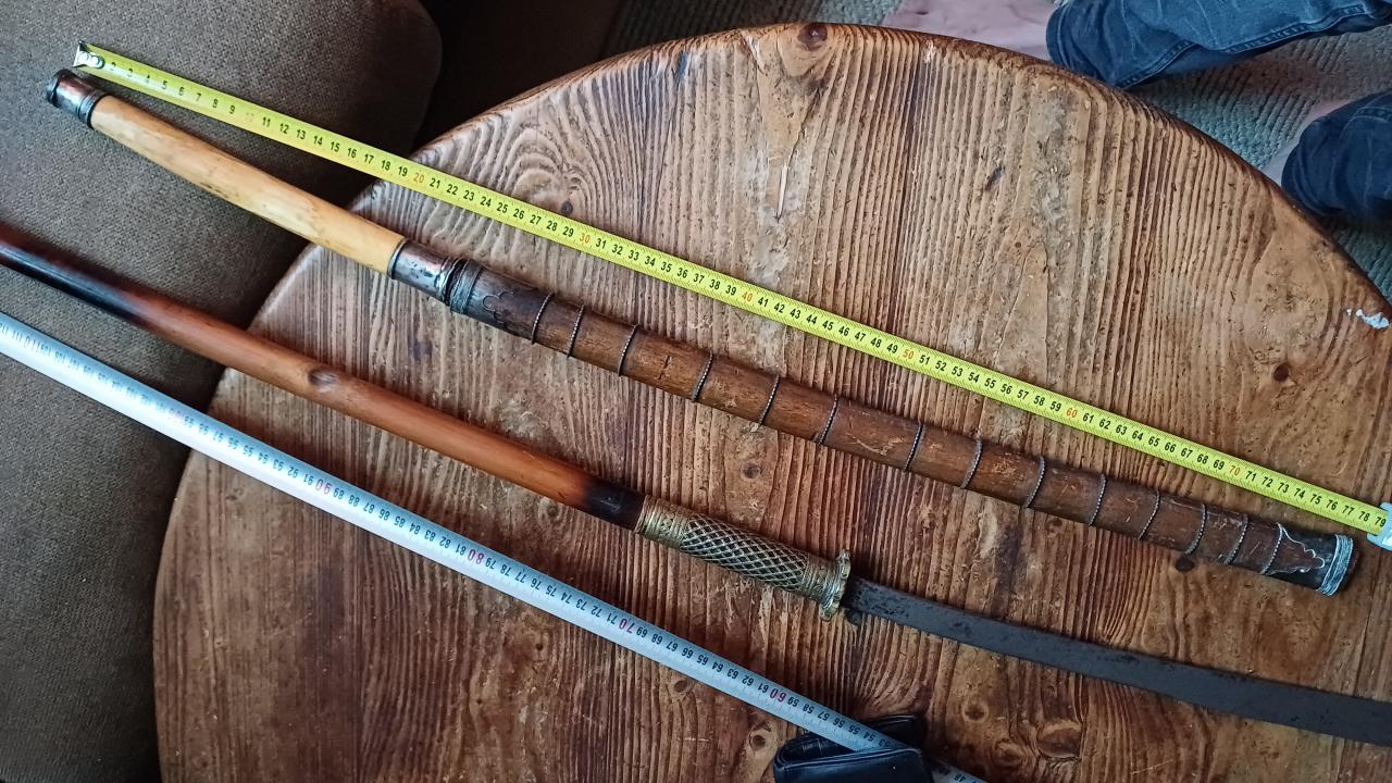

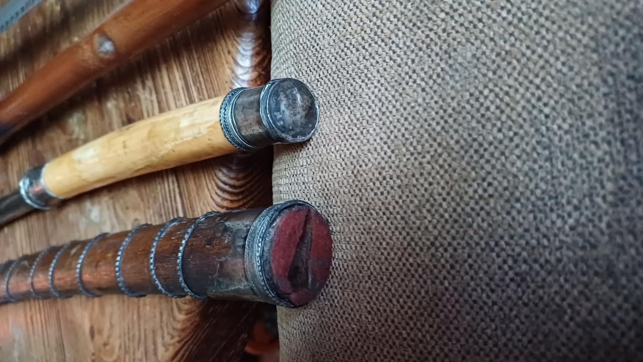

I have these two dha/daab/dhaab/dharb variants. I've had the smaller one for a while now and the larger one was delivered to me in person today by a fellow collector who I know lurks on this forum. I thought I'd use the opportunity to document both swords here and ask for your input on the region, culture/ethnographic group, and period of origin, or any other information you could add, since I have had some difficulty finding sources on mainland SE Asian weapons.
__________________________________________________ __________

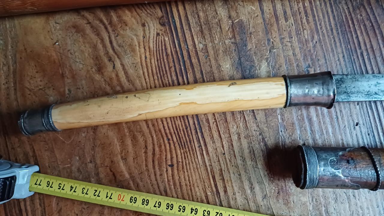

The smaller one was sold as Vietnamese but I suspect that it is Birmese given the relatively short grip and the presence of a fuller on the blade. But that is just a best guess based on very limited data.
Some stats, for those of you who like that sort of thing:
77cm total out of the scabbard.
Sword 472 grams.
Scabbard 130 grams.
24cm grip.
Tapers slightly from 25mm near the blade to 22mm near the end.
53 cm blade with a very shallow fuller. Spine transitions from flat to triangular about 24cm from the base of the blade (but no false edge).
Profile tapers very slightly from 22mm to 21mm and then swells slightly to 24mm at the cutting portion of the blade.
Distal taper from 7.5 mm at the base to 3mm at the end of the fuller and 2 mm just before the tip.
Maximum curvature 30mm measured by taking the distance beween the blade spine and a straight line from the back side of the tip of the blade to the back end of the pommel.
POB 6.5cm from the base.

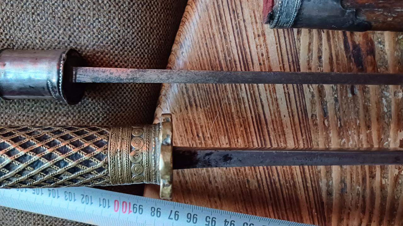

Silver fittings on the grip and scabbard. Red velvety or felt cloth on the scabbard mouth. The scabbard is a reddish wood and tapers distally from 28mm at the mouth to 12mm at the tip. Some loose strands of silver wire at intervals around the scabbard.
Not sure if the grip is bone or ivory, though I'm guessing the former. The blade is a bit worn but the construction is solid.

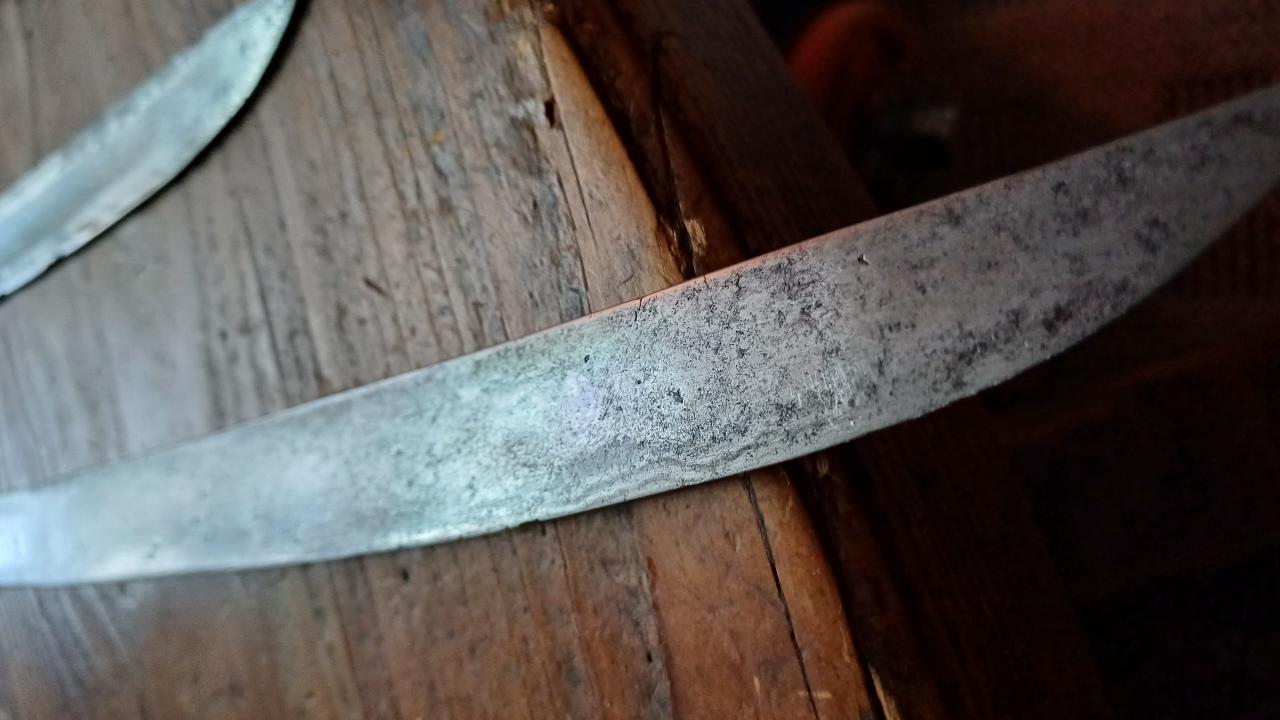

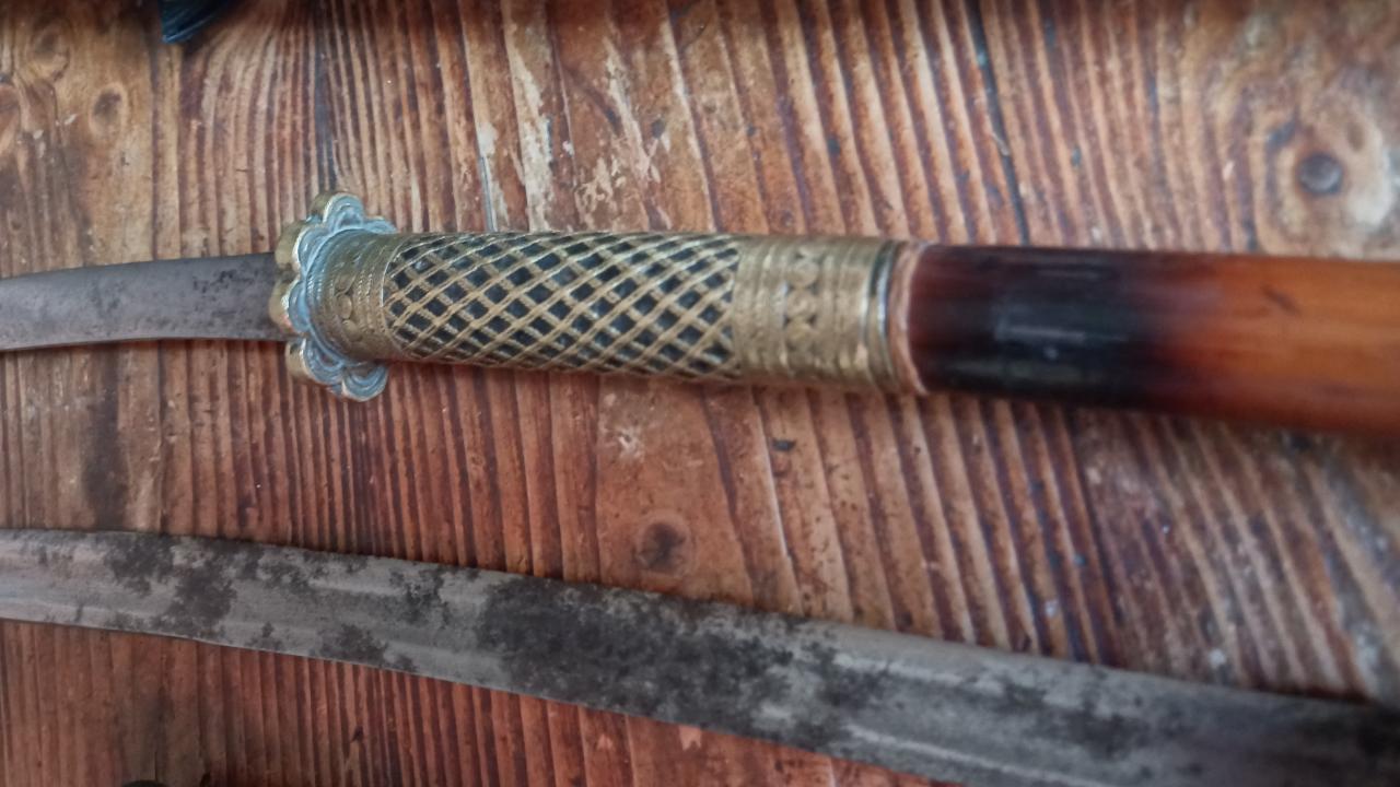

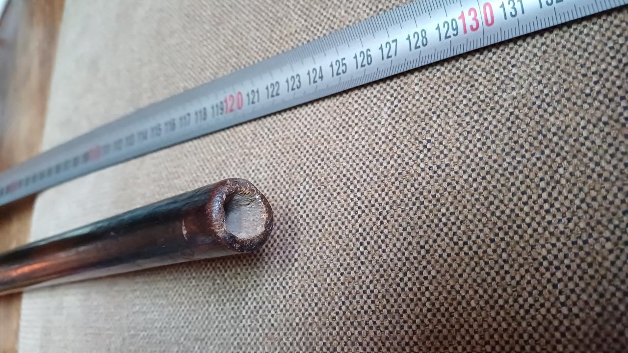

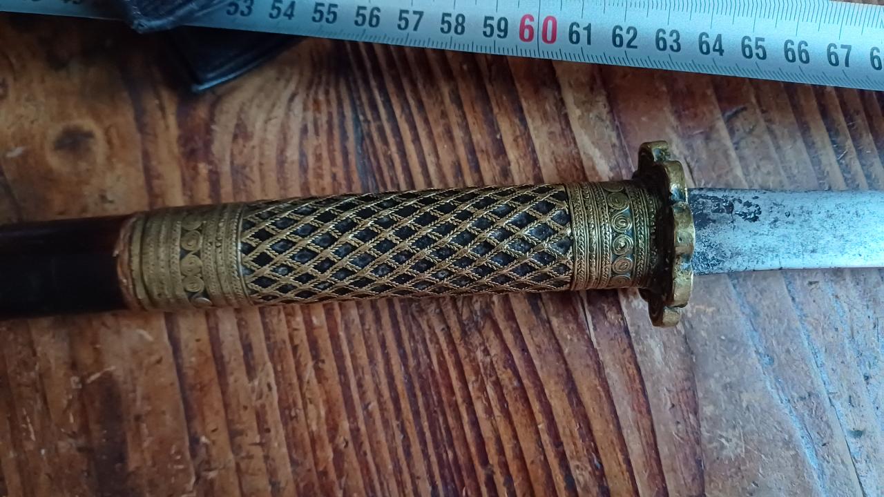

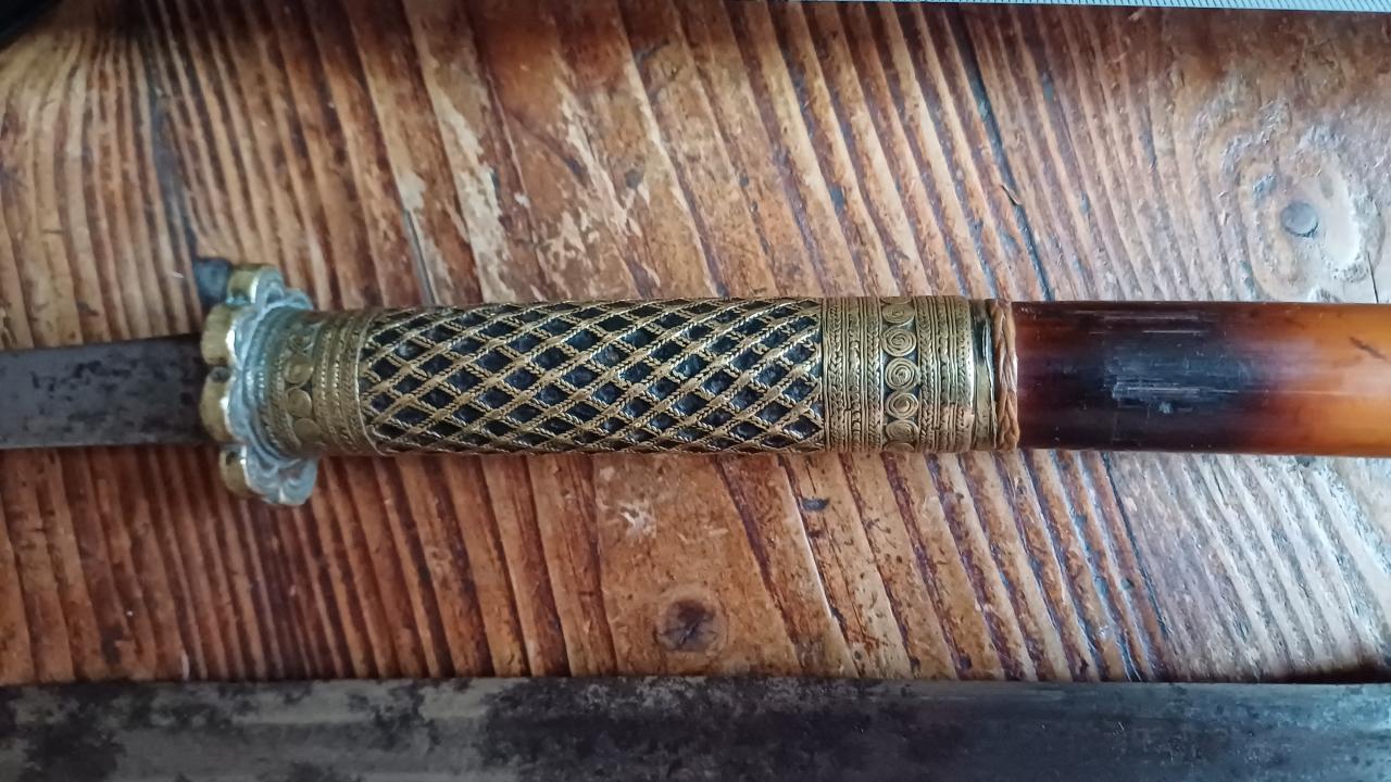

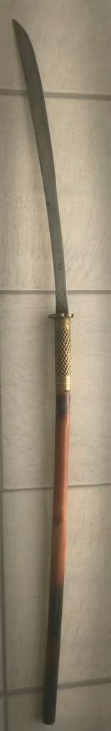

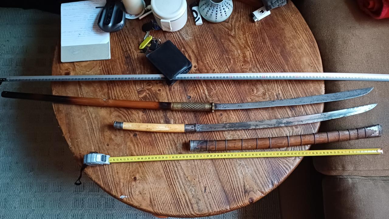

The longer one was sold as a Hmong / Laotian Montagnard dha. Blade is laminated. No scabbard for this one. Hollow grip, maybe bamboo? Nice copper or brass wirework with swirls and mesh on the grip with a miniature "tsuba" (I don't know the local term).
Stats:
113cm total.
557 grams.
65cm grip including the tsuba, which is .5cm.
Grip is approximately round and 23mm thick on the wooden part, 26mm on the wire grip part.
Tsuba is 43mm wide along the blade and 34mm along the orthogonal axis.
48cm blade.
Blade profile starts at 21mm, then tapers to 19mm and then swells to 25mm.
Distal taper from 9mm at the base to 1.5mm just before the tip.
Maximum curvature 50mm measured by taking the distance beween the blade spine and a straight line from the back side of the tip of the blade to the back end of the pommel.
POB is exactly on the tsuba.
Very interesting sword (almost a polearm, but due to the overall size it still feels more like a sword).
Both are quite sharp. More pictures to follow in my next two posts on this thread.
I'd love to know more about these two swords in particular and south east Asian swords in general, so any insight or background information you have, or any references you could recommend would be greatly appreciated.
I found the following threads on Montagnard dha useful so I'll link them here:
Montagnard Dha tribal association?
Montagnard Dha Sources
Hoping For Some Help Identifying the Origins of this SE Asian Highlands Weapon
what is it?
Montagnard Daab, Dha

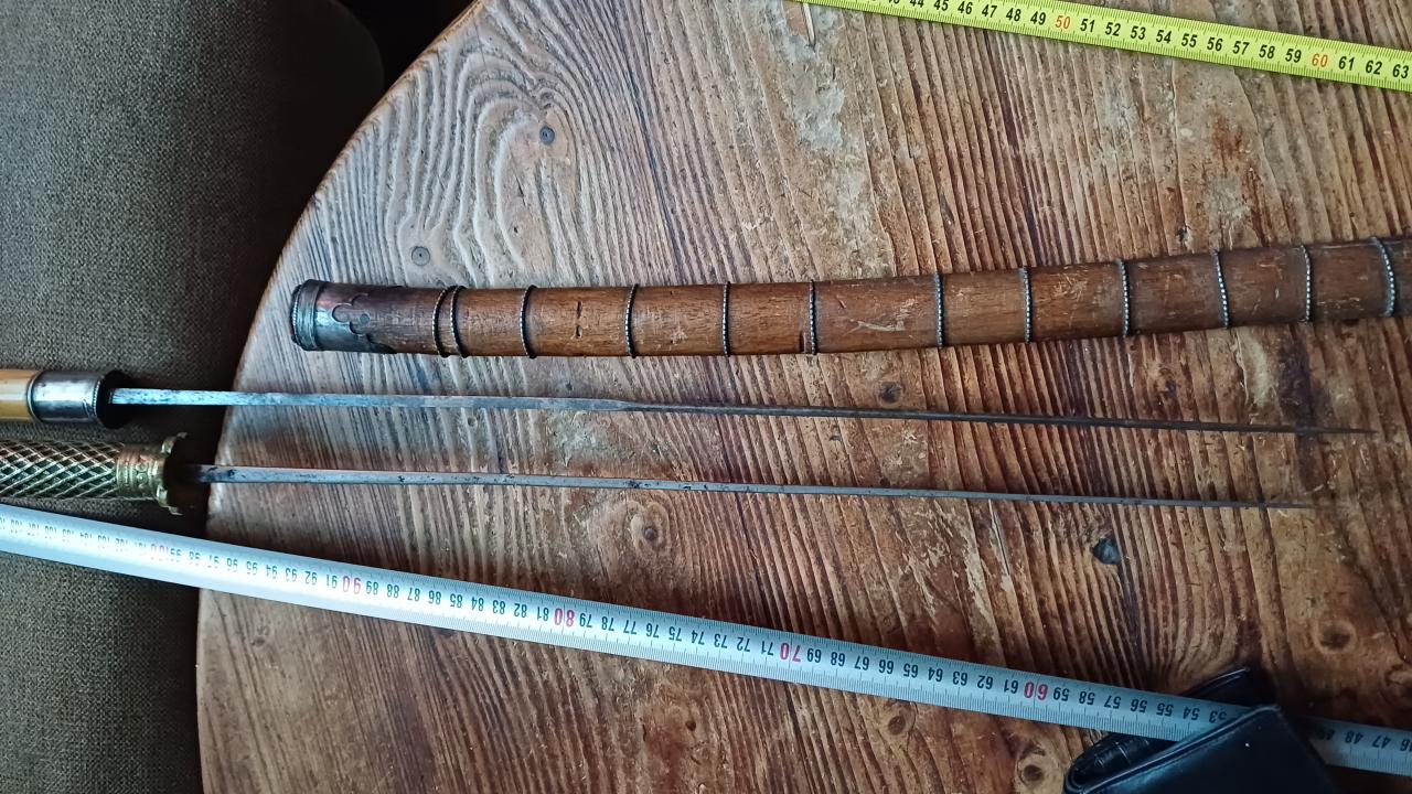

Pictures #2 / 3.

Pictures #3/3.
Old 7th July 2024, 09:00 AM   #4
Very nice dhas!
And you're correct, the shorter one is Burmese and the other one, which I like very much, is a so-called Montagnard dha.
When you want to part with it, please let me know!
And yes, the handle material by the Burmese one seems to be ivory and by the Montagnard the grip seems to be made from bamboo.

Is the Hmong / Laos attribution indeed the most likely one?
Is there anything known about the handling of the Montagnard ones? It has the proportions of small polearms but feels more like a sword, which puts these in a sort of strange and intriguing no man's land for me. This one is light enough for single handed use, but presumably that is not how they were wielded, as the long grip makes it somewhat awkward.
If anyone knows of a youtube video that shows their use it would be instructive.

The so-called montagnard dha is not associated with the Hmong. It is from southern Laos, northern Cambodia and the border areas of Vietnam. Commonly the style is called after Attapeu in Laos which is a major regional center for both Lao and hill tribes.
This example is a hill tribes variant, the long handle is not for two handed use but rather a reflection of the multi purpose use of this sword. The long handle serves for common tasks like harvesting hard to reach fruit etc. They are used as single handed swords in combat.
The pattern of the casting is found also on shorter hilted swords.
Thanks Iain. I was wondering whether these might double as agricultural tools but the fact that it has a (minimal) handguard of sorts threw me. I'll have a look at the forums for other forms of dha with similar decorative casting. Maybe the second from the top and bottom swords in this post of yours?
EDIT: Closeup from here
Also the swirling patterns look a lot like this post by Detlef in the first thread:
Interesting that you say the Montagnard dha swords are not associated with the Hmong. The seller mentioned that he lacked expertise on this region but that he had made the determination based on what he read on these forums. I think the Hmong association was specifically based on #3 in this post by Ian (and possibly corroborated by this post by Jim).

The fully cast handle ones are weapons. The long handle ones are both. You have to keep in mind that in this part of the world even today you don't go out in the hills without at least a large knife/machete. So some of these are true daily carry swords/tools. Regarding the fully cast hilt examples I'll PM you a couple articles as I don't want to spam the forum with my own links.
There are several varieties of casting patterns found on these. The cross hatched pattern seems, in my experience, to be a more recent style compared to the intricate swirls and whorls on some of the very old ones I have.
This is part of the problem of labelling a type with a label like montagnard which I quite dislike. Yes the Hmong use swords but as far as I'm aware they are not associated with this type. Rather I have seen Hmong with rather long knives/short swords with short handles with a slight downwards curve. Of course some may use other types, I can't claim an extensive knowledge of all Hmong groups in the region.
There are a multitude of groups in this area like the Bravo, Katu, Ta Oi etc. compounding the issue of attempting to label everything by tribe is that weapons were traded, including blades, castings might be acquired from a different village, town or craftsman as well. Because of this I prefer regional attributions.
I have to agree that there are few Hmong in southern Laos, as noted by Iain. They are concentrated in the northern half of the country. The Hmong attribution for the sword in question was given to me by an English dealer who professed considerable knowledge of dha/daab. This was before I established some reliable contacts among the Hmong who had immigrated to the U.S. and live in Minnesota. I don't know the tribal attribution for that sword.
"Montagnard" is a French colonial word, simply meaning "mountain people." The Hmong are "mountain people" who live mainly along the western border of what is now Vietnam. Their range abuts Laos and Cambodia, and may extends into Yunnan. As Iain notes, there are many different hill tribes in this area.

As a final question, can anything be said about the age of both these swords? They were both listed as "late 19th century", which may well be correct, but that often seems to be the dating equivalent of "shrug?" in the antique sword world.

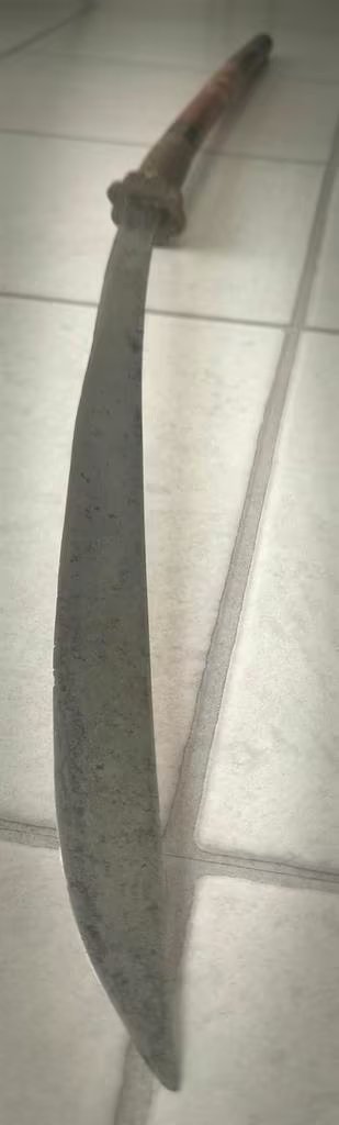

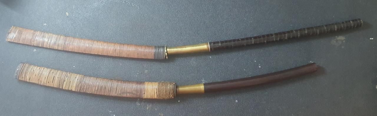

I have two Montagnard dha said to be collected in the Central Highlands between 1967 and 1969 by a US serviceman active in that area.
Are they documented on the forum somewhere? If not, please add pictures!

Late 19th century is most likely correct although both could be early 20th century as well.
Old 9th July 2024, 11:04 AM   #15
JeffS
JeffS's Avatar
Join Date: Sep 2005
Location: Singapore
Posts: 467
I haven't gotten around to proper photos yet, so a couple of quick workbench photos will have to do.

Thanks for the info Iain! And thanks for sharing your examples JeffS. Nice that they both retain their scabbards. Makes me wonder what the scabbard on mine would've looked like.
