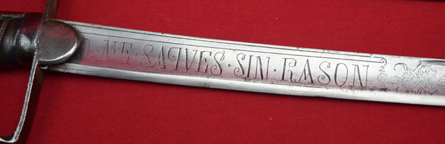

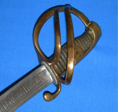

Wouldn't this one be Spanish ? .
The first one is from about 1660, blade possibly Italian. Toledo production by then was minimal.

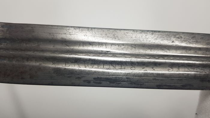

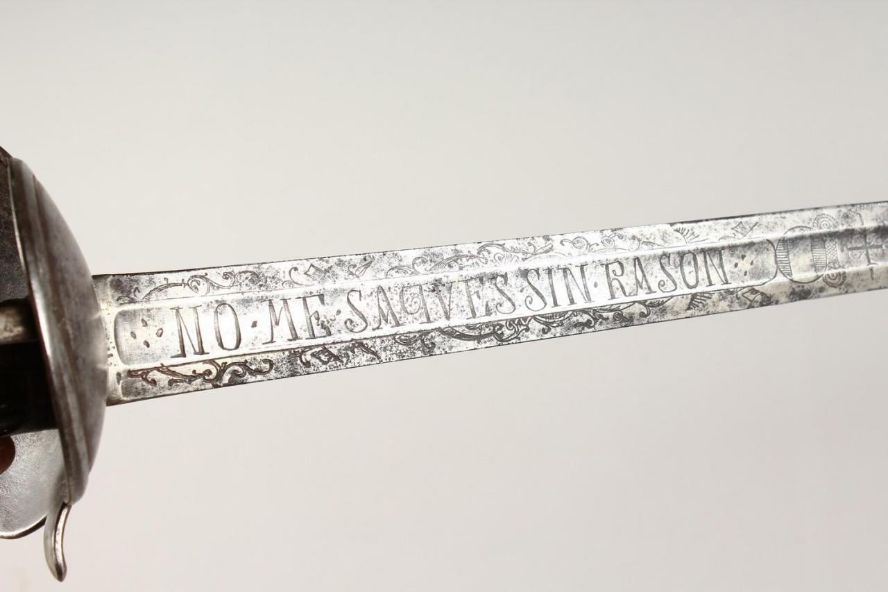

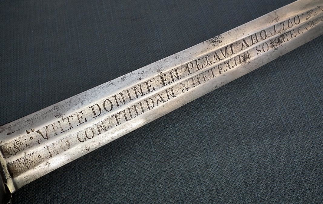

First one I believe Solingen. About 1760. Toledo was starting again in 1762, with Toledo and date etched on the blade. Possibly they are the same blades as some of the ENRIQUE COEL ones (there are 3 types of ENRIQUE COEL blades in 1728s).
Then, 3 from Halbach. Third one with a Batavian republic hilt. 1775-1810? Many have Montmorency blades.
Mexican machete probably Halbach.
Then two Solingen, after 1820, one marked by Knecht as well. For the Soth American Republics market.
Last one, also Solingen about 1740, in two lines. Easy to mistake with the blades 100 years younger. Central channel is narrower.
I have five "no me saques", 3 from Halbach, one unclear, one from Solingen after 1820.

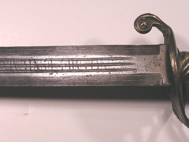

Old 11th April 2024, 10:11 PM   #8
midelburgo
Join Date: Jun 2005
Posts: 298

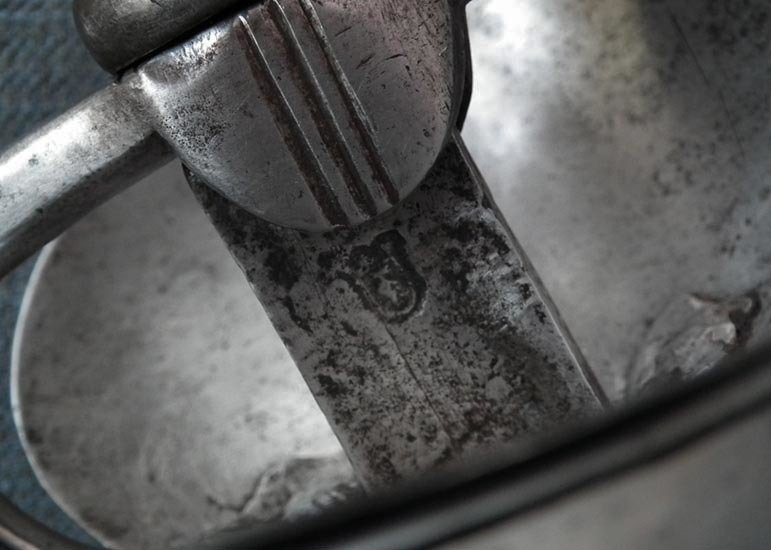

Why the first one is Solingen?
You saw the two groups of 4 points in lozenge?
Sometimes they are inside a square.
Check the spelling at the end of the two channels sword from 1760 (also a 1728). SOLIGE- Solingen. This is a not common not rare blade. I have one.
Now, the funny part is that many of these blades are marked as from Toledo (To). But Toledo did not make swords anymore in 1760!!
Fake mark for the third sword, and fake mark for the first sword in this post.

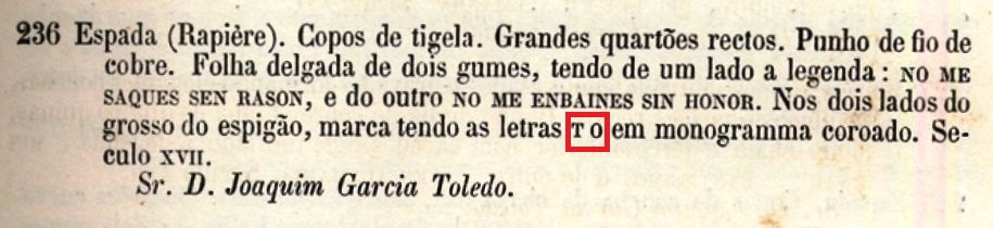

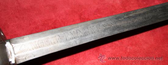

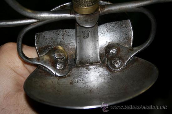

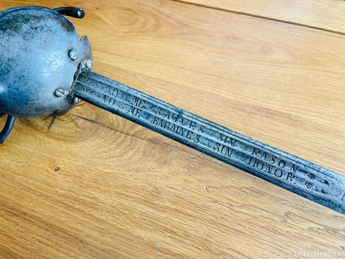

I am completely devastated by Midelburgo's input. So much convinced i was that the NO ME SAQUES moto often appeared in Spanish blades; not only shown in blade illustrations but also in all kinds of articles and blogs out there.
Surprising also that the Toledo symbol (To) was also used to be faked.
https://ame1.org.es/no-me-saques-sin...nes-sin-honor/
https://apuntessobrelamarcha.wordpre...pada-espanola/
https://museodeavila.com/pieza/espada-de-concha/
https://swordsantiqueweapons.com/s245_full.html
Old 12th April 2024, 10:39 AM   #12
Amazing also that specialist Vicente Toledo calls it "Classic Spanish motto".Go figure !
Nice. I said Toledo never made the motto. I see I was wrong and thank you for sparing me the search.

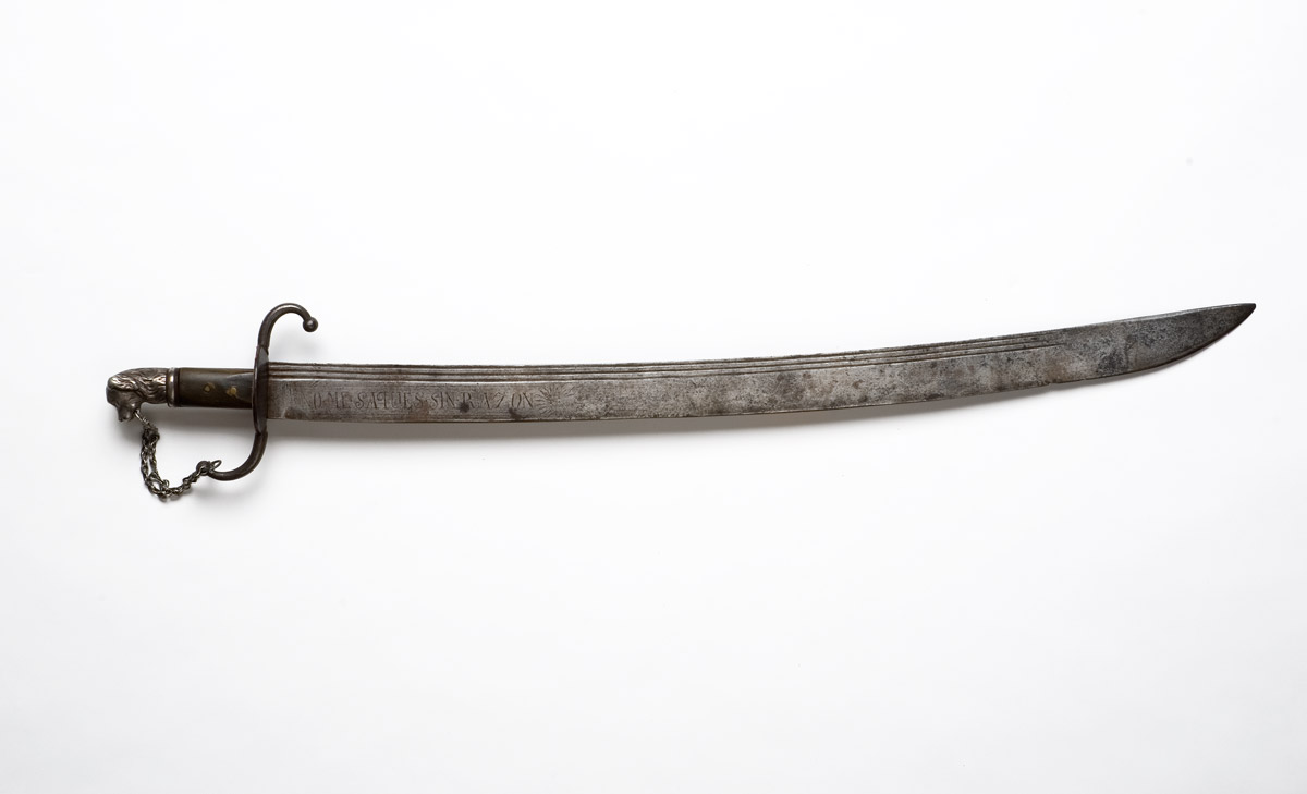

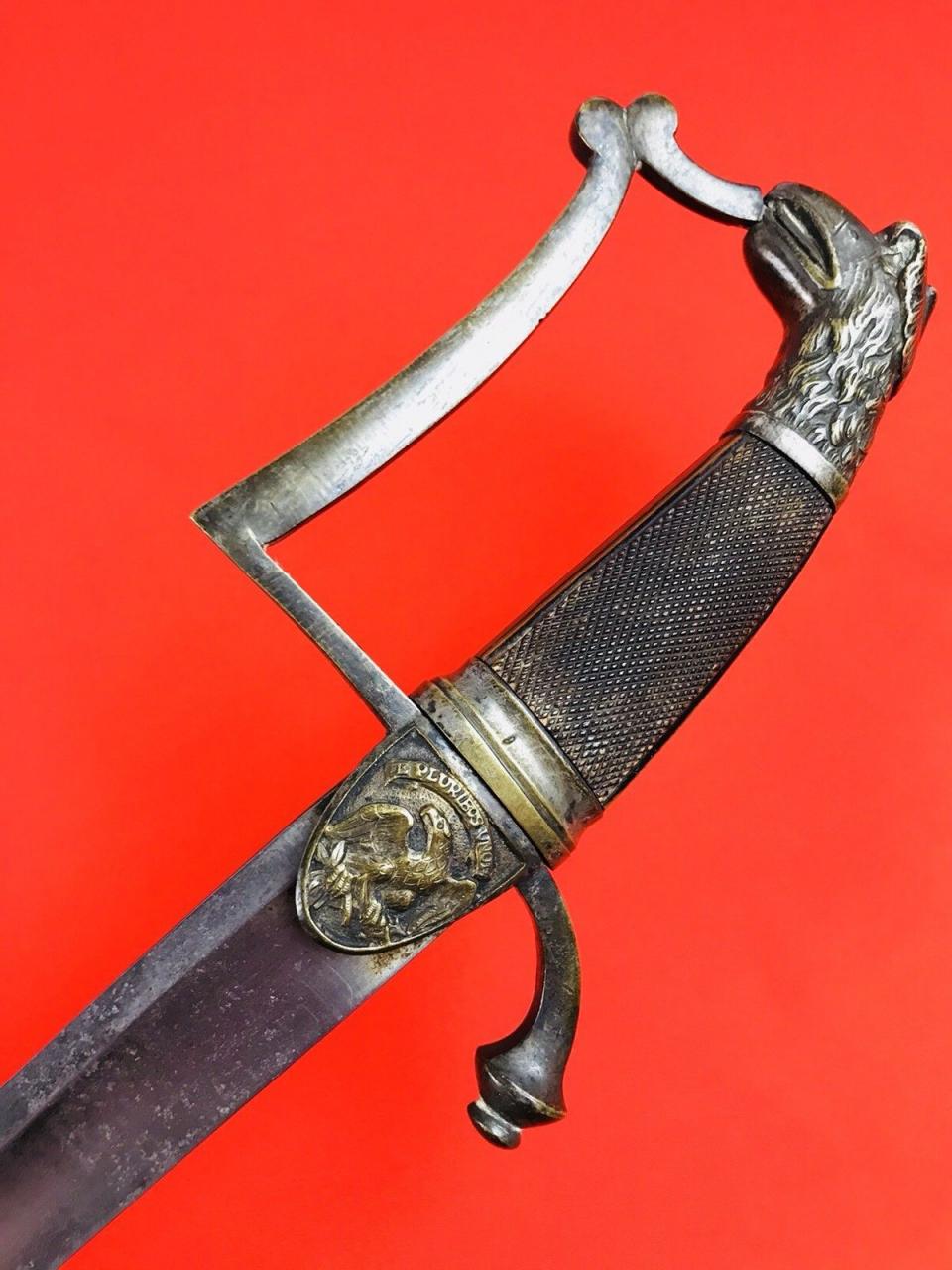

The mystery Bowie sword. Hilt but the rest of the sword is invisible
https://64parishes.org/entry-image/p...t-of-jim-bowie

Well its an eagle head, but Glen, you'd be the one to say which type (Thurkle etc). I can only imagine that there must be examples that had Spanish motto blades. However, I think some Mexican swords had eagle heads as well, but offhand not sure of details. Bowie was after all a Mexican citizen by marraige, so possible, but this seems American.
Always curious why nobody has ever mentioned swords AT the Alamo.

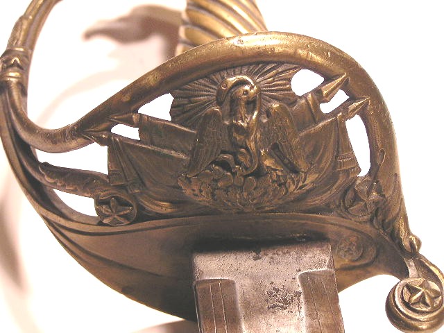

There were some 1st Empire eagles that might fit the portrait, as I had thought of the old LePage Foghorn Leghorn

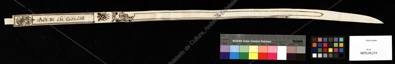

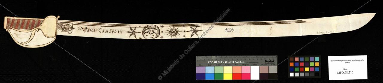

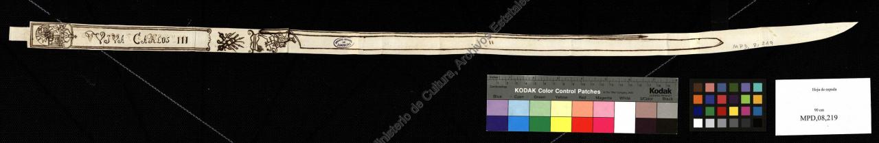

Just some examples of the Halbachs 1775 cardboard real size trade samples, from the Simancas archives.
There are not "no me saques" mottoes among them but the blades are the same you can find with that motto. And the offering letter to king Charles III says he can choose whatever motto he wants.
The offer was rejected for the state owned weapons. But private buyers (officers) could buy them.
No doubt the offer was repeated from time to time, but only the one from 1775 has survived.
The kingdom of Two sicilies has similar pieces.

With this portrait of Bowie, it appears to be a silver hilt eagle head of the crested form, which like most of the earlier types of these were typically made in England and sold to US. This type crested eagle head seems to have been a type of pommel fashioned by Thomas Bate of Birmingham, but used by many of the cutlers there so might have been any number of these Birmingham makers.
These seem to be from the period c.1805 (Mowbray, 1988, p.96).
Inerestingly, an eagle head sword with Spanish motto blade was posted here last year, which with that being the case the sword was thought of course Mexican as they used the eagle element as well. The character of the sword suggests overall it is Mexican, perhaps later than the 1820 period (of the Bowie portrait) and of course the lack of knuckleguard. What is interesting is the character of the hilt, especially the crossguard which recalls the style of some Masonic skull and cross bones hilts. While Freemasonry was notably present in the US, it was as well in Mexico.
Returning to swords at the Alamo, while most of the defenders were civilian, the only 'military' there were essentially militia. The unit that Daniel Boone was with was comprised of a number of volunteers who were formed much as they had been during the War of 1812. In that same manner, the most noted unit at the Alamo were the New Orleans Greys (whose flag may have been actually the only flag flown there in the famed siege). This group was assembled in a meeting in an establishment in New Orleans where also was a storehouse of equipment left from the War of 1812. Many of the men were of course quite young and their fathers had fought in the War of 1812.
With young men, preparing for war, with the hubris and bravado, and recalling their fathers and their service in the earlier war, it seems possible as they outfitted themselves (even to the grey uniforms) that they might have taken swords....the Starr M1812 sabers made for dragoons and militias.
It is known that some of these were used in the 'Texas Revolution' so it seems possible some of these men might have had them at the Alamo as well.
As always, the presence of swords is absent from mention in the otherwise keenly detailed accounts and literature on the Alamo, the classic case of absence of evidence.
While a bit off track from the Spanish motto theme, and this eagle head is clearly not 'crested' as with Bowie's, the example with Spanish motto is of interest .
Just noticed Midelburgo's post...THANK YOU!
These large letters used for the Spanish motto along with the cosmological symbols popularly used on blades with Solingen origin suggesting the 'motto' was in use of course in latter 18th c. . Though rejected 'officially' by the Spanish court, these blades were solicited privately so available to cutlers not only in Spain and Mexico, but perhaps even in the US.
So does Bowie's sword have a Spanish motto blade? who knows" . ?

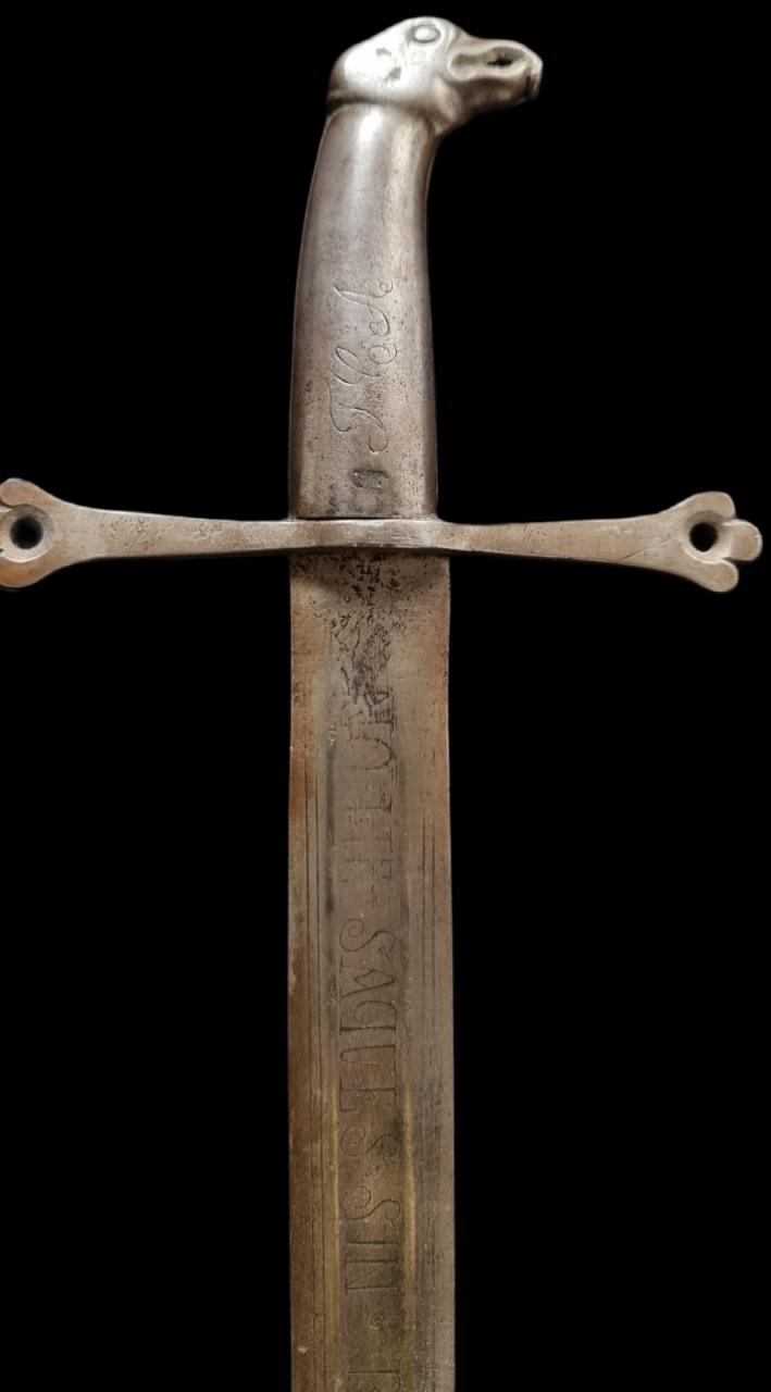

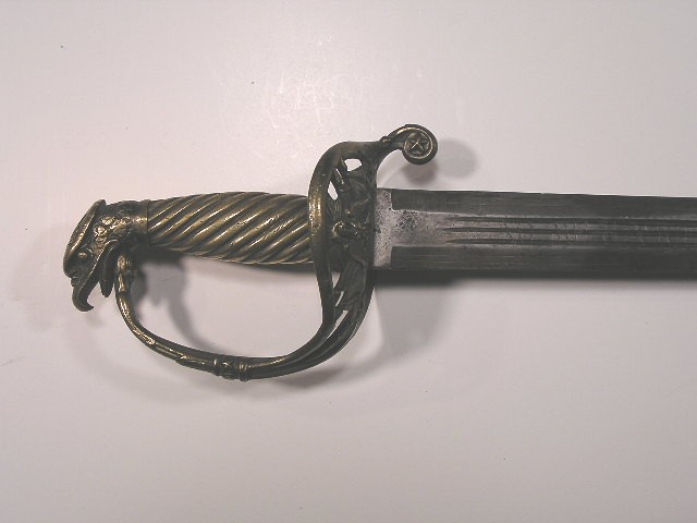

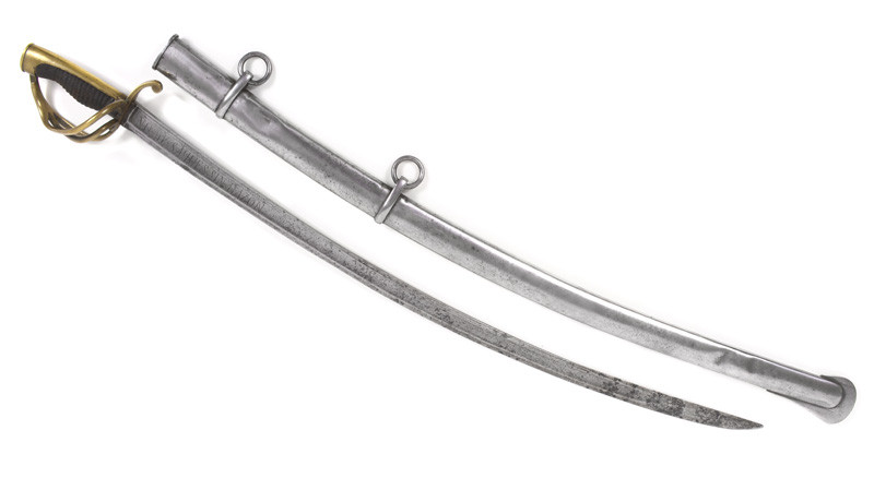

I have posted this in the past but there was never an overall shot. I have the old dealer listing through archive.org but it will take time to remember where. Oh yes, David Park. 'Relics of History'. Archived in my drives 2007-2008ish?.
https://web.archive.org/web/20090224.../weapons2.html
Very much an Ames silvered hilt made for Mexico (or use there) but with a typical refit pallasch blade. More photos at the link.
Cheers
