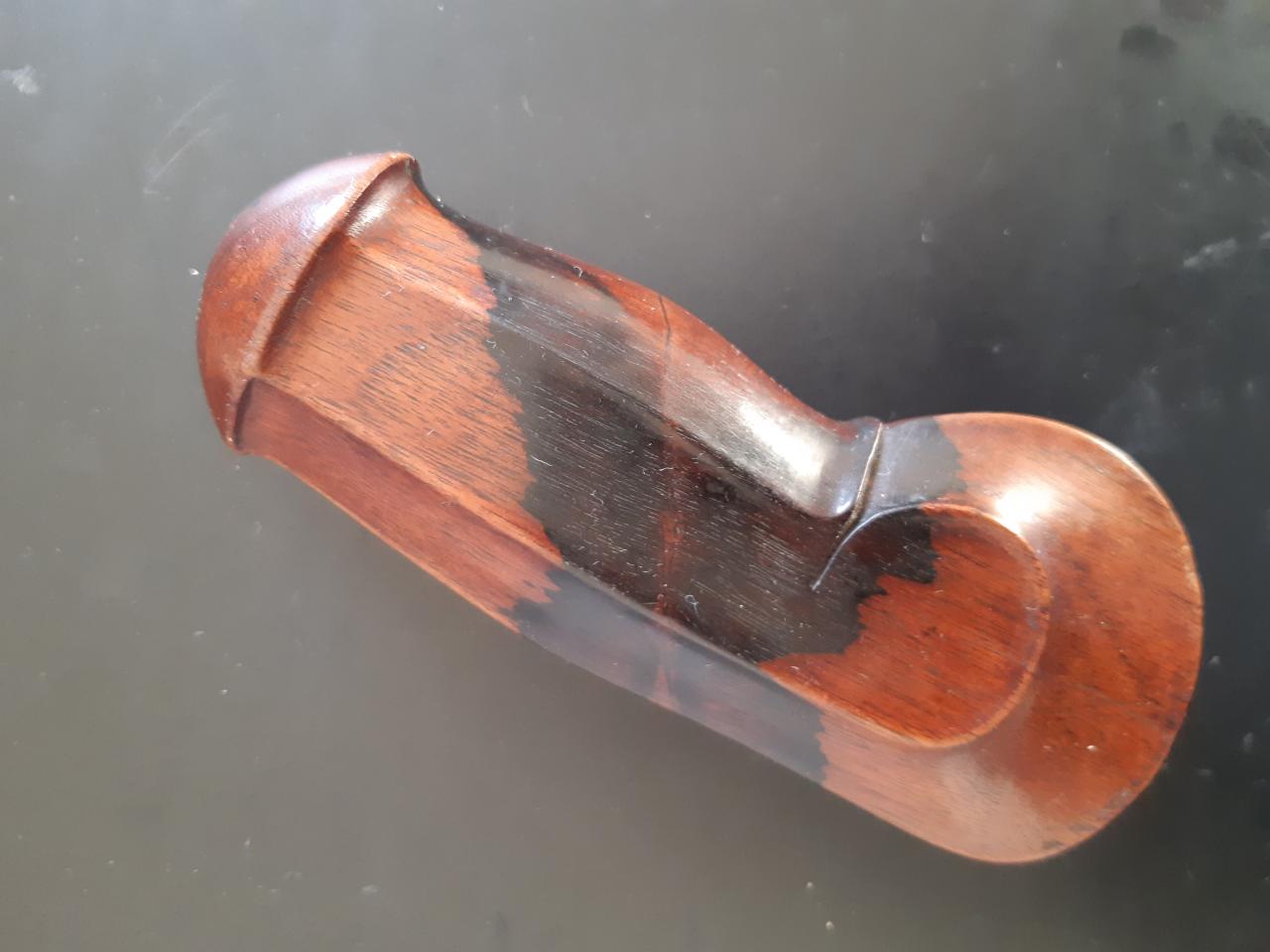

I sometimes see for sale keris ukirans shaped more or less obviously like a phallus. I always see them go very quickly which must mean that they are appreciated but is this something that has any base in a tradition or is just a gimmick ? I can't show any because what I can find are all for sale and some may be offended by the graphic nature of the images

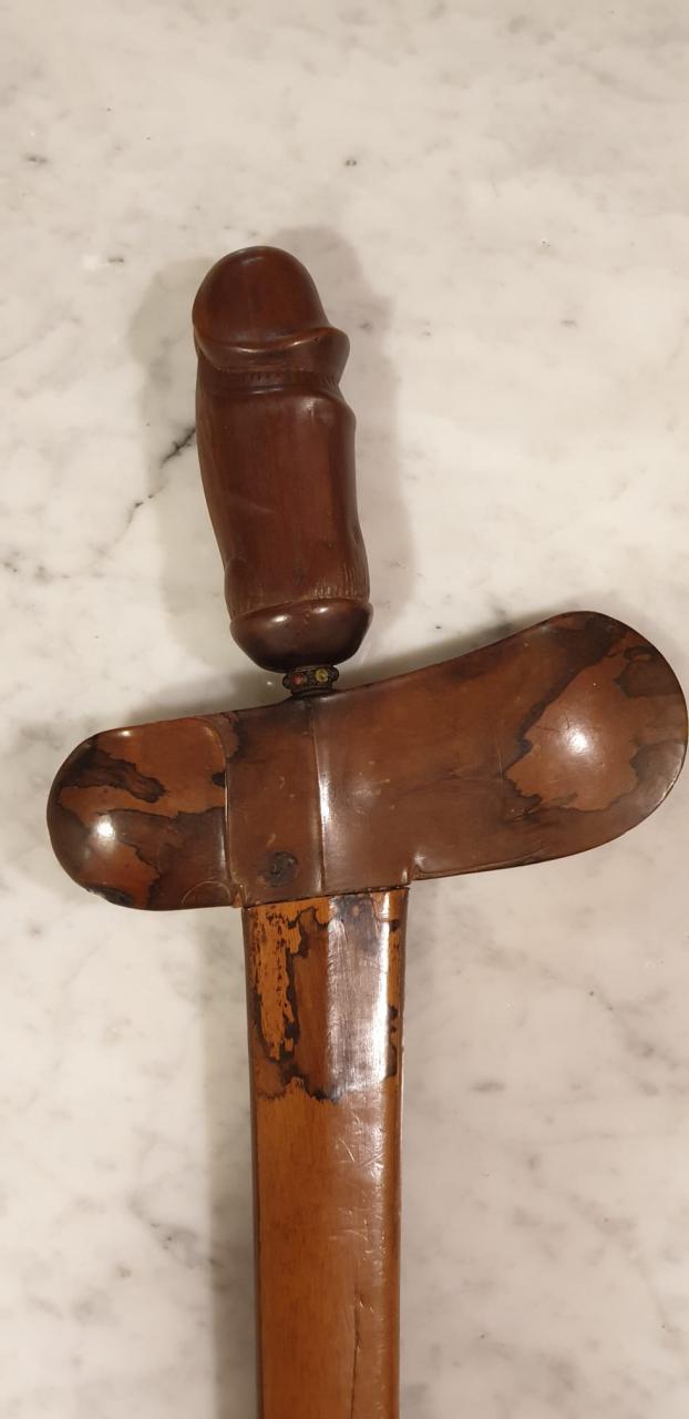

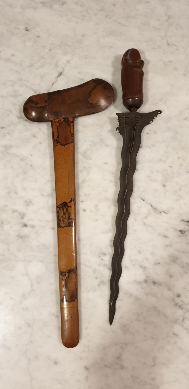

I guess the photo speaks for itself.
I bought this at auction many years ago from a grainy photo. I thought it was a man in a helmet.
Paul de Souza is offline   Reply With Quote

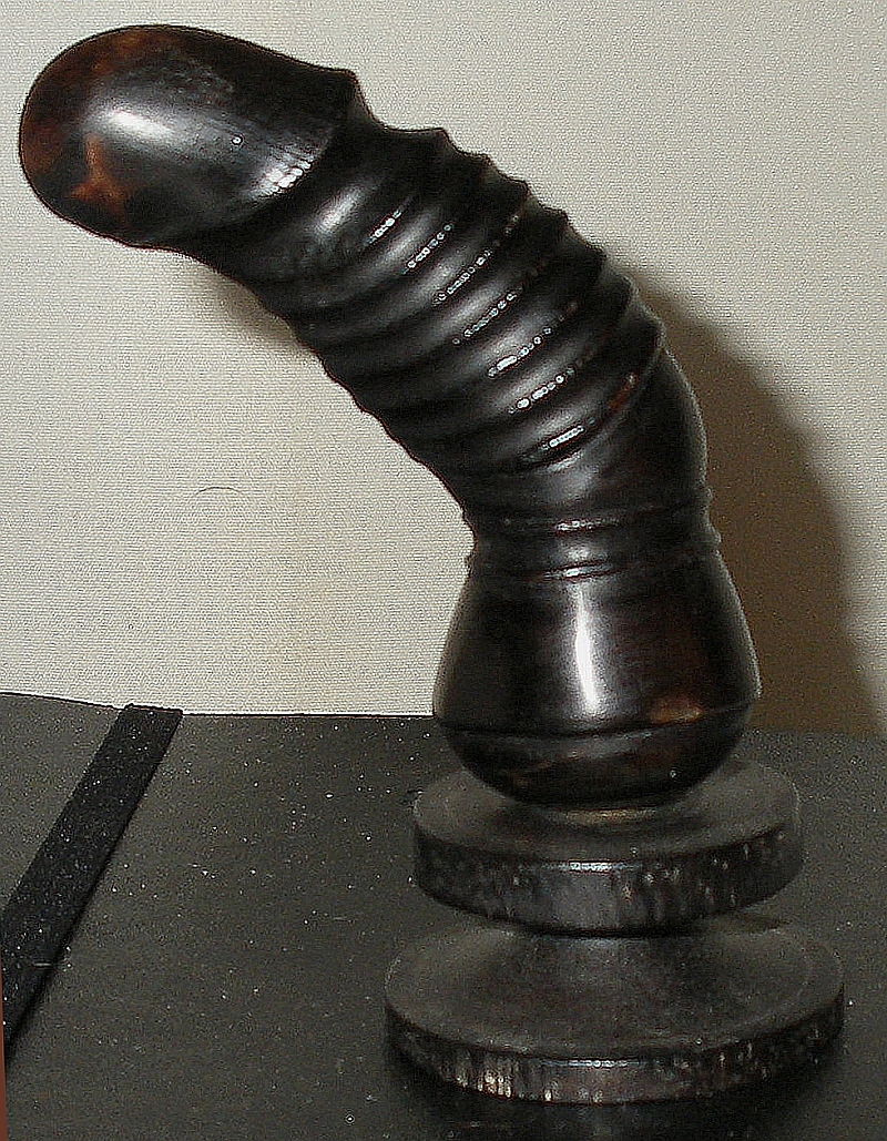

I have this example carved from horn (how appropriate!) from Adni.
I've never seen one mounted on a wilah. I do wonder where it fits into the cultural ethos of the keris or is it a gimmick for those of us who are outside of keris culture.

Here is what it looks like on the wilah.
It is a comfortable grip and works very well.
Just a bit awkward grasping in the hand though.

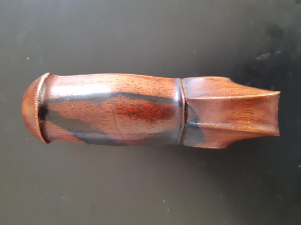

Hi David
Yes this type of hilt. The glans tip bearing the pesi and the rounded pommel forming the scrotum. Immediately apparent when the hilt is separate from blade.
