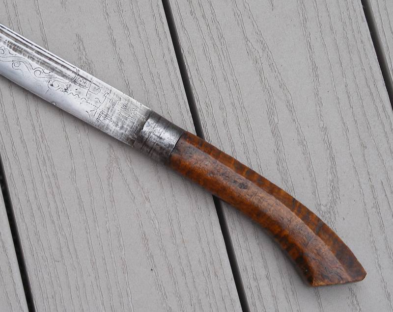

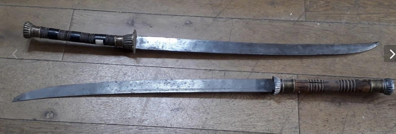

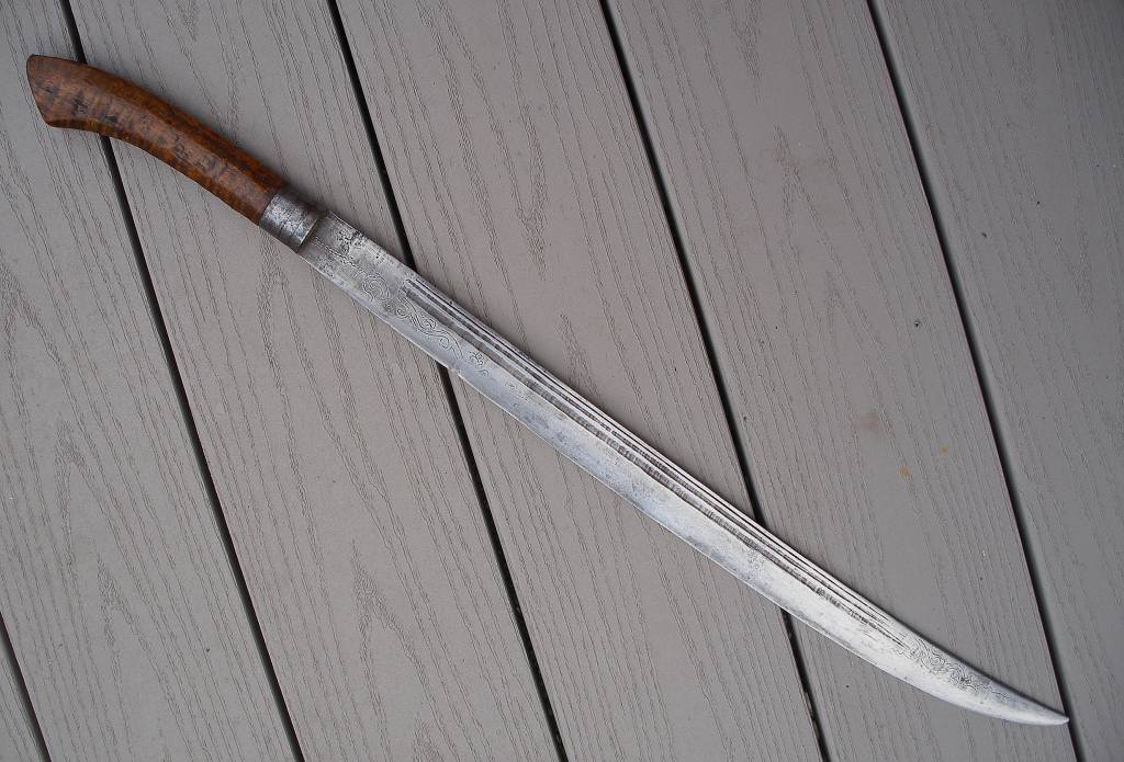

I’m still learning about the South East Asian twists on weaponry. Was just wondering if anyone could identify these large two handed sabers, as Vietnamese, Thai, Burmese, Cambodian?
28 inch blades, 40 inch total lengths.
Because of the design on the blade, I was leaning towards Vietnamese. But since there’s two of them, it reminds me of the Thai or Cambodian double sabers. (Krabi Krabong etc?)
Many thanks in advance.

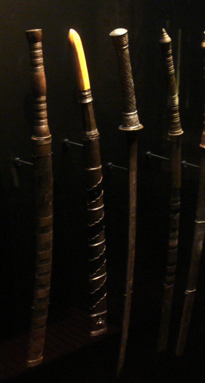

First and fourth swords from Son La province in Northwestern Vietnam. My friend took this photo with his phone at the Quai Branly Museum in Paris.

Re: swords in post #1 - Another tit-bit:
Look at the amount of rings on the hilts, shape of the pommels, etc. 2 single 19thc Tonkin sabres, not made as a pair. (lower one looks to be missing its flat guard disc & is fullered & blade is decorated).
They are also too long at 1 metre (40in.) for two handed Thai style.

Ren Ren,
Thanks for posting this interesting picture. The hilt on the left-most example is unusual and may well be local to the province you mention, or possibly Cambodian. The second and third are probably Thai, the second being northern Thai/Shan in style and the third seems to be Thai from the Rattanakosin period (early-mid 19th C perhaps). The fourth is Lao in style, and may be quite old.
Like many attributions in museums, classification is often by the site of collection rather than the site/culture of manufacture.

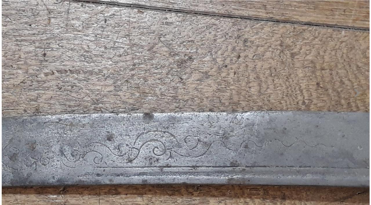

Posts: 6,441
Note the same decoration seen on one of your blades, David; could this be called a Guom even in this simple form?

Good observation on the ring count difference on the two swords.
I will look up Tonkin sabres, as it’s a new area for me.
When the swords arrive, I will take closer pics.
Thank you.
