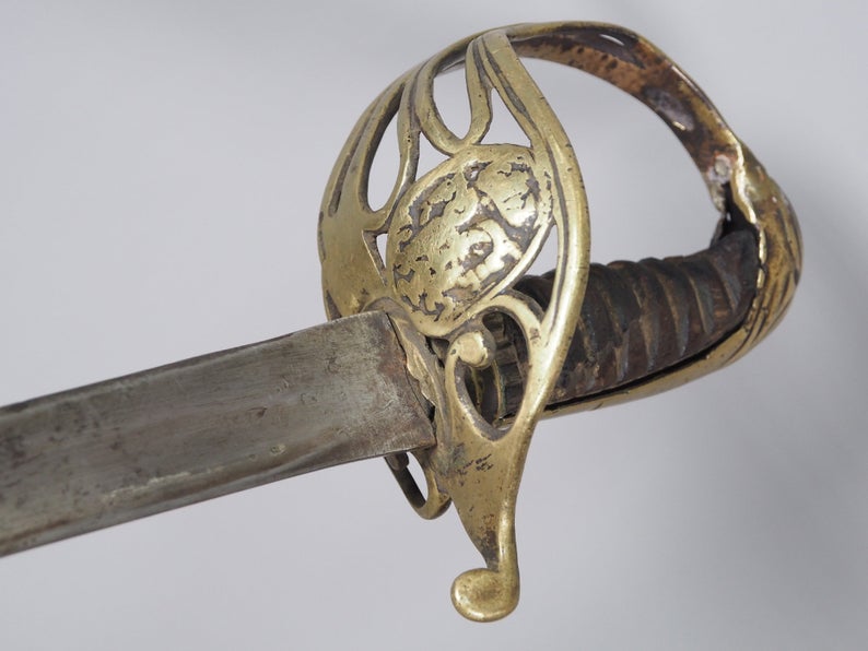

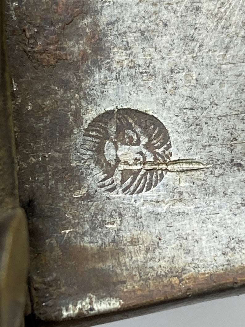

I bought this very obviously British style cavalry sabre, (not sure what model) but it has a very unusual marking of a lion, and I am not sure if this is a British marking, or the marking of the Afghan king Sher Ali Khan. Perhaps the Afghans obtained this sabre from the British, and added their own marking to it.

Can you post a photo of the brass guard with its coat of arms?
This could be an Indian sword for one of the Princely States.
https://commons.wikimedia.org/wiki/C...tates_of_India
The blade is British but the hilt appears to be local manufacture that copies the British infantry pattern.

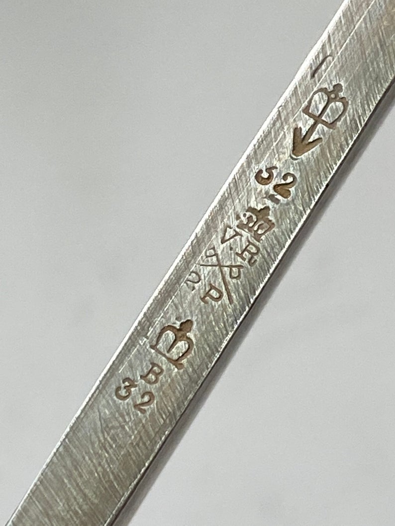

This is of course a British M1822 infantry officers sword (I'd like to see the cartouche in the hilt), and the multiple stamps in the blade correspond to issuance and inspection marks placed on the blade in England.

While I am not aware of a Royal stamp (with the lion head) used in that manner by Sher Ali Khan, it certainly does seem possible. Sher Ali Khan (1825-1879) certainly had provisional contact with Great Britain prior to the war and there was use of British weaponry.
It does seem that there were at least one or more arms factories in the area of the Mashin Khana in Kabul in these times, and while I cannot find the reference presently, there was a 'lions head' used as a mark.

I would think the pattern is the later 1854 when officially the folding guard was abolished. The hilt does appear "locally" made with noticeable differences.
Why is there no photo of the cartouche as it would answer the question of state. A British blade that may have been rehilted.

Could this be a sword bayonet blade? I say this because of the inspection markings which you don't see on infantry sword blades unless a sergeants sword but then only one or two marks.

I think I can add something to support that....I just found my notes on a an Enfield musket converted to Snider with a 'toughra' on the lock, and a LIONS HEAD stamp just ahead of the hammer......the toughra had the date 1874 in the reign of Sher Ali,
it is thought there was a shop near Mashin Khana called 'lions head' which used this stamp.

I see the crown but under it i'm not sure. I don't think it's a VR. Possibly finding another sword with less wear could answer as to what it represents?
Looks like the guard at the pommel has a brazed repair.
I do agree a sergeants sword, it would have been kept polished which explains the wear.
A blade of 73 cm could be a bayonet blade repurposed as a short sword. The interesting hilt was obviously added at some point.

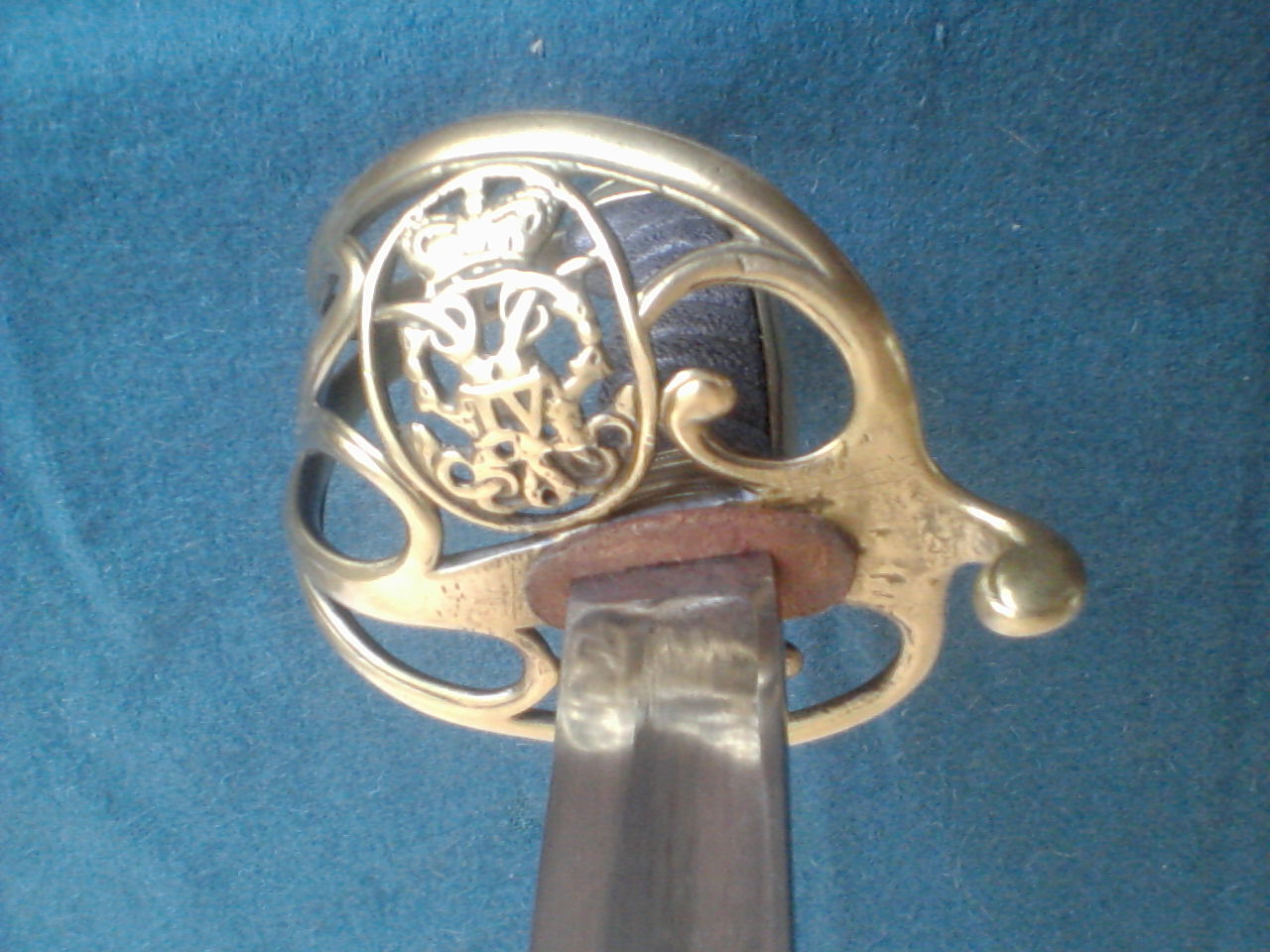

The pattern started with George IV, so you have a choice of George IV and William IV as monograms as well as Victoria. Here is Georges monogram on a sword of this pattern. But if its East India Co. they also used their own badge or seal.

Thanks for showing the cartouche.
These were almost invariably VR (Queen Victoria 1837-1901)
George IV, was Prince Regent 1811-1820 and became George IV 1820. As this was an 1822 pattern and he passed in 1830, these with that cartouche are not common.
The William IV would be even more so of course.
This hilt seems roughly cast as even worn the relief would not be that indistinguishable.

Yes it does appear to be a rough sand cast guard probably taken from an existing sword guard. I find these swords interesting considering the likelihood of them being used in battle.
