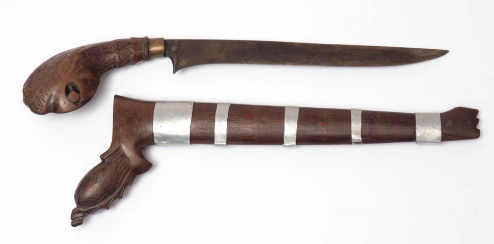

I've won a rare Batak sewar by an English auction house, sadly the scabbard tip is old renewed but the price was right and since these sewars are rather rare I go for it anyway. I've cleaned the blade from rust but I plan to polish it and give it an etch later. I don't remember having seen such a sewar here before so I post it for discussion. It's 35 cm inside scabbard, 30,5 without, blade is 20 cm and 7 mm thick behind the octagonal swelling.

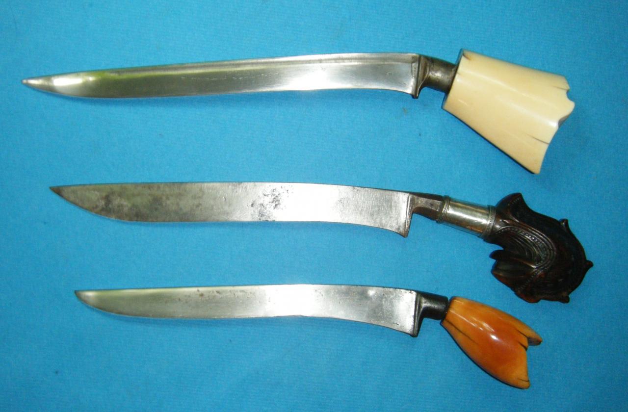

And here a picture with an other Batak sewar and a tumbok lada for size comparison.

Congrats, that's another good grab!
Yes, definitely a Batak piso. As you mentioned, this blade belongs to a family including sewar-like pieces and what the coastal Malay of the Straits region seem to call tumbok lada; among the Batak, there is a bunch of these with either the bulky ivory hilts or figurally carved pommels.
From the carving motifs, I'd be inclined to lean towards a Karo origin; Simalungan can't be ruled out though. The motif of the silver sleeve has also been seen with blades that seem to suggest a northern influence. Thus, we need to keep Dairi/Pakpak and Alas in mind, too. There even may be a Toba link here - so, we're going pretty much full circle...
This is a topic I'm currently looking into; more data will hopefully allow to reach more reliable conclusions. It will definitely take a while to sort things out though.
