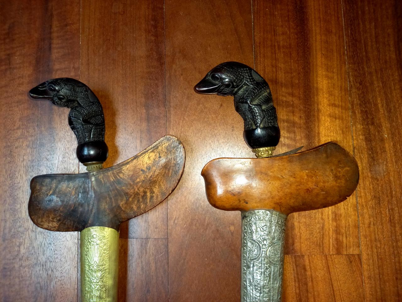

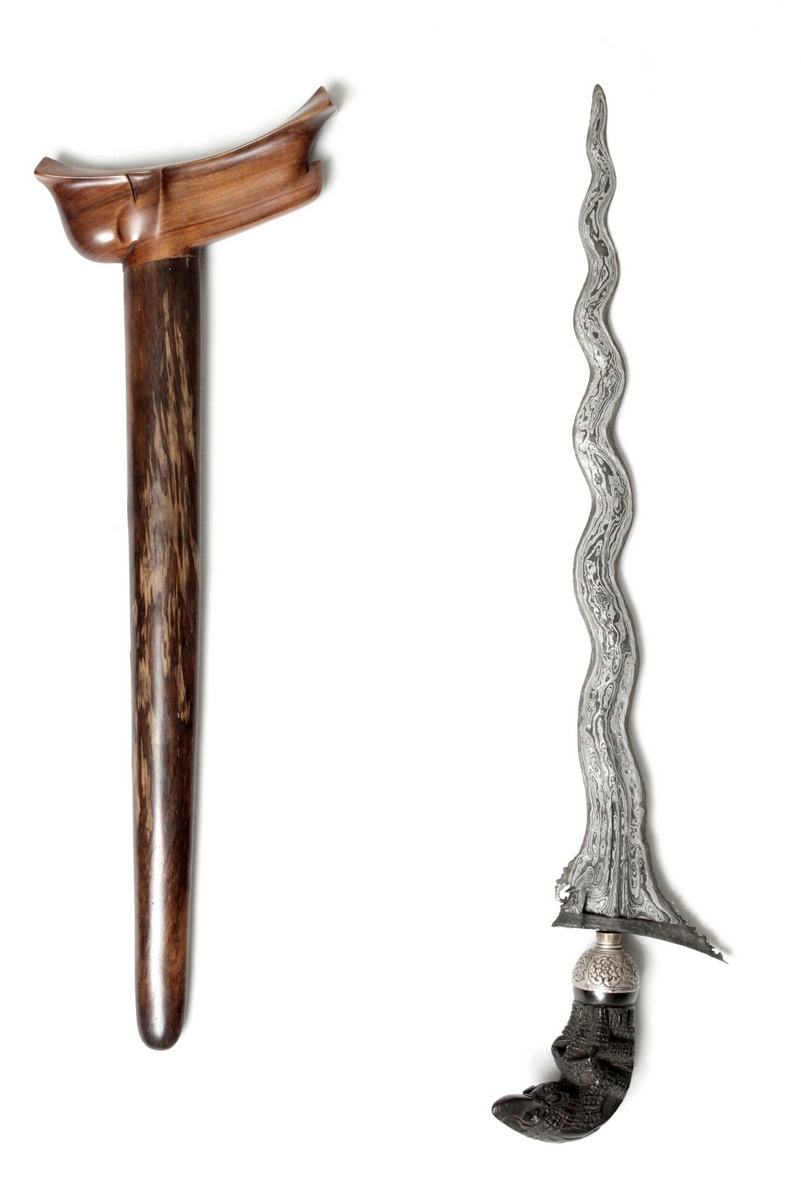

I recently acquired these two Keris which intrigue me a lot because their grip is very close to that of the Keris hilt from South Sumatra.
However, the base of these handles is typically Javanese.
The two Keris come from two different collections.
In both cases there is unfortunately no Mendak.
What type of Mendak would be the most suitable?

IMO these 2 hilts are indeed in burung style from South Sumatra, while the scabbards are rather from NW Java (just in front from each other). And the blades....

Yes there is nothing exceptional about the blades ... one was probably beautiful in her youth, but is now just a ghost. The other is really very basic and still covered in rust.
I do not remember having seen identical handles mounted on Sumatran Keris (where the blade and the scabbard are typical of sumatra).

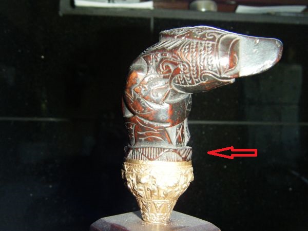

The Burung handles that I am used to seeing from South Sumatra usually have a sort of "ruff collar" at their base, just above the Selut (see the picture of hilt from Detlef collection).

It is sometimes almost impossible to distinguish between S Sumatran and NW Javanese Keris indeed, if we are looking for older specimens. There are at least a couple of sheath and hilt forms from W Java, which are old ones, seldom seen, and not (videly) published (and mistaken for S Sumatra, E Java or even Bali forms).
The origin of the hilts presented (in #1) can also be W Java.

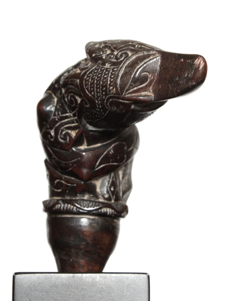

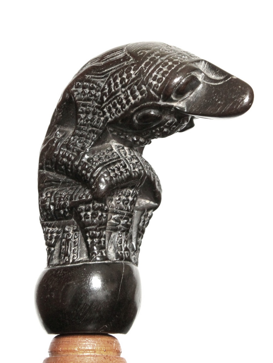

Athanase, the hilt which you just showed is a different animal from South Sumatra, a Jawa demam type and not burung, I will attach the pics of the 2 types for comparison.
Old 17th July 2021, 08:12 PM   #6
Jean
Join Date: Jun 2009
Posts: 1,740
Pics of the 2 types of hilts, both from South Sumatra IMO but I may be wrong?

For me the sheath and mendak of keris n°148 and 158 in Jensen's Krisdisk are Javanese. But that's just my feeling when comparing lines of these hilt and sheath with examples whose origin leaves no doubt.
My a priori comes from the fact that I have never seen this type of handle mounted on a blade, with a mendak or selut and in a scabbard typically originating from sumatra.
While I have already seen several examples with Javanese blades, mendaks and scabbards.
But this is maybe just random of the photos I saw on the net.

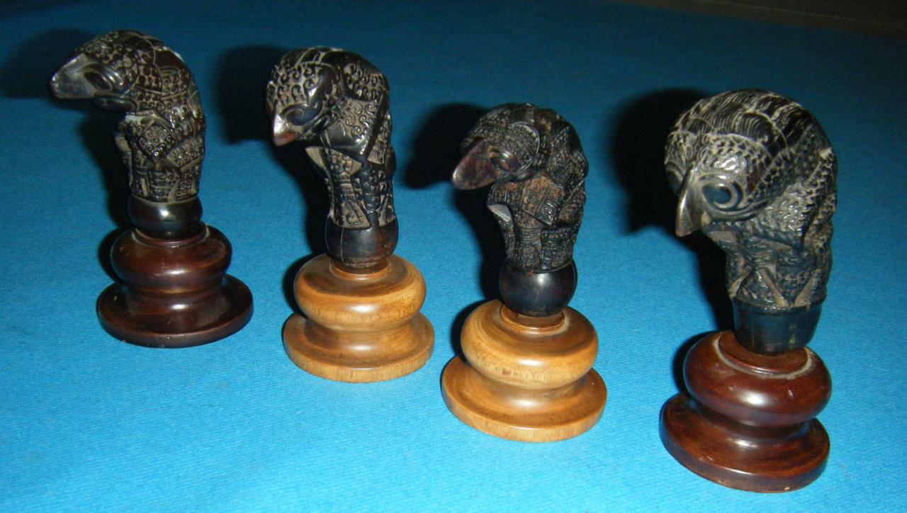

I have four handles in this style in my collection, one is very big (the one on the right), I really doubt the Palembang attribution and I believe they originate from West Java but this is just my feeling.
The base of this handle style would fit much better with a Javanese mendak as with a Palembang pendokok, look for example the keris from Jean, in my opinion it's a mismatch, sorry Jean!

I note that the handle reported as coming from Lampung in Tammens Vol. 3 is typical of Cirebon.
Even though the hilt style of this subject is from Lampung, I don't have a Selut to go with it, and the scabbards are from Java so I put on mendaks that I had in stock (an old one (left) and a new one in an old style (right)).
