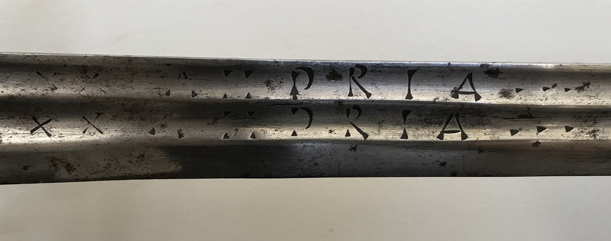

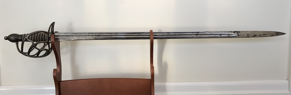

G'day Guys,
I have a British, 1788 pattern, heavy cavalry officer's sword, which has an older blade marked "Andria Ferara". The hilt dates from the 1780's, but the blade is of a style commonly found on mortuary hilts of the mid 17th century. Is there any way of determining if the blade really does date from the 17th century, or is an 18th century blade made in the style of the 17th century? Either way it is a great example of its type.
Cheers,
Bryce

Really nice example Bryce!! The M1788 or so it is regarded though not officially a 'pattern', is sort of come by in the 'heavy cav/dragoon' hilt.
Im not familiar with this pattern blade being found on mortuaries but you have likely seen more than me.
The ANDREA FERARA however seems atypical for such markings of 17th c. and the 'mortuary' I have with Andrea Ferara is block letters as are the Xs.
This style lettering seems almost 'oriental' and not in a font I have ever seen for this inscription. The late 18th c. of course did seem to lean toward some almost fanciful blade decoration, and officers with their affinity for exotic and unique might account for this anomaly.

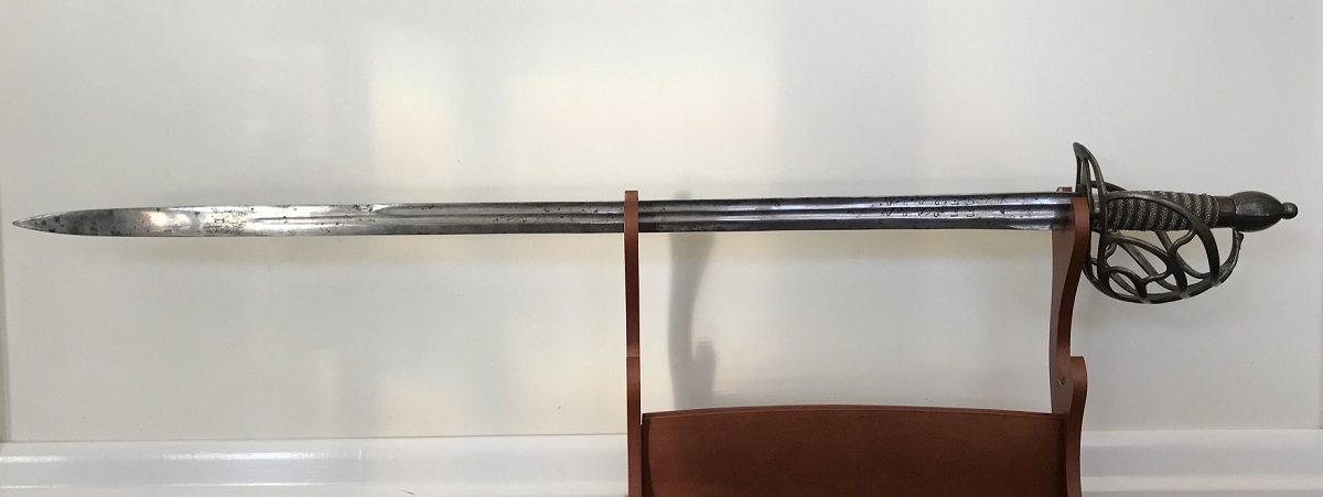

Thanks Jim,
I forgot to include some dimensions with my original post. The backsword blade is 90cm long and 3.2cm wide at the ricasso. It is double-edged for the last 30cm. Below is a mortuary hilt from the Royal Armouries collection with an almost identical blade.
Cheers,

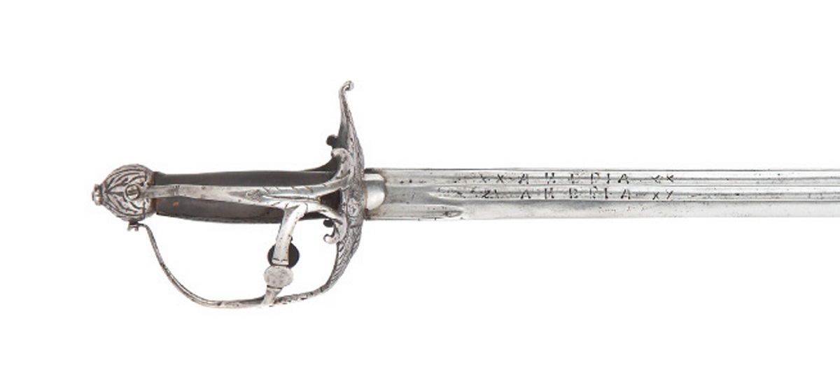

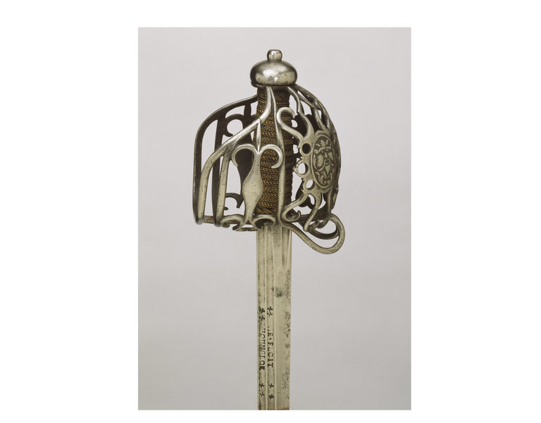

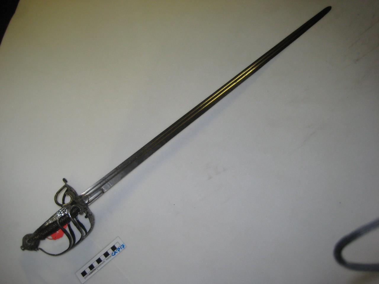

Here is another example from the net with the same blade fullering and Andria Ferara placed the same way.
Cheers,
Bryce

Posts: 10,862
Cheers,
Bryce
Hmmmm! Velly interesting! We seem to have had a purveyor using the same artisan or shop, would be great to figure who and where, but thats not likely.
Either way, sure looks like a heirloom blade placed in the 1788.

G'day Guys,
I actually purchased this sword 4 months ago, but it has only just arrived. USPS misplaced it for over 3 months?
In the mean time I had forgotten how many early to mid 17th century examples of this style of blade I had found searching the net. I couldn't find any 18th century examples.
Jim, I think any connection to the East based on the blade engraving style may be very tenuous indeed. Could this actually be a Hounslow blade? There is evidence that the 17th century cutler Benjamin Stone got into trouble for putting "false marks" on his blades.
Cheers,
Bryce

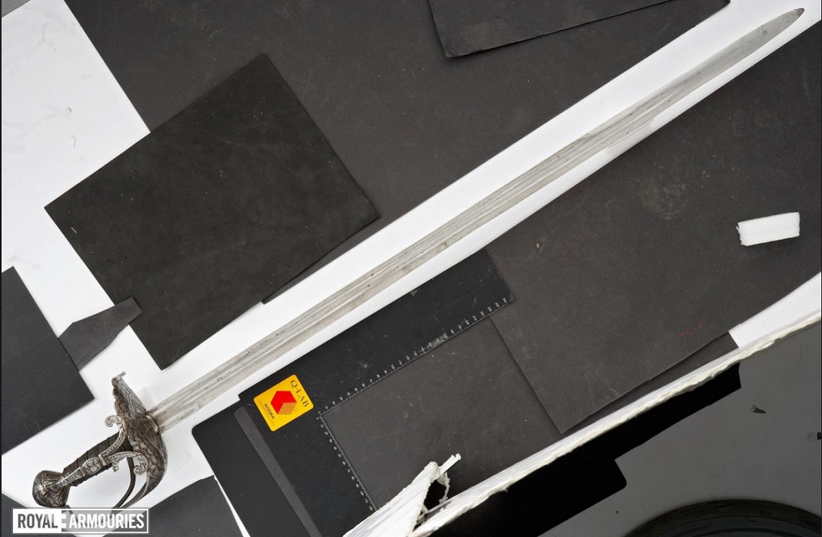

Markings aside it seems that this type of blade was manufactured at Hounslow. A search of the net has revealed many examples of this style of blade marked "Me Fecit Hounslow". York Castle Museum has several examples, as does the V and A.
Cheers,
Bryce

Posts: 10,862
Thanks very much Bryce!!!
I really had no idea Hounslow made these 'mortuaries' and if these collections have these so marked, then that is pretty resounding. I have associated Hounslow with hangers of course, with the many that are marked with the ME FECIT HOUNSLOE etc. and some of the known names.
As noted, Hounslow was taken by Cromwell, but several makers remained there while the others removed to remain suppliers to Royalists, primarily to Oxford.
As I had mentioned,I have a mortuary which is clearly Solingen with the ANDREA FERARA within the familiar 'sickle'marks and is from 1640s.
So then we return to this rather bizarre 'ANDREA FERARA' in Chinese 'chop' letters, on what we see now as a Hounslow blade.
Hounslow was known to produce maritime oriented hangers........could this be again aligned with influences from trade?
Again, tenuous of course,but why these unusual letters?

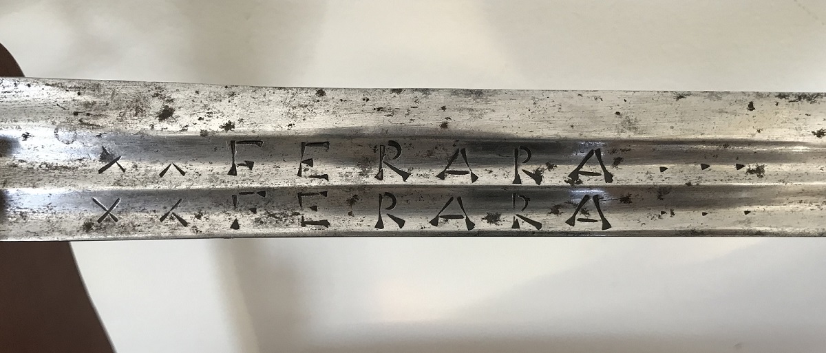

G'day Jim,
I actually don't think there is anything unusual in the way Andria Ferara is marked on this blade. If you look closely, many Andrea Ferara blades are marked in the same way, it is just that successive polishes have worn the marking down on my blade, leaving only the highlights behind.
Cheers,
Bryce

Posts: 10,862
Bryce, as indicated on concurrent thread, I have been going through references of English swords for hours, and am deeply in chagrin at my comments on Hounslow swords previously! Ouch!
It has been some time since revisiting earlier research, but still no excuse for the oversights in my comments, which I have discovered were profoundly in error.
To your example which is on M1788, as discussed, I found this in "Hounslow Hangers" by the late Tony North ( Park Lane Arms Fair, 2004, p.38.).
"...although the factory seems to have closed in the 1670s, the blades made at Hounslow were obviously prized. They are often found mounted in high quality English officers swords of early 18th c.". It is also noted these blades were often mounted in hunting swords of 1730's-40s' (these would be hanger blades).
Clearly the convention of mounting these Hounslow blades would have carried further in the century as well.
Regarding my notes on Hounslow workers leaving Hounslow to go to Oxford for Royalists, it seems that may not be correct also, as per Aylward ("The Small Sword in England", 1945.p.31). Aylward claims that no historic evidence that this happened, however it is noted that many London smiths had originally gone to Hounslow as well (the emphasis has always been on the German smiths). As London was strongly Parliamentarian, even if the Germans did leave, there would have been plenty of workers. It is noted that Hounslow was well organized at the time of the Civil,Wars (1642-1660).He notes further that Hounslow was producing 'the great sword" (= heavy blades for cavalry, proto mortuary types).
In "Some Swords Associated with Oliver Cromwell" by the late Claude Blair (12th Park Lane Arms Fair, 1995, p.26) it is noted that a large number of long heavy swords were sent down to London for Cromwell, which were being made at Hounslow (as Aylward notes).
These were of course likely Solingen blades, and it is noted in "Arms and Armor in Tudor & Stuart London" (M.R.Holmes, 1957. p.30-31) that Hounslow was producing single edge cavalry swords, as well as curved cutlasses for use at sea. It is noted also that requests specified 'Dutch' (=German, duetsch) blades in orders by 1640s.
The illustrations and examples cited in this reference repeatedly note mortuary swords from Hounslow with ME FECIT HOUNSLOE varied, some with maker names and dates , 1636 etc. and many have the running wolf, and other German inscriptions , clearly many blades were finished with the Hounslow markings.
On the fuller pattern, as indicated by Bryce, the asymmetrical fullers and the single flute do appear on MANY examples of mortuary, and from 1630s+ with some being seen as noted in "Catalog of Sword Collection at York Castle Museum" (P.R. Newman, 1985).
Re: Benjamin Stone, who was more an organizer than artisan, and his 'markings'. According to Aylward (1945, op.cit. p.34) in 1638 he petitioned the Privy Council that, "...he may have power of hindering stamping of Spanish and other marks upon blades made by workmen of cutlers co.".
DeCosson however noted (1920) that no forger was successful at reproducing the peculiar style of lettering on Toledo blades.
Stone had his own mark, a bunch of grapes, authorized by Cutlers Co. but unsure if any blades so marked is known.
With the ANDRIA FERARA on this blade of the OP, I still feel this has an 'oriental chop' type style with these flared serifs, and remain keen to know from where this might derive. We know there are at least two with such lettering, and I had hoped something might be in all these references cited, but none had such styling.
