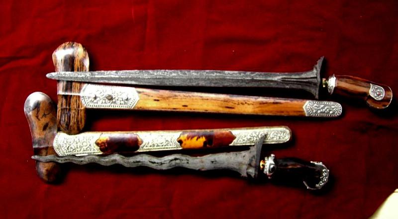

Old 7th March 2008, 01:24 AM   #3
brekele
brekele's Avatar
Join Date: Mar 2007
Posts: 208
Hi Rick, Ligan came from word of LIGA. in Javanese term (Jawi Kawi), Liga mean without clothes (Ngeliga = Ora kelamben). So, in Java ...the keris Ligan is a keris without warangka.
Never heard keris dapur Ligan in Lombok or Bali
I read in one of webside that LIGAN = Keris from Bali and Lombok with a Pedang shaped blade.
Is it possible that KERIS LIGAN = KERIS PEDANGAN?

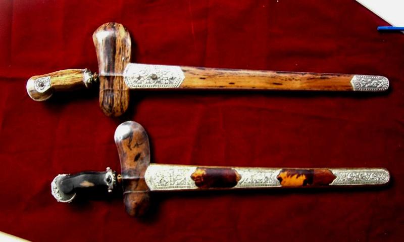

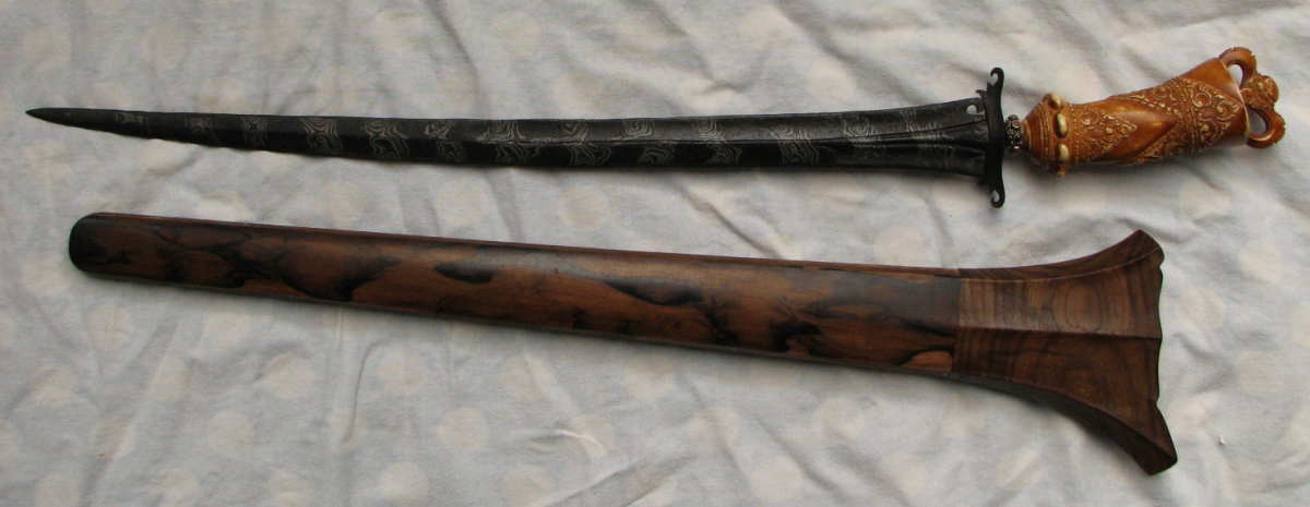

Here I have pics of Keris Pedangan (big one with 55 cm blade only).
(Small blue pen at the top corner of the pic just to compare).

Thank you for responding Brekele; I'll bet you are correct in your assesment of this term .
I had heard that these were longer than the average Bali keris .
I'm not sure that I see much resemblance to a pedang in the blade profile though .
I'm most grateful to you .

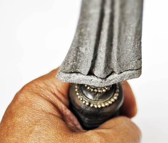

Old 27th October 2008, 09:39 AM   #6
gwirya
Join Date: Dec 2007
Posts: 15

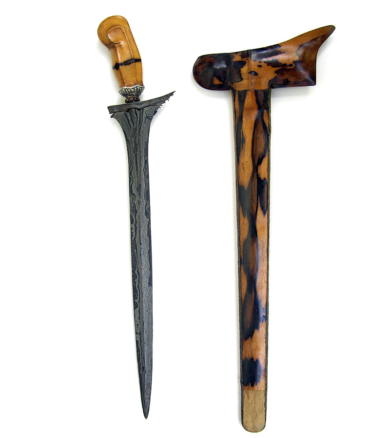

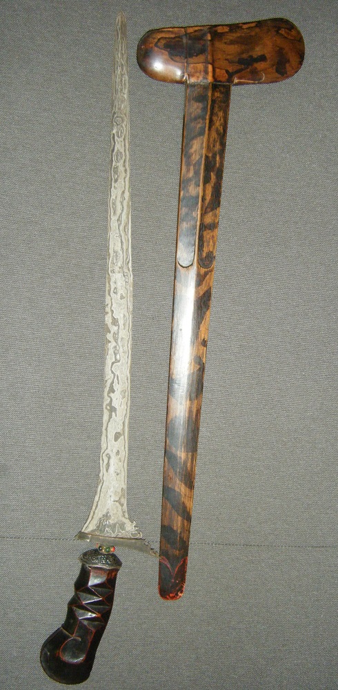

Dear all,

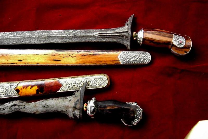

I recently acquired this ligan (pedang keris) from Lombok. I think it fits the description from Ir. Lalu Djelenga book, Keris di Lombok. The blade itself is not straight, it curves like a pedang. It also has half the back edge of the blade(inner side of the blade curve) without an edge (see pictures). The pesi itself has a rectangular shape. I dont have a scale handy while taking the pictures; but the blade has approximately 60 cm in length from tip of the blade to the pesi end. (two pieces of A4 photocopy paper combine together in length)
Any idea how old is this? Pamor type?
Any comments positive or negative will be appreciated
gwirya is offline   Reply With Quote
Old 27th October 2008, 10:56 AM   #7
Marcokeris
Marcokeris's Avatar
Location: Italy
Posts: 928
IMO the nice blade seems old (pamor Walang Sinuduk?) but hit not so old.
The Solo keris' sarong wood (Cendana?) seems fantastic

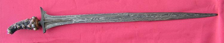

Hello guys I don`t know of this is one keris ligan but the dapur looks like a pedang
semar
Thanks Gwirya for showing us your keris.
Absolutely nice keris and RARE!!!
Old 27th October 2008, 09:33 PM   #10
Posts: 7,258
Marco, in respect of the Solo ladrang,that appearance is more typical of trembalu than cendana.

Very good old nice keris pedang gwirya !!!! Has been some time back I'd seen something similar keris pedang with Shiva eyes.
semar
Hallo semar, I think the keris on the first picture is a keris ligan. In addition to what Alan mentioned above, looking at the pictures of keris ligan in my Keris in Lombok book, it seems like all keris ligan don't have gandik, sekar kacang, jenggot, lambe gajah etc ( all the ricikan on the left side of the keris if you hold the keris as usual). It does have sogokan, bungkul and ada ada. About the size, I am not sure if it has to be bigger than normal Bali/Lombok keris.
To Marcokeris, brekele and Newsteel, thanks for your comments

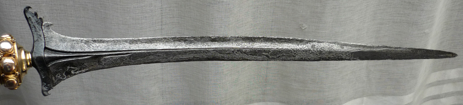

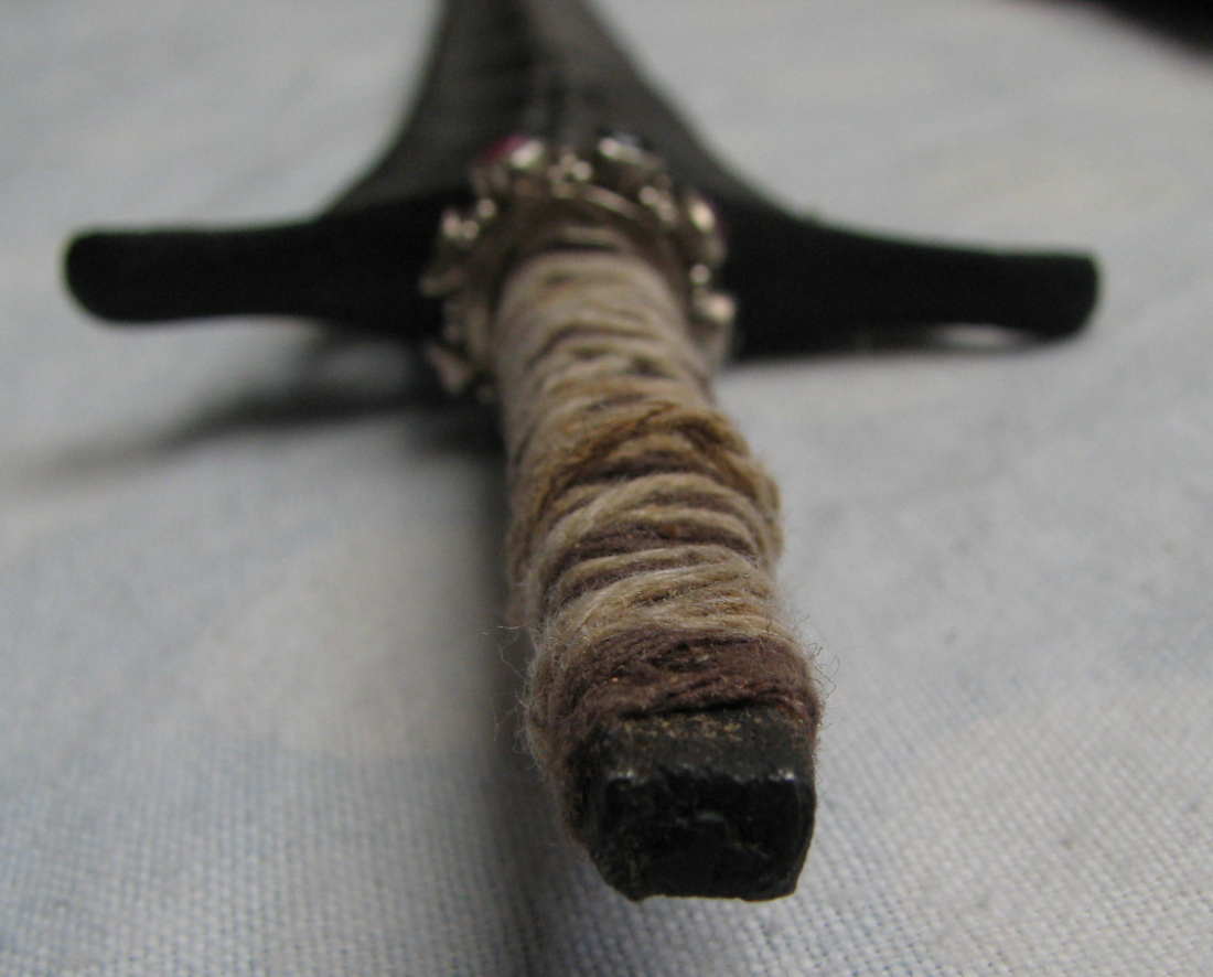

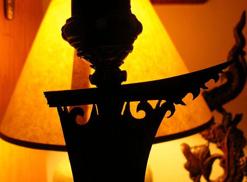

Smile The Sorsoran
Of my Ligan .
Note the odd number of open spaces, 7 .
Comments ?
Old 29th October 2008, 02:22 PM   #15
gwirya
Join Date: Dec 2007
Posts: 15
Originally Posted by Rick
Of my Ligan .
Comments ?
Honestly,first impression, spooky , It reminds me of Jack O Lantern (the carved pumpkin). Rick, does your picture have anything to do with the upcoming halloween? (joking)
I browse my Keris in Lombok book by Ir. Lalu Djelenga, and found very little information regarding this open space, in fact so far I found none mentioning about the "Shiva's eyes". There are only a few keris in the pictures that have shiva's eyes. Does anyone have any information about the Shiva's eyes?
Old 29th October 2008, 02:35 PM   #16
Posts: 6,441
Talking
Hmmm, you're right Gwirya .
I noticed that while processing the shot last night; any way it gives a good silhouette image of the spaces .
Trick or Treat anyone ??

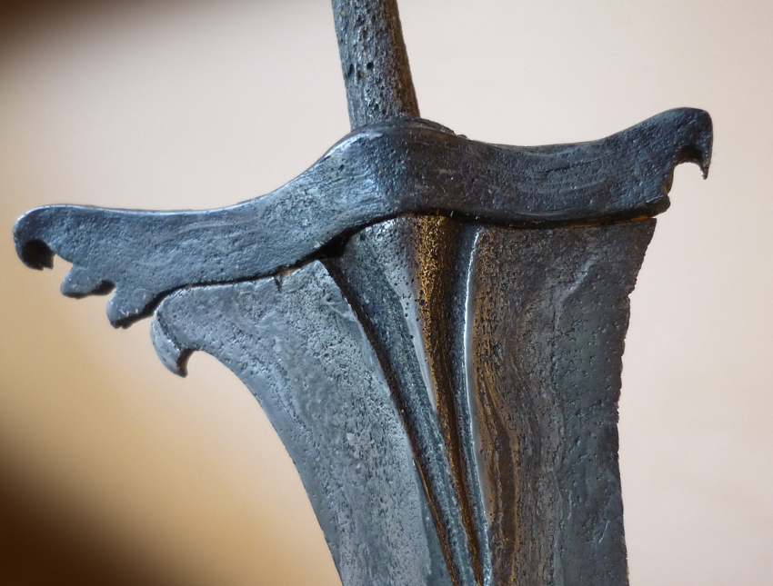

Old 28th July 2009, 09:35 PM   #17
ganjawulung
ganjawulung's Avatar
Join Date: May 2007
Location: J a k a r t a
Posts: 991
Default Regol Ligan?

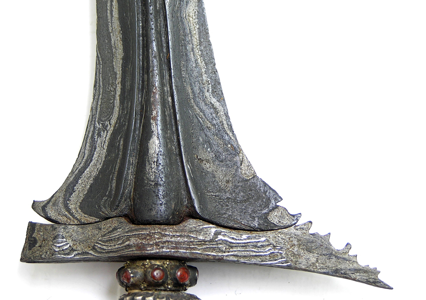

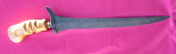

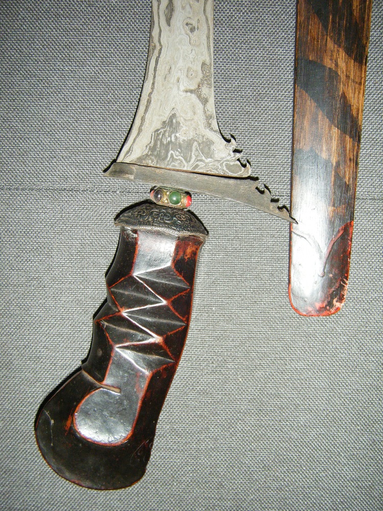

A ligan -- either Lombok or Balinese -- with "double gandhik". Regol ligan? It has two sogokanS in each side. I am not sure what "angun-angunan" (dhapur) it is...
GANJAWULUNG
Old 28th July 2009, 09:41 PM   #18
ganjawulung
Join Date: May 2007
Posts: 991

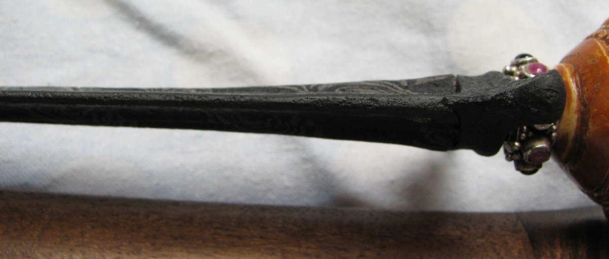

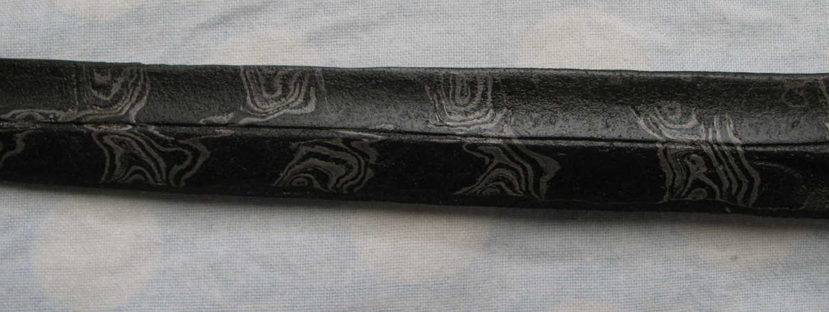

Default MORE Close ups

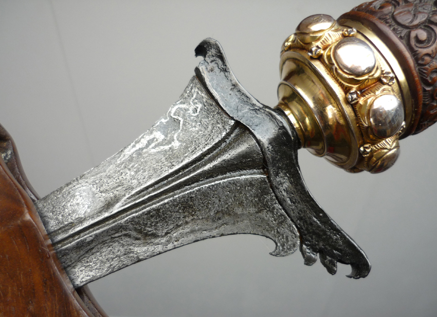

These are more close ups on the sogokan and the sor-soran of this ligan (keris pedang)...
GANJAWULUNG

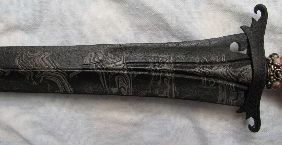

Old 28th July 2009, 11:59 PM   #19
Gustav
Join Date: Jun 2009
Posts: 1,346

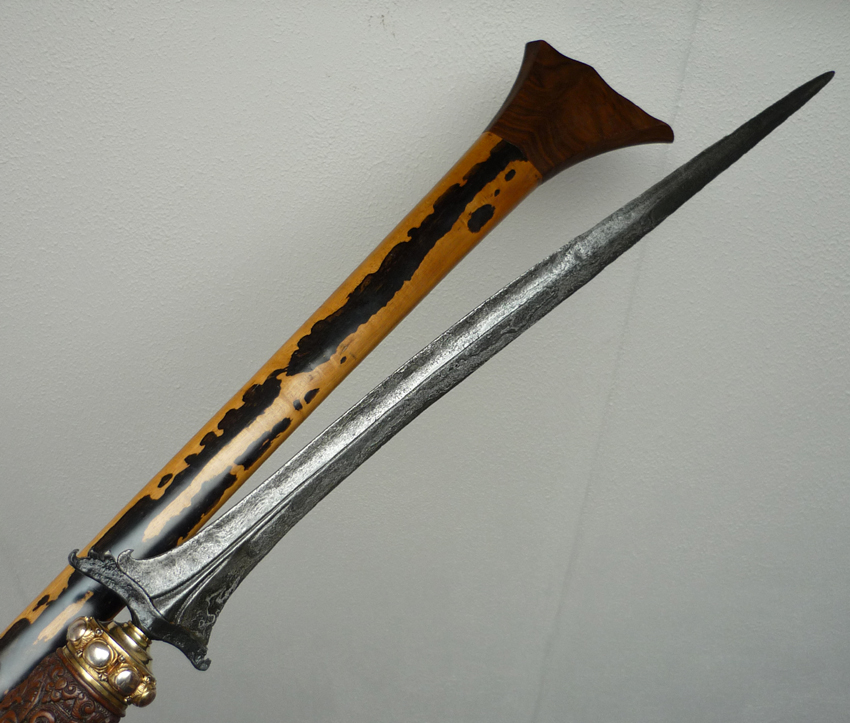

I hope, it is a keris ligan. Length: 49 cm. An interesting connexion of blade and ganja.
Old 29th July 2009, 01:11 AM   #20
Posts: 6,441
Is there a change from dull to sharp a little more than halfway to the point on the greneng side of the blade, Gustav ?
If not, then you have an interesting Bali/Lombok keris form .
Old 29th July 2009, 02:52 AM   #21
Posts: 6,441
GANJAWULUNG
An interesting thing about the ganja is that it echos the crossguard form of a Javanese pedang .
Old 29th July 2009, 06:13 AM   #22
ganjawulung
Join Date: May 2007
Posts: 991
Rick, to me the sor-soran part more looks like a "regol" dhapur of keris. A regol has two gandhiks, and no wadidang... (in "putihan" condition, this ligan's iron looks like 'wesi malela'...)
GANJAWULUNG
Old 29th July 2009, 09:11 AM   #23
Gustav
Join Date: Jun 2009
Posts: 1,346
[QUOTE=Rick]Is there a change from dull to sharp a little more than halfway to the point on the greneng side of the blade, Gustav ?
Rick,
there isn't such change, the blade is otherwise a current keris blade.
Old 29th July 2009, 09:02 PM   #24
Posts: 6,441
GANJAWULUNG
Indeed it does .
Old 29th July 2009, 09:06 PM   #25
Posts: 6,441
[QUOTE=Gustav]
Rick,
Gustav, I have never seen a ganja fitted as yours is .
(of course that doesn't mean much )
Anyone else seen this feature before in a Bali/Lombok keris ?
Also, it's beautiful .

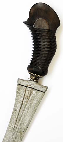

Old 19th April 2020, 01:51 PM   #27
Paul B.
Paul B.'s Avatar
Join Date: Nov 2017
Posts: 205

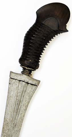

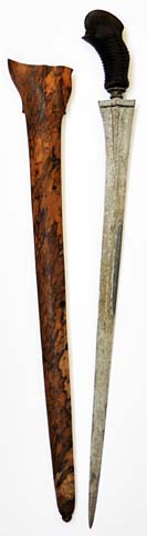

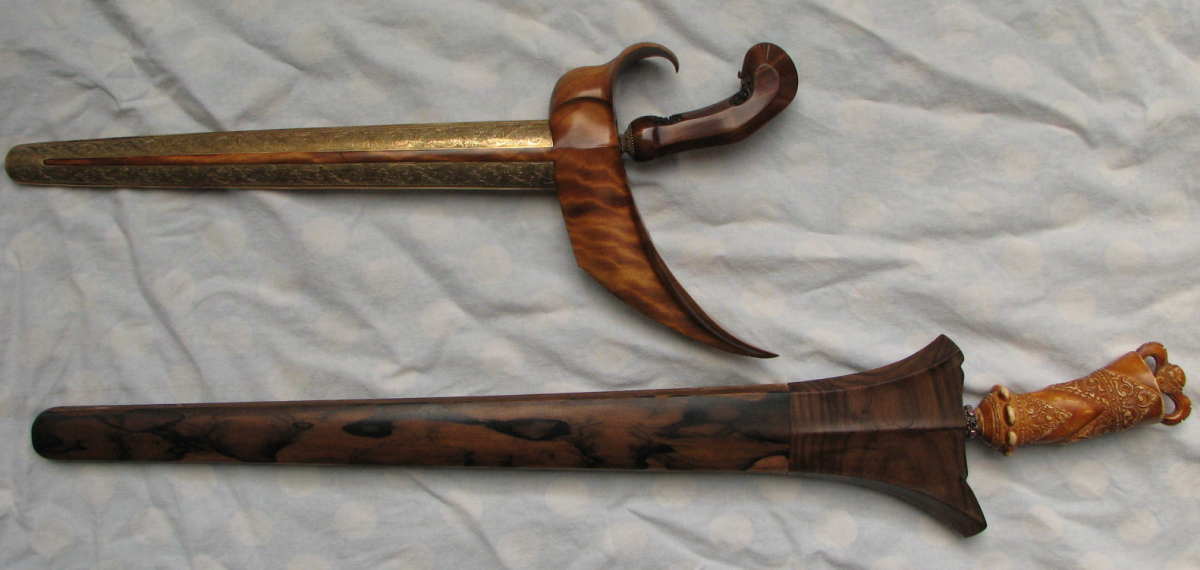

How about my LIGAN keris?
Blade size 47,5 cm, overall 67 cm. That's quite a large one.
Kocet-kocetan might not belong to it (as it is from Lombok?) but the selut is from gold / suasa so a valuable part of the handle.
Paul B. is offline   Reply With Quote
Old 20th April 2020, 12:45 AM   #28
jagabuwana
jagabuwana's Avatar
Join Date: Jan 2018
Location: Sydney, Australia
Posts: 295
That's stunning, Paul.
I learned a lot in this thread. Had I not known any better I would have thought I was looking at some kind of keris dhapur sepang.
jagabuwana is offline   Reply With Quote

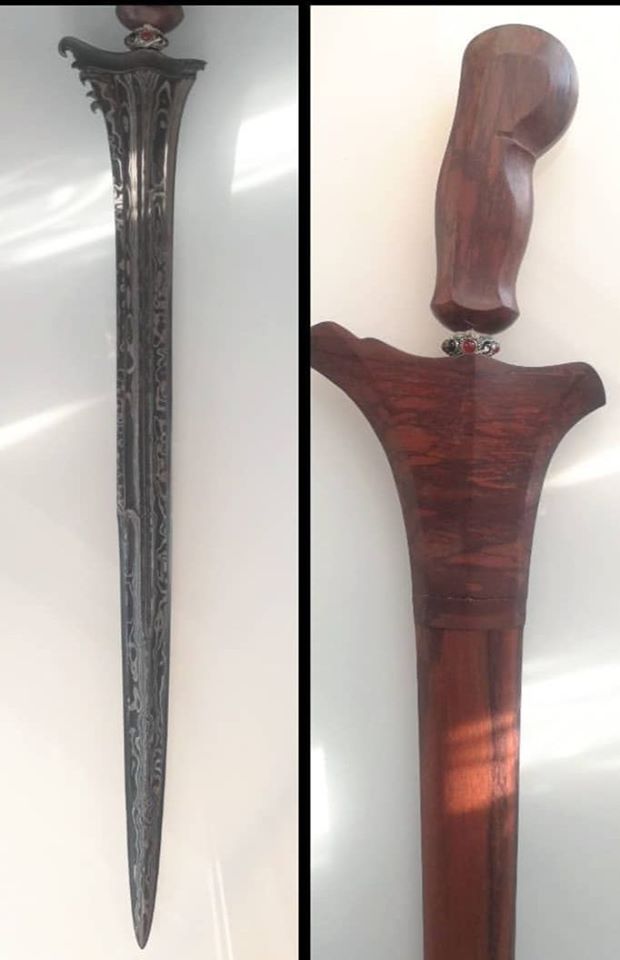

Modern era Bali made keris Ligan.
Correct?

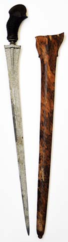

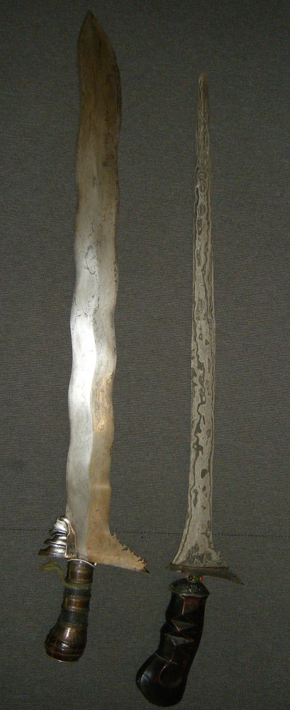

Old 21st April 2020, 01:52 PM   #30
Here my honest example, 76 cm inside scabbard, 71 cm without, blade without pesi 57 cm. Last picture show it together with a huge Moro kris for size comparison.
