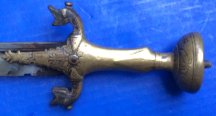

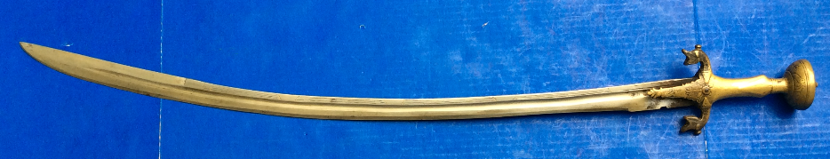

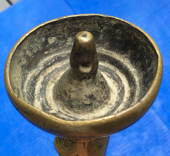

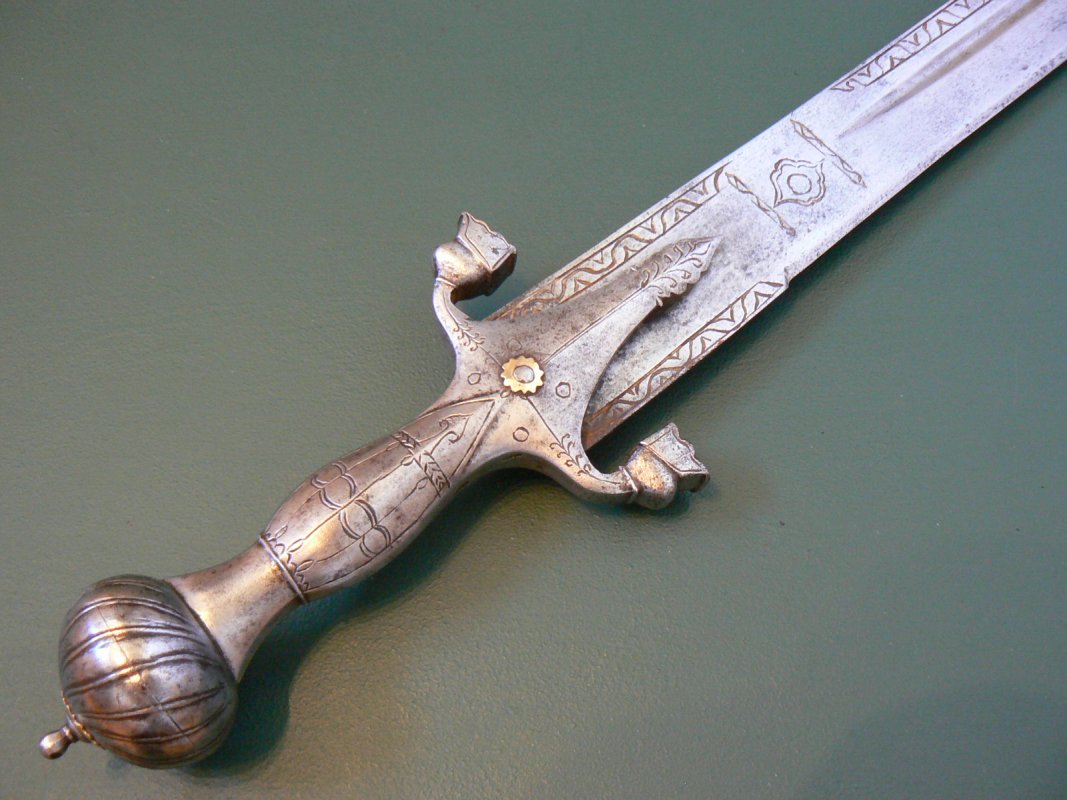

This is an Afghani pulwar, with a typical Afghani blade : false edge, narrow profile and very thick spine, thin fullers interrupted by flat planes and indentations filled with yellow and red lac. I suspect it is wootz because of a long " seam" or "crack" at the spine, but could not reveal it with lime juice or ferrous sulfate.
But my real question is about its handle: crudely-cast brass with very deep cup-like pommel and a baluster going all the way up from the bottom and having a lanyard hole. At first blush I thought that it was a traditional Afghani pommel with a lid lost, but the lanyard hole looked to be located quite low, below the presumed lid. I placed a very thin piece of metal next to it and indeed, at least a third of the hole was below the level of the presumed lid.
The rivet through the guard is distinctive though one can see this construction in Jodhpur in the 19th century examples and in the south even earlier (See Elgood's " Rajput Arms", vol. 1, p.22): the "adoption" of that feature went from South to North. Old brass shows that Afghanis used this material well before 20th century.
Thus, my cautious conclusion that this pommel had never had a lid, it was open, just like the pommels in Hamzanameh, the Brian's tulwar similar to piso podang or Jens' tulwar on pp. 350-3 in his book. If so, this might be an early pulwar handle, 17-18 cen. at the latest. Apparently, the owner thought it quite valuable for some reasons: one langet was broken and carefully shortened and reformed. The blade is likely newer than the hilt. Pics are attached
Your thoughts?

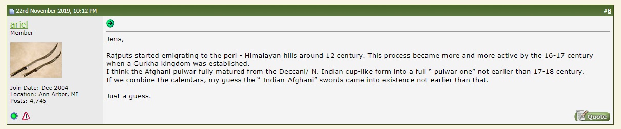

Why ask a question if you yourself answered this question for yourself a month ago by expressing your opinion?
http://www.vikingsword.com/vb/showthread.php?t=25438
Message № 8.
Didn't you say that "I think the Afghani pulwar fully matured from the Deccani/ N. Indian cup-like form into a full “ pulwar one” not earlier than 17-18 century".
You are probably showing a Deccan sword, or an Afghan pulvar with a handle from Deccan (according to your own ideas)

Sorry, Ariel, no informed contribution from me either since this is not my area of expertise if any. It certainly looks like a good ol’ warrior who could tell a bunch of stories!
Any signs of the lost wax casting remaining with this hilt? The guard does look typical. BTW, any idea which mythical creature is associated with this type by Afghan ethnic groups or possibly cultures elsewhere?
Considering that the open cup most likely is the original design, it is amazing how rare genuine examples appear to be extant while their descendants are pretty common on Sumatra and the Malay Peninsula.
The blade seems to exhibit the pretty crude craftsmanship often seen with Afghani blade decor. Any signs on the hardness of the steel when you cleaned the blade?
Old 24th December 2019, 03:21 PM   #8
Talking
Kai,
I really do not know what are the specific signs of the lost wax casting I should be looking for:-(( But it was cast, no doubt, very basic work, kind of “ village level”.

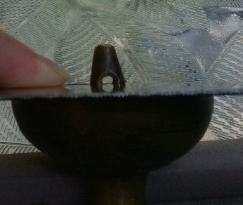

Generally, the ends of downturned quillons on Afghani/Persian hilts are associated with dragons.

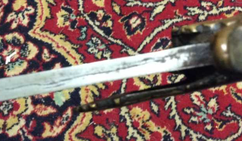

The blade is hard. Also, look at the second pic( handle with intact langet): there is a small part of the edge that “crumbled out” after some mechanical stress( a blow?). Thus, the steel is quite brittle, and that was yet another hint of the wootz nature of the blade.
The “open cup” design was first shown among the mid- 16 century illustrations for Hamzanama commissioned by Akbar. It was indeed considered extinct , but for the only surviving example belonging to Brian Isaac and illustrated by Elgood in his “Hindu” book. It indeed looks just like Piso Podang. However, similar idea was preserved in NW India, albeit with more shallow cups. The example from Jens’ collection ( see above), also from brass ( correct pages 321-323, sorry for the earlier mistake) is one of them, and I have several simpler ones. They are difficult to differentiate from the Afghani, but the close connections between the two areas are well known.
And yes, it is old. The broken langet was fixed for continuous use and the grip of the hilt is polished bright by the hand(s) of the owner(s). Even incised decorations on the grip are almost completely extinct, with only bits and pieces left over.

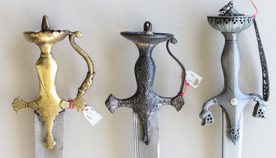

I am with Ariel. I dont think the cup disc has ever been closed.
Although it is a different hilt type see also my catalogue pp. 321-323 - picture attached.
From left to right, NW India/Afghanistan 17th century, Afghanistan 17th top early 18th century and Afghanistan late 18th to early 19th century.

Jens,
Thanks for the examples!
Your first one ( brass) also seems to have been rather crudely cast; not as bad as mine, but still...
I just noticed another similarity between the two: the widened part of the grip is asymmetrically shifted toward the pommel. I looked at all my pulwars and all of them had it located in the midsection of the grip. Also, crenellated lower langets.
Was it a chancy coincidence, a “ signature” of a particular caster, or an early pattern ?
Curiousier and curiousier.....

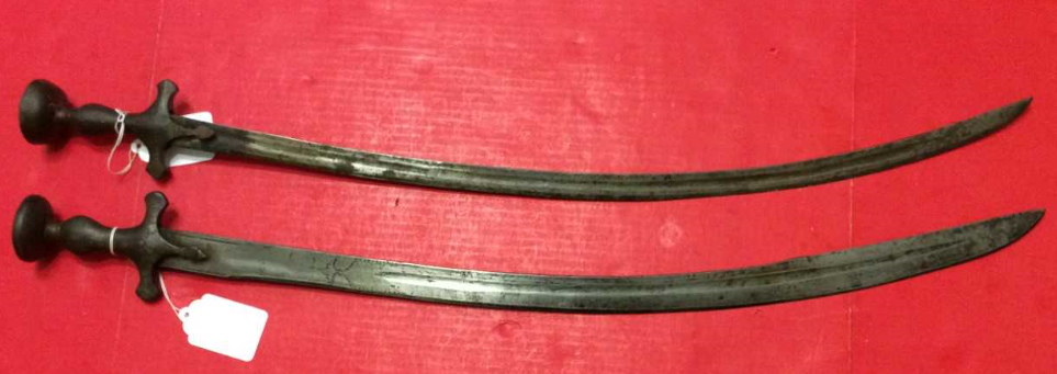

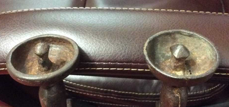

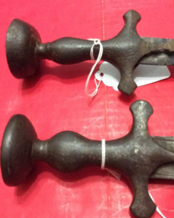

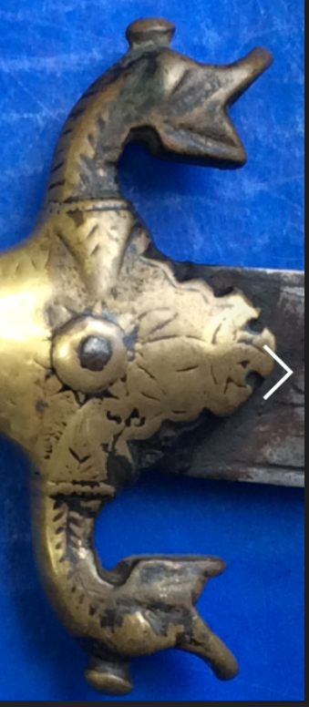

Just to add fuel to the discussion:-)
Here are 2 sabers. Both have thickly-patinated " tulwar" handles, but with a twist: their pommels are cup-like without lids. Both have crude fleuret terminals of their quillons. The upper one has no pin through the quillon bloc, but the lower one does.
The blade of the upper one is typically Afghani, the lower one - likely Afghani, but may conceivably be of NW Indian origin. No evidence of newer mastique, it is pretty crumbled and some of it is lost in both cases. Very ( very!) cautiously I would conclude that the entire handle/blade assemblies are original or at the very least belong to the working life of these sabers.
Overall, my interpretation:
-both are most likely old Afghani swords. Judging by the fleuret-like quillons, they may be 18 century ( See discussion of Jens' example from his book, p. 321 and its picture posted by him).
Are they, as well as my earlier example with brass handle, predecessors of the full-blown Pulwar pommel?
