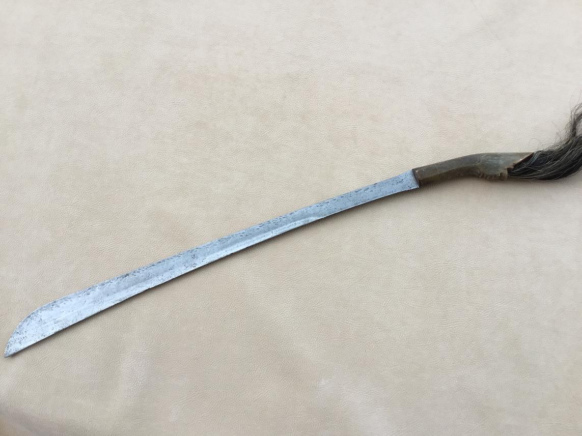

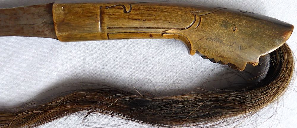

Old 25th May 2018, 01:37 PM   #2
Default Gliwang from Thomas' collection
Example #1 from this thread: http://www.vikingsword.com/vb/showthread.php?t=22732
Originally Posted by thomas hauschild
Total length nearly 80 cm without the hair, blade thickness 9 mm at the handle goes down continues to 1 mm, weight 620 gramm

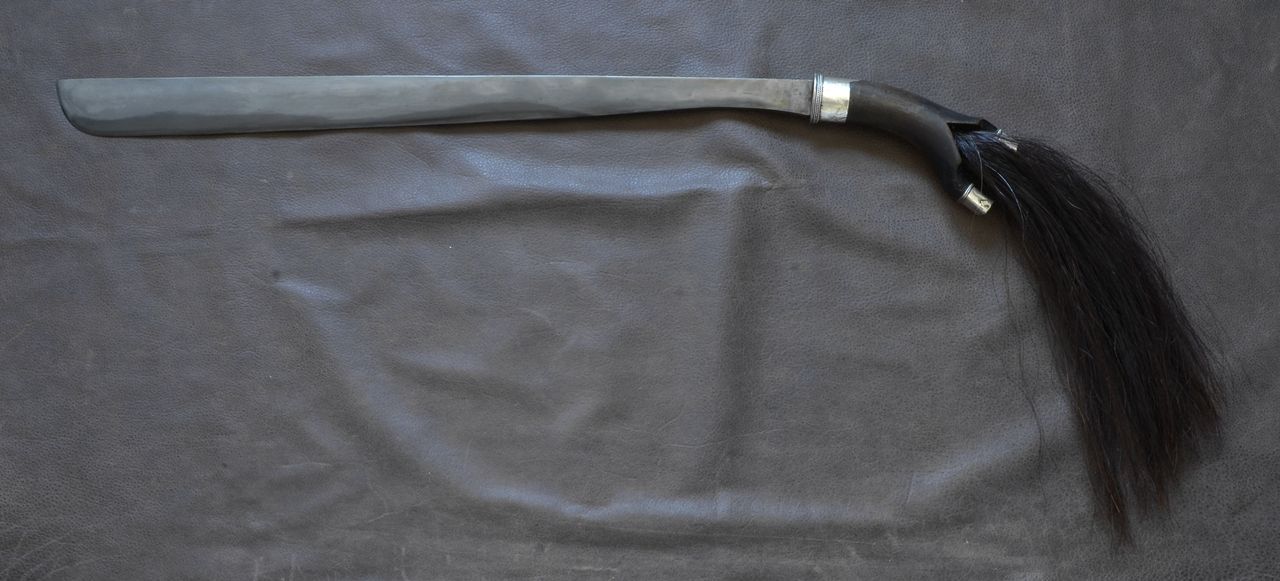

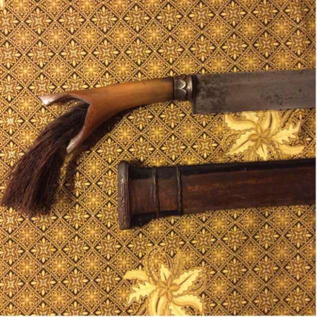

Old 25th May 2018, 01:41 PM   #3
Default Amanremu from Roland's collection
Example #2 from this thread: http://www.vikingsword.com/vb/showpo...98&postcount=1
Originally Posted by Roland_M
The whole sword is 66cm (26") long, blade 52 cm (20,5"), the massive base is a little more than 12 mm (0,5") wide, it weighs 740 grams.

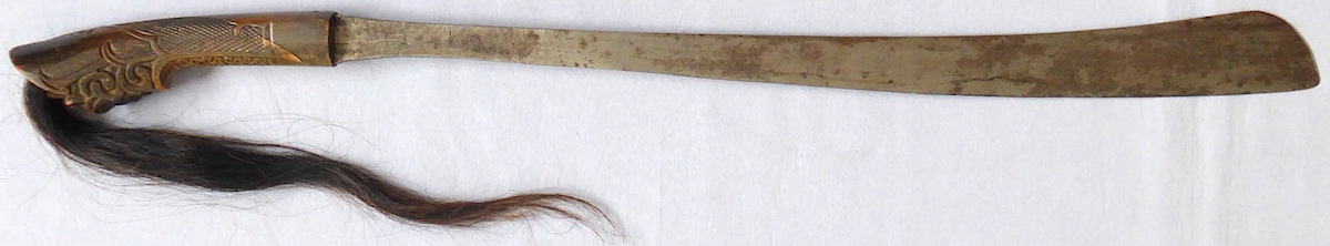

Old 25th May 2018, 01:43 PM   #4
Default Sikin panjang from Machetero's collection
Example #2 from this thread: http://www.vikingsword.com/vb/showp...098&postcount=10
Old 25th May 2018, 01:46 PM   #5
Roland_M
Roland_M's Avatar
Join Date: Aug 2014
Location: Germany
Posts: 528
Originally Posted by kai
We all know that dealers and collectors often restore decorations of hair (as it is fragile and easily lost to clothing moths, dermestid beetles, etc.); I don't think it's unreasonable to assume that some would be dumb enough to also do this to pieces from a culture without any such tradition...
1: I think a serious collector would never add a hair tuft to a blade which never got one. This would be ridiculous and he cannot show the piece to any other collector.
2: To add a hair tuft as an upgrade to increase the price is also not senseful, because most collectors know what the buy and they will laugh about such an attempt.
In my case the hair is braided and surely not a kind of silly upgrade by a collector.
Roland

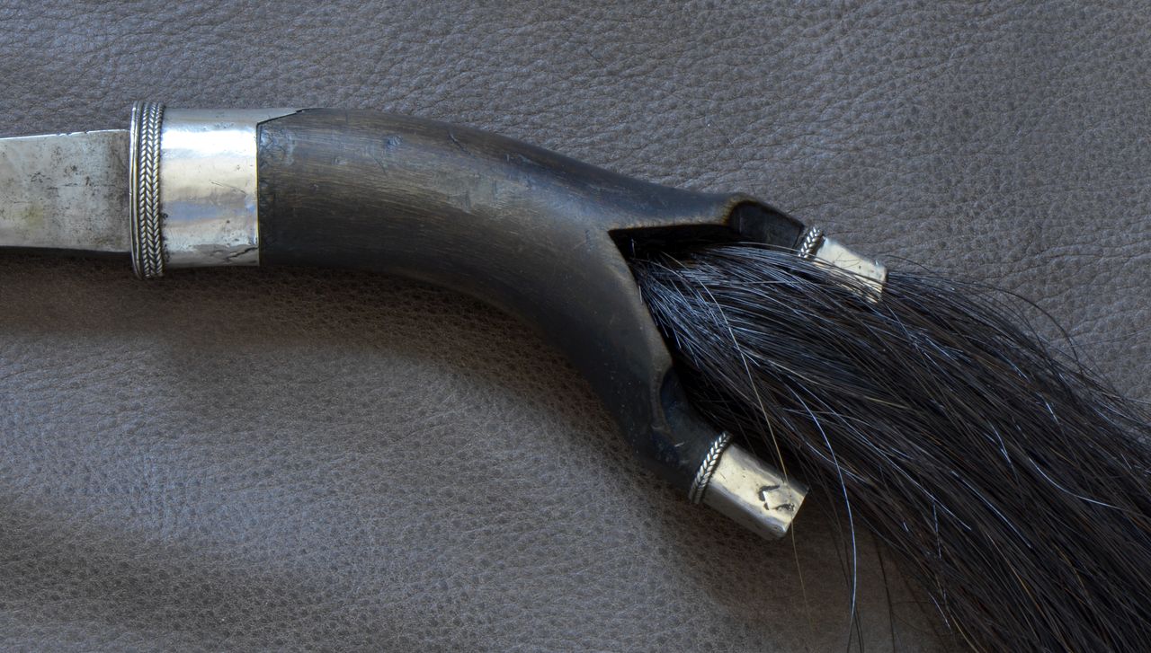

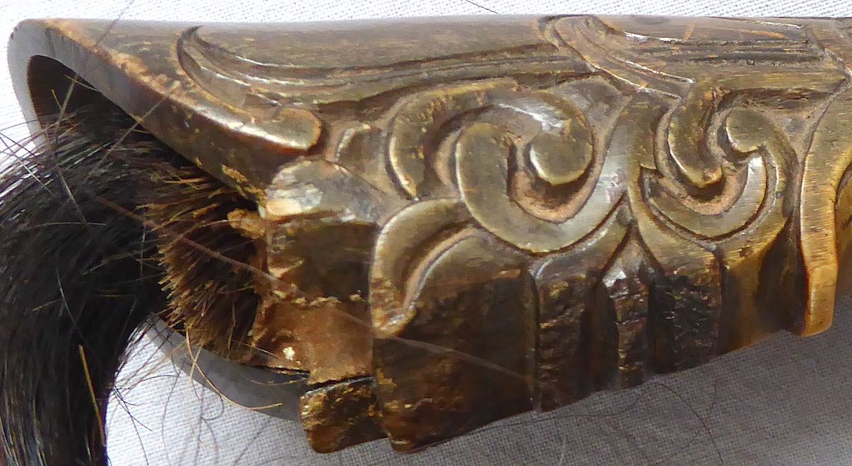

Old 25th May 2018, 02:30 PM   #7
Default Ladieng from Karel Sirag's collection
Submitted via email - thanks, Karel!
Originally Posted by Karel Sirag
COLL.NR: 12-29
ORIGIN: Sumatra, Aceh.
SWORD: Gliwang. TYPE: Gliwang Ladiëng.
TOTAL LENGTH: 70 cm.
BLADE: Iron. LENGTH: 53,3 cm.
HILT: Greenish Buffalo Horn, carved. HEIGTH: 16,7 cm.
TASSEL: (probably) Horse hair, brown. LENGTH: 35 cm. (Measured from attachment to very tip.)
AGE: Old piece, could be first quarter of 19th cent.
NOTE 1: The back of the hilt is only partly carved.
NOTE 2: The hair is fastened inside the pommel cavity with a wooden plug and a metal pin. This pin can be seen on the photograph of the uncarved side of the hilt. At a later time, a light brown substance got added along the margin of the cavity.
Old 25th May 2018, 02:31 PM   #8
Post
Hello Karel,
Yes, I've seen a more elaborately carved "show" side with quite a few hilts from the greater Aceh region.
The brownish (hardened) paste does indeed look like a later addition to fill the crevices around the tassel attachment, probably for cosmetic reasons (given that the metal pin is very likely to hold the wooden plug tightly enough).
The pinned construction is certainly unusual for the whole archipelago.

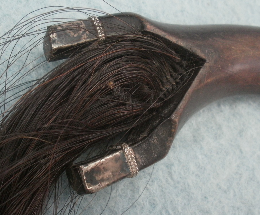

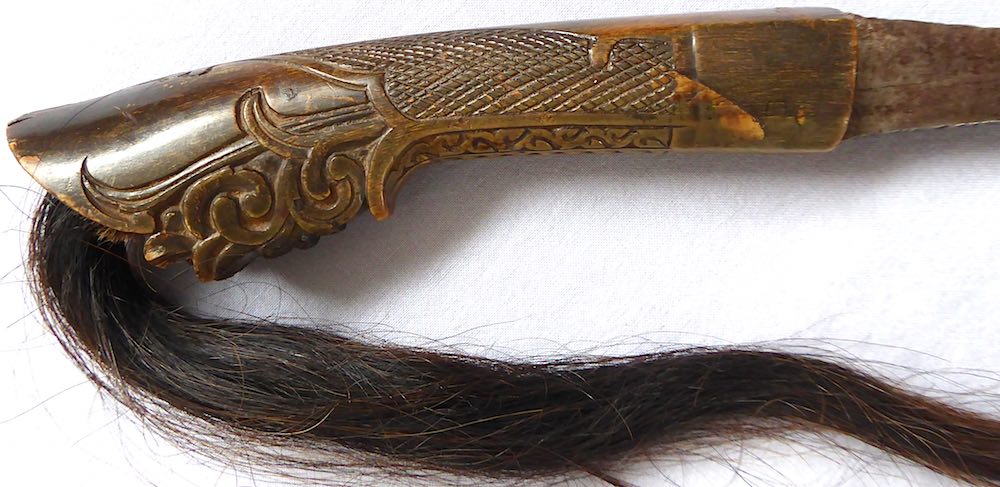

Old 25th May 2018, 06:34 PM   #9
This is certainly interesting and may help to narrow things down. Any chance to shoot close-ups without the hair getting into the way?
Hello Kai,
first, there was no attack intended by my comment in the other thread. When you have felt attacked I apologize!
I have a lot pictures from Rolands new treasure which I have assigned wrong as Amanremu since I agree with Roland that it is in fact a very rare Batak Pakpak landingin in my folder where you clearly can see the braiding, picture taken when still uncleaned.
Hope Roland don't mind when I post this picture.
You will agree that this let suppose that this is an original decoration. The same I can say about the gliwang from Thomas, the attachment isn't fine like by the sword from Roland but IMHO a tribal work and not a later addition for selling purpose.
And I've handled both swords in the meanwhile.
A thought come to my mind, could it be that all this pieces are of Pakpak origin? There are not many published Pakpak swords to compare so is the chance high that it was maybe not uncommon that some Pakpak warriors liked to adorn their swords with hair??
Like said before, I think we all haven't seen every sword variant and will maybe never see.
Old 27th May 2018, 09:18 AM   #10
Post
Hello Detlef,
No worries, frank communication is perfectly fine with me!
I have handled quite a few of these swords and just don't see it. To me the blade shape of Rolands sword does not seem to fit with typical ladingin; it clearly seems to be an amanremu/mermu (even if the tip might be a bit worn); and I don't see any features suggesting it originates from any Batak group. Let's discuss this on the thread dedicated to this sword - more close-ups would certainly be nice to see!
Not necessarily, I'm afraid - horses and braiding hair were not exactly unknown in other parts of the world (including Europe... )
One region that springs to mind where braiding was used to attach hair decorations would be southern and central Sulawesi. On swords I'm used to see human hair while on tawara (spears) goat hair seems to had been utilized.
Just playing devil's advocate - how do you tell the difference (if made well)?
There are a bunch of Pakpak swords around: Van Daalen & Christoffel and Volz & Christoffel were among the first Europeans to transverse the region. There is no mention of pommels with tassels in the records; and weapons were carefully studied for military reasons.
We should be careful with making up stories. None of the examples shown here does exhibit features that clearly suggest any Batak, much less Pakpak origin. All could possibly had been traded to Pakpak owners as well as to just about any other ethnic group in the northern half of Sumatra (and beyond - cp. Schmeltz). IMHO, the currently available evidence does suggest a much more northern origin of these swords though (Aceh or northern Gayo).
As already mentioned, it is possible that these tassels were modifications by some more distant ethnic groups. Let's see if we can narrow things down by details of the attachment and possibly any braiding work, etc.

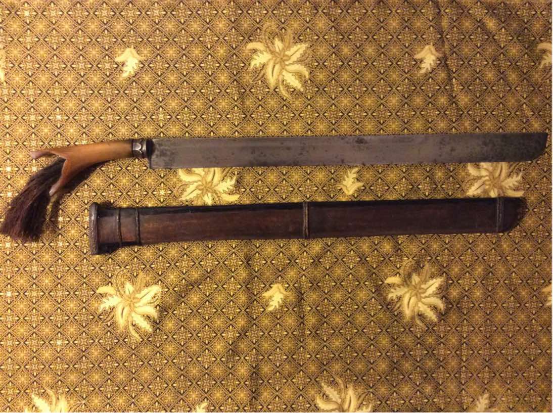

Old 28th May 2018, 01:05 PM   #11
Machetero
Join Date: Feb 2013
Location: Stockholm, Sweden
Posts: 12
I checked my Sikin if the hair was braided, but no. However, the hair was certainly separated into sections, as if the hair had once been braided, but in that case, clearly not as elaborately as on Roland's sword.
/Odd
