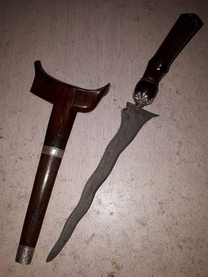

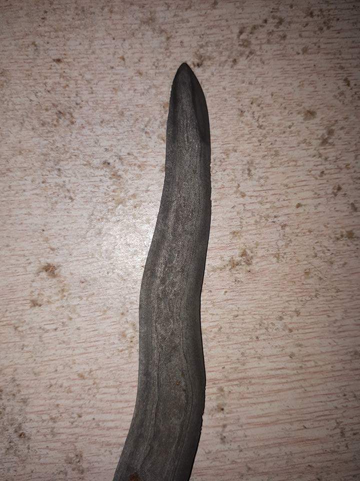

Default Small (dress?) Keris Minang with sepuhan on the tip
Hi David & Alan, thank you for your explanation.
By the way, the keris Minang pictured here is actually small one (the blade is less than 25 cm in length) and it got sepuhan on the tip part of the blade.
I have seen the previous thread which discuss the small keris or called keris selit in the Malay culture which is functioned as dressing companion. But judging from the sepuhan exist on the keris that I've shown you, is it possible that these small keris may have practical function (eg: as a weapon)?

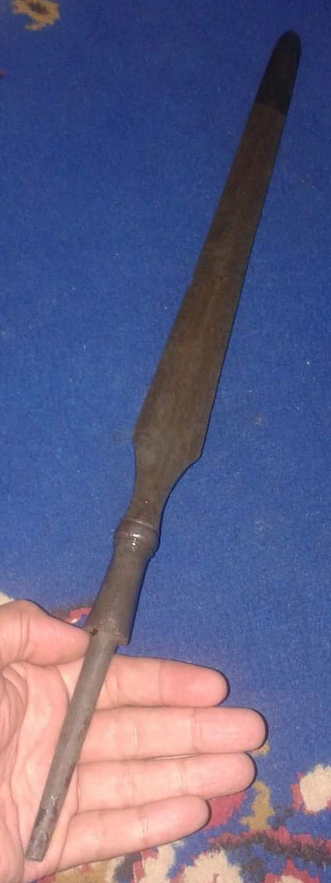

I also attached picture of a tombak from Palembang with sepuhan only on the tip part.

Hi Oracle. AFAIK Keris selit is specific certain areas of Malay culture. Minangkabau culture is distinctly different from the Malay cultures of the Peninsula as well as other cultures on Sumatra. I do not believe they have a tradition of keris selit as a dress function. From my understanding Minang keris tend towards the shorter side.
Keris are stabbing weapons so the most important area of the blade for harding would be the tip.

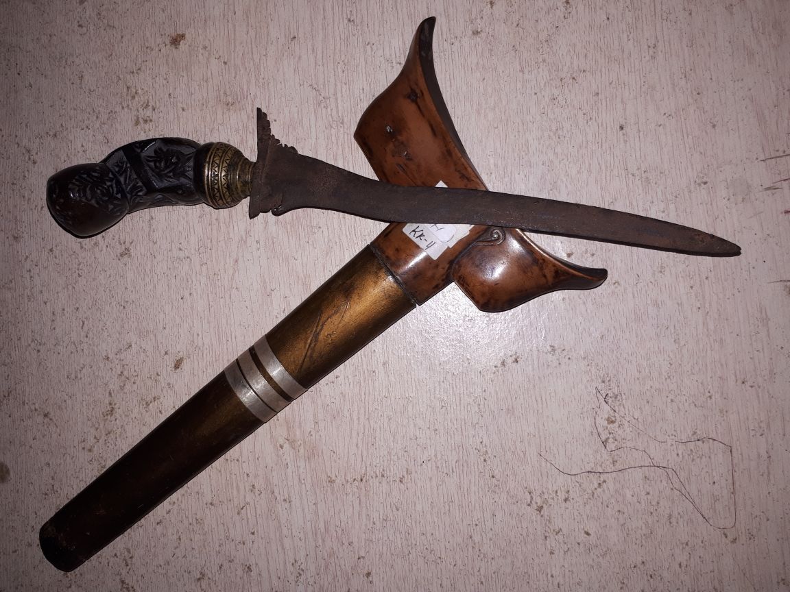

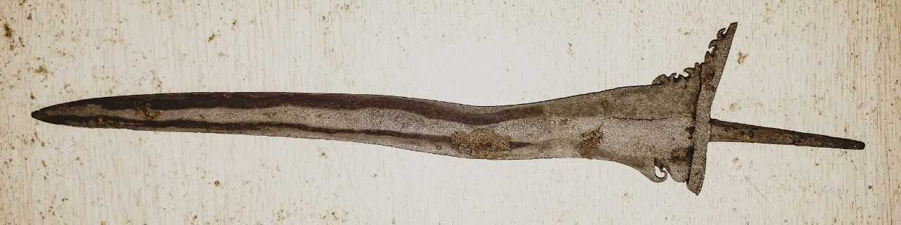

Hi Gustav, I want to show with you another example of keris Minang which has intrigued me in regards with our discussion about the practical function of sepuhan and therefore, its existence in small keris particularly in Minang culture (and whether or not it is separable from the Malay culture in general).
Attached, I sent you pictures of a keris Minang with small size with blade length just about 20 cm (actually it fits exactly the length of my palm). After I clean the rust with coconut water, it appear that this keris is constructed from different kinds of steel: pasir malela steel (or "bunga garam") along the center part of the blade and the ganja; then malela steel or "besi miang" along the edge part of the blade. It is also given sepuhan from the part above sor-soran to the tip.
Given the complexity of making such a small keris, maybe it really serve a practical purpose? So not just as a dress keris.
