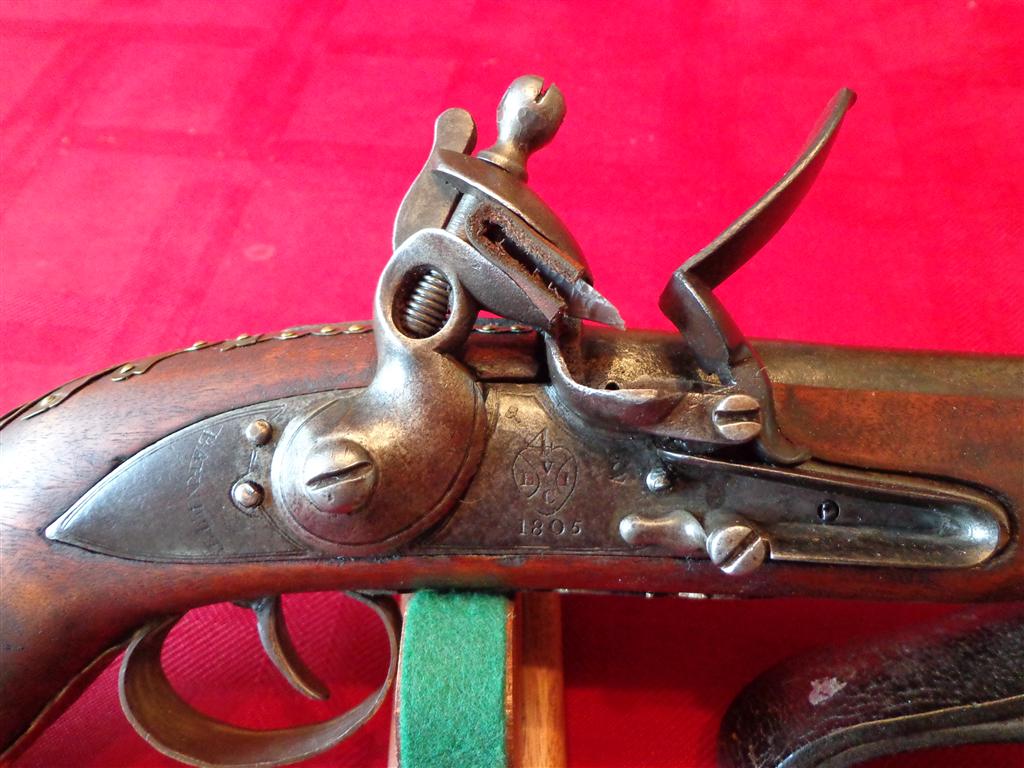

The first photo shows the style of lock marking used until 1804. The date was apparently not engraved on the lock before 1775.
Between 1804 and 1807 the heart and date appeared in the centre of the lock and the maker's name across the tail.

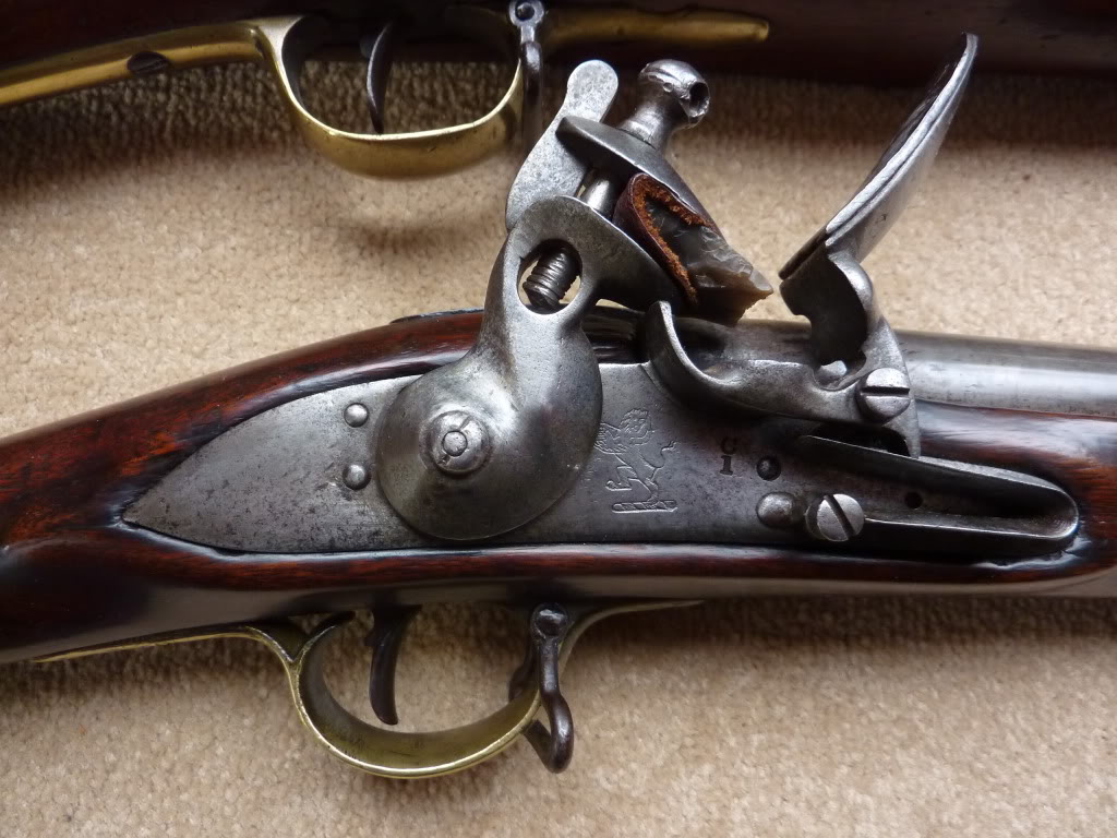

Second picture;
This photo shows the style of lock marking used between 1808 and 1818. There are several different lion stamps in evidence, some being rather crude and cartoon-like.

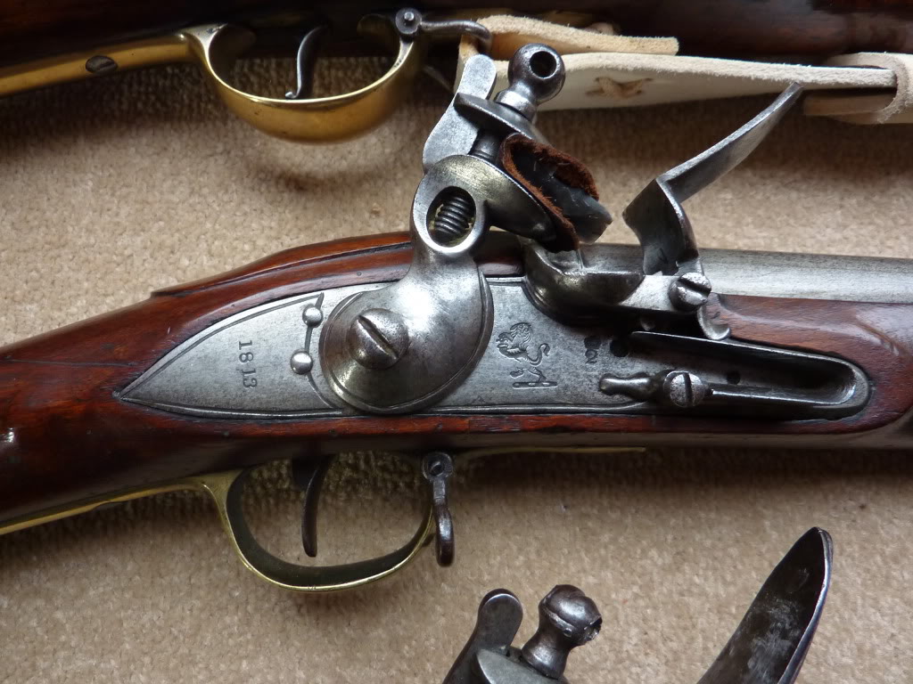

Third photo,
Here are the markings on a Baker Pattern lock 1819 to 1839. This late production example has the date code C for 1839. This lock also features the "bun nut" securing the cock to the tumbler.

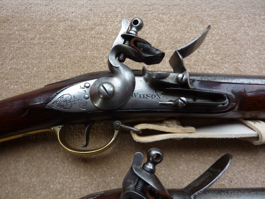

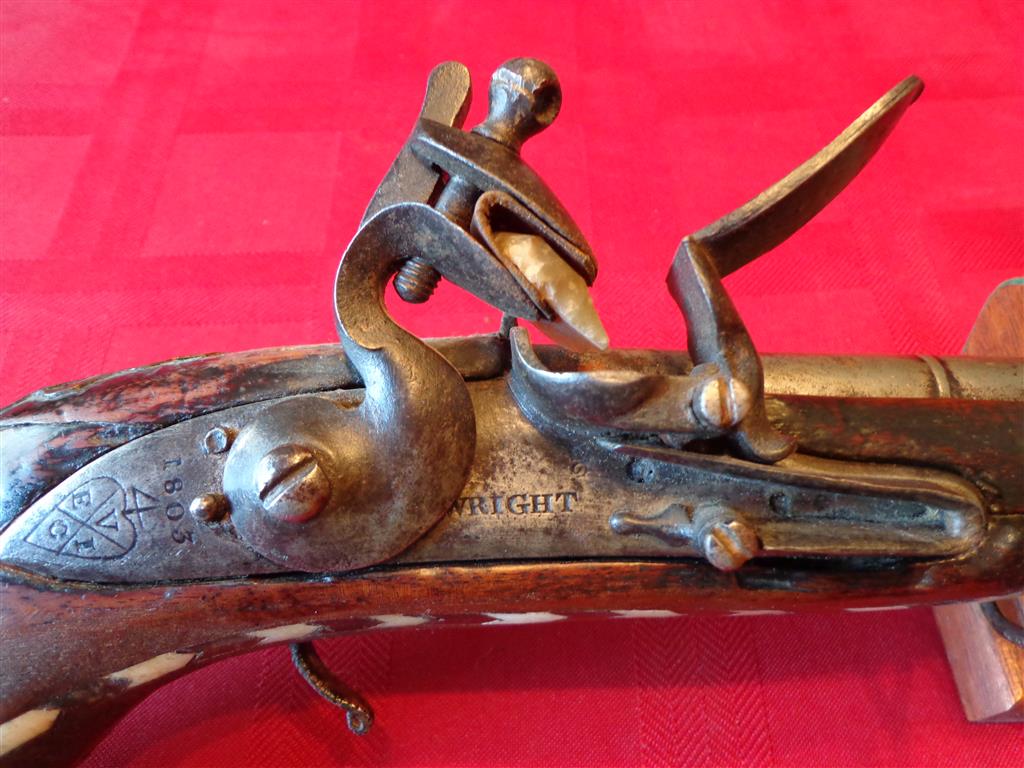

Posts: 1,634
Hi Stu
Well, here are a couple pics of locks on two of my Jazails. One is a Barnett pattern, the other a Wilson pattern. Notice the hearts and names on different locations on the lockplates. Note the quality of the engravings/stampings.
As to when, where, etc. the different hearts ID's were used and the locations on the lockplates, you almost need Harding's book to find out. I hope another Forum member might have the reference material to give you a better idea.
But if the mark is spurios, it could have simply been crudely copied at most any point in time. And was so common on these guns.

Hi Richard,
Sorry to disagree, but they did not always use what you describe as a "quartered heart". The style on my lock (whether it is genuine or a copy) is the same as that shown on Ricks lock dated 1805. The quartered version came later according to the small amount of reference I can find.
