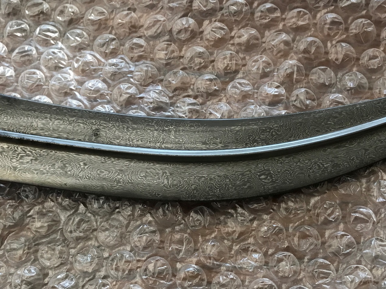

G'day Guys,
I was wondering if anyone could tell me more about the origins of this jambiya. It has a 24cm blade made from dark wootz with a heavy ivory grip. The back of the grip is covered in a light coloured metal. The scabbard appears to be wood covered with fabric and looks to have a bit of age.
To me it appears that neither this scabbard or the metal plate covering the back of the grip, would have been original to the jambiya. They don't seem to be the same quality as the blade or ivory grip. I was wondering if the metal may have been put on the grip by a later owner to cover damage to the ivory?

Hello Bryce,
The blade is unmistakeably Persian (18th century, my guess), and of highest quality Kara Taban wootz. Wow!

While you may be right about the hilt and the sheath, I am certain you are wrong, very wrong, about the blade.
I have many wootz blades, many etched myself, that show exactly the same type of local fading you highlighted on this blade.
The blade is Wootz all right in its finest form!
Moreover, the lobed pommel doesn't look very Arabic to me but much more Indian, as I saw several Tiger Tooth Daggers with pommels somehow similar to this one.

Nothing new about this piece. The blade is definitely wootz. The spots where the pattern is gone is where the edges were probably heat treated and not perfectly controlled causing the pattern to burn out. The contrast and depth of pattern rules out any artificial method. The scabbard shows extensive wear on the side worn against the body and the fabric exhibits a good bit of fading. I would call the hilt style Indo-Arab, maybe Hyderabad, with a funky replaced side. The ivory has a nice mellow patina and is old. The white metal mounts were probably a late 19th to early 20th century “fix” for a missing grip slab. Whether done in its working life or in a late 19th, early 20th century bazaar is anyone’s guess.

Agree about the blade: first class!

Hello Bryce,
there are jambiyas found on Muslim parts of Borneo but frankly said I've never seen one from there with wootz.
One word regarding the fading, it's located at the sharp bend from the blade and at the edge and I believe that this caused by strong and heavy beating by the forging process.

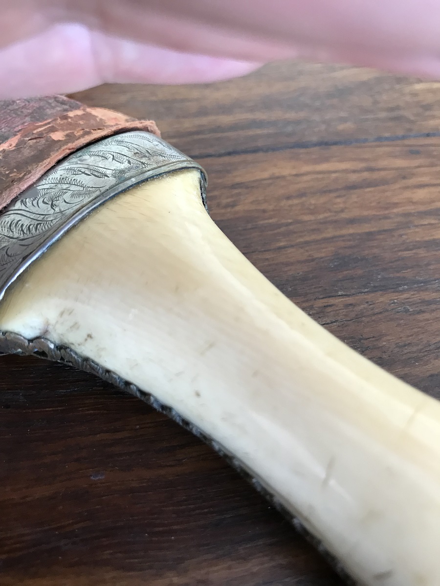

Old 13th January 2018, 04:00 AM   #16
Bryce
Bryce's Avatar
Join Date: Aug 2017
Posts: 202
G'day Guys,
Unfortunately I am no expert on ivory. I had always assumed it was elephant. I am curious as to what it is that you guys have seen that makes you think it isn't elephant.
After a quick internet swat I think it is elephant as it has schreger lines. They are easy to see with the naked eye, but very difficult to photograph. You can just about see them on the lower lobe in the photo below. From the angles produced it almost looks like mammoth ivory?
With the help of the torch, I can see that the ivory behind the metal plate, although fractured appears to be all there.
Cheers,
Bryce
Old 13th January 2018, 06:34 AM   #17
Posts: 4,749
Hi Bryce,
Sounds like you have elephant ivory. I don't know how experienced you are as a photographer, but your picture seems to have too bright a light source to see anything in cross section. Looks like you took it in direct sunlight. I would suggest that you take a picture in even light and without a flash. Then use an image editing program such as Photoshop (or even Preview if you have a Mac) to adjust the exposure, contrast, saturation, etc. until you have an image that shows the lines to your satisfaction. I've found the "sharpen" feature in these programs can be very helpful for displaying Schreger lines and other fine details.
Ian.

Old 13th January 2018, 09:12 PM   #19
Posts: 7,418
I agree, these new pictures look like elephant (not mammoth) ivory.
Old 13th January 2018, 09:15 PM   #20
Yes, I agree as well!
